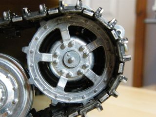

Hi all, i'm trying to remove the gearboxes on my torro pro king tiger and need to remove the main drive sprockets so can replace gearboxes.
I assume that the drive wheel is held onto the gearbox shaft via screw, but there is a centre cap and i cannot work out how i can remove this cap without damaging the wheel or cap, any advice would be much appreciated.
Thanks all, Brett.
http://www.rctankwarfare.co.uk/forums/d ... p?id=31168.
Here is a link to pic on these forums of the wheel and cap in question.

Hi Brett,
it is so, how you suspect.
You must remove the cap in the middle of the drive sprocket, then you find a allen screw M3. This one you must unscrew, then you can remove the drive sprocket. It could be, that the drive sprocket is so hard fixed that you must use a puller (so was it at my Torro Kingtiger).
Normally is the middle cap only pressed in the hub, but it could be, that Torro has donated a drop glue. :problem:
Take a small screwdriver and try your luck. :thumbup:
Greeting Hotte

Thanks for the reply, i've decided to soak the part in wd40 and buy some ultra fine flat head screwdrivers in the hope i can get down the very tiny gap around the cap itself.
I will let you guys know if i have any success, but do not want to damage the soft alloy metal wheels and cap trying to do so.

superguybrett wrote:Thanks for the reply, i've decided to soak the part in wd40 and buy some ultra fine flat head screwdrivers in the hope i can get down the very tiny gap around the cap itself.
When you try to levering the cap, please lay a piece of wood under it, to avoid damage on the drive sprocket. And ever evenly levers around the drive sprocket, good Luck.
