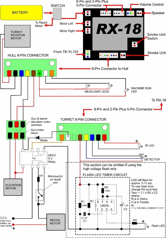

jonger
Posts: 215
Joined: Tue Jan 04, 2011 8:39 pm
Location: Charnwood Leicestershire
Re: Snap!
Post by jonger »
Just had a search and found an image I have been using to check my wiring is correct as I modify my tanks - I can't remember who posted it originally or even if it was this site but it is very useful, its a diagram some one posted for installing a flash unit but it shows all the wiring loom.
hope the original owner does not object.
wiring connections
wiring connections
Jonger
