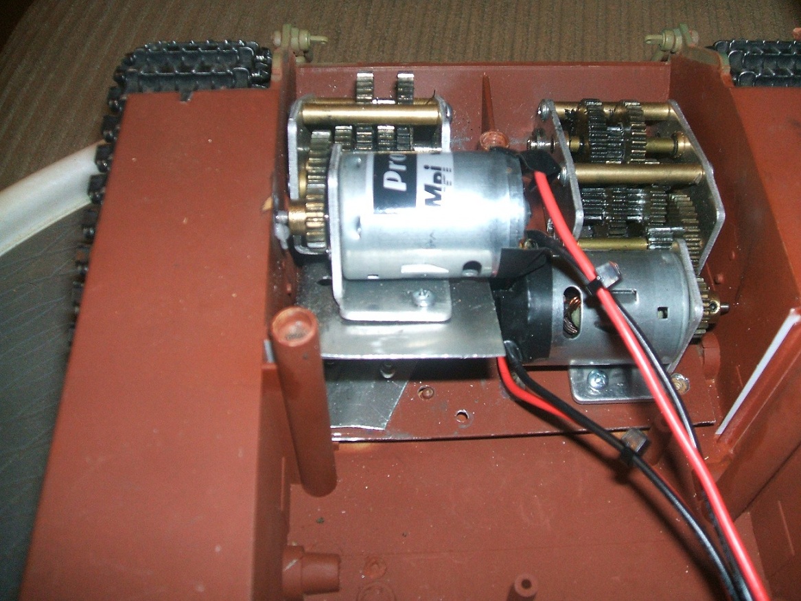

Post by buckeye36 »
I mounted mine with a metal plate and riser, this allowed me to add 400 motors.
