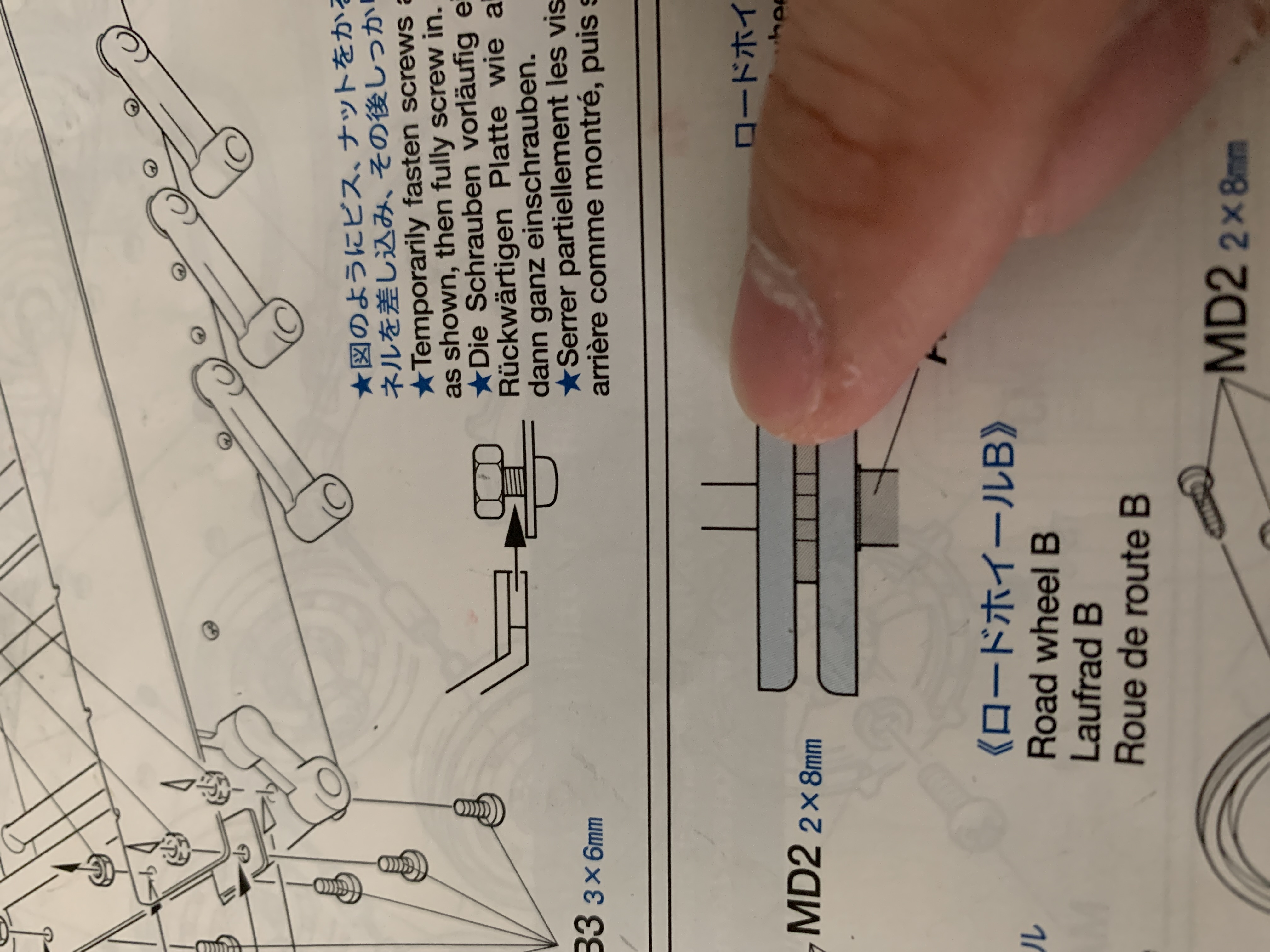

I was looking at step 13 of the instructions and wasn’t sure where did that grey thing in the middle of the road wheels come from where it kind of separates both road wheels, neither MF parts are wide or big enough to be able to do that? Did I miss something on the instructions?

Hello, Thank you for your reply and my track teeth do go into the wheels but the grey thing that separates the two metal disc, what item # is that? None of the MF pieces are big enough to create that level of separation, and could you also tell me what I did wrong

Hello the grey part where my finger is pointing to what does that reference to, and I see you have quite a large gap between your KT but the other one the gap seems a lot smaller. I have attached pics but I feel like I have followed all the instructions carefully tho so if I am wrong pls point out where!

That grey part is part of the wheel itself, no extra part.
After seeing your new pics it is obvious they are wrong. Just remove the wheels, remove the screws and fit the metal parts correctly, that is it.
