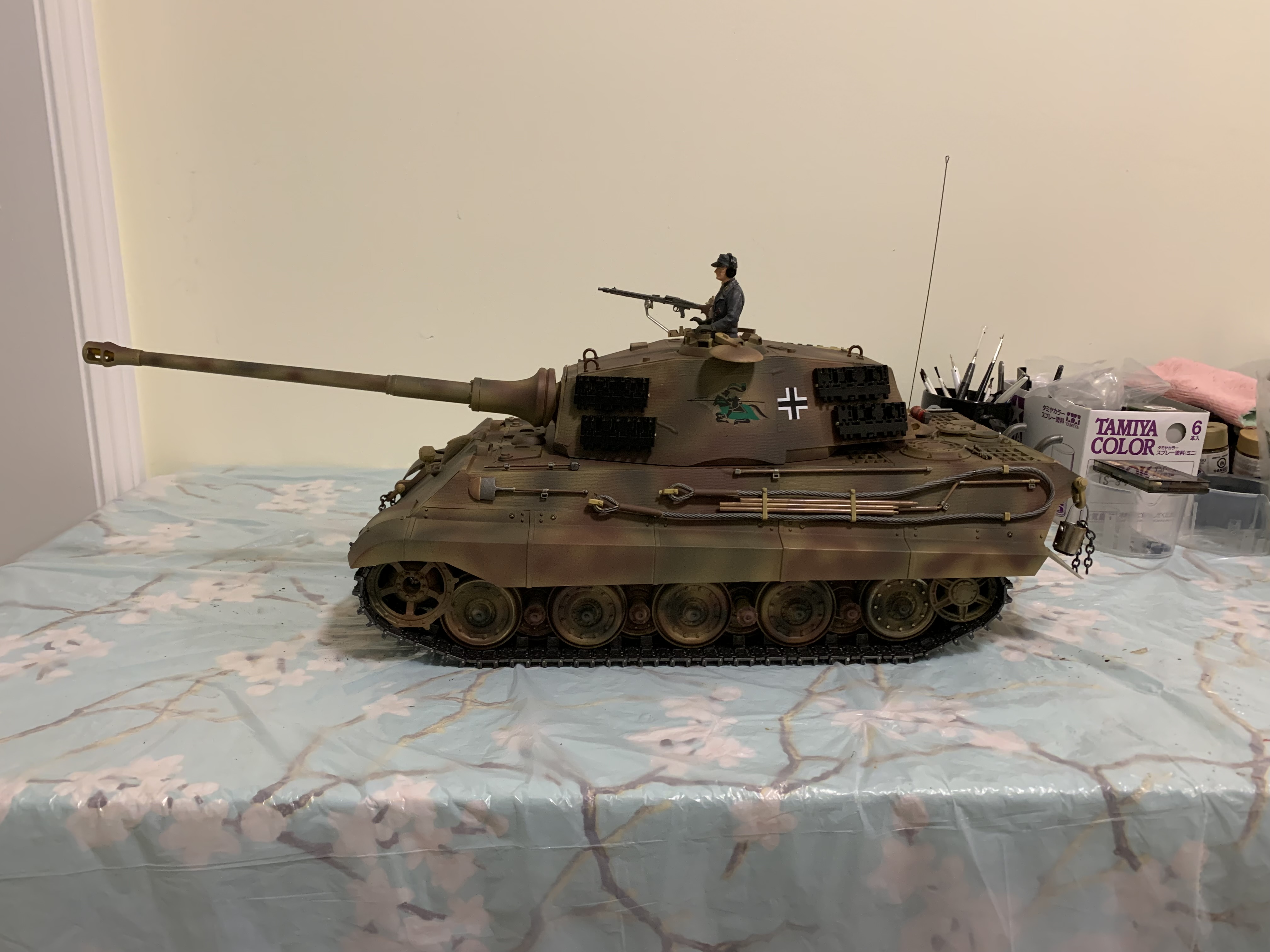

Michael151722
Posts: 122
Joined: Sat Jun 22, 2024 3:30 am
Re: 1/16 Tamiya King Tiger Road Wheels won’t spin
Post by Michael151722 »
Jofaur86 wrote: Fri Jun 28, 2024 3:50 pm Question: do the central teeth of the track pass properly between the metal discs??
Yes it does and here is a picture of it if this is what you mean
