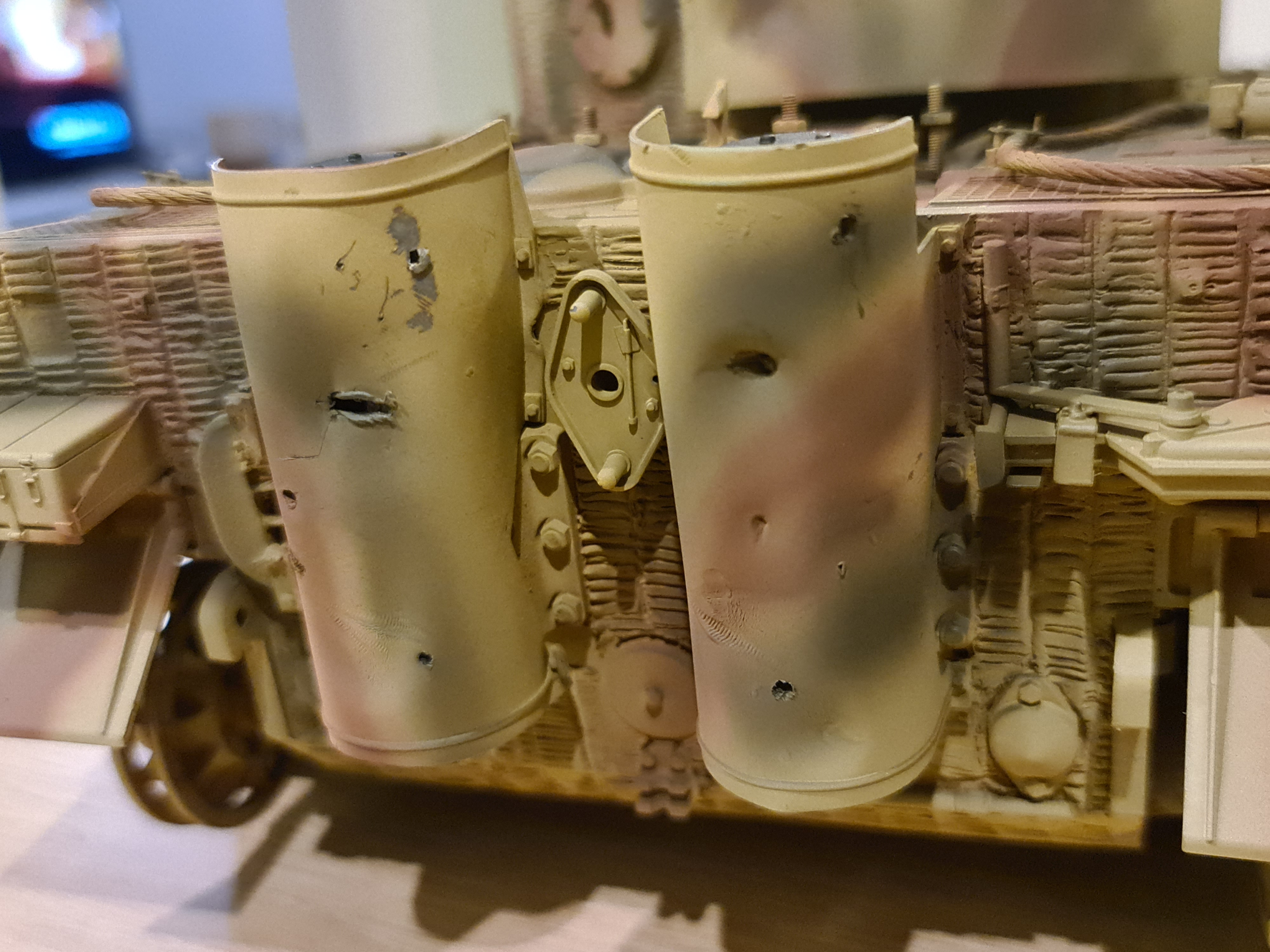

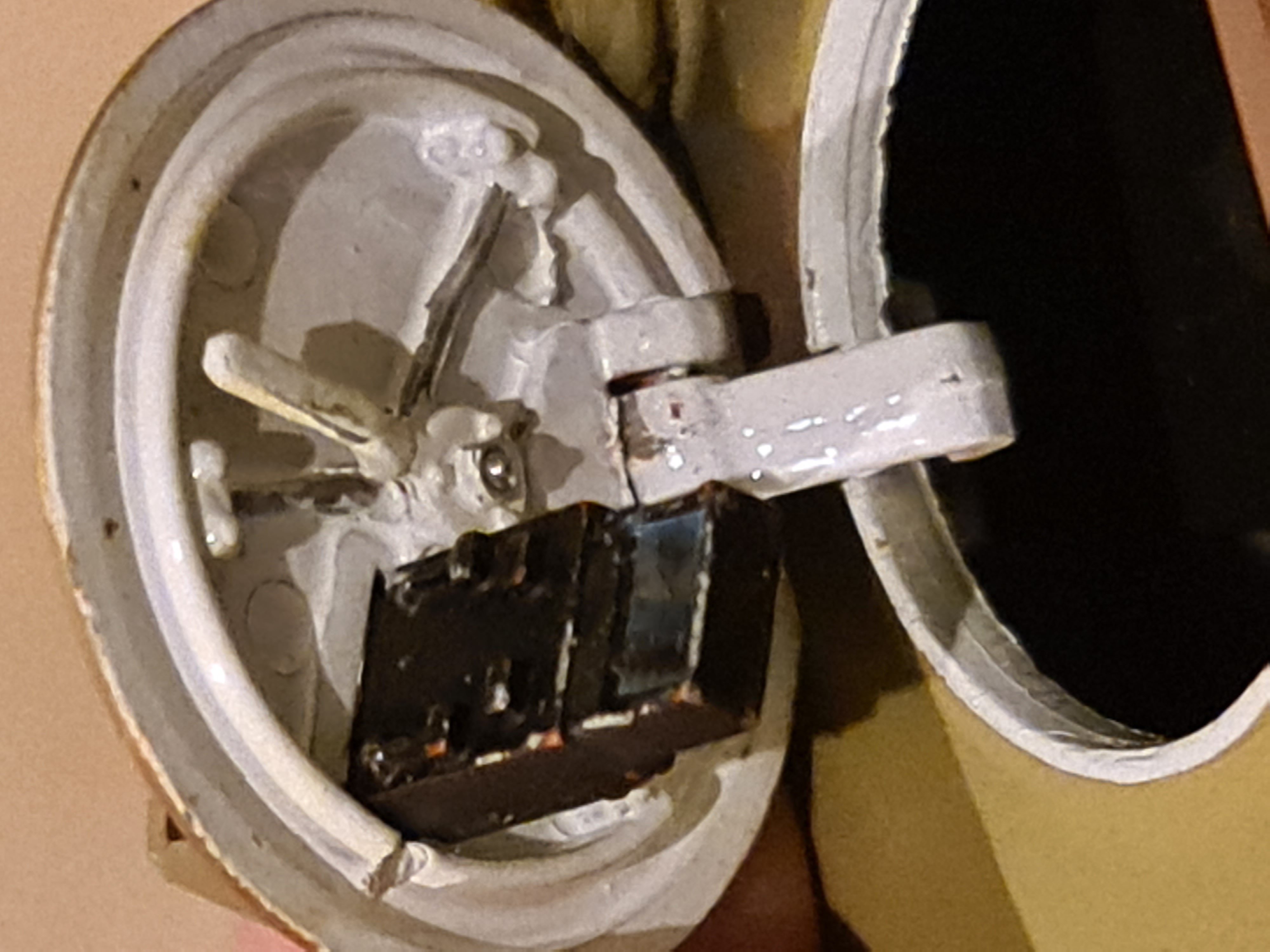

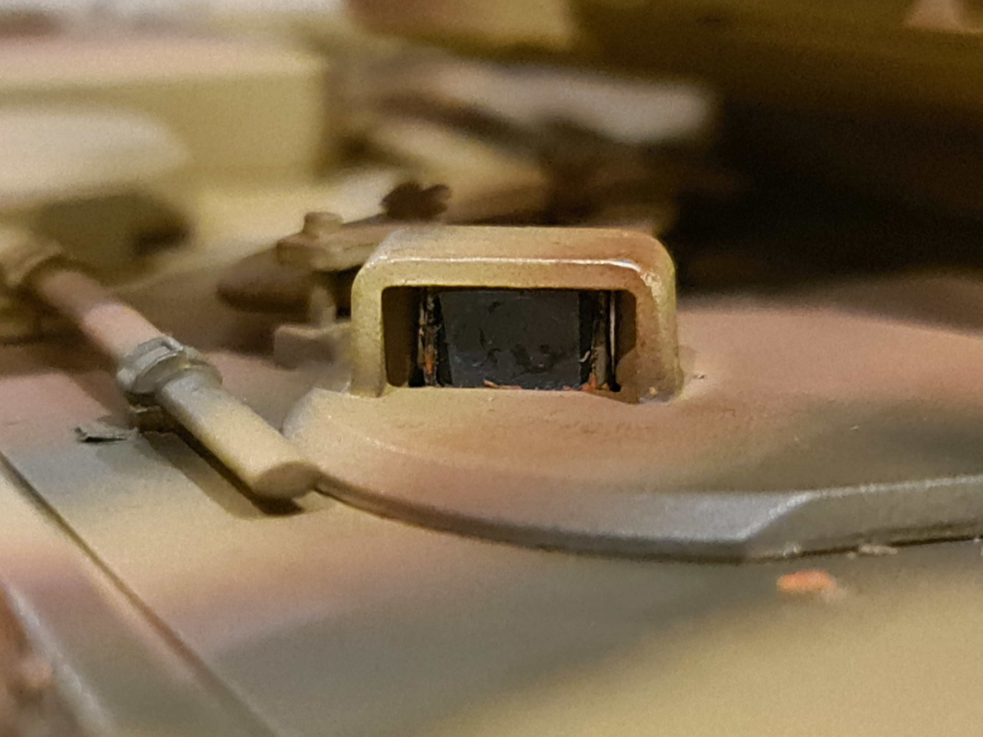

Evening all. Hope the weekend has been kind to you. Weather lousy today so the perfect opportunity to crack on with the Tiger build.
Based in advice from the community I've ditched both front hatches and bought metal Taigen replacements. They're detailed inside so look much better when open, and came with metal periscope. Thanks Welsh Dragon Models. They're now bonded in with CA glue and chemical metal epoxy compound. The glass is represented by clear plastic film from a food packet sprayed with Tamiya clear blue. Cut to size it's a decent

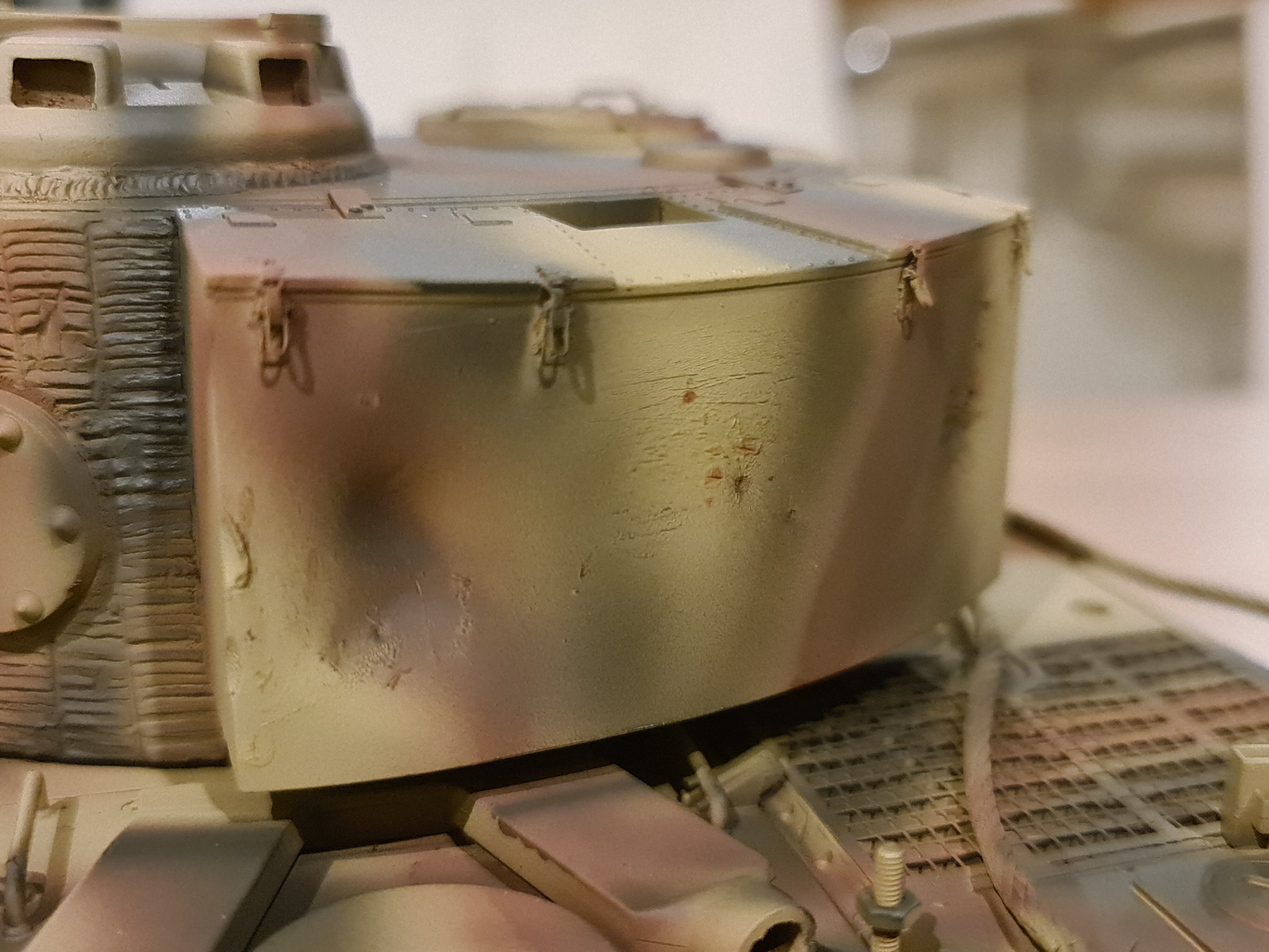

I've had a go at adding battle damage to the exhaust shields following advice about using a hairdryer. Unfortunately this shrunk and distorted the plastic too much so after a bit of a go at the left side where I managed to add a dent and bullet holes I got out the kitchen blowtorch which with careful use heated the plastic in a more localised way, allowing dents and holes to be made without distorting the whole piece. The same approach was used for the turret stowage bin. I'm reasonably happy with the result.
