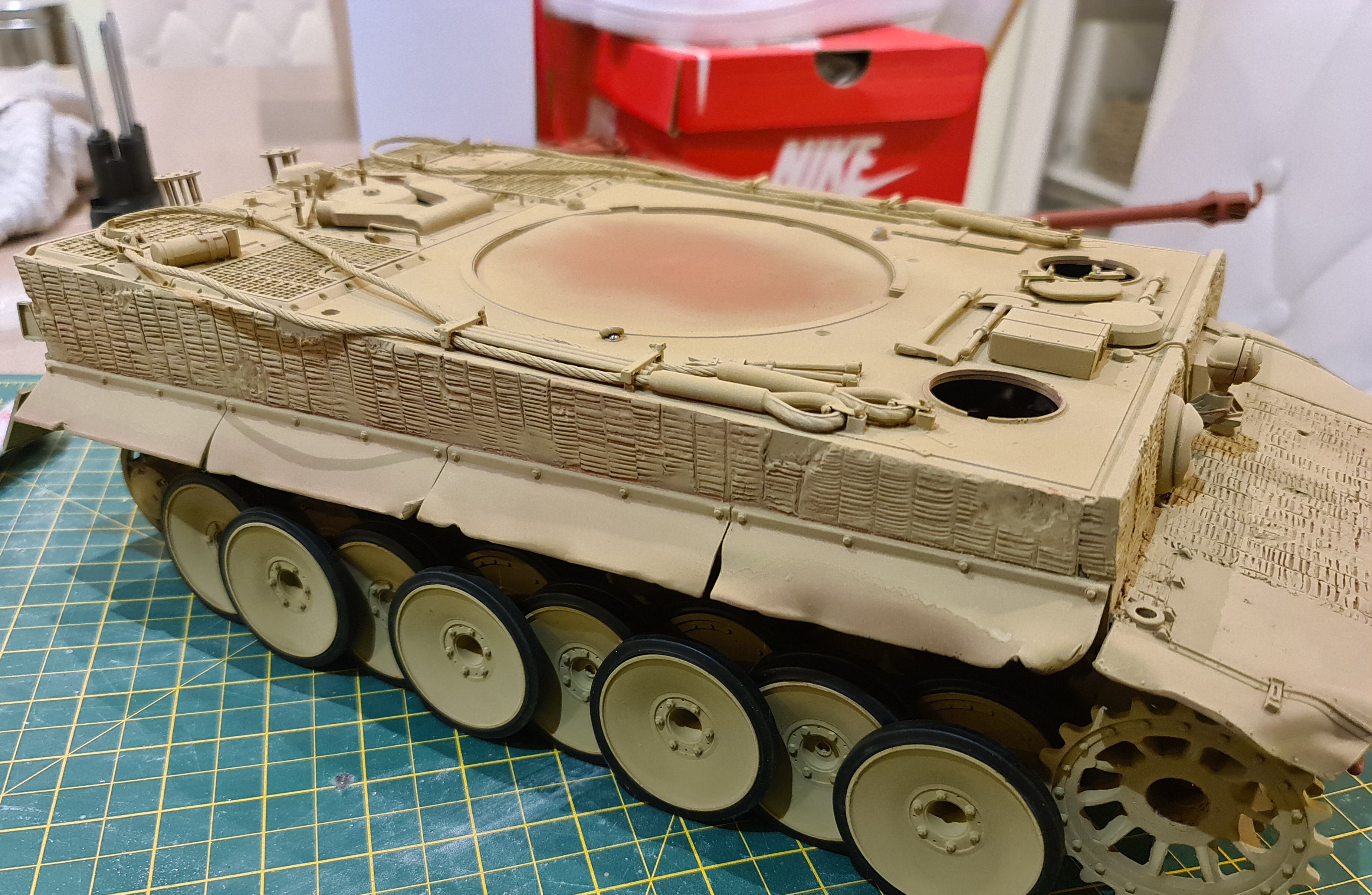

Progress update. After priming in red oxide I've applied 2 coats of dark yellow (Tamiya XF-60).
I'm really pleased with the track cable tie downs with resin wing nuts that I painstakingly drilled out to put on the threaded brass. Unfortunately I need 4 more for the rear clamps, which are now on order from E Europe.
So tonight onward with second base coat of dunkelgelb.
I also received 2 replacement Taigen metal hatch covers and periscope. They're more detailed with lock mechanism so I removed both of the current ones and once the paint has cured will fit them

Definitely 👍and thanks fir the positive comment. I'm going to give it a dark wash first to bring out details, then work on the damage.
I would appreciate some advice as to how to add creases to the exhaust fenders and stowage box. I felt the fender bending was quite risky using a lighter.

cmryanuk wrote: Thu Jan 18, 2024 10:11 pm I would appreciate some advice as to how to add creases to the exhaust fenders and stowage box. I felt the fender bending was quite risky using a lighter.
Nice work here. :thumbup: You're giving me ideas for my Mid war Tiger, but I have to finish my current Tiger and then the Kursk unit.
Hairdryer+needle nose plyers+flat nose plyers
There are several ways to achieve the bends and I don't even think mine came out that great but I did get some good advice from Mr. Bix for the holes.
Modelers of smaller scale will use a rotary tool and remove plastic from the opposite side to make the plastic weak for bends and creases that closer resemble metal. I tried it. One issue I had was that the Heng Long Cancer-Plastic is thick and it takes quite a bit to remove what I thought I needed to.
Using my wifes old Pro hairdryer that heats up like Hell with lots of mean pointy things allowed a more gradual bending. Just learn from my mistake, Do Not Let the Metal Tools Heat Up or they will leave uneven marks like you are branding it with a hot fire poker. If you heat the plastic gradually it becomes very easy to bend and contort.

Thank you MrChef, that's great advice. I'll try tomorrow.
Meanwhile I'm making the lightweight cable. I bought 0.8mm brass picture wire from Ebay which holds its shape. I've then cut off the end loops of the Tamiya plastic cable and drilled them out.
I've also encountered another problem: one of the swing arms has stripped a thread and I'm trying various ways to fix it. I'm trying gluing in a plastic tube from a cotton bud but it's a bit thick so I couldn't get the grub screw started. A bit more head scratching required here.
