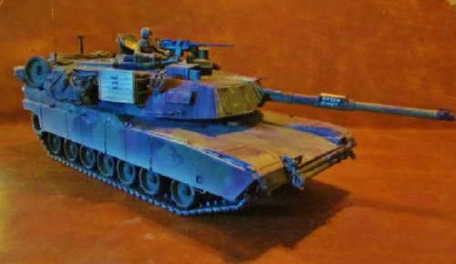

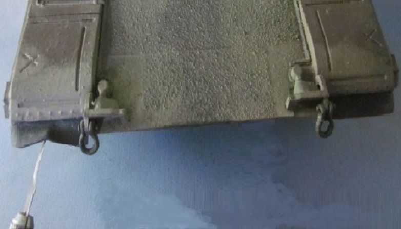

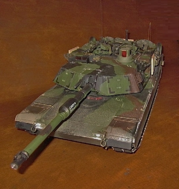

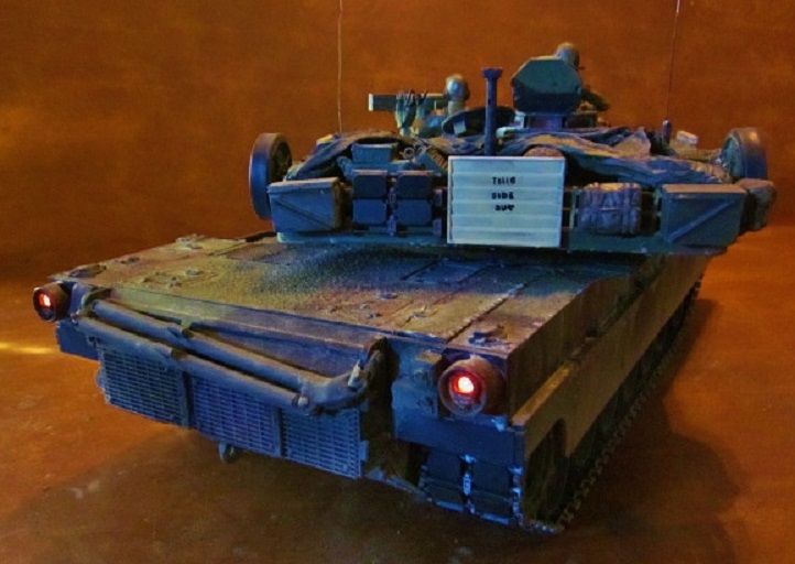

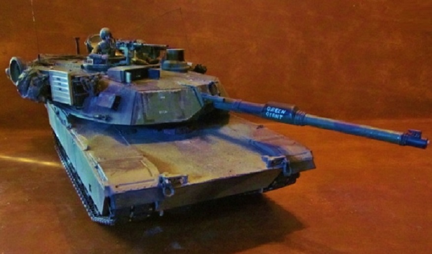

Some full view of tank pics with clevis's on front, tow bar on front ( the clevis's are used to hold the tow bar ), and with the tow bar in the rear.
I'm leaning heavily to the rear location so the clevis's can be seen on the front.

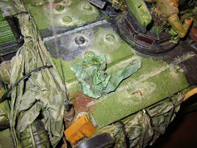

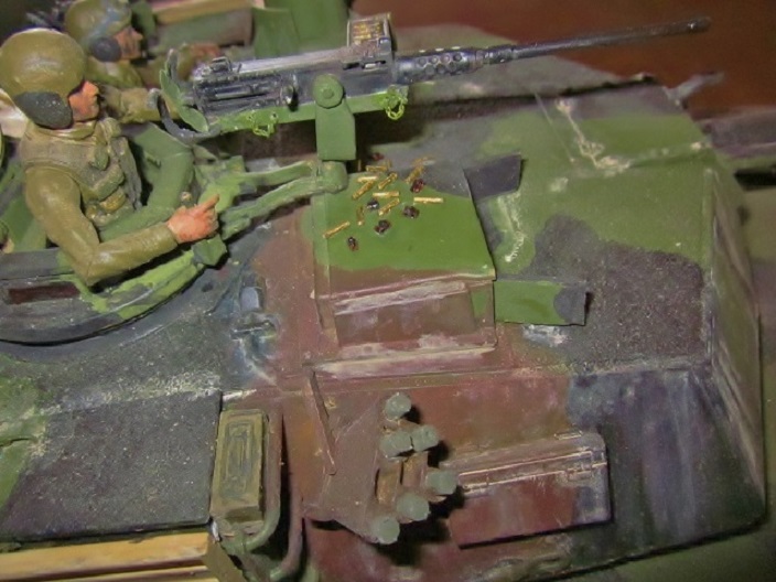

Last of details that I'll put on it for now.
Just had to show some kind of damage so I made the left rear upper hull skirt looked like it was ripped off. Something that from what I've read happened many times.
some spent 50 cal brass and cartridge links to make it loo like the 50 was fired. And gun mounting pins and chains
canvas 50 cal cover thrown on turret top

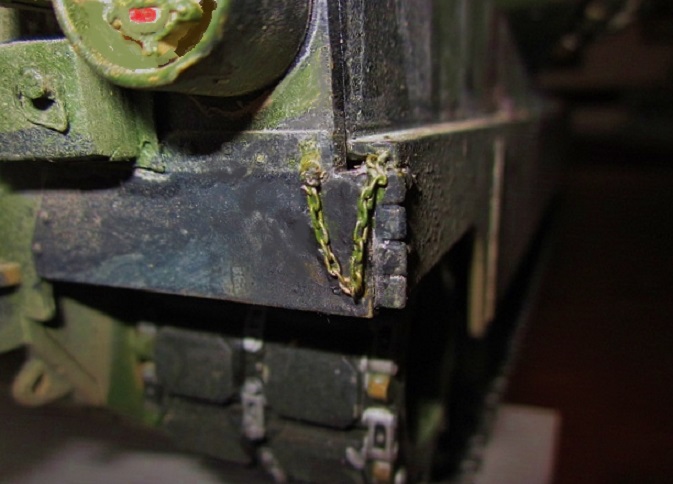

rear skirt panel locking pin chains

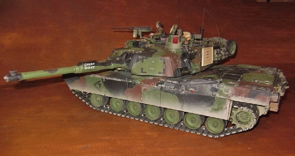

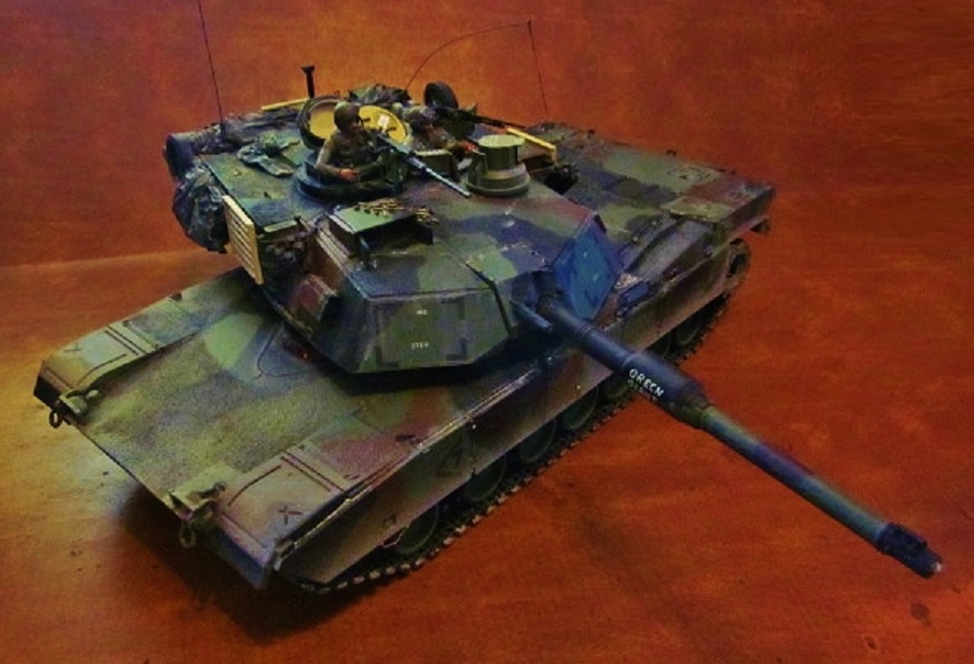

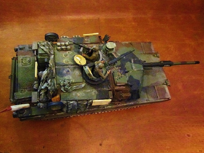

some more pics of completed model

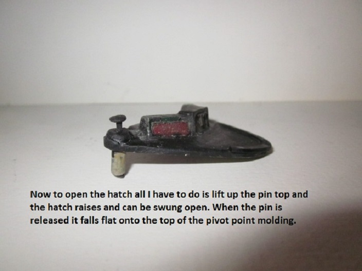

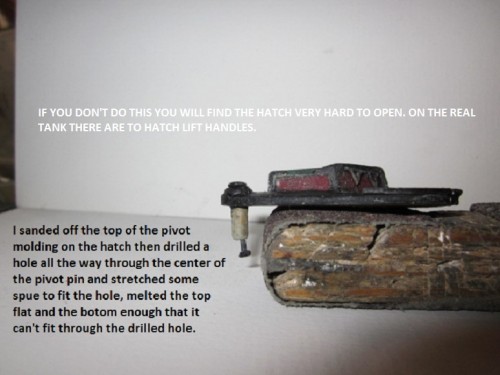

The line on the picture that shows how I made the pivot lift for the hatch should read that; there are no lift handles on the real hatch.
top view  ( tanks hooked up to battery charger )

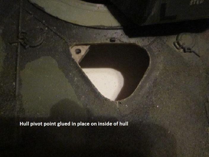

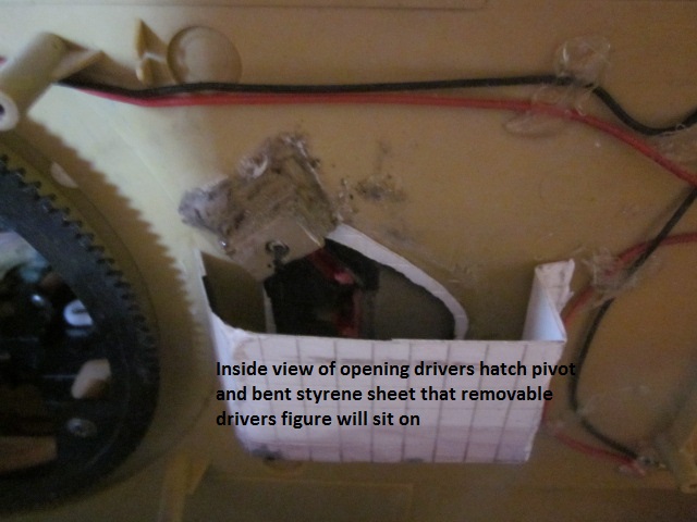

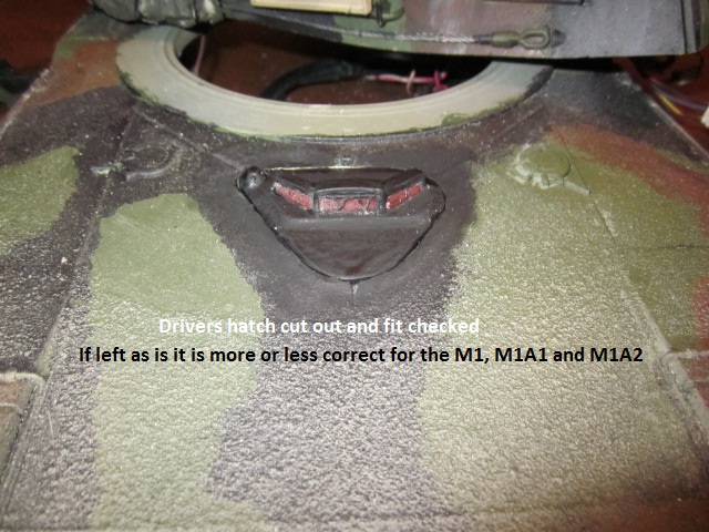

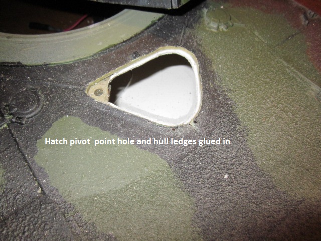

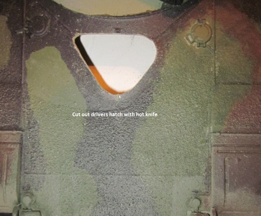

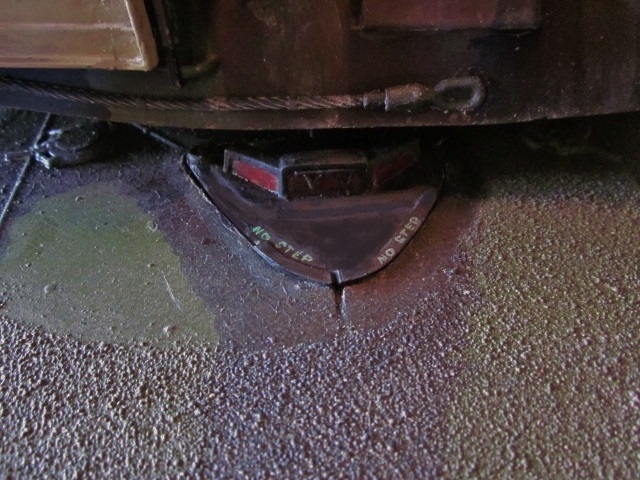

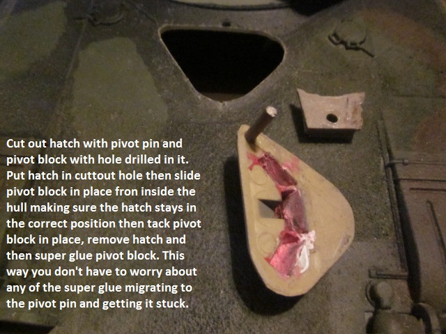

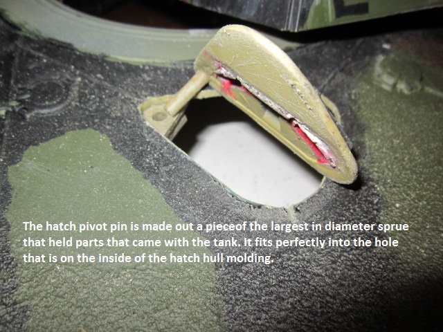

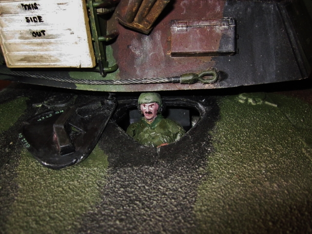

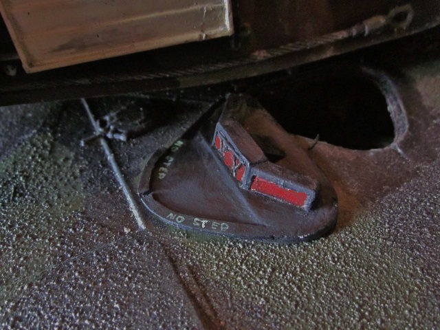

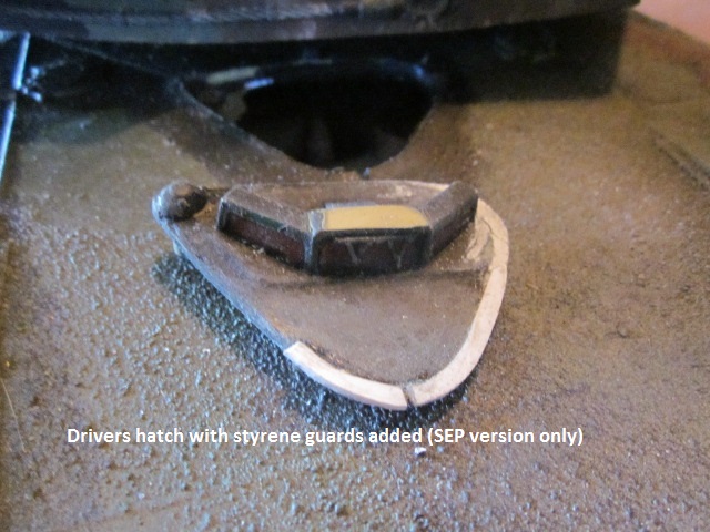

Decided that the drivers hatch should open and be modified to the SEP version of the hatch.
This could also help anyone thinking of moving the controls from the tank bottom to a hatch opening.
Abrams SEP drivers hatch 017.JPG (78.22 KiB) Viewed 4983 times
Abrams SEP drivers hatch 004.JPG (96.6 KiB) Viewed 4983 times

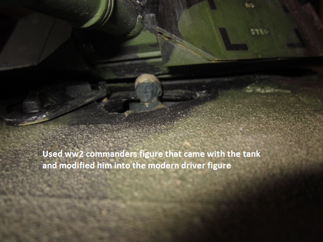

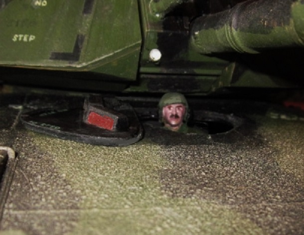

Some more.
when you get the figure in the correct position he just clears the bottom of the turret when rotated
Abrams SEP drivers hatch 025.JPG (96.31 KiB) Viewed 4983 times
Abrams SEP drivers hatch 019.JPG (85.03 KiB) Viewed 4983 times

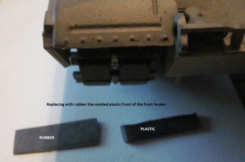

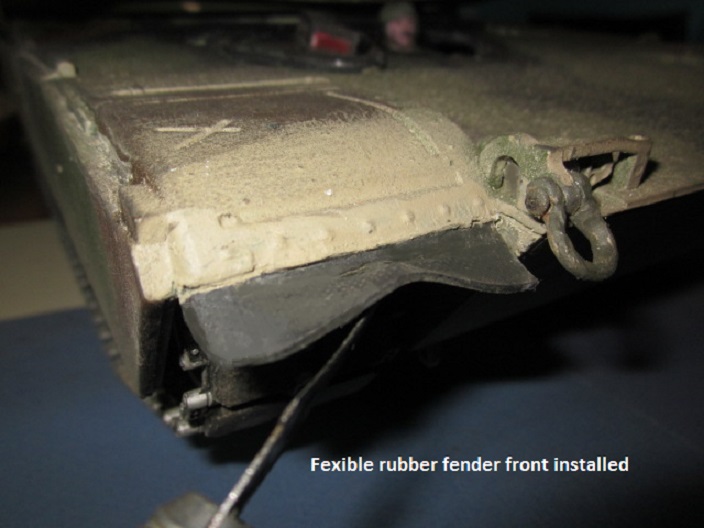

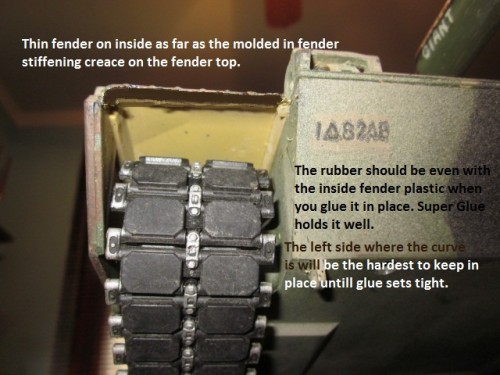

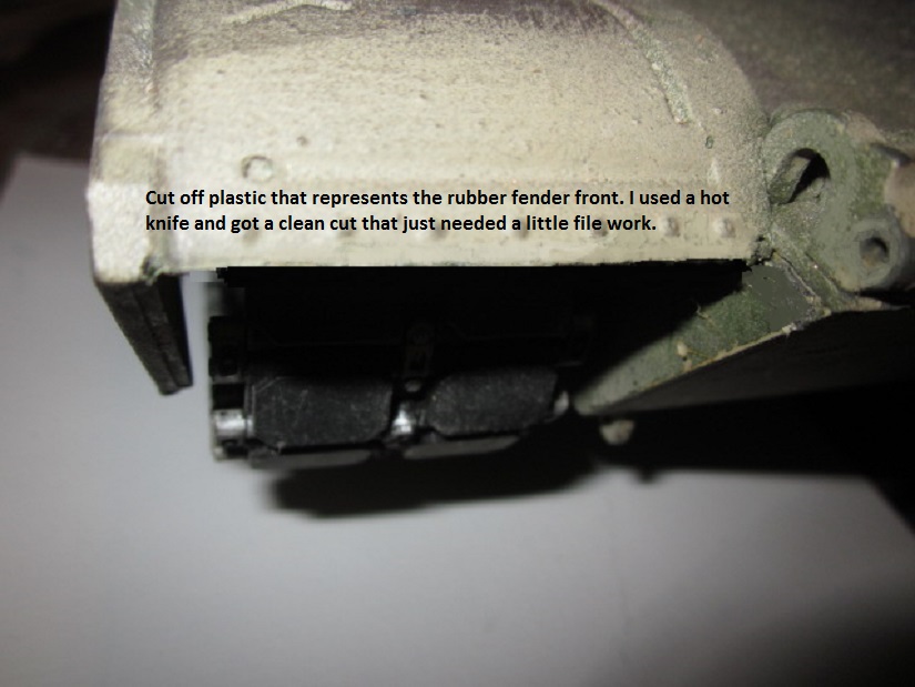

Decided to replace the molded plastic front fender mud flaps with rubber ones after I found an old car tire inner tube.

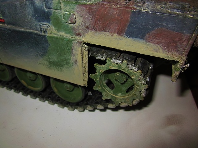

The rear grills are not molded through to the inside of the hull. Only the very top center is open to allow the smoke to come out. If you read through my build you will see a part where I made a deflector to direct the exhaust smoke downward so it appears to be coming more out of the molded in grill section rather then just straight back out of that top open slot part of the grill. If you do this leave just enough room for the thin smoker refill tube to be pushed in to refill the smoker.
The main place gunk can get into the hull is through the road wheel arm guide slots which HL allowed to go through the hull side. There are pictures and a description of how I covered them. Just remember that the arms on the right side have guides that are bit longer ( or the hull wall is a bit thinner ) then those on the left and the tips that extend into the hull a fraction of a millimeter must be sanded or filled enough that when you glue the covers for the slots on they do not rub on the covers which will cause the suspension to bind up.
