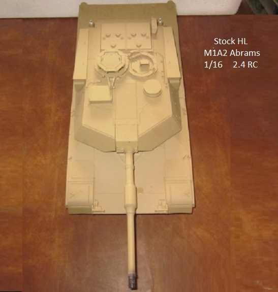

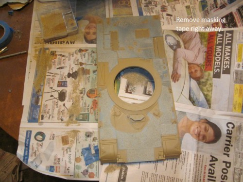

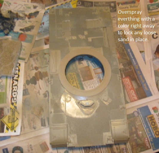

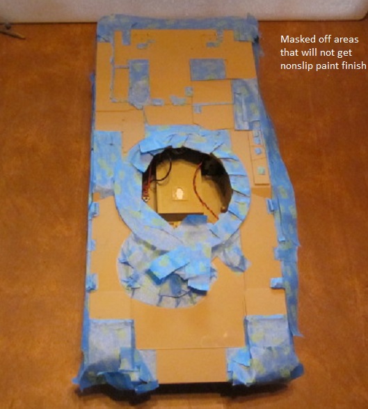

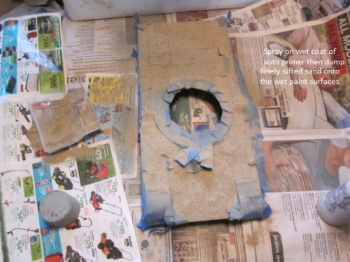

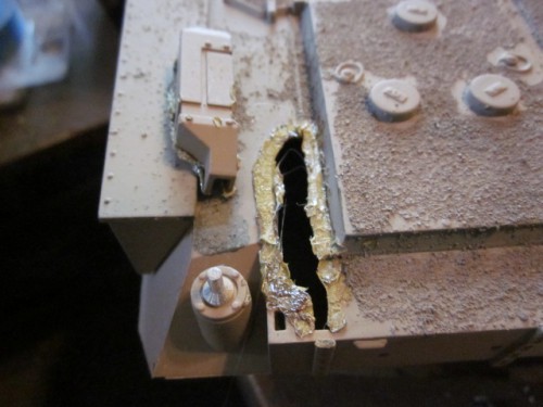

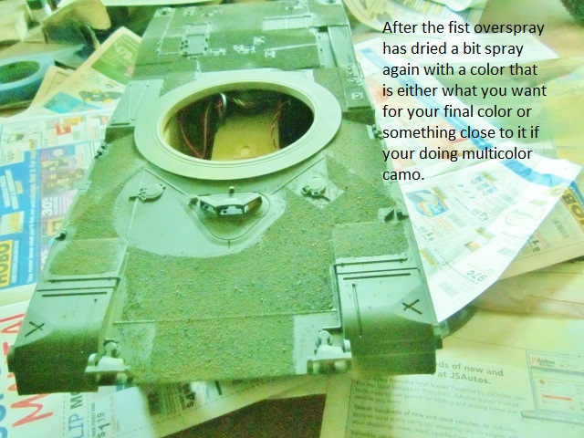

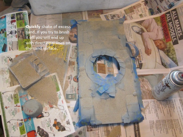

Received my HL Abrams a few days ago and have started to correct some things HL missed.
This first batch of pics are a way to get the nonslip surface on the tanks upper hull. All Abrams in service since the gulf war have this coating painted on.
I used sandbox sand that I sifted down as much as possible so I only had the smallest particles. It ended up a little thicker looking then I wanted but I think as I add more coats of paint that will diminish.
Tomorrow I will start to do the same thing to the turret.

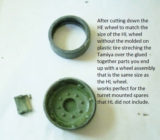

HL has more of the lifting and pulling plates in the right place but didn't bother to make the holes that should be on them. They also didn't bother to include any stowage items not even the spare road wheels that all Abrams have or a modern commander figure.

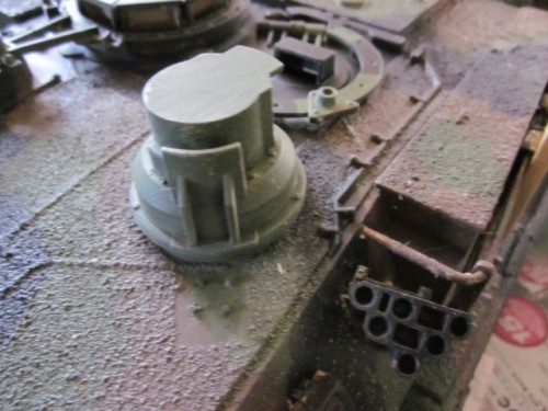

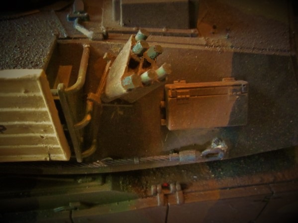

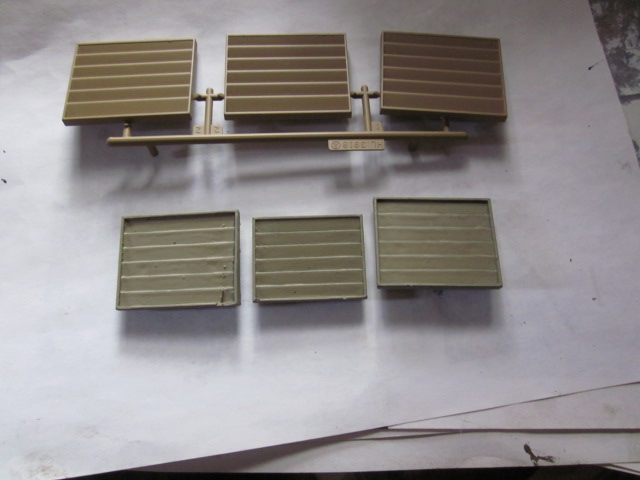

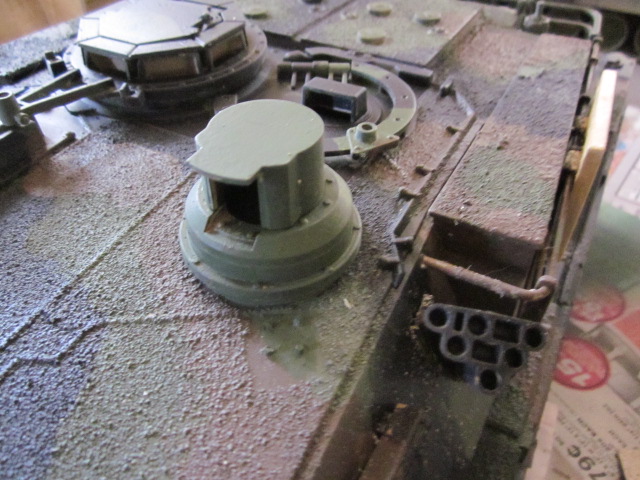

Have finished turret exterior.
Put the nonslip on like the turret hull.
Used HE ID panels as HL's are to large and only one size. (the rear one is really smaller than the side ones on the real tank)
Removed non SEP connecter for the APU.
Hade to reposition the grenade launchers as they point to much forward and not enough upward.
Made the commanders thermal viewing tower rotatable.

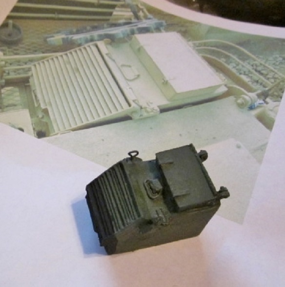

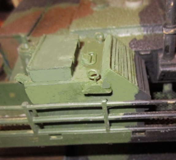

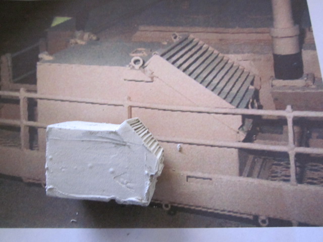

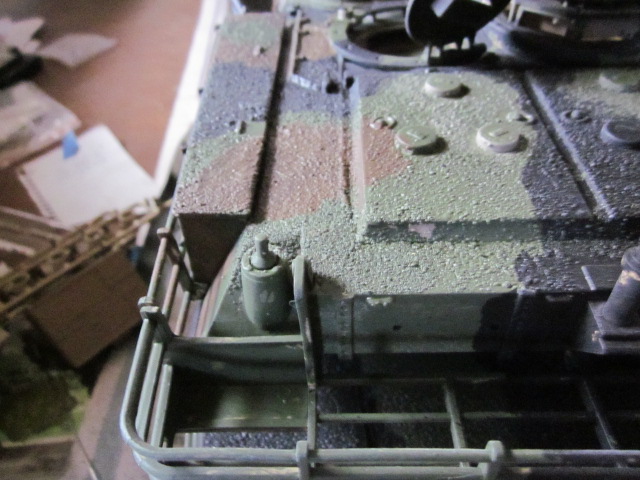

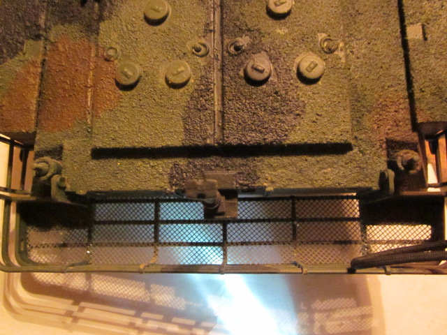

Built SEP model that replaced the old APU. It holds the condenser coils for the turret cooling system that is used to keep the newly installed electronics packages at operating temps.
On the real tank the connections to the turret are all located under th bustle and turret. The condenser for the cooling unit is located in the turret.
Added the mesh bottom to the turret bustle rack using fiberglass window screening.
- test fit of cooling unit
- 011.JPG (90.33 KiB) Viewed 11362 times
- almost complete still needs dome bolt heads
- 010.JPG (95.57 KiB) Viewed 11362 times
- roughed out the shape by cutting up the APU that came with the tank and covering with filler to be sanded smooth
- 002.JPG (91.2 KiB) Viewed 11362 times

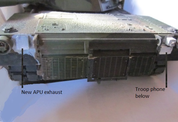

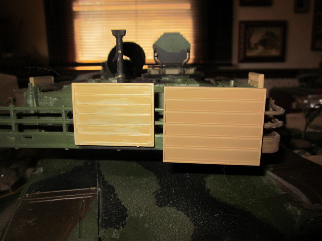

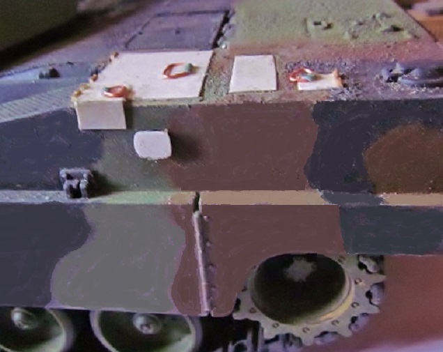

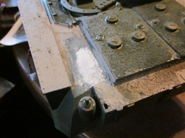

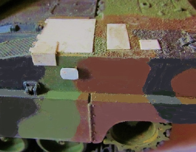

Did some work on the hull rear and the hatches on the left rear sponson that the SEP version has the APU located.

Wow you've done some impressive work so far, can't wait to see more!
If I may suggest something for the non-slip coating, next time perhaps try the fine sand that Woodland Scenics offers for model railroads. If the sand is so fine that it is correct scale for a 1/87th scale H.O. train layout then it should work perfectly to give the non-slip coating areas a nice texture while not having any larger grains of sand nor having to try ti sift down sand with screen. Just a thought.
- greengiant
- Posts: 1138
Re: HL Abrams detailing build
Thanks AT.
Jackalope great idea. I must have been suffering from brain fade to not have thought of that. What I have though is what I have and it is a little to rough for my taste. I may at some time have to remove what I put on an try the woodland scenic sand.

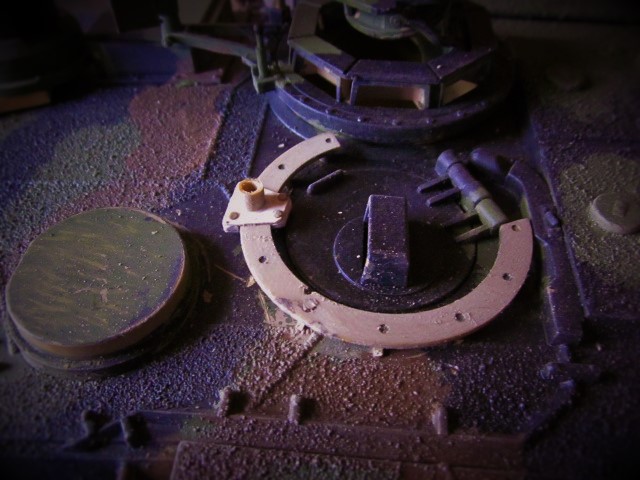

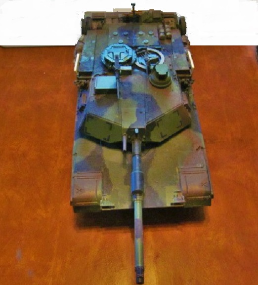

finished upper hull and turret exterior modifications except for some finer detail parts.
- HL Abrams M1A2 SEP Glass in drivers hatch and commanders thermal imaging tower Painted in Nato Camo.JPG (97.79 KiB) Viewed 11268 times
