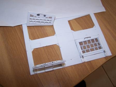

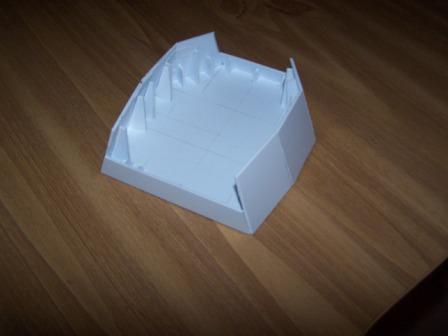

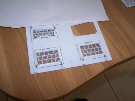

Sneak peek at the rear deck, almost done. After this it is off to the lower hull. I have a set of 3 to 1 gears and some drive wheels coming this week.

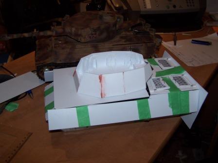

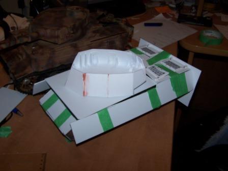

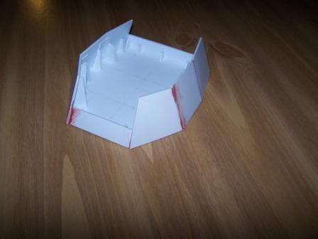

I can't contain my excitement anymore. Its coming together and I thought I'd tape a few slabs of plastic together to see if it looks like what I envision. I see lots of Panther and some Tiger.
Going to listen to some opinions and see where I go from here. I like what I see but I think their might be too much Panther in her. Tiger in the background is for a scale look.

Re: German Armour What If?
Thanks for the pics, looks like you could actually build that suspension in scale. I haven't tried that yet but I am going to pick up some brass tube tomorrow. Maybe I could use some springs from an RC car, stuff them in the tube and put a gear on a suspension arm. As the wheel rises it should compress the spring. You could control the travel by the size of the gear and the number of teeth on your compression shaft.
This would have been a game changer for manufacturing and certainly the "What If" I am looking for.
This is awesome stuff. Those German Engineers certainly did have some great ideas.

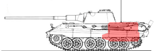

found another couple of pics that might help....this is a scale on ft shot of the suspension...the wheels are 800cm like the kt
here are some others I find interesting.......
this a motor placment shot.......
hope these help
hope these help
