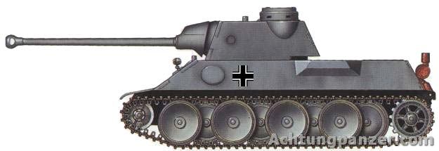

The picture of the failed Daimler Benz Panzer the VK3002DB is probably a good starting point, for the new design.

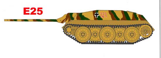

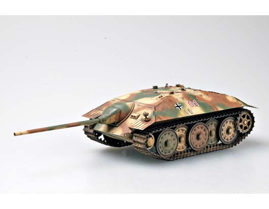

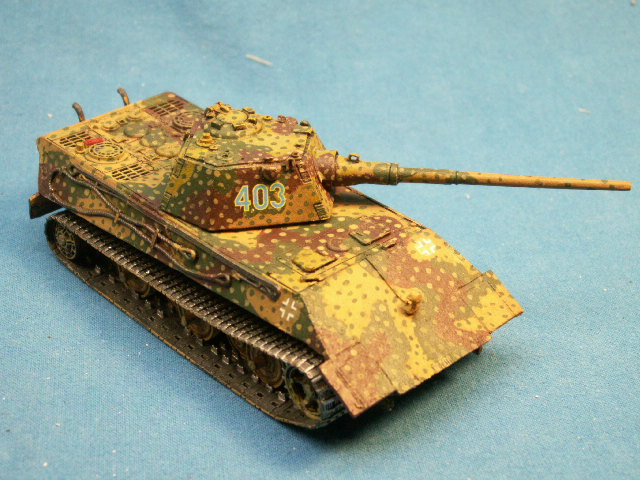

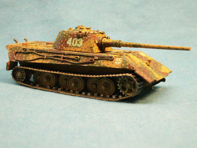

E-50 50 tons,,,Panther 75 mm or Tiger1 88mm gun or a new 75mm PaK made by Krupps and Skoda..

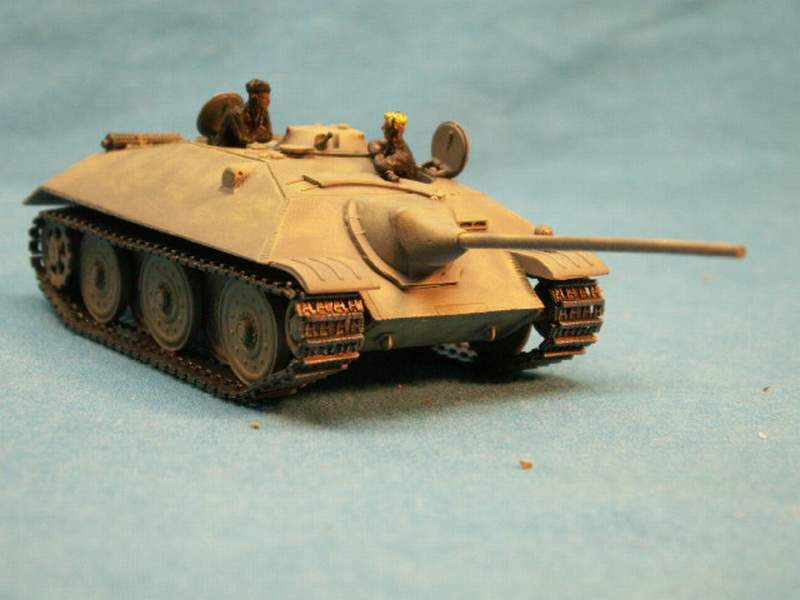

and the two small light tank destroyers....
E-10 10tons ( but combat weight nearer 16 tons) E-25 25 tons Is any of this of any use for a possible scratch-build

love the info on the posts. I think all the paper panzers are or have been built, no use flogging a dead horse.
Now I haven't seen the VK3002DB.I found a Porsche design that was similiar and based on the T-34 ( could be the same tank) I would go with the diesel as well for obvious reasons.

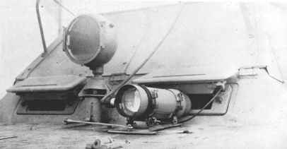

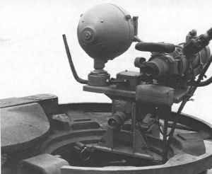

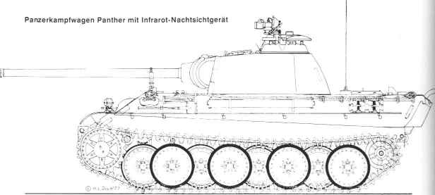

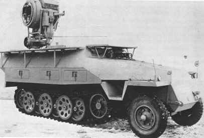

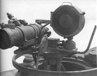

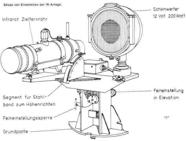

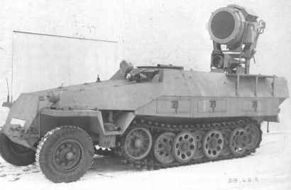

Hi Freakydude,
Here are all the pictures that I have of the > VAMPYR < infra-red system. The Panzers would be equipped with their own 'Search-light' good for about 600 Metres of visibility, but one of the support vehicles would have been a half-track equipped with a massive light to increase visibility to well over 1000 Metres. The lighting system and the gun sights were linked to the main gun elevation , so that the gun could be used in a 'Normal' way.
I have also included drawing of a German soldier equipped with a 'Man-Portable' system so that the assaults could be supported by infantry.
I believe that the Germans also carried out field tests with an armoured rear deck/ armoured open topped box, fitted to the Panzers, so that the infantry could actually ride ' With the Panzers ' and so supply direct support....it would also allow them to 'keep up' with the pace of the advance and to hopefully NOT get run over by the Panzers !
I hope that these photos and drawings are of help to you.
ALB
ALB

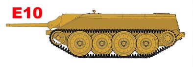

hi there
nice thought .. but the road wheels on all the E series armour are 1 meter diameter or 64mm
the king tiger wheeks are almost 10mm too small
http://www.rctankwarfare.co.uk/forums/v ... f=1&t=8096" onclick="window.open(this.href);return false;
iain
iain

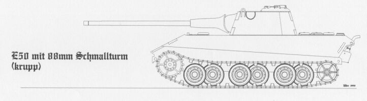

Re: German Armour What If?
that was for the e10, not the e50/e75mcevoyi wrote:hi there
iain
http://fingolfen.tripod.com/eseries/e50.html" onclick="window.open(this.href);return false;
It was decided that torsion bars were difficult and costly to make, and as the larger factories were getting bombed round the clock something was needed that could be simple enough to hand to small engineering concerns to fabricate under sub- contract. The new bogie carried 800mm steel rimmed "rubber saving" wheels from the Tiger II. This type of wheel is often refered to as "silent bloc". (A similar design was also seen on the late Jagdpanzer IV chassis, albeit a much smaller size. Also Spielberger vol 9: Der PzKfw Panther und sein Abarten pp 71 has a photo of a new Panther G at a showing for the top brass. In the background is a Hummel munitions carrier with six medium size silent bloc wheels, designed by Krupp. To the best of my knowledge this design did not enter service, nor have I seen any other photos of it) The wheels were mounted on geared swing arms suspended against springs made of simple Belleville washers held in tubes, with a hydraulic shock absorber down the centre of each. The suspension unit was designed by MAN of Augsburg, and was small, due to the high loading it could take, and easy to produce. The washers could be churned out on most stamping machines. The axles for the swing arms still needed machining on a lathe, but they were nowhere near the size of torsion bars. The complete bogie was refered to as "Einheitslaufwerk", or standardized running gear. A lesson learned from the American Sherman suspension was that none of the components was handed. The wheels straddled the track guide teeth, but the same length axles were used: the wheels had a bearing spacer on one side which could be reversed, setting one wheel in and one wheel out. An escape hatch could be fitted in the hull floor now, almost impossible with torsion bars. Mine damage would be much easier to fix as the complete unit could be unbolted and replaced, where as mine damaged and buckled torsion bars often had to be removed with a cutting torch, after the interleaved wheels had been removed first of course.
