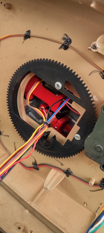

I unplugged the wiring from the daughter board and the MFU and separated the turret from the upper hull. I plugged things back in and fiddled with the wiring and the barrel recoil and flash started working...YAY!!!
So now on to the barrel elevation. I figured that a gear was not seated properly and the motor was OK because I could hear it running. I took the bottom off the turret to reveal the wiring and the elevation/recoil unit. (actually it was about this time I got the recoil/flash working). There are two screws that hold the unit together and one screw that holds the barrel to the recoil arm. When I popped the top (er..bottom?) of the unit all of the gears became dislodged. They are only held in place by pressure from the two halves...so be careful. I appears that the axle pin for the gear that rides on the motor's worm gear was no in place. I replaced all of the gears with their axle pins and reassembled the unit. I reconnected the wiring and with a little more fiddling with the wire I got the elevation to work. YAY! I then thought to myself "this isn't going to work when I get it put back together". I wasn't wrong LOL.

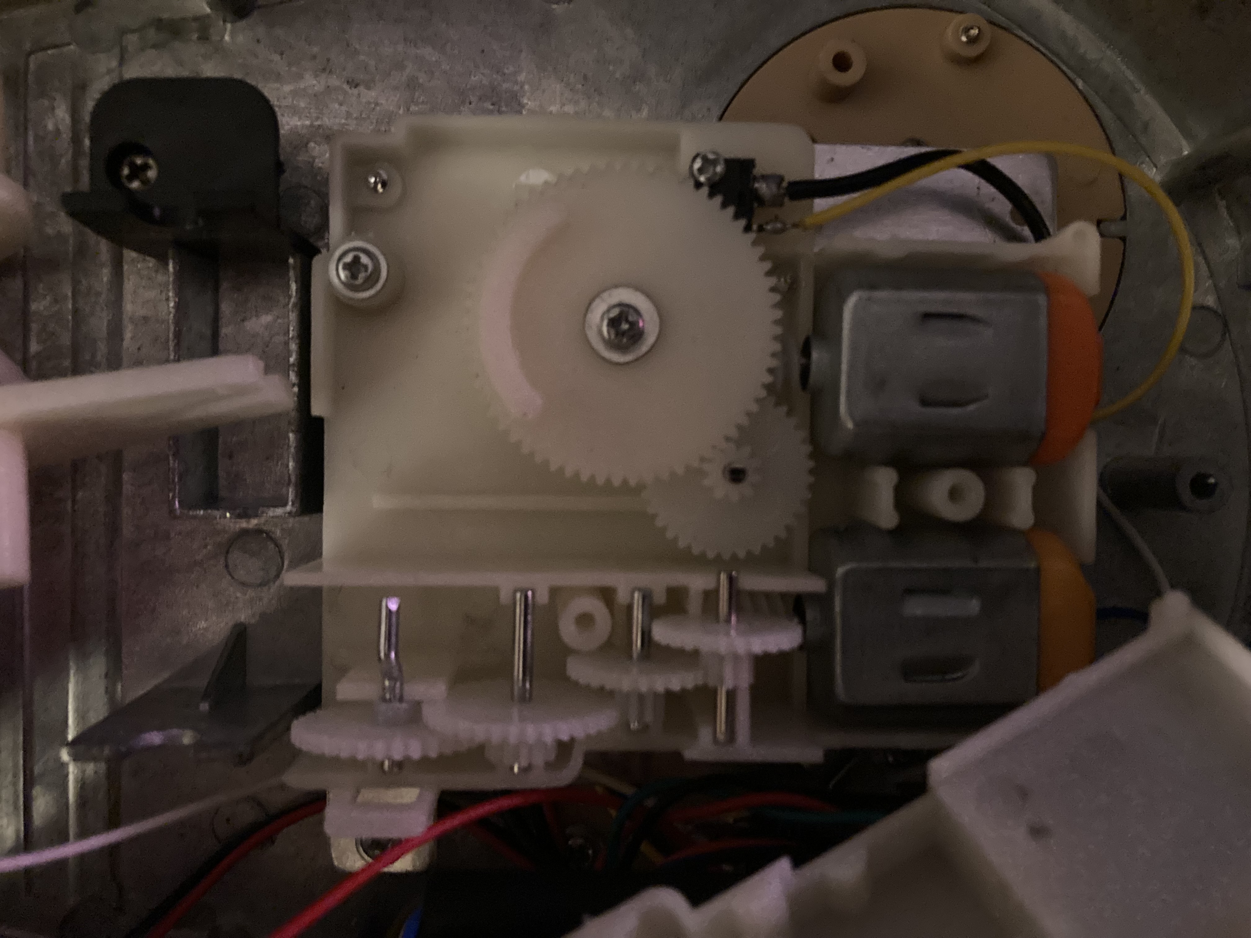

Here is the inside of the barrel elevation/recoil unit

The bottom gear on the left was the culprit. The pin must have slid out and was probably hitting the gear for the recoil on the right. For some reason that pin is not captured like the other three and probably worked it's way loose during shipping and handling.
There is also a pin for the smaller gear for the recoil. Mine stayed with the other half of the case when I separated them. These pins are a loose fit to the gears, so again, be careful when taking it apart.
Do the operation on a good work table and don't be like me and do it sitting on a couch. I had a tough time finding the pin for the elevation gear

Well I finally had time today to open the "Pandora's Open Box" special.
Function check revealed the only things not working was most importantly the cannon elevation then the smoker. I could care less about the smoker so I dove right in using Barmonkey's notes. Sure enough the motors were all working so I dismantled the elevation/recoil box. My issue wasn't the same gear but the same issue.The Top gear in his picture with the bent metal rod that attaches to the bracket on the end of the barrel that moves it had worked it's way off.
So carefully with his advice I opened up he gearbox and reset all the gears. I'm also amazed the gear closest to the motor isn't captured.
