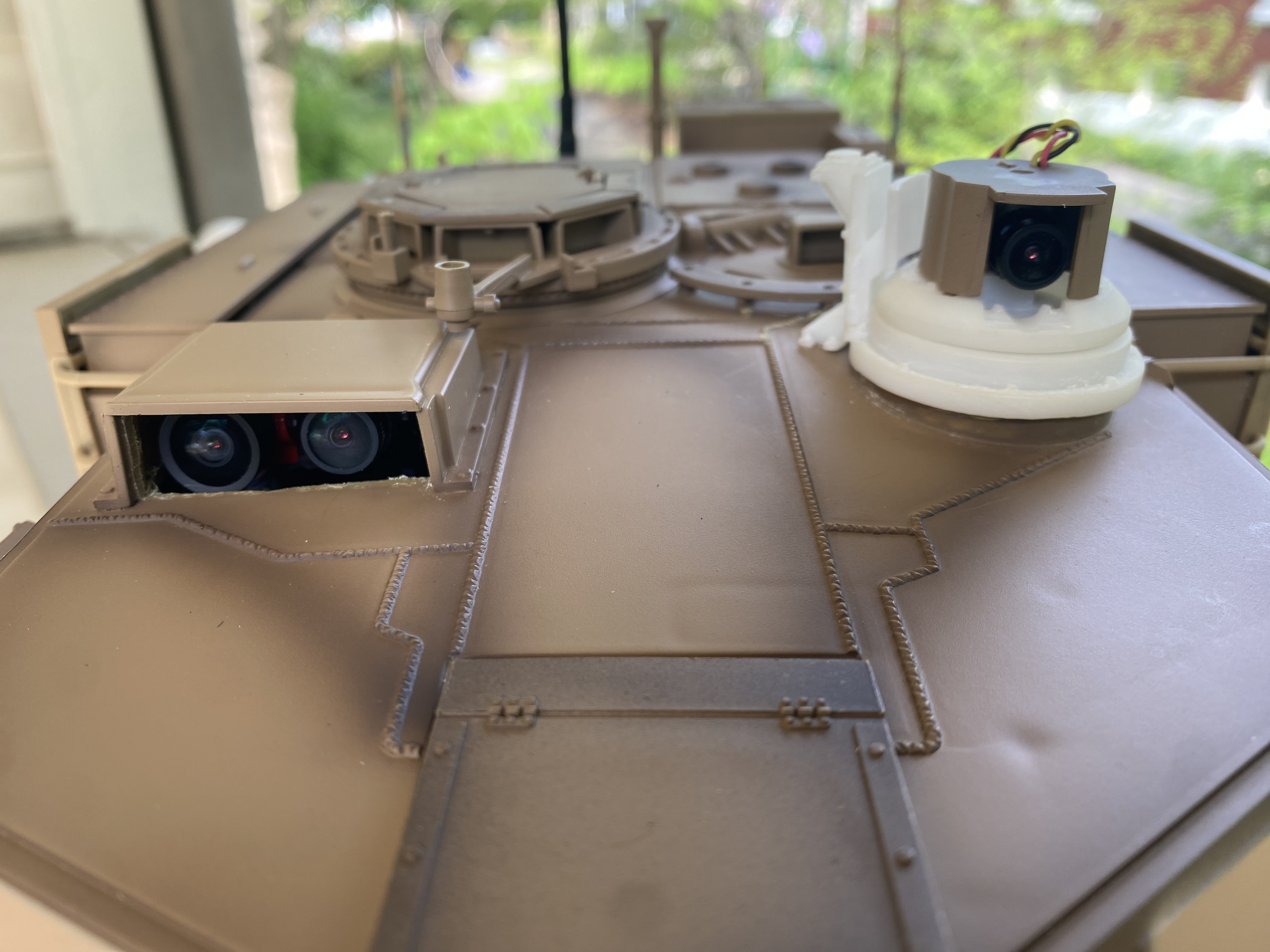

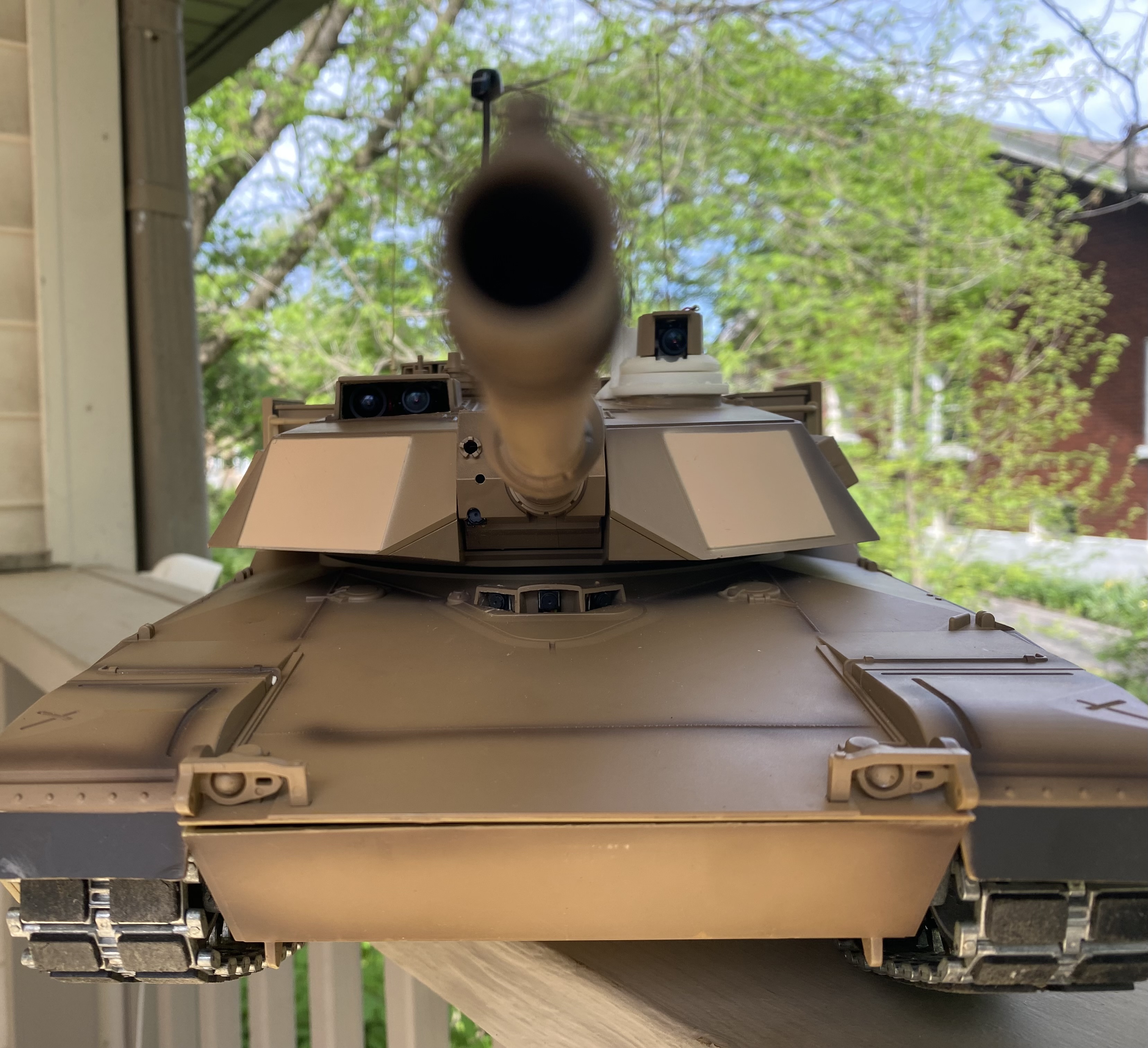

Also, I went crazy with FPV cameras and have not one but seven on my HL Abrams. I’m new here, so I haven’t had a chance to search to see if anyone else has done a write up on that yet, but I could, if no one has beaten me to it yet.

- The inside of my turret, you can see the FPV VTX (red with a fan on top), two 3 way video switches, and some of the cameras
- IMG_2229.jpeg (1.49 MiB) Viewed 4345 times
- Gunners auxiliary camera and drivers cameras
- IMG_2239.jpeg (1.22 MiB) Viewed 4345 times
- Gunners main sight cameras and CITV camera
- IMG_2240.jpeg (1.57 MiB) Viewed 4345 times
- IMG_2238.jpeg (1.45 MiB) Viewed 4345 times

"I went crazy with FPV cameras...seven on my HL Abrams." Wow! Are you able to switch among cameras as your M1A2 runs? Or can you watch all seven simultaneously? Do you make videos from the cameras?
Re: Heng Long Tank Mods and Fixes, ... especially those for the M1A2 Abrams
Yes, no, and yes. I did a brief look around and it seems like a lot of the people here that have installed cameras on their tanks are using the dinky things that ToucanHobby sells and installs on their tanks instead of what I would consider true FPV. I’ll try to start putting together a post on the what and how of this kind of a setup.

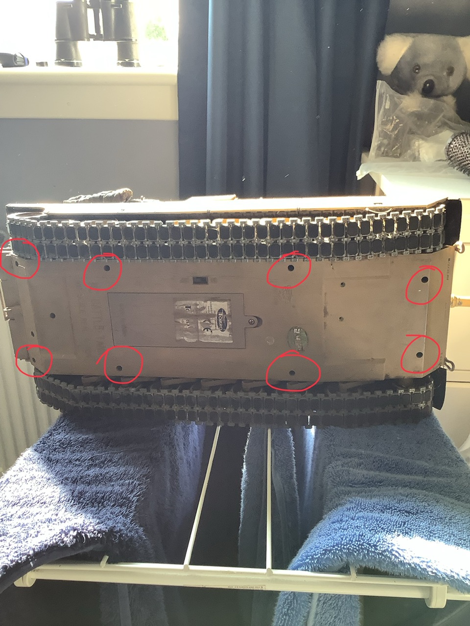

Are there instructions on how to open the tank to expose the internals?
The 6 screw holes at the bottom of the tank have some special sort of screws or bolts that aren't flat, cross or hex screws.

May be some pictures would help, showing the type of fixing? Mine has 8 fixings, all cross heads, highlighted in red. .
If this is new, then you are correct that sometimes the battery is placed inside, for customs reasons, as some companies, including the post office, do not ship batteries. The only other fixing I can think of, is they are Torx heads.

Hello, battery location circled in blue, but I think you know that? For the screws, you sometimes have to sacrifice a small screwdriver, in order to adapt it to the type of screw, sometimes, and with a bit of luck, you can do it with a normal mini screwdriver

Hey, many thanks for responding!Meter rat wrote: ↑Sun Mar 09, 2025 12:17 pmMay be some pictures would help, showing the type of fixing? Mine has 8 fixings, all cross heads, highlighted in red.
IMG_0794.jpeg.
Yeah, the store said they put the battery inside the chassis for customs purposes.
Sending some photos here...
The "screw" in one of those holes at the bottom (in your photo, this is the one in the top right circle)...
