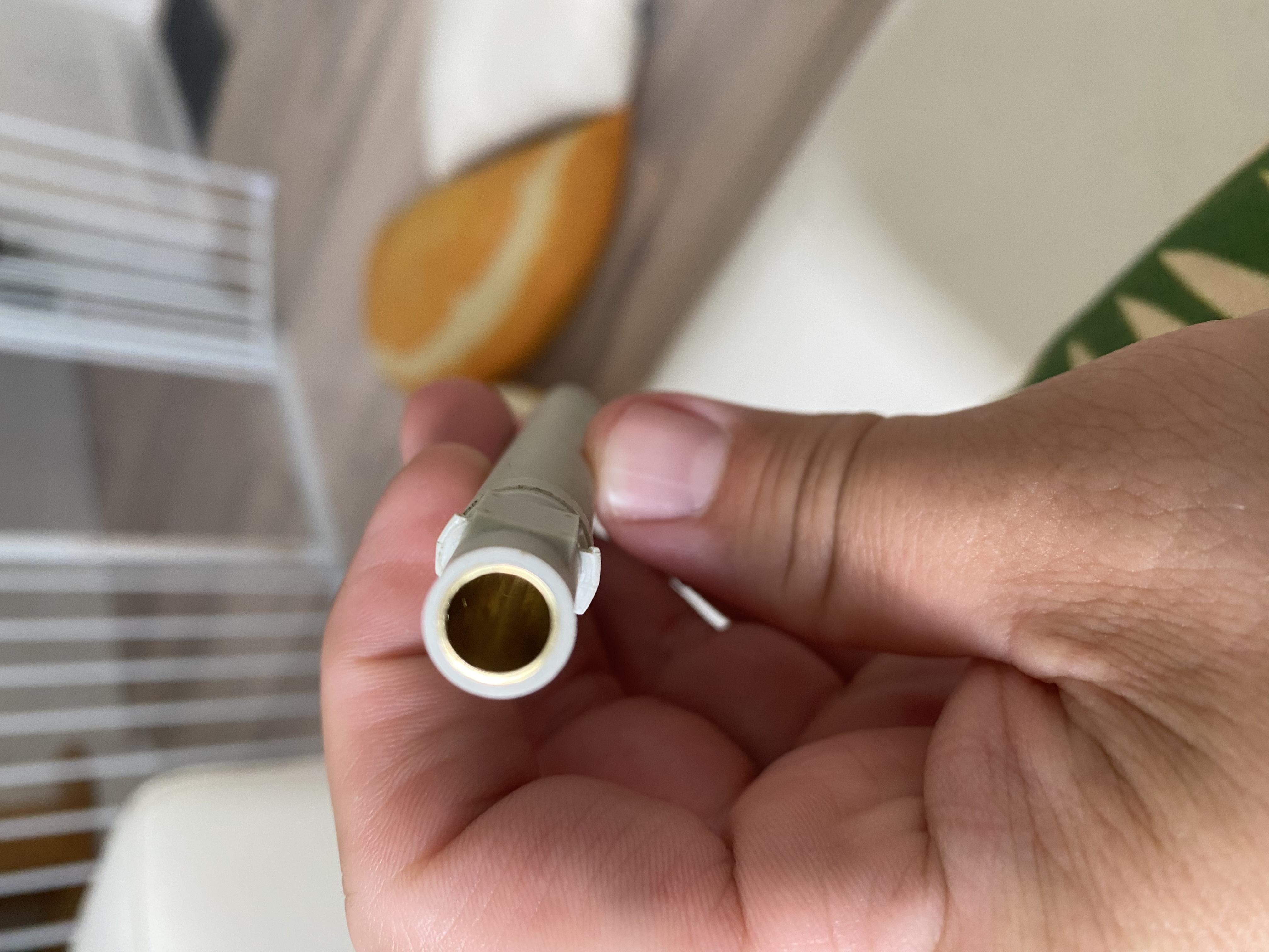

Anyone have any ideas on how to remove this metal tube from inside this plastic barrel? This is the detailed M1 Abrams gun from Specials Ops Models off of eBay. It looks great, but I want to use it for airsoft, and it comes in three pieces you have to assemble. Each piece has a brass tube in it, and to connect the three pieces you have to use a smaller diameter brass tube to act as a connector to join them together. So the Airsoft pellet would exit the unit into an area with a larger diameter, then a smaller diameter, then big, then small, then big again, then exit. I imagine this would play hell with the FPS of the BB.
I had thought to use a new tube where the OD of the tube matches the ID of the plastic part of the barrel (8mm), and the ID matches the OD of the Airsoft tube (7.6mm). This way I would have one long solid tube throughout the barrel, and then that tube would fit directly over the tube of the airsoft unit.
However, first I would have to get the old barrel out. This was easy to do for two of the three barrel sections by pushing the metal tube out with another 8mm tube, but this is not working for the tube in the final part of the barrel. I’ve tried whacking the tube in the final part of the barrel out pretty hard by essentially aligning my sacrificial 8mm tube up with the tube in the gun barrel by using the slight smaller connector tube to join them, and then trying to push that tube out by slamming it on concrete (I did try to be gentle at first), but the tube won’t budge. I also messed up the outside part of the barrel by putting it in a vise and trying to hammer it out, didn’t budge. So now I’m going to have to fix that.
I’m afraid that for whatever reason the other metal tubes weren’t glued to the plastic, but this one is. I have thought maybe using an adjustable hand reamer to drill the metal out by widening it?
Any ideas?

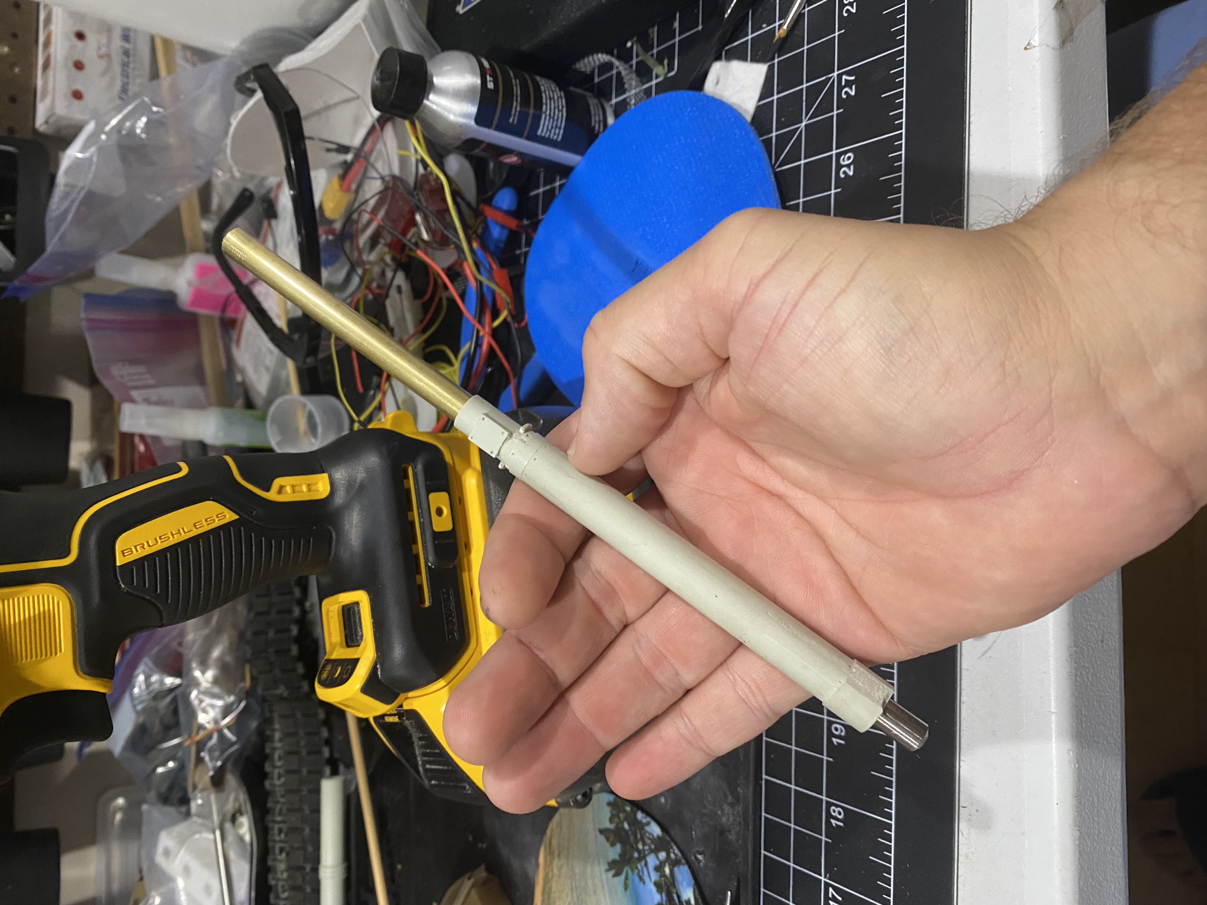

So I finally had some success today, so I’ll leave what I did here as this would be an actual tip/trick instead of me just asking questions (I just noticed the giant red text today said says this sub form is for posting tips, not asking questions, sorry).
So let me drop some numbers. The ID of the plastic part of the gun barrel is 7.9mm. The OD of the brass tube inside of the plastic part of the gun barrel is also 7.9mm. The ID of that brass tube is 7.2mm. The OD of the smaller brass tubes that are used to connect the three parts of the gun barrel are also 7.2mm. The OD of the metal tube on the Airsoft unit is slightly under 7.6mm and the ID is around 6.5mm. As a comparison, the ID for an airsoft gun barrel on a airsoft gun that shoots 6mm pellets ranges from 6.02mm to 6.04mm.
To replace the brass tube, I bought a stainless steel tube that has an OD of 8.0mm and an ID of 7.6mm. Although the fit of this tube onto the airsoft unit tube doesn’t have a lot of give in it (especially compared to the stock HL barrel that has an ID of around 7.85mm, so it wiggles a lot) it slides back and forth easily on the Airsoft unit barrel, making it perfect for this application.
I bought a series of 117mm long drill bits ranging in 0.1mm increments from 7.2mm all the way to 8.0mm in diameter. While the 7.2mm drill bit went completely inside the brass tube I was trying to remove, the 7.3mm bit went in a little bit and then caught on the tube. Instead of reaming it out, it began to push the tube out of the other end of the barrel piece. So I worked it out slowly until the drill bit was all the way inside that piece of the gun barrel.
At this point although the drill bit was all the way in, the brass tube was not all the way out. I grabbed the tube with some curved pliers and reversed the drill to get it out. I then slowly rotated the plastic barrel by hand, holding onto the brass tube with the curved pliers, and slowly worked it out.
Unfortunately the end of the barrel ripped off, but it doesn’t seem so bad that I can’t fix it.
Now, I took the 8.0mm drill bit and drilled into one of the more sacrificial sections of the gun barrel to see if it would fit. It did, about as tight at the original 7.9mm brass barrel, which was VERY tight. I decided to order a 8.1mm drill to see if it will make it a little easier to push the tube in without making it slide too easily. Should come tomorrow some time.
So if anyone cares enough about airsoft and gun barrel detail to do the same thing as me with the exact same product, this is a tip on how to accomplish this. I’ll be putting this and other things in my build log once I get that started.

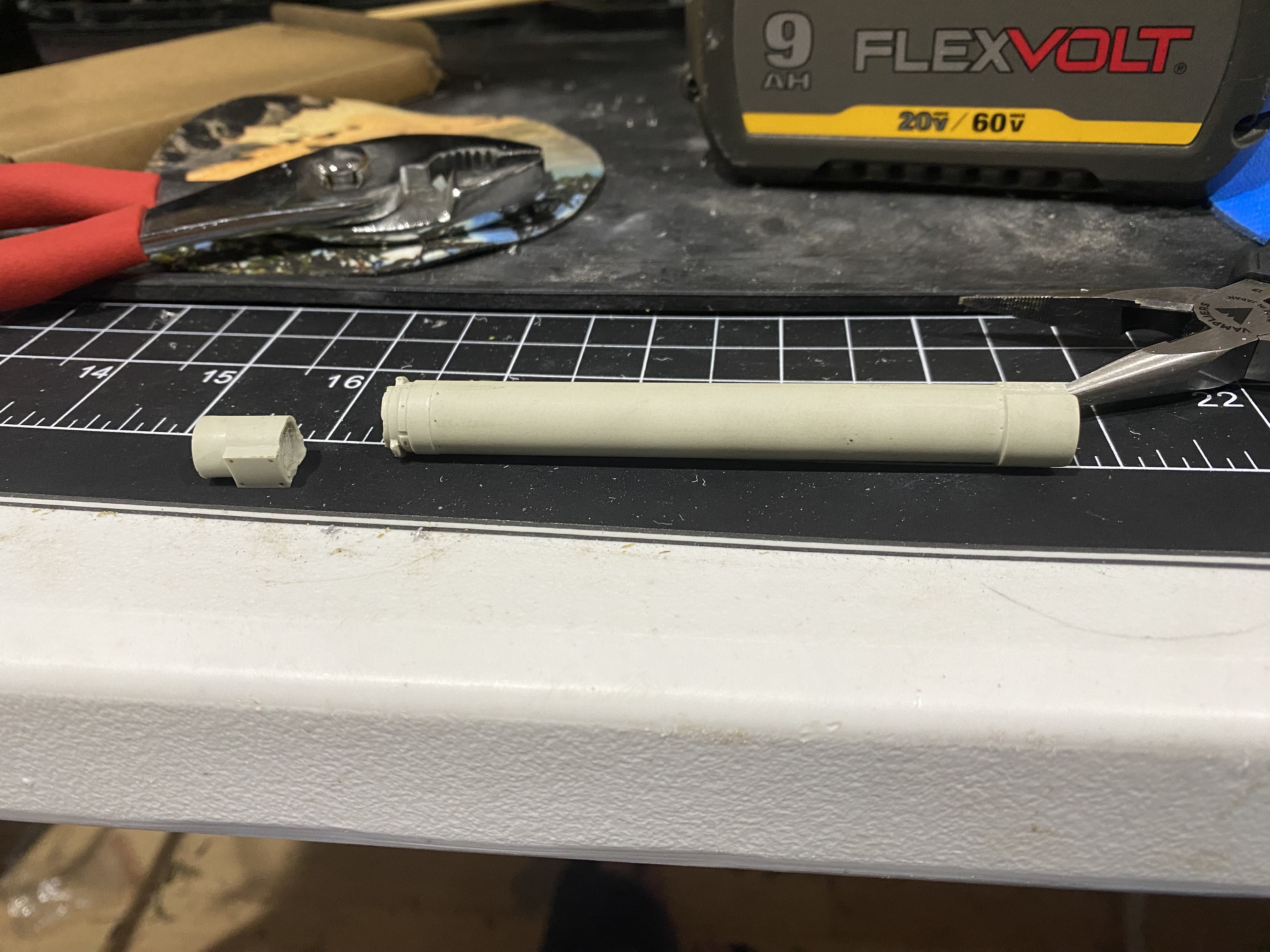

- Here is the result, the piece is stilll sturdy, so it should glue back together well, especially with the metal tube supporting it.
- IMG_3275.jpeg (2.34 MiB) Viewed 5140 times

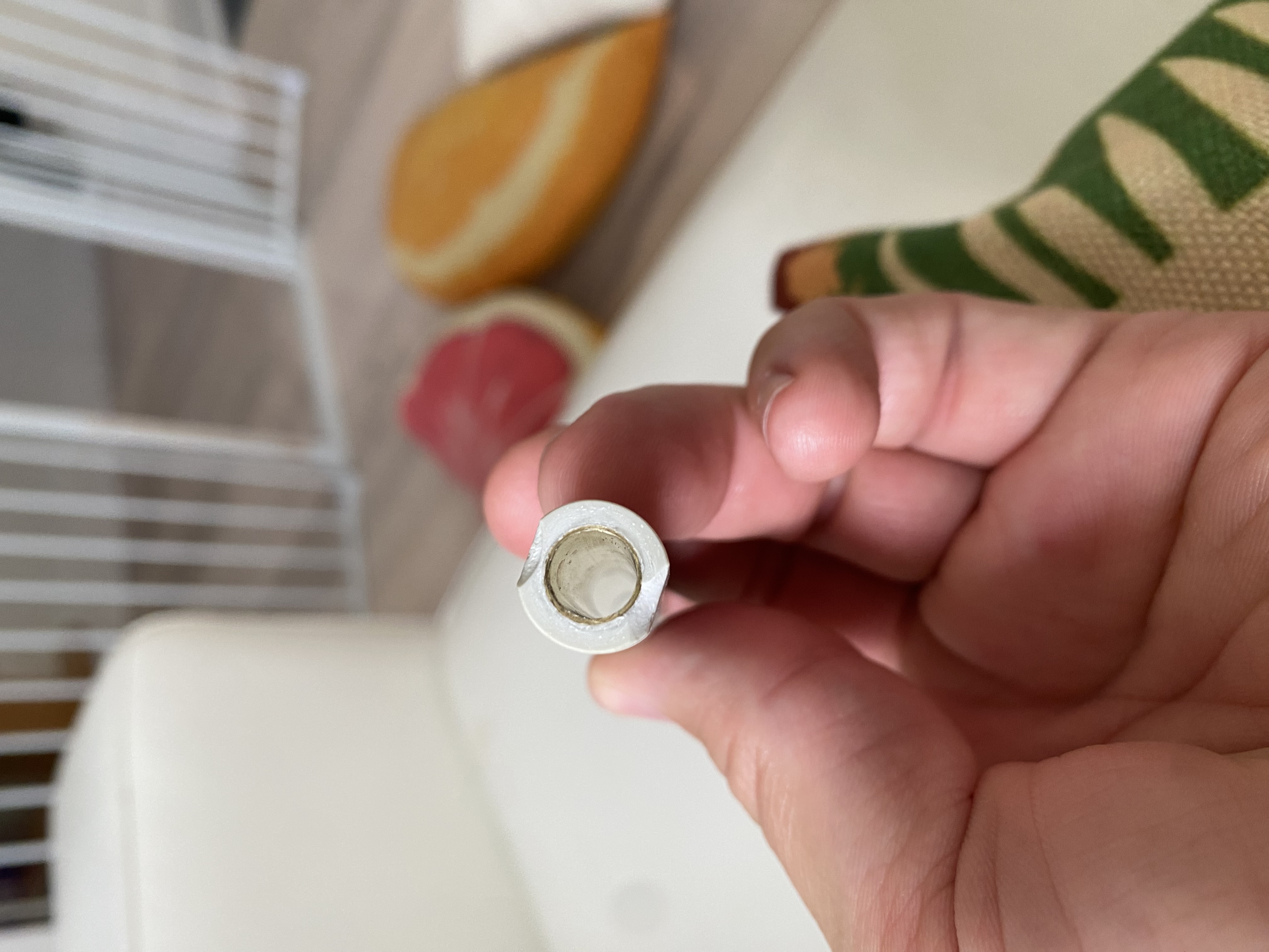

- Here is the drill bit stuck inside the gun barrel
- IMG_3274.jpeg (2.05 MiB) Viewed 5140 times
