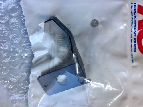

This tiny, and insubstantial, bracket is what has been delaying the assembly of the major turret parts. It's actually quite inexpensive, but very difficult to obtain...
colours..

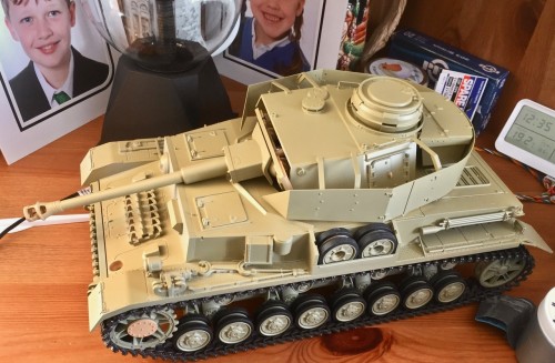

..and this is what will remedy the barrel droop on the wee beastie, seen in this updated shot of my Pz IV progress ..
Of course, although the exterior is almost complete, and has had one coat of Dunkelgelb (apart from the sprocket covers). It will eventually have three colour camouflage, and the accessories (shovel etc) painted in appropriatecolours..

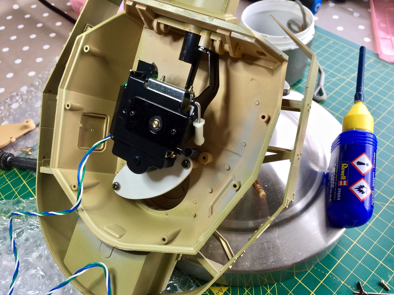

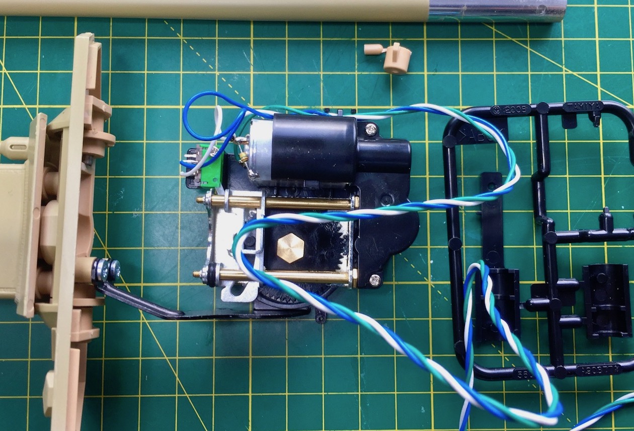

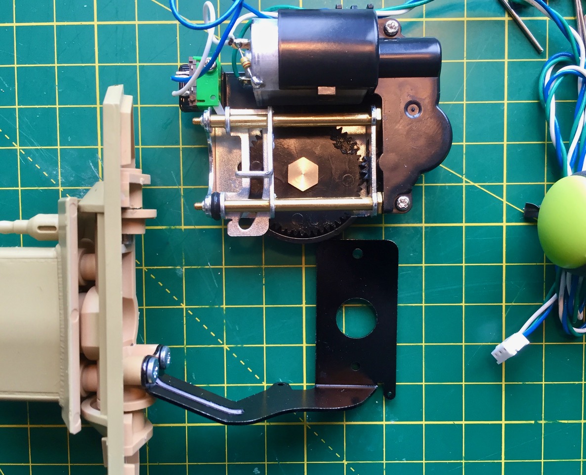

Back to the innards...
Now that I have the recoil bracket, I can fit the recoil and barrel, and then graft the whole assembly onto the front of the turret.
First the recoil bracket has to be fixed to the mantlet: The are the key parts of the Gun assembly: The two screws holding the bracket to mantlet are not fully tight. I've found that by removing one, it's possible to clamp the end of the gun (with a glued black plastic bracket), and wiggle it into position by moving the recoil unit slightly to one side to provide access. With bracket fully detached, you almost need three hands to steady the mantlet, hold the gun breech in place, and then screw the midge sized retaining screw into the recoil bracket; the one that holds the barrel in place.
That's why I prefer to have the bracket partially attached to the mantlet..
I put a drop of threadlock on the end of the minuscule screw that secures the black plastic gun breech to the recoil bracket. In the process, it also grabbed a bit of my woolly jumper. Och well... Note the absence of a Flash cable sticking out of the breech. That's because I've not yet decided I'll go down the full Tamiya electrics route...

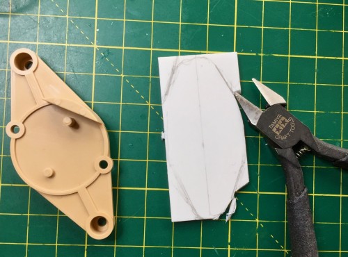

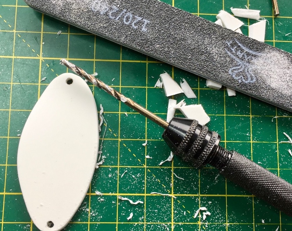

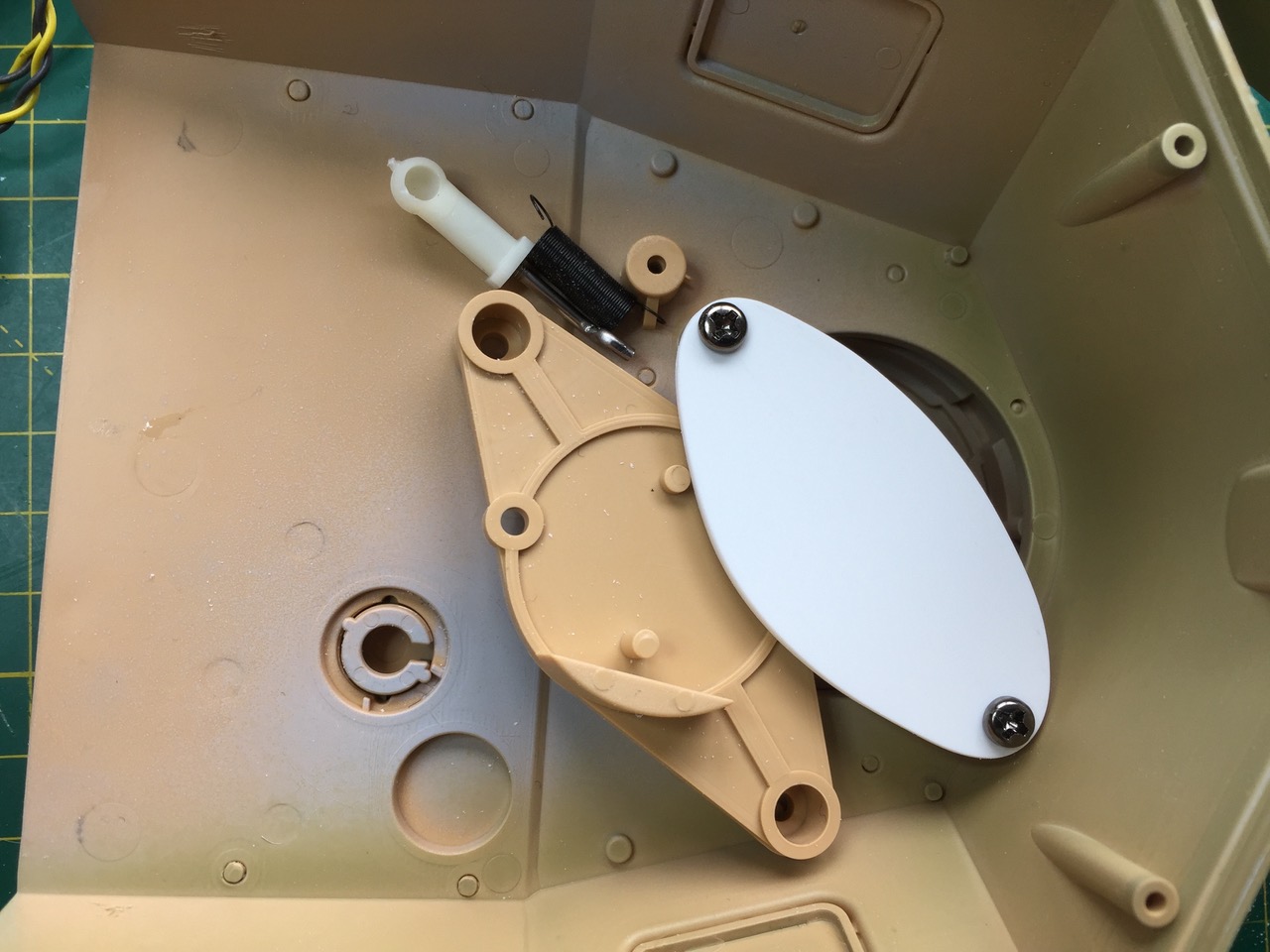

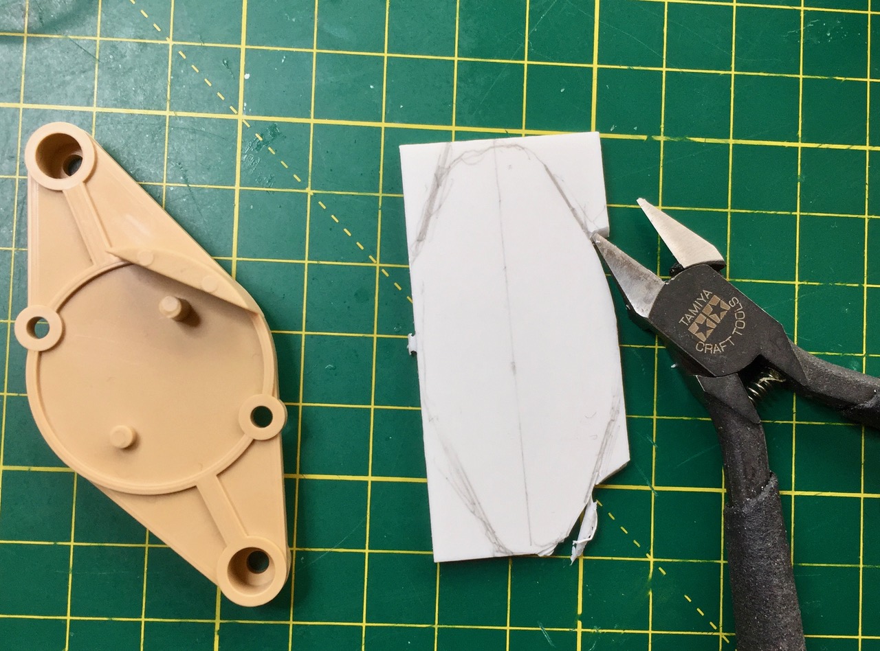

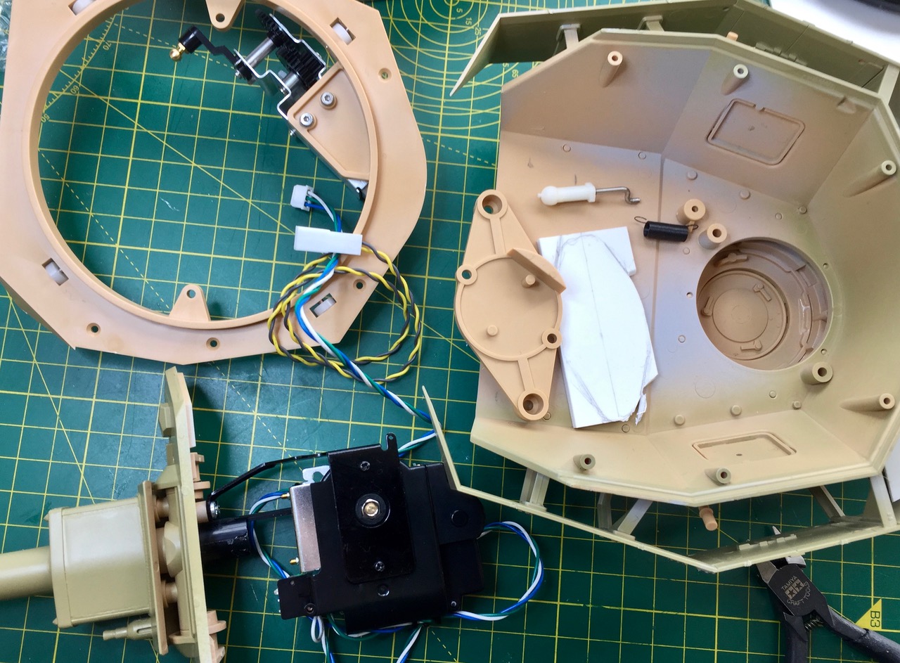

These then are the key constituents of the Turret itself. Note the white piece of styrene on the right. Normally, in a Tamiya kit the turret has two option supports for the space where the commander will 'sit'/ 'stand' (with his scary half torso..
). There's one oval plastic part for non-battlers, and another for the battle option. In this instance, I have neither, since these particular parts were in a bag I didn't (or couldn't order). Next to the styrene, there's a battle part from a Tamiya Panther, just to give me an idea; as I'm going to have to make my own part for the Commander to plonk his non-existent a*se on..
Now, after a quick recce, I've marked the styrene out:
. If you ever have toenails like kevlar, these Tamiya side cutters are very sharp, and up to the job
- 43rdRecceReg
- Posts: 6295
Re: Contemplating a Panzer IV build? Then...
Nothing fancy, but the plate is a perfect fit..that's what counts.

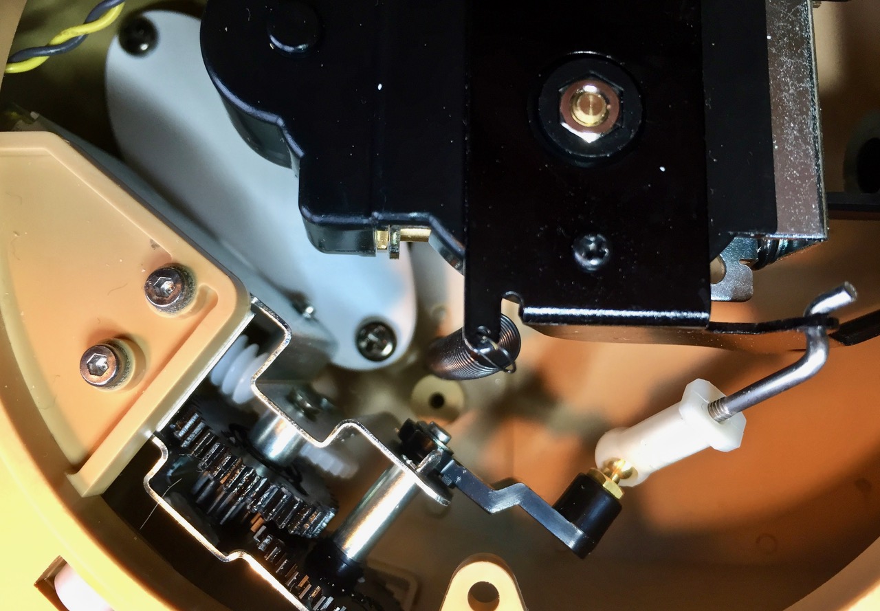

Now that this part's out of the way, I'm able to glue the whole gun assembly and turret front plate in place:

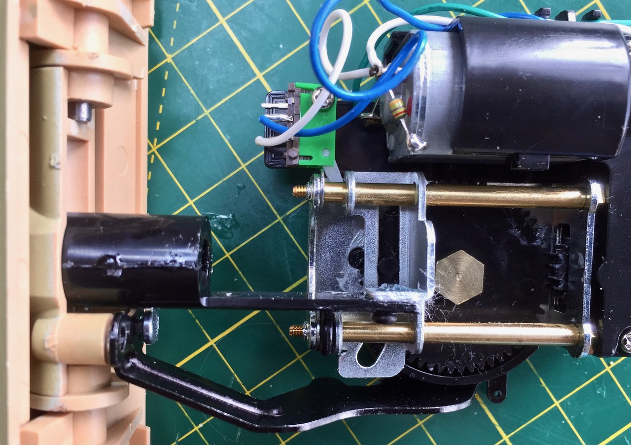

With that in place, it's necessary to fix the recoil assembly spring to the roof of the turret. That can be a tad fiddly, especially when it then has to connect back to the recoil bracket...and it's usually worth at least three serious expletives
Also, at this stage the white (ball and socket) elevation lever has to be looped through a wee hole in the recoil bracket. Then...when the turret floor/elevation unit is finally screwed in place, the elevation lever has to be pressed onto the brass knob (ball) of the black (cheapo, apparently) elevation arm of the elevation unit. This can also generate a few choice curses.
Finally they're both in place: I must say, the angle of the arm looks a bit extreme, but then I didn't design it. Let's hope it doesn't detach itself, like knackered hip, under moderate loading..

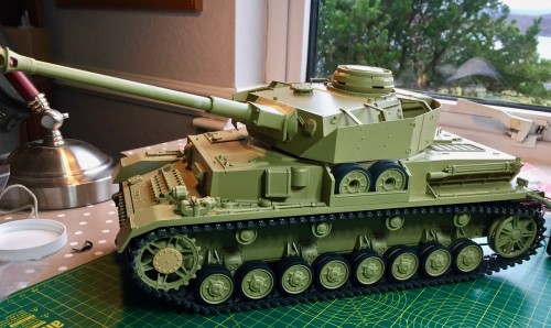

..And following on from all that, the exterior of the tank is now actually complete! Complete apart from camouflage, decals, weathering, and some cables made of cheap string , that is..
Here's a visual progress update As usual, Click to ENLARGE : Oh, as an incidental. Generally, I'm vary careful with things and I don't like them to break (except eggs over a frying pan). BUT, I dropped the turret the other day, and much to my surprise, it bounced and nothing broke off it...not even a wee bit of schurzen.
Perhaps I was wrong to think Tamiya hulls and turrets really too fragile for robust treatment
