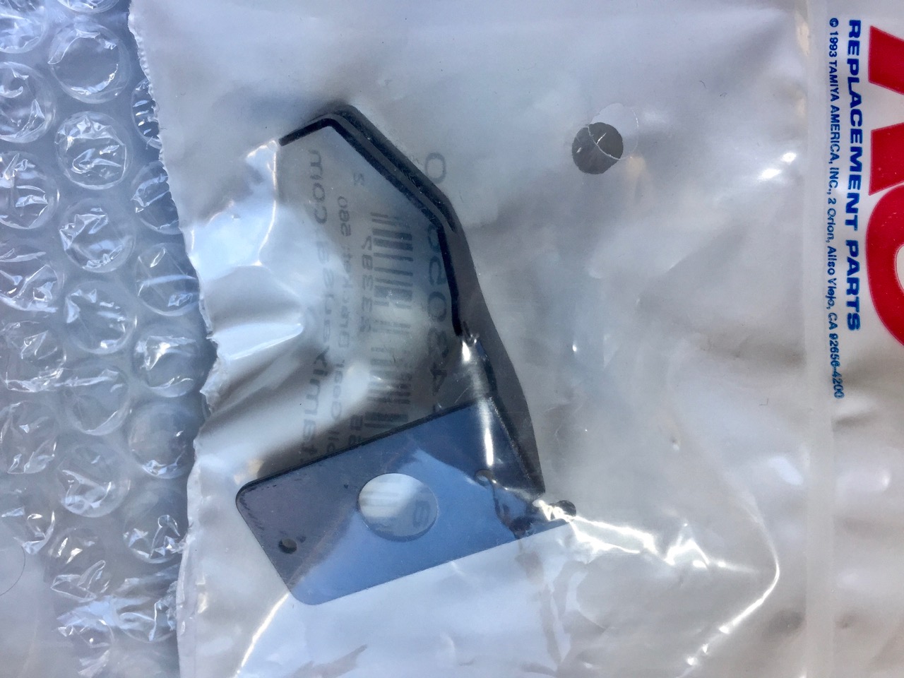

This tiny, and insubstantial, bracket is what has been delaying the assembly of the major turret parts. It's actually quite inexpensive, but very difficult to obtain...

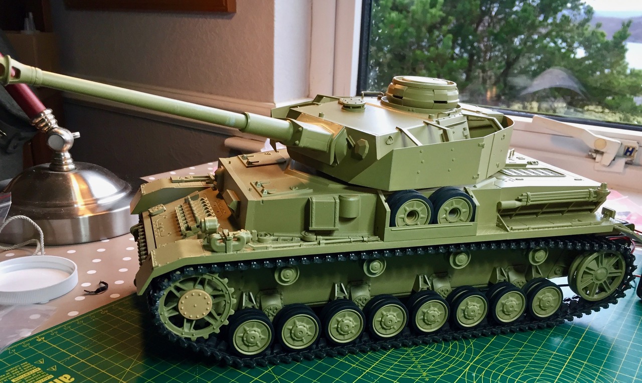

..and this is what will remedy the barrel droop on the wee beastie, seen in this updated shot of my Pz IV progress ..
Of course, although the exterior is almost complete, and has had one coat of Dunkelgelb (apart from the sprocket covers). It will eventually have three colour camouflage, and the accessories (shovel etc) painted in appropriate
colours..

Back to the innards...
Now that I have the recoil bracket, I can fit the recoil and barrel, and then graft the whole assembly onto the front of the turret.
First the recoil bracket has to be fixed to the mantlet: The are the key parts of the Gun assembly: The two screws holding the bracket to mantlet are not fully tight. I've found that by removing one, it's possible to clamp the end of the gun (with a glued black plastic bracket), and wiggle it into position by moving the recoil unit slightly to one side to provide access. With bracket fully detached, you almost need three hands to steady the mantlet, hold the gun breech in place, and then screw the midge sized retaining screw into the recoil bracket; the one that holds the barrel in place.
That's why I prefer to have the bracket partially attached to the mantlet..

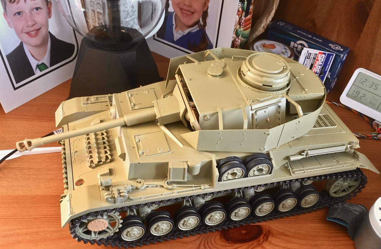

..And following on from all that, the exterior of the tank is now actually complete! Complete apart from camouflage, decals, weathering, and some cables made of cheap string , that is..
Here's a visual progress update As usual, Click to ENLARGE : Oh, as an incidental. Generally, I'm vary careful with things and I don't like them to break (except eggs over a frying pan). BUT, I dropped the turret the other day, and much to my surprise, it bounced and nothing broke off it...not even a wee bit of schurzen.
Perhaps I was wrong to think Tamiya hulls and turrets really too fragile for robust treatment
Oh, yes..as a postscript, i forgot to mention that the Sprocket covers are held in place by 4mm magnets (1mm thick). They come with one already self-adhesive side and are, so far, nice and sticky. Very attractive

Another successful build Roy, glad to see it all together with all the functional guts installed. What are your plans for the brains? Are you sourcing a DMD/MFU or are you looking further afield?

I do like your attention to detail, I am pleased that you have left off the Schurtzen covering the wheels and suspension especially as you have gone to the trouble of fitting the Correct "Late" Rear Idlers and Front Sprockets,
In fact all I would point out
is the temporary omission of the Spare wheel carrier retaining bar.
I imagine that will be fitted at the same time as the "Aber" Tool clamps?
Now do you see why I never submit photographs?
Truly it is a lovely job of work and you should be very proud of it.
