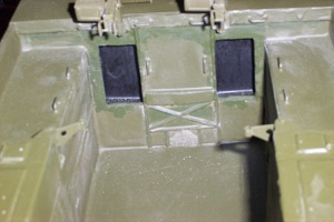

Here are some updated pictures of my build. I have been working on some details in the cargo hold, LED taillights, and the access cover while waiting for my wheels. They have arrived, so now it is time to finish making the suspension and then putting the sponsons on. I have finished adding the carbon fiber grousers to my tracks also. That was a bit of a time consuming job, but I think it was well worth it. At least every thing has now been fiber-glassed so it won't leak.

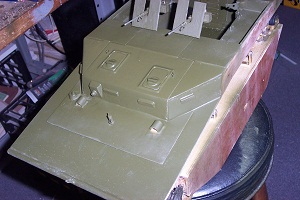

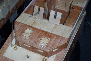

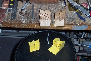

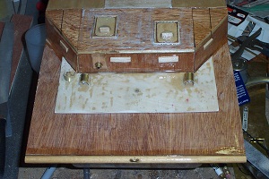

These are pictures of all that I have accomplished in the last couple of days. I have added some detail to the cab and made the water diffusers for the back. I made them out of card stock first and then thin plywood before glassing them with epoxy. Not quite as hard as I thought they were going to be.
Cabin detail
Cabin detail
Track Adjuster026.jpg (39.03 KiB) Viewed 4035 times
Water Diffusers
Water Diffusers
Track Adjuster025.jpg (40.79 KiB) Viewed 4035 times

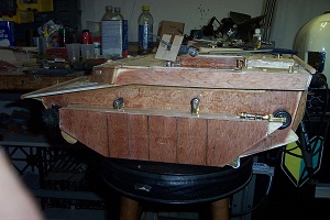

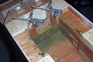

I have been working on the gun mounts of late, I hope I have done them justice. I still have to get some .30 cal. MG's for the side mounts. So far, all of the guns and mounts move as the originals. I have also added the weld lines to the sponsons. Scribed out a grove where I wanted them and glued in thick thread so it is just above the surface. This gives a pretty good weld representation in my opinion. Well it works for me anyway.
Sponson weld lines
Sponson weld lines

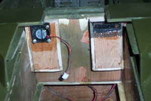

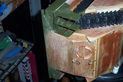

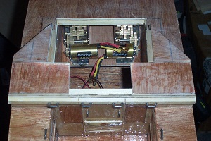

I have done a little more detail work on my build. I have made the ramp locks, the front hatch stops, vented the engine compartment and installed a fan for air circulation, and paint hides numerous sins.
Vents from inside with fan.
Track Adjuster034.jpg (28.9 KiB) Viewed 3995 times
Engine vents through passageway.
Track Adjuster033.jpg (25.65 KiB) Viewed 3995 times

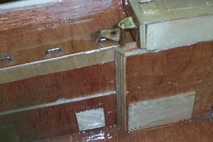

Ramp locks
Ramp locks
Track Adjuster032.jpg (35.83 KiB) Viewed 3995 times

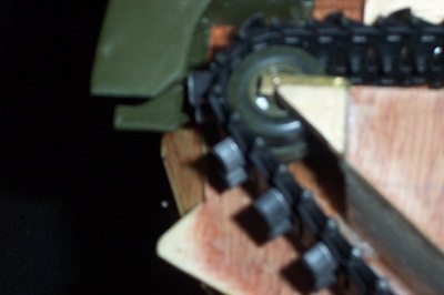

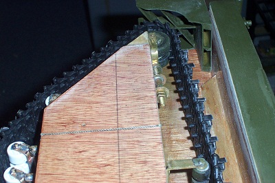

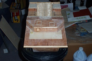

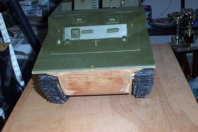

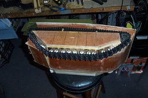

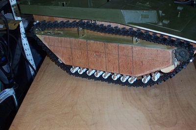

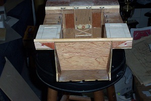

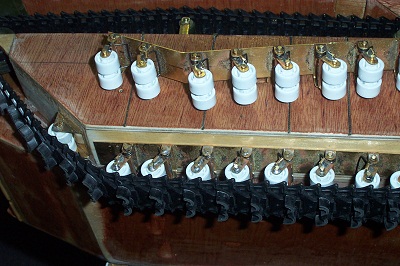

I have finally finished with the bogey wheels and suspension. It does look pretty much life like imho. I still have to attach them to the sponsons and put on the water diffusers, but that is going to be the easy part. Now I get to install the ESC's and radio receiver and program my transmitter so it will actually work.
Did a bit of work on the ramp also.
Track Adjuster043.jpg (50.83 KiB) Viewed 3982 times
Ended up having to take 3 links out to make it fit right.
Track Adjuster042.jpg (52.51 KiB) Viewed 3982 times

Trial fit with the diffuser.
Track Adjuster037.jpg (56.85 KiB) Viewed 3982 times
Showing how I put it together.
Track Adjuster036.jpg (64.25 KiB) Viewed 3982 times
