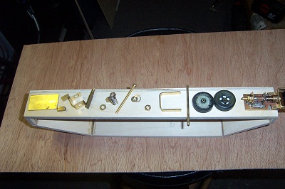

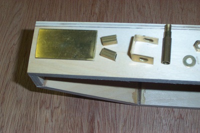

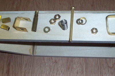

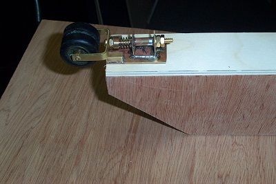

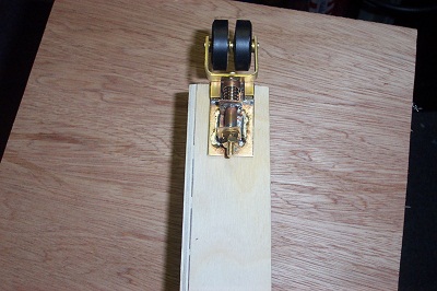

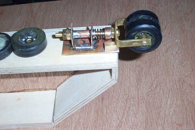

Here are some poor pictures of the prototype track adjuster I put together for my build of an LVT 4 from WWII. This prototype has an adjustment and a spring action of about 3/8 of an inch or appx. 10 mm. The LVT 4 was an amphibous vehicle used by allied forces in the Pacific as well as in Europe by both American and British forces.
- Prototype.
- Track Adjuster007.jpg (47.59 KiB) Viewed 5448 times
- Prototype.
- Track Adjuster006.jpg (46.47 KiB) Viewed 5448 times
- Parts.
- Track Adjuster005.jpg (46.83 KiB) Viewed 5448 times
- Parts.
- Track Adjuster004.jpg (47.53 KiB) Viewed 5448 times
- Parts.
- Track Adjuster003.jpg (46.07 KiB) Viewed 5448 times
- Parts.
- Track Adjuster002.jpg (48.21 KiB) Viewed 5448 times
- Completed prototype sitting on a sponson.
- Track Adjuster001.jpg (53.18 KiB) Viewed 5448 times

Hi Nice work ,good piece of engineering.I might add this could be addapted for other uses(anyone thinking of building a Churchill)could be used .

Nice work Green amphib love your use of brass

Hi Green Amphibian , Now thats very good mate . I hope you dont me using that on my LVT build once I get that far .

I do not mind if anyone uses the design for their projects, as long as it is not made commercially for sale by someone other than me. I believe the forums are to help each other in our hobby and to share what we do.

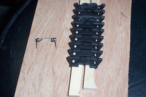

Here are a couple of pictures of the track I am using and one of the springs I made for the road wheels suspension. I used carbon tube to make the cups and CA to attach them. The spring was made from piano wire. I figured that if I made the spring with two areas where it attached to the road wheel frame that I would get an evenly suspended system with no twists in it during use.
- dcp_1586.jpg (27.04 KiB) Viewed 5394 times
- dcp_1585.jpg (34.44 KiB) Viewed 5394 times

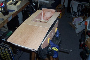

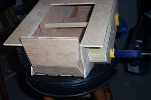

Here are some pictures of today's progress. Everything is not attached, but it is a good mock-up. It is giving me knowledge of how much room I have to work with. Batteries are going to be going under the cargo area deck and everything else will be up front. I still have to fiberglass everything also. This is still very rough.
Herman
Herman
- Track Adjuster010.jpg (26.58 KiB) Viewed 5373 times
- Track Adjuster009.jpg (34.18 KiB) Viewed 5373 times
- Track Adjuster008.jpg (37.48 KiB) Viewed 5373 times
