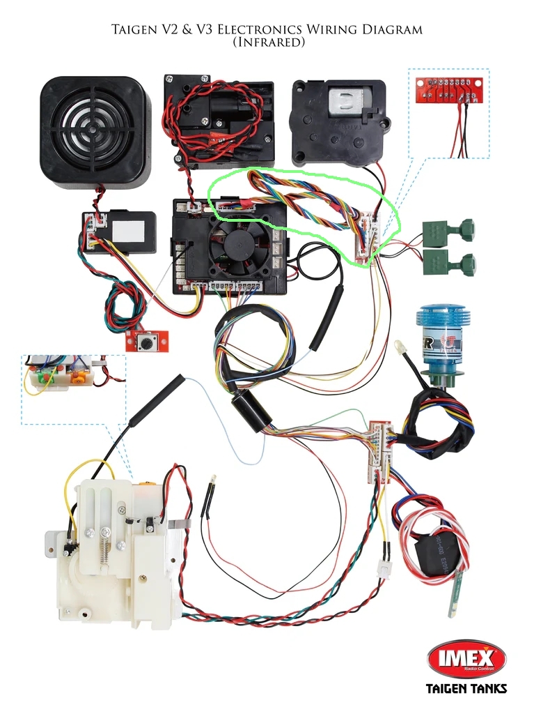

MrChef wrote: Mon Jun 17, 2024 10:12 pm
Jarlath wrote: Mon Jun 17, 2024 6:49 pm Sounds like the main 8 pin connector is unplugged or damaged. Odds of all turret functions failing due to a Bad MFU (But everything else works?) Do the headlights work? Bow MG light up when used? Still drives?
Is that what Taigen calls the "Upper Hull Daughter board?
That is the upper hull daughterboard. The 8 pin connector that connects the MFU to this controls the following items.
  • Turret rotation motor
  • Cannon Elevation
  • Barrel Recoil
  • Airsoft launch
  • Headlight LEDs
  • Machine gun LED
If your tank does not have anything functioning of these, then it is likely that the 8-pin Cable is disconnected (Circled in green in the image).
8-pin Cable.jpg (337.11 KiB) Viewed 789 times

Jarlath wrote: Tue Jul 02, 2024 3:14 pm
  • Cannon Elevation
  • Barrel Recoil
  • Airsoft launch
  • Headlight LEDs
  • Machine gun LED
I ordered the daughterboard for $4.99 and a 360 degree turret slip ring from Taigen. Those will be my first to try. I could also try swapping the MFU from my Taigen Tiger to test if it's that. If it's the MFU I'm ready to do a TK 7.0 swap. :thumbup:

MrChef wrote: Wed Jul 03, 2024 12:34 pm
Son of a gun-ner wrote: Wed Jul 03, 2024 12:04 pm Mr Chef. A word of warning. Before connecting up your turret features to your good mfu. Best to check for obvious shorts in the wiring, or factory mistakes, even last (I didn't try to fix it) owner interference etc. Any problems that could injure your working mfu and pride ;)
Thanks Mick. Good advice. This one will be baby steps. I'll be relying on all of our members good will, solid advice and help to diagnose and get this girl up and running. :thumbup:

Going by what you say the problems are on this tank I would check if the 8 pin wire is fully plugged in. As it sounds like someone has opened the tank to put the battery in pulled a little to hard and disconnected the 8 pin plug not fully but it's sitting at an angle so you still have MG and headlights as it doesn't say they don't work but don't have turret functions or rotation.
