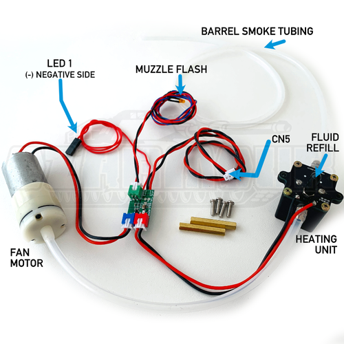

Jofaur86 wrote: Sun Mar 26, 2023 3:17 pm on the diagram it is indicated: CN 6 Trigger Switch? indeed, seen that marked +/- it can be confusing ?
Look at the attached link, on the TK 6-1 for example, is the Micro switch Trigger in CN 6 well drawn? moreover, I think that if Mr. Bix indicates this manipulation? he is quite competent, not to say nonsense, I am also attaching a photo of a TK 7.0 and a video, where you can clearly see 2 wires from CN 6 to the recoil switch, ( Green arrow )
http://www.rc-panzer-shop.de/rc-tank-in ... fo-rc-tank
Hoping to have brought some help?

On the 7.0 board you do not need a jumper in cn6 you use cn5 for smoker lead and led 1 for the flash.

Here is a very clear video of cannon smoke and or flash install=
https://youtu.be/MjjnKgBlDrg
