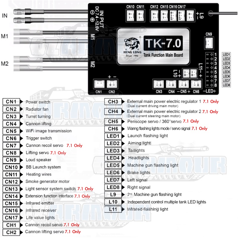

I've never install one before so im looking for a diagram or instructions for all the connecters if any one has one

im trying toinstall version 7.1 into a tank that has an old motherboard so would like to see a diagram of the connections.

Here is the diagram, for a 7.0 plate. If you browse this forum? post "Electronics" should find many answers there :thumbup:

The problem you will face is that your earlier board has "JST" plugs,
These will have to be changed.
The "7" board uses a totally different plug.
Of course you could just change your earlier board for a nice aftermarket board and keep the "JST" plugs and in most cases finish up with a much better Tank.

Jofaur86 wrote: Sat Mar 25, 2023 7:29 pm Here is the diagram, for a 7.0 plate. If you browse this forum? post "Electronics" should find many answers there :thumbup:
Sorry for my English, not perfect, by google translate
thank you i did have a look but didnt come up with it
jarndice wrote: Sat Mar 25, 2023 8:29 pm The problem you will face is that your earlier board has "JST" plugs,
i can solder so not a problem.i am installig a better board ?

the little red wire that comes out of the uit near l9 i think is that the wire that connects to the controller wirelessly ? so i can do away with the aerial on the tank ?

mrmetallica wrote: Sat Mar 25, 2023 9:51 pm the little red wire that comes out of the uit near l9 i think is that the wire that connects to the controller wirelessly ? so i can do away with the aerial on the tank ?
sorry but not done this before .
Yes Sir you can do away with the external aerial.
It should be routine enough to get the functions working if you get the plugs changed onto the respective wires for each operation, elevation, rotation and the drive motors, but BB will be the likely sticking point.
Be sure to add a loop wire into the Trigger socket. Just use an old cable, cut it down to an inch long off the plug, bare both wires & join them with solder & heat shrink-done.
That will give you cannon sound .
