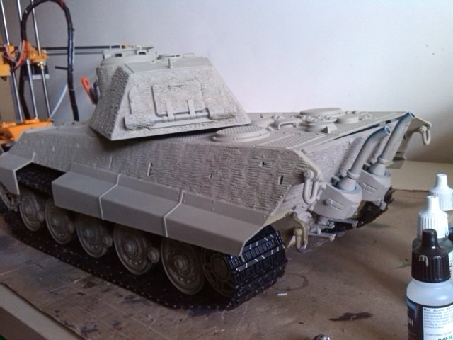

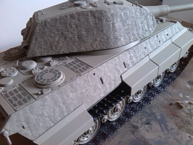

I managed to get the zimmerit completed, it turned out ok, and by using milliput it hardly cost anything at all. I prefer that uneven look as opposed to the uniform pattern that the Atak panels would have looked, it took forever to do though. A coat of Vallejo WW2 German Beige mixed 30/30/30 with matt varnish and water and it all came out quite nicely.
Taigen sprayed the wheels with some sort of hard as granite paint, presumably to prevent the paint chipping off, and this has pretty much welded the caps into the sprockets. Try as I might I can't get the caps out without seriously scuffing them, and that means I can't get the tracks off unless I remove a pin. They will stay in place for now and I will see how I can weather the tracks at some point in the future.
Just waiting for the paint to dry out properly and then I can put some German Green camo stripes on it.

The zimmerit looks great. A sense of great satisfaction, I imagine.

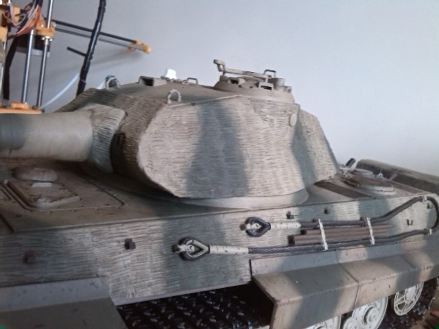

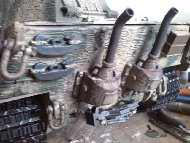

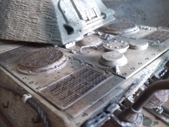

Been busy these past few days, I am on a mission. Just need to do the wheels and that will be all of the painting and weathering done. Still a few things to do after that, but it's almost complete.

Beautiful work all around. I am especially enjoying the detail work.

Hi WW an excellent job all round the weathering is spot on you should be pleased with the way this build is turning out.

That Zimmerman job is monumental!
I'm sure when I look close at it I can see where you've sat up and gone "why !?"

It was just a thought that I had when browsing through archive pics, and none of them were very clear. I kept looking and then started delving into production history, and there it was, the zimmerit was applied at the factory, and it was applied before the fenders were mounted. This doesn't of course apply to all of the KT's with the production turret as zimmerit was discontinued.
My way of doing it was to use yellow milliput, make up a small amount at a time, and then press pea sized balls onto the surface and spread it wafer thin. do about 6" on a surface. I then cut a 10mm wide strip of 3mm styrene, and sanded the end into a chisel shape, it was this that I used to do the pattern. Only apply the pattern to 5", and then apply another 6", and so on.
It also helps to take time to only do one surface a day, as that way you don't end up touching soft milliput when handling the hull and turret.
I hope that this helps anyone else contemplating doing this themselves.
