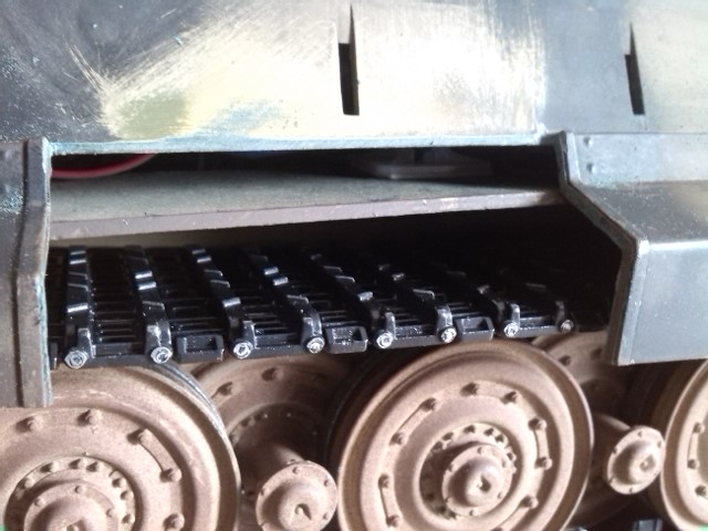

Been having a quick hack about with the fenders, I took out the overhangs, and that doesn't leave a gap, but yes, when I remove the plate that is left on the hull...a tad too much plastic is going to disappear. The other question of course is that strip that goes between them. Is that attached to the front or the back of each section, as strictly speaking I should remove one of them? :/

That bit you left is part of the fender, if the fender is gone that bit should be gone to. That's where you'll need the plastic card for not to mention when you remove that bit of fender you'll need to trim 2mm off the lower hull that is above the tracks so you can continue the correct angle for the upper hull behind where the fender would be.
I'm sure you'll see what I mean once you remove the rest of the fender, just giving you a heads up. :thumbup: Wish I could be of more help to you.

I had to trim a section off the upper sponson on my octopus when I removed the left guard.
The sponsons are wider than the true hull width as the guard profile is moulded over them rather than to them.
Once you remove the section of guard there will be an open gap. To attach a new section of armour to fill this gap will mean trimming clearance on the sponson in that area to allow the new armour section to fit flush with the hull profile/angle.

No worries chaps, I know where I am going with this, it's all pretty simple once the plastic gets removed. A strip of 2mm styrene fills the gap and brings the hull back out flush with the back of the fenders each side. By cutting it longer than the gap it can be glued securely each side. It will all be covered with zimmerit anyway as the coating was applied to the hull before the genders were attached, at the factory.
Looking at archive pics the raised 'lip' between the sections is seperate from the fenders themselves, so I will have to sand those off.
