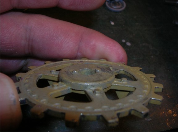

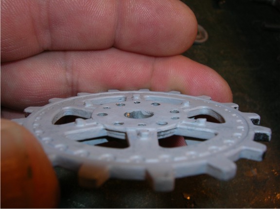

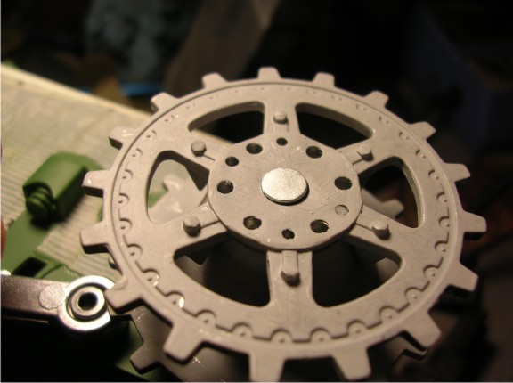

Now the the front sprockets. I wanted to put the early ones on and again issues with Mato to HL.
As you can see here the later sprocket center that comes with the "G" is raised up
So I had to grind this down. Easy to tell when you have it flush the holes appear on the inner hub. I then primed it.

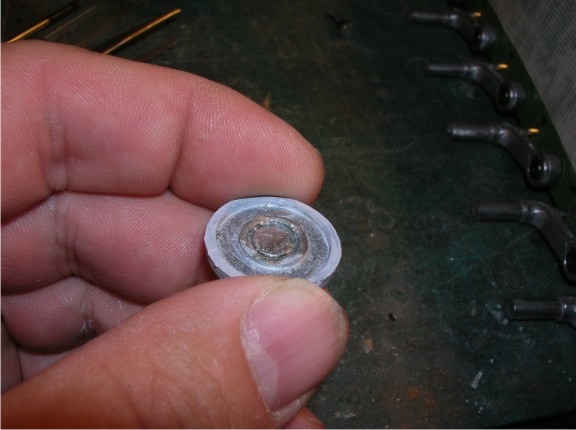

Here is the early cover

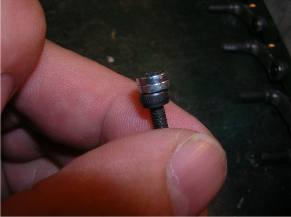

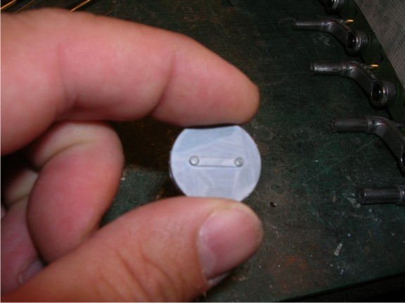

On the back side I made the inner ring flush with the outer by grinding it down too. Then 2 part epoxied a wafer magnet into the center
As you can see the hex bolts are magnetic and 2 of these wafer magnets measure out perfectly for a tight fit!

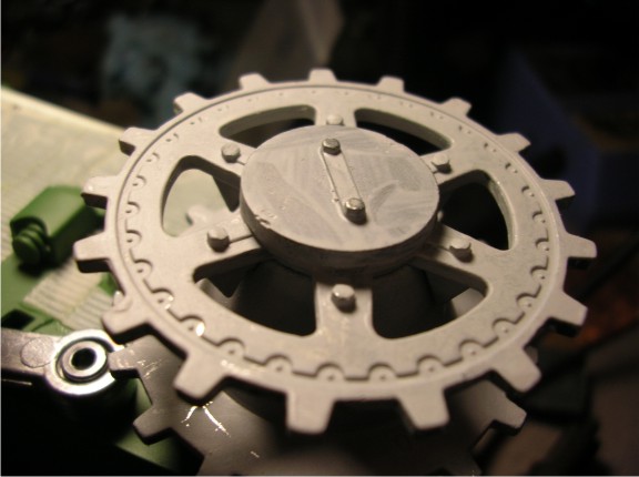

so screwed the assembly into the hull then popped the magnet in on the hex bolt head.
Brought the cover close to it and snap! It went right to it. Viola! You have the early sprocket and no issues getting into it when you need to...
