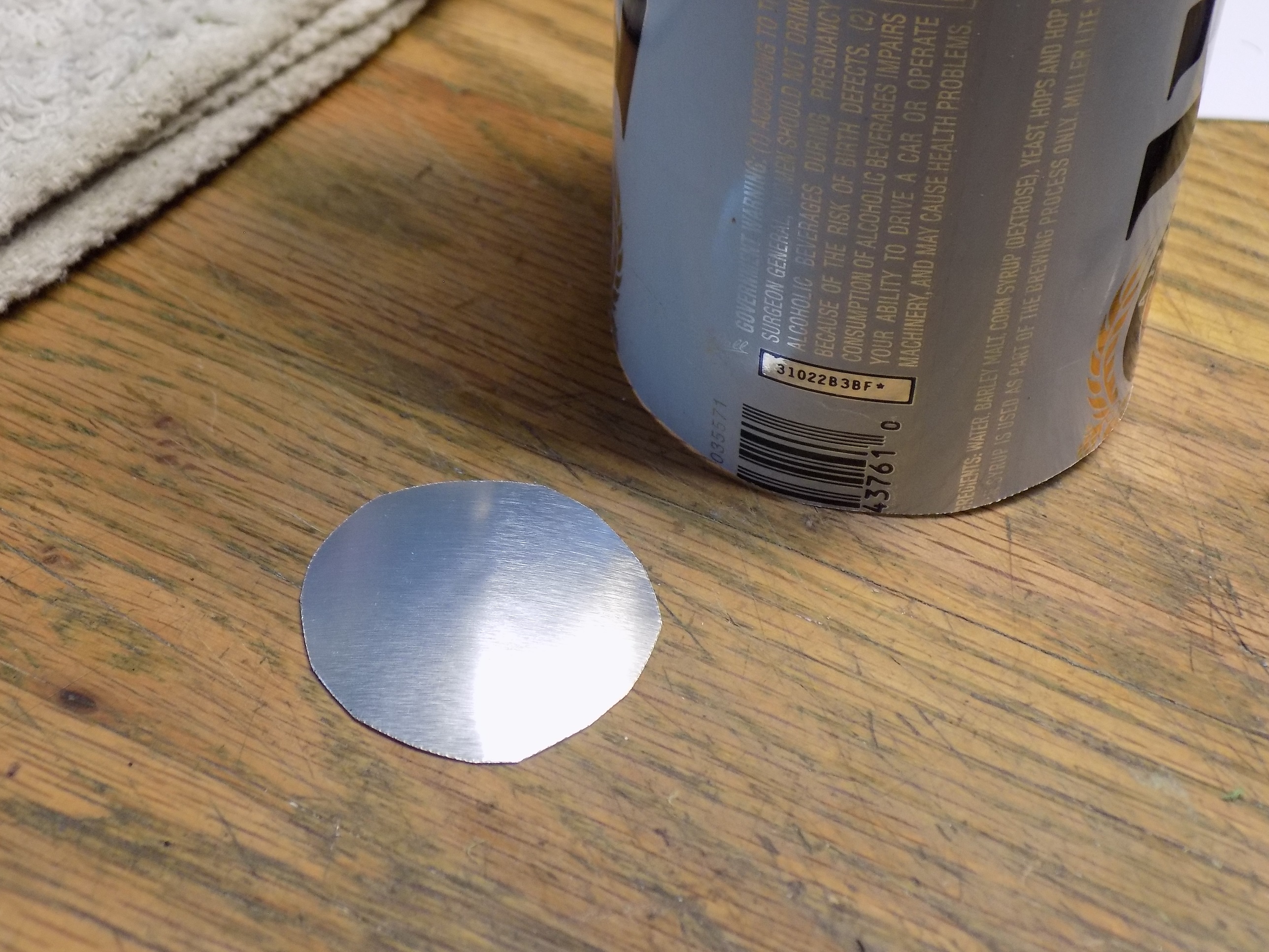

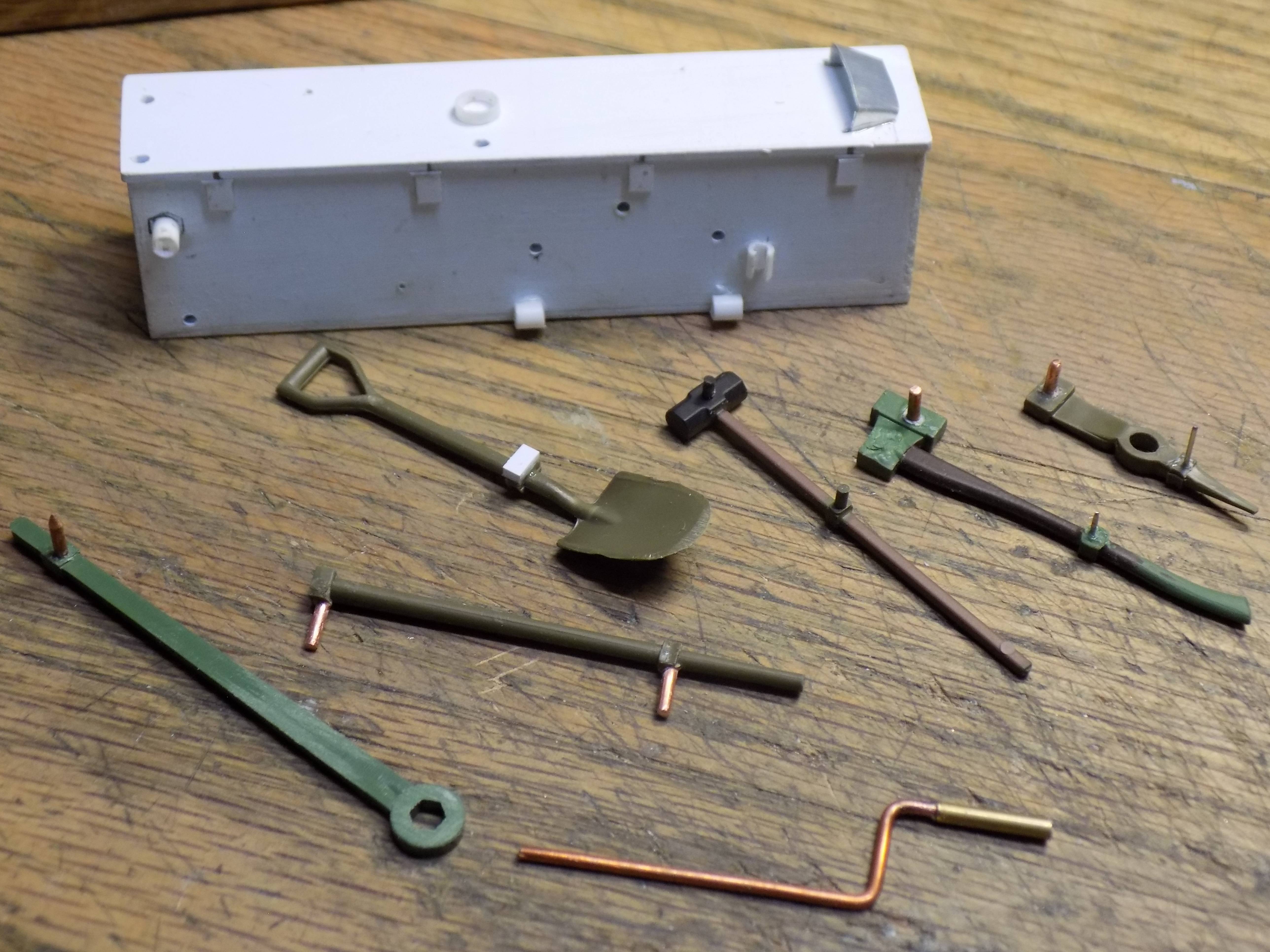

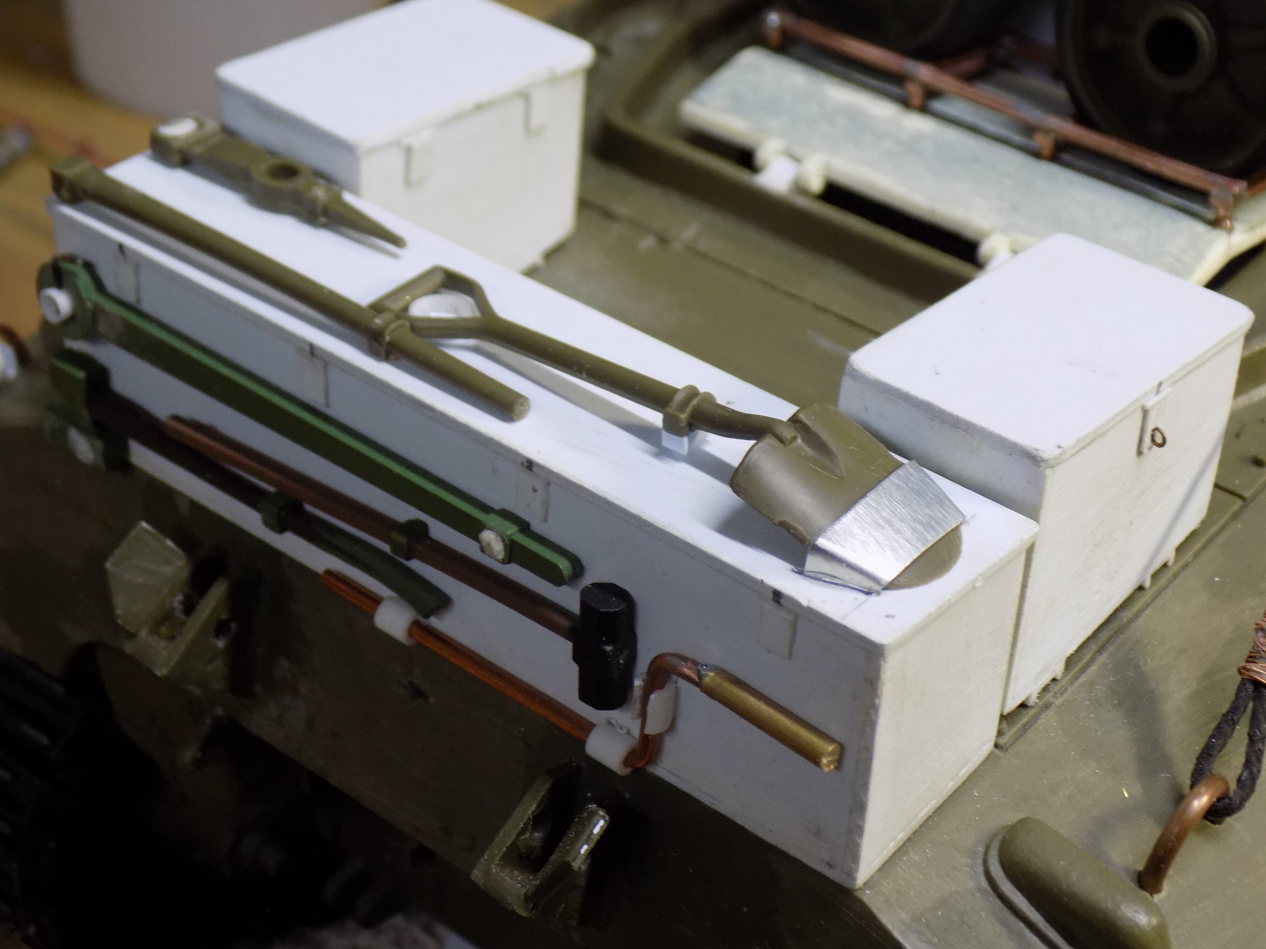

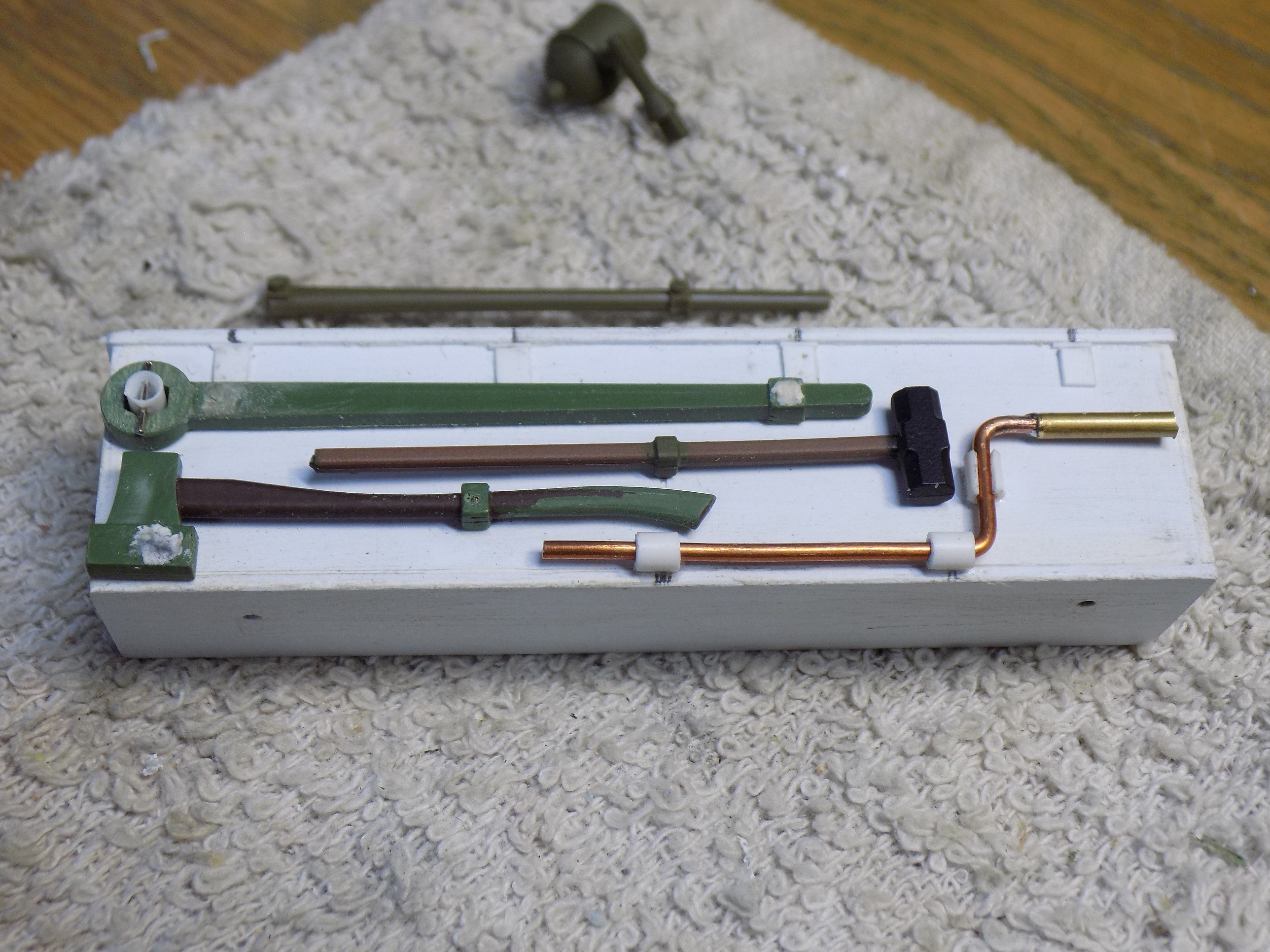

Tool box hinges/latches, pioneer tools and a couple tips/tricks. I find that often when removing tools for a repaint the plastic studs break off. I tend to drill out the tools and replace with longer metal studs (longer because the friction fit is usually all that is needed and the tools can be removed as needed). The little ones get sewing straight pins (they also make great rivets). When there is room the larger ones get soft copper wire. Needed some thinner aluminum, the walls on this can measures .07mm/.0025" but the bottom of the can is .38mm/.014". I use tin snips but a good pair of scissors can do the job as well.

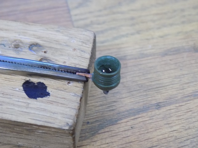

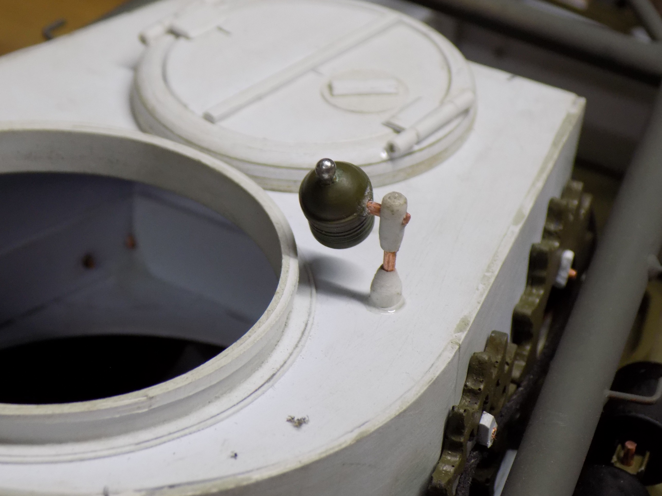

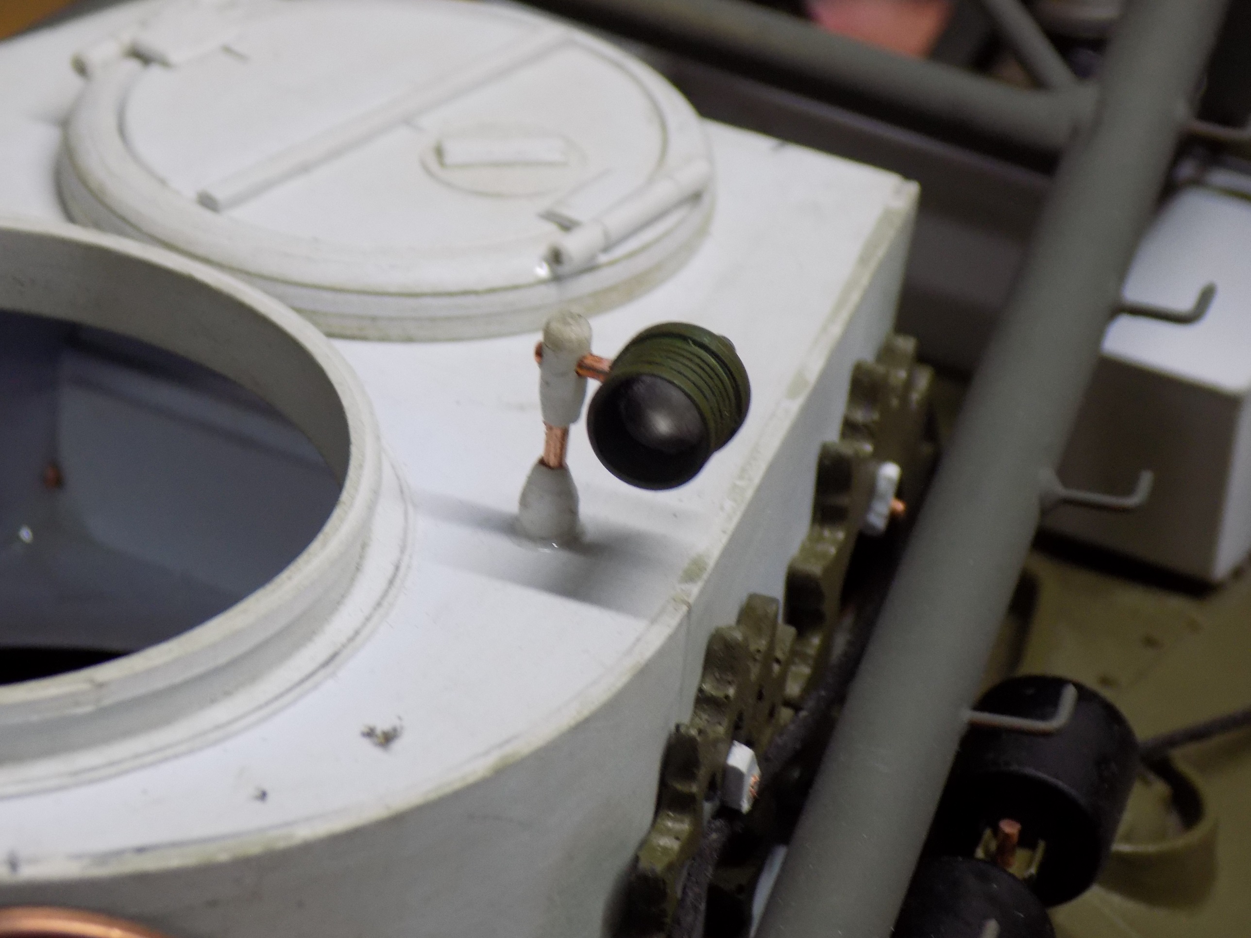

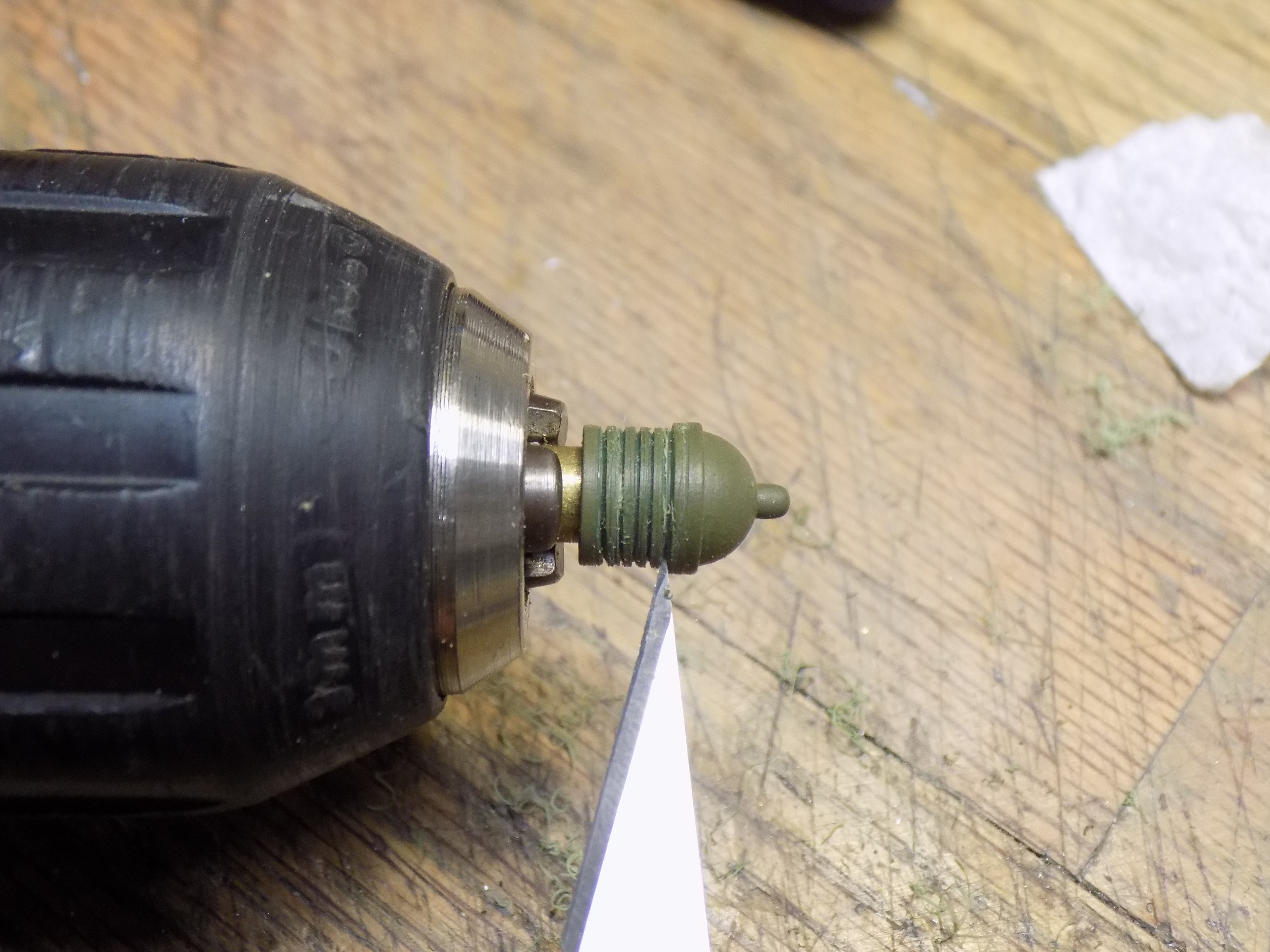

Spot light, just for fun.
M32 151.JPG (118.35 KiB) Viewed 49 times
Add some ribbing detail.
M32 152.JPG (1.11 MiB) Viewed 49 times

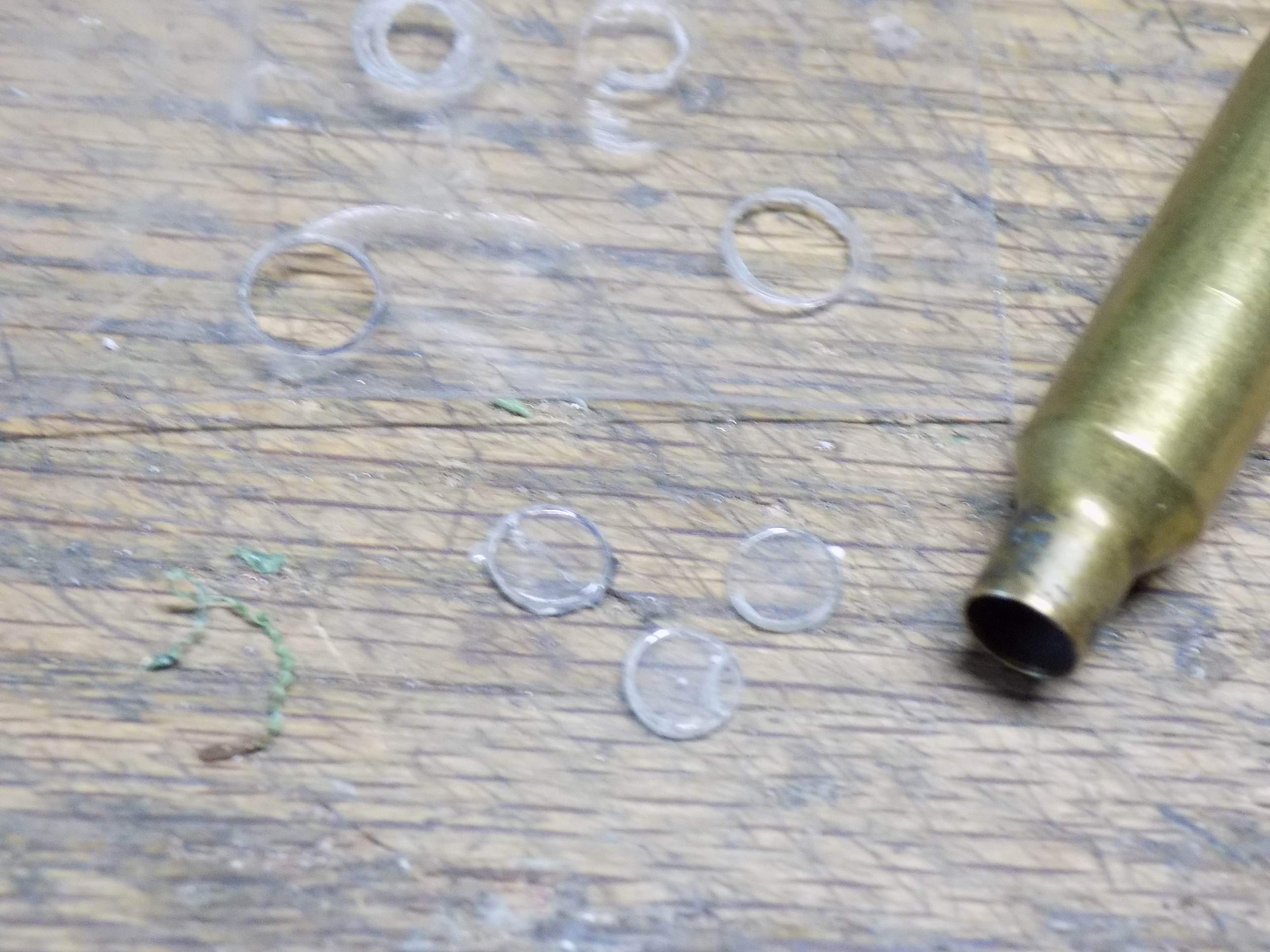

Difficult to see, used the .243 casing in the drill for some friction cutting. Blister pack material.
M32 153.JPG (1.23 MiB) Viewed 49 times
Epoxy in the bottom to build up the reflector. Then some silver paint followed by the lens.
M32 154.JPG (147.56 KiB) Viewed 49 times
IT moves....

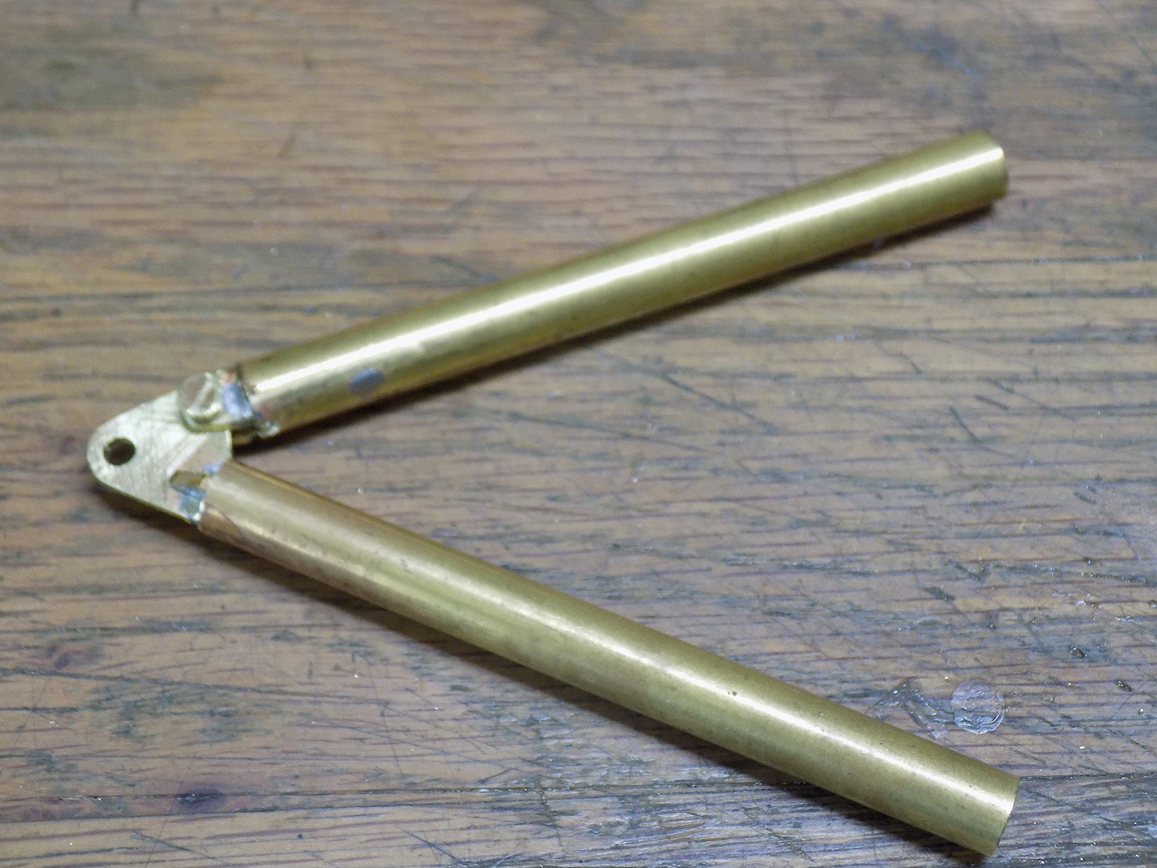

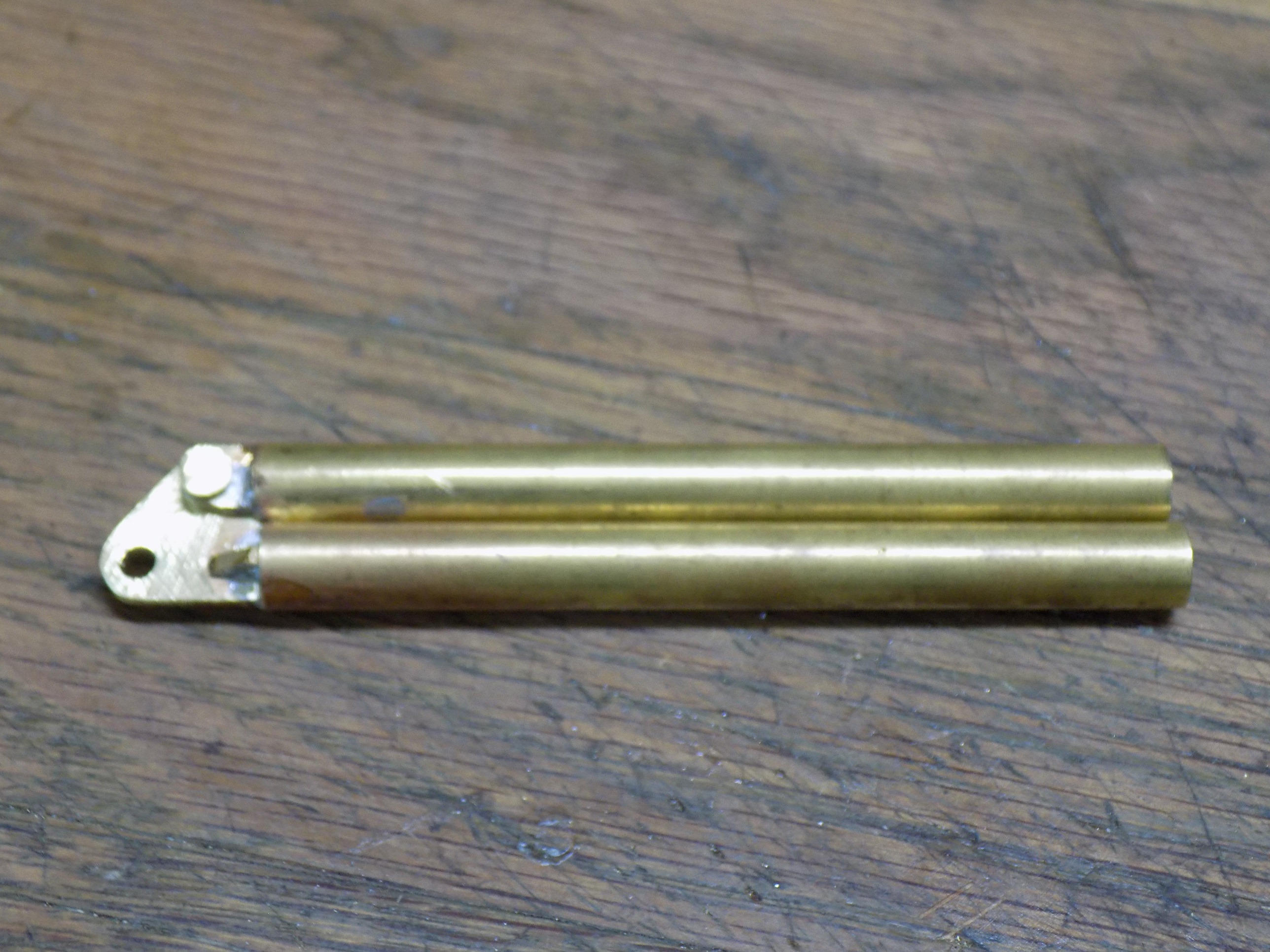

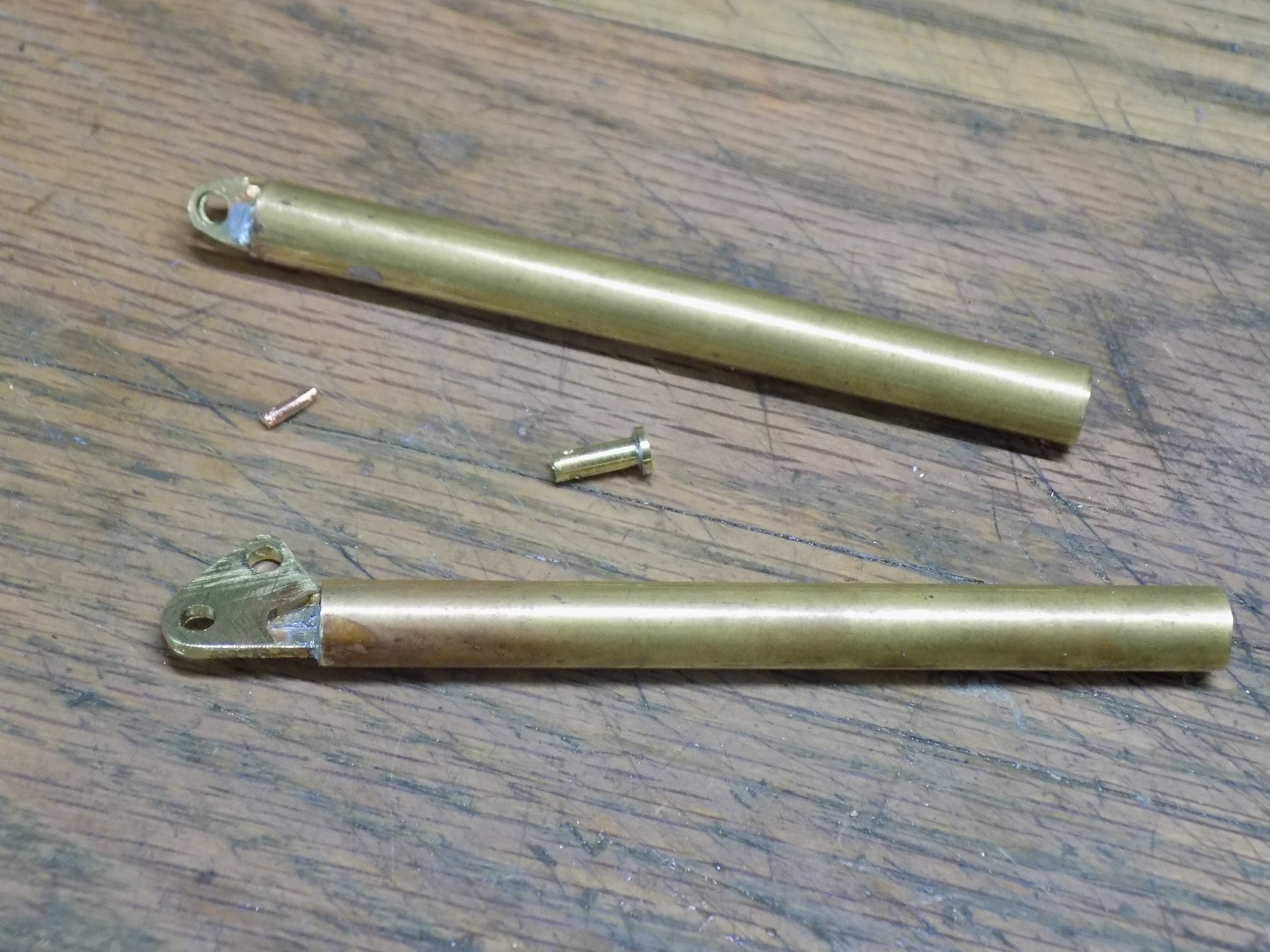

Recovery tools;
Starting with the hinged tow bar.
M32 157.jpg (46.91 KiB) Viewed 48 times
M32 158.JPG (1.43 MiB) Viewed 48 times
M32 159.JPG (1.19 MiB) Viewed 48 times
M32 160.JPG (454.43 KiB) Viewed 48 times
At the moment, am at a total loss as to how to build the opposite ends...
