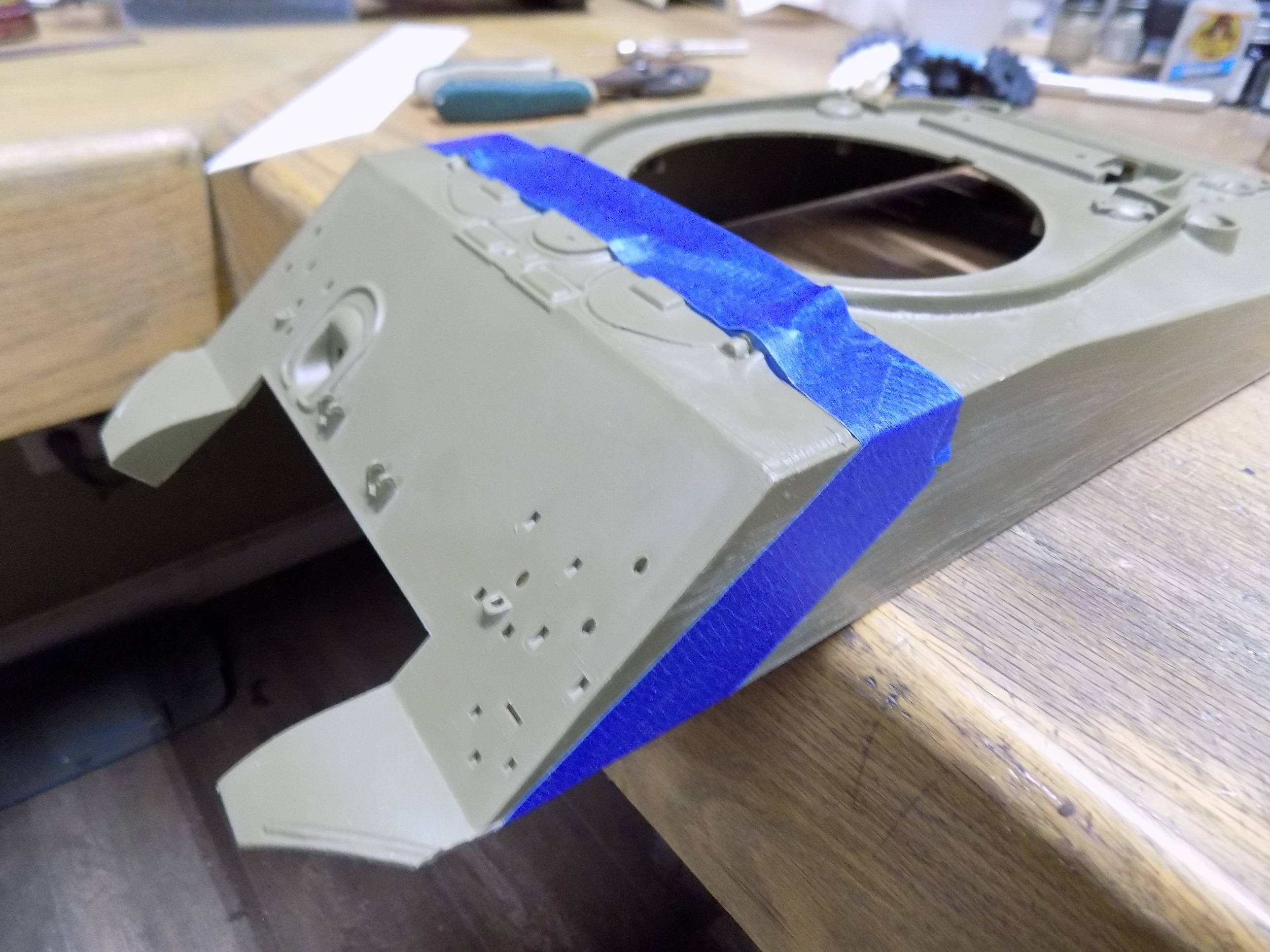

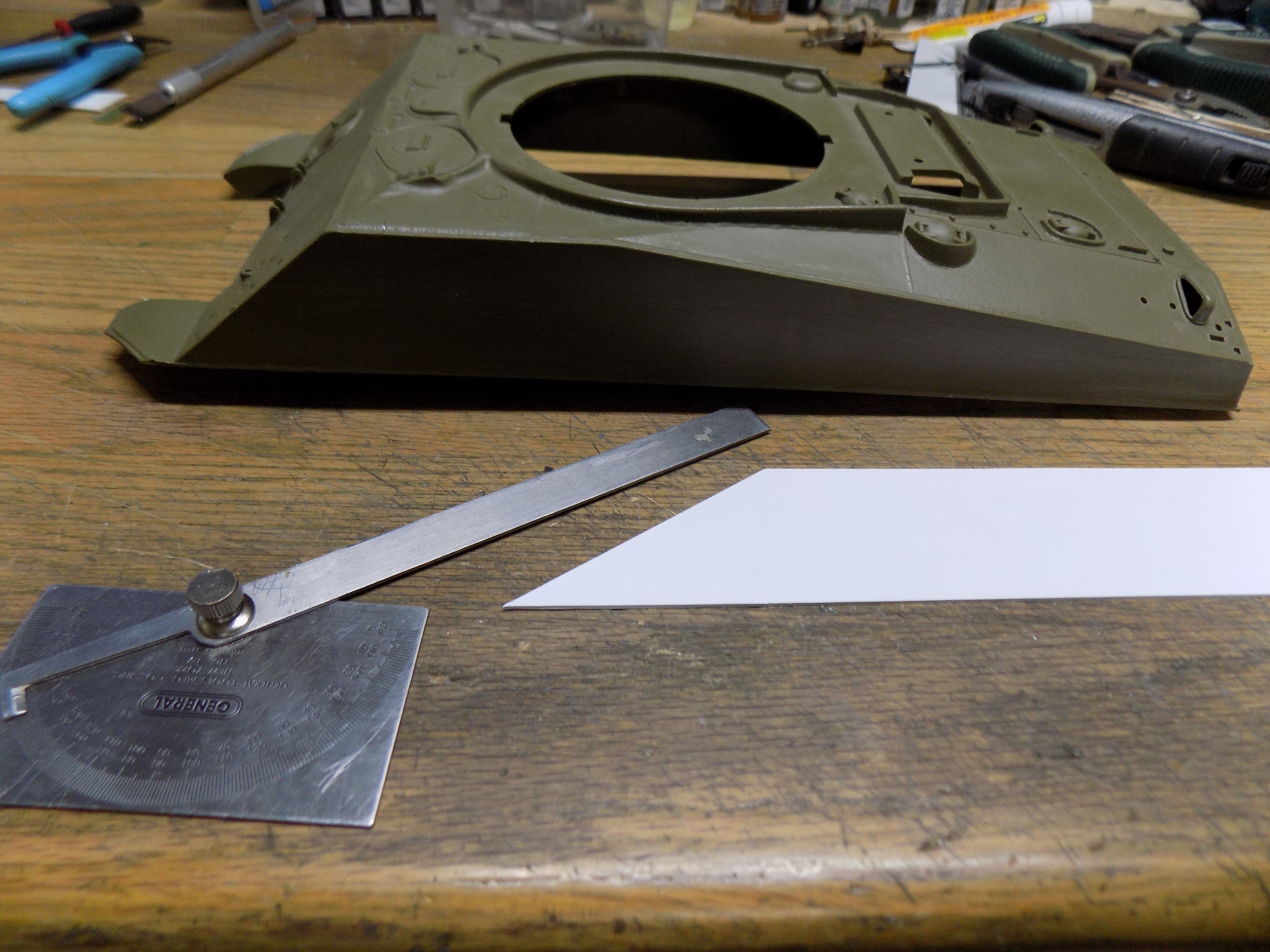

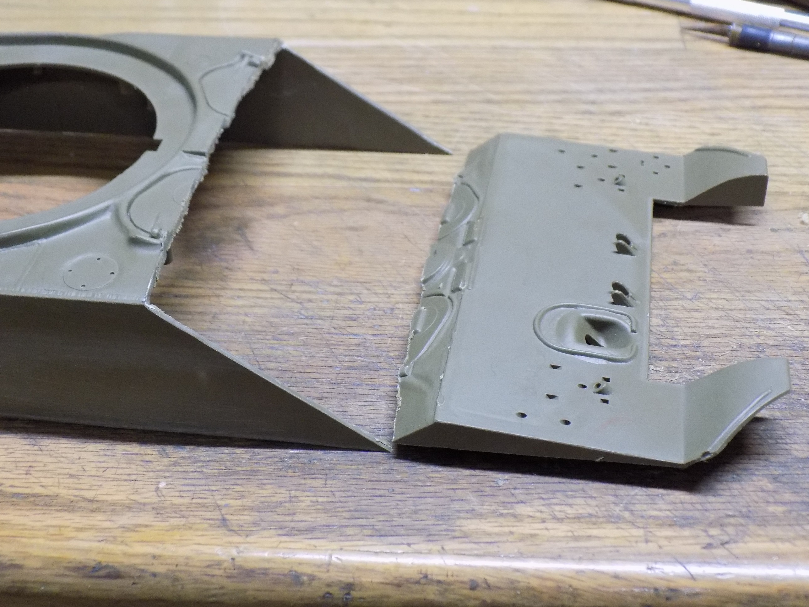

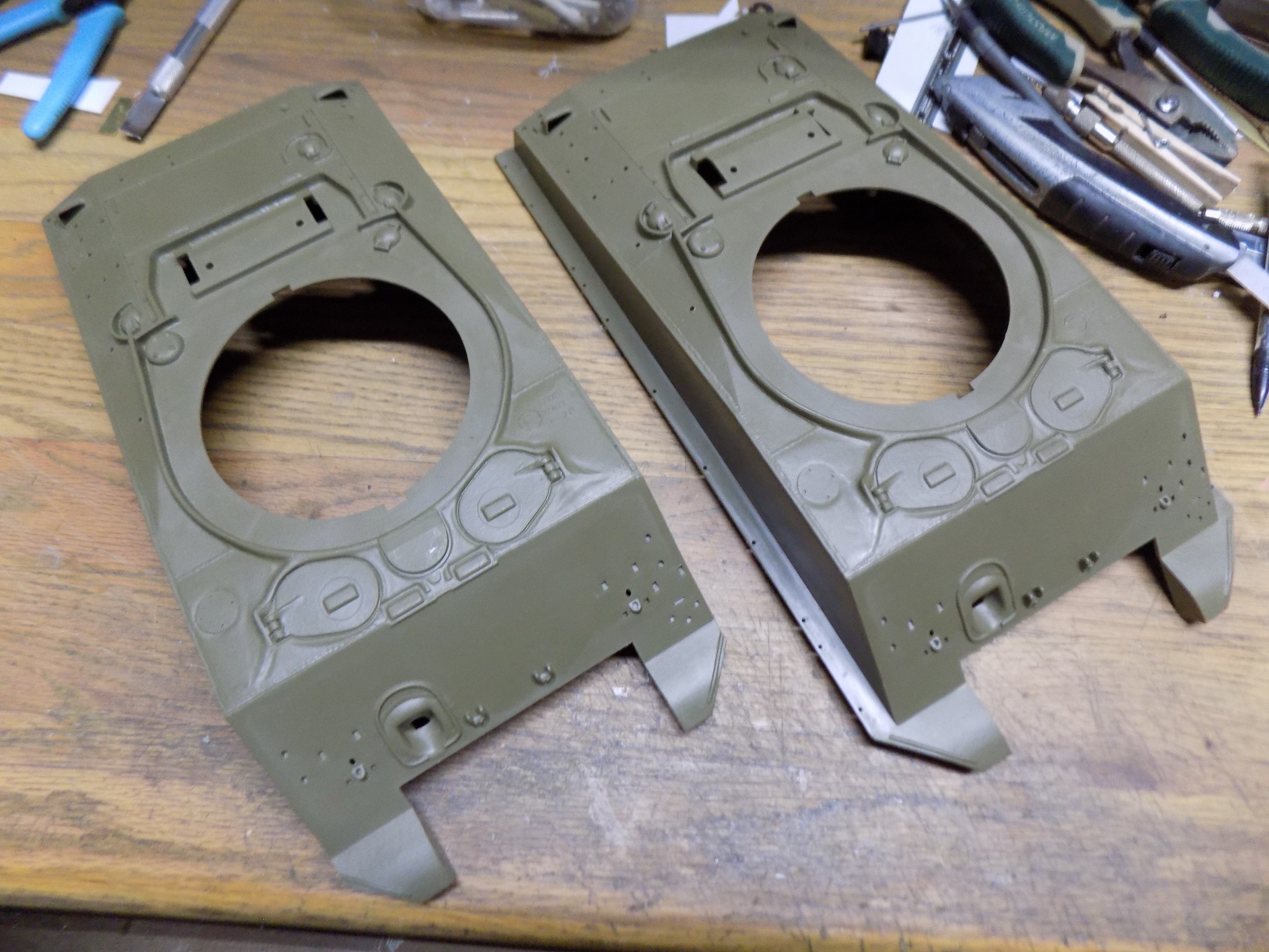

I got started early this morning. Have three Tamiya upper hulls, 47 degree wide hatch M4s. One of them I had robbed the fenders for a build several years ago, so I chose this hull. The Heng Long upper to Tamiya lower is a simple/easy swap. Tammy to HL is a bunch more work (mostly trimming the lower to fit the upper, then turret ring if using a non Tamiya turret.). Have not ordered my M4A3 yet so I will borrow the M10's lower for now until it arrives.
I've built several scratch builds but all have used plans of some sort to build. This time around, I will use pictures and what I can find on the net to construct this one (for instance I found measurements for the crane boom that when scaled to 1/16 ends up with 11/32 beams x 13.5 inches long).

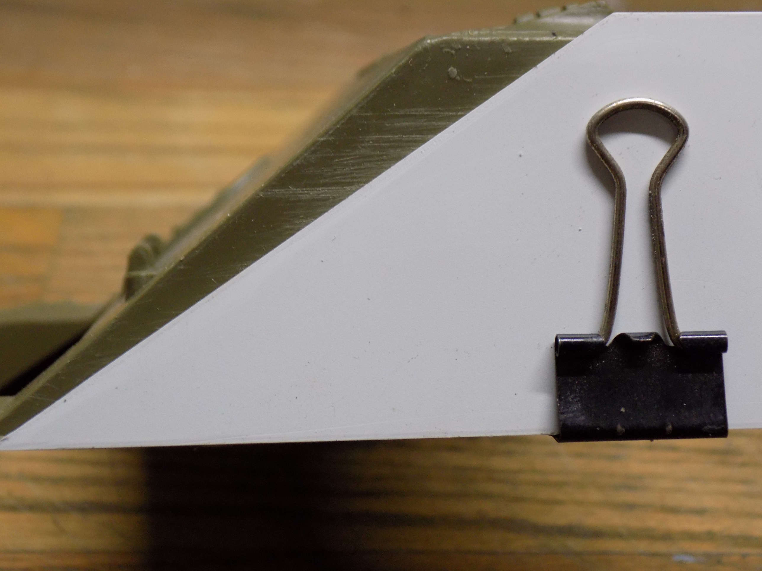

To make the narrow hatch conversion the front glacis needs to be inclined/reclined back to 57 degrees from vertical compared to the 47 degrees of the later wide hatch units.

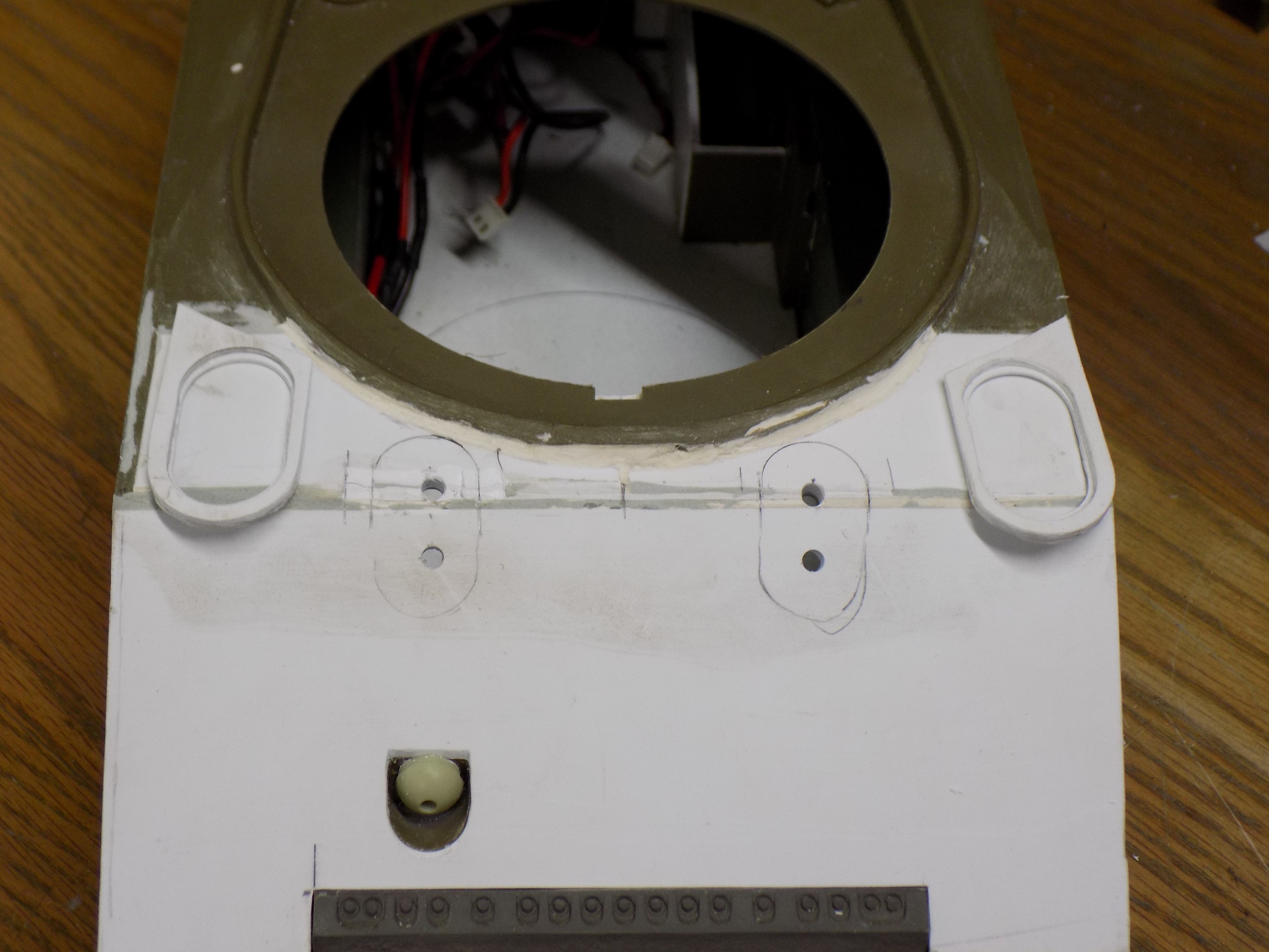

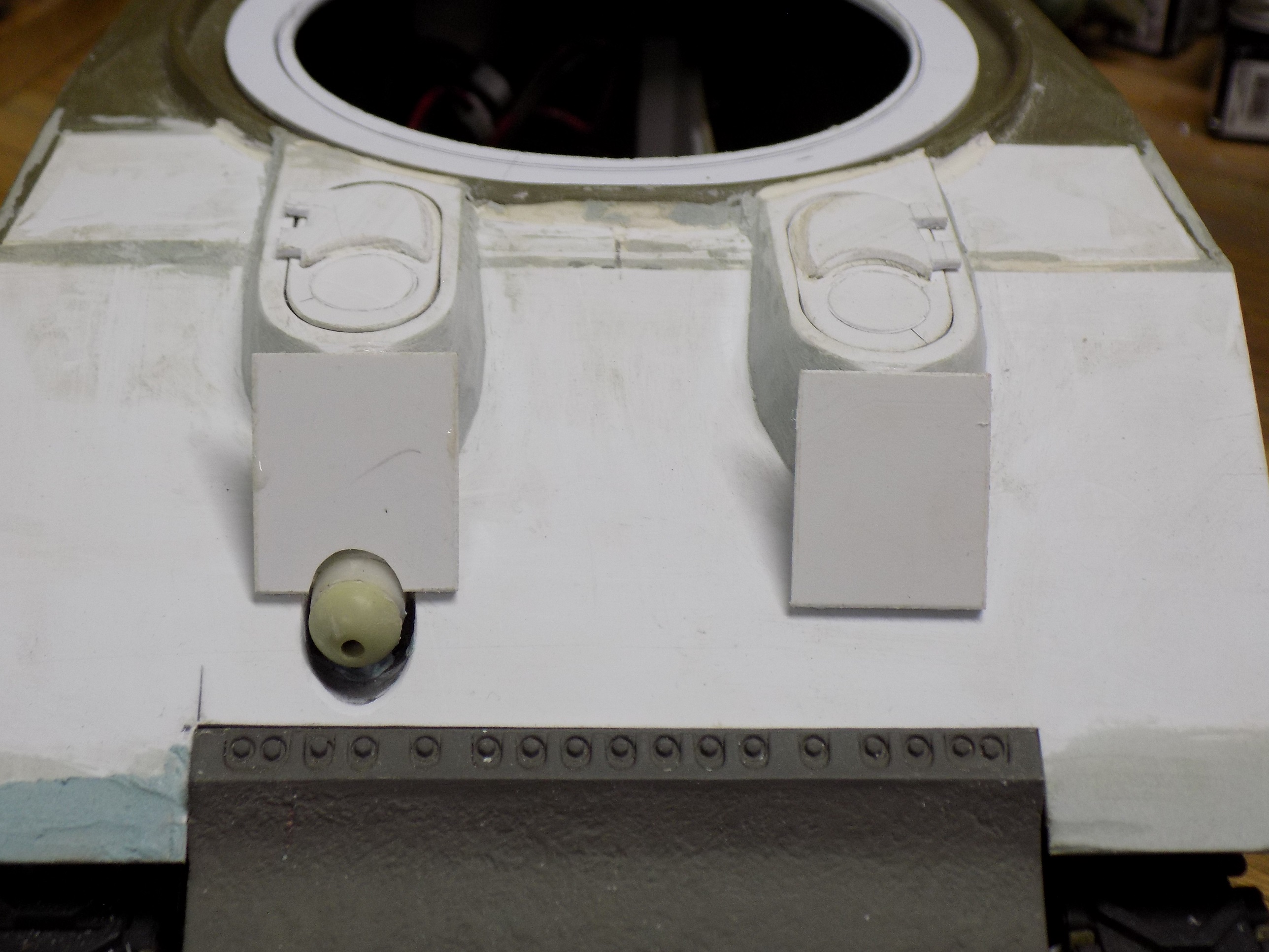

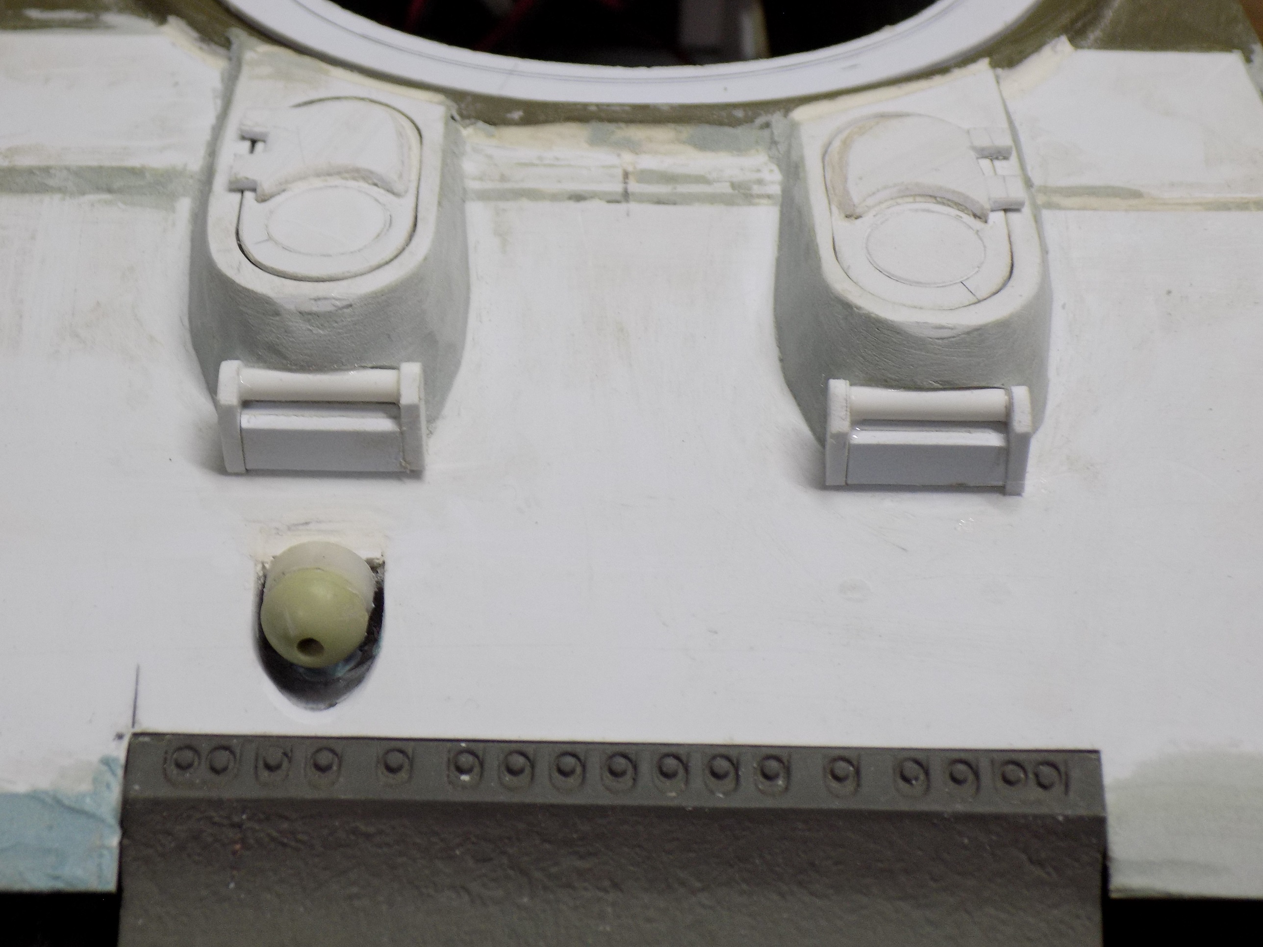

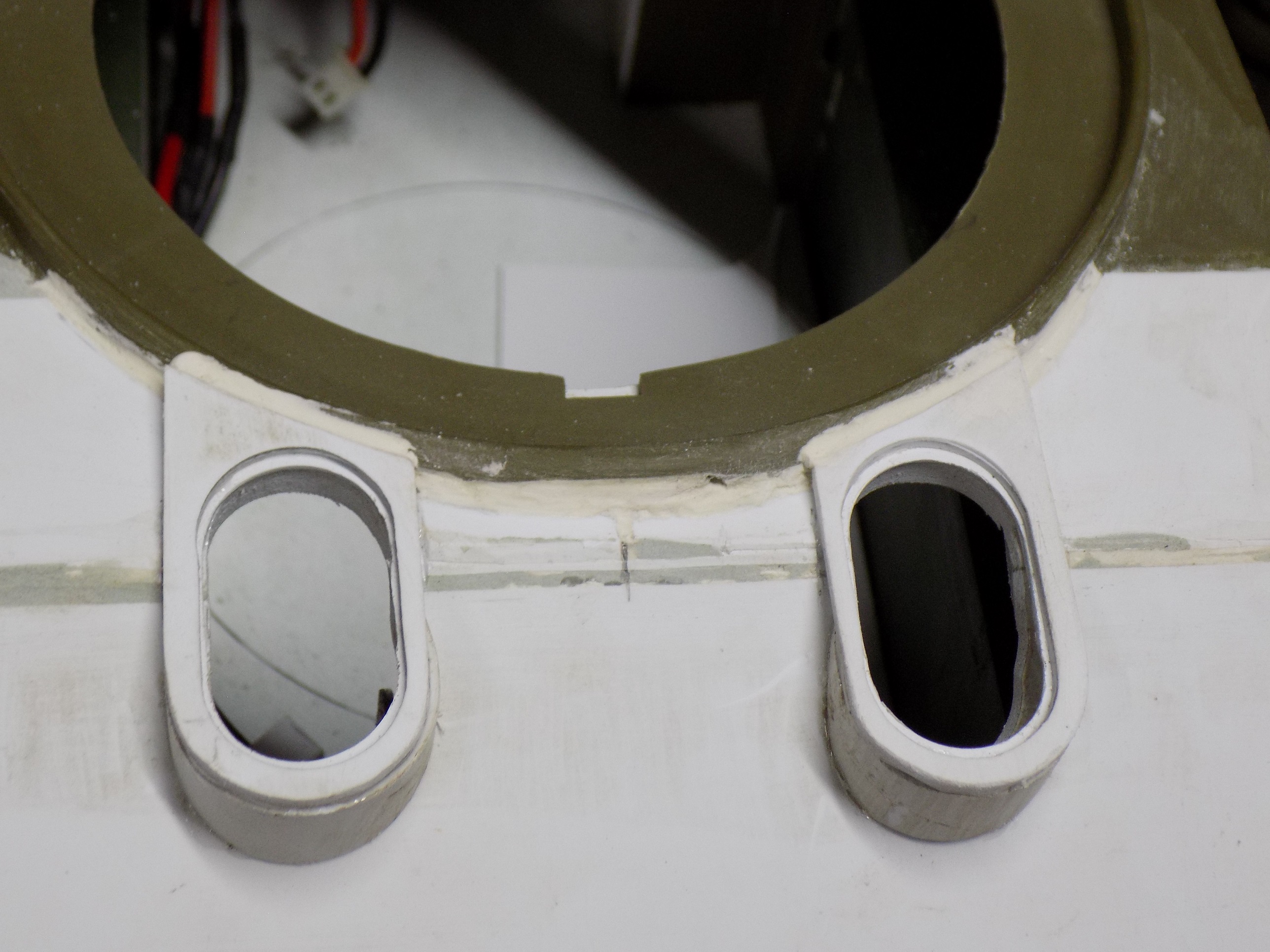

Trimmed out around the turret lip to get rid of the casting on the wide hatch hull. Simple 1.5mm card for the front glacis and then created the hatch rings. Added some Bondo around the hatch risers and added direct viewing covers. The applique armor is simply set in place in the picture (but were on most of these conversions). The Bondo color change is due to the new hardener I bought when I ran out of the red/pink (still the same gallon).
