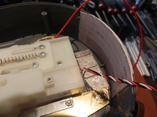

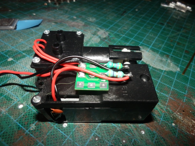

Had an issue with the turret the day before I left, that being the damn recoil/elevation unit would only cycle elevation non stop.
Changed the unit out for one I repaired earlier !
Now its spot on.

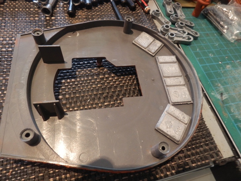

Also, used stick on mag wheel balance weights to ballast the turret as due to the lack of elevation box out of the back of the turret, its a bit front heavy with the nice barrel et-al.
Sits good now.

I'm relieved you managed to fix it! The wheel weights are a good idea too, 50 grams is a decent amount to balance out and wouldn't have been easy to do without the turret bin for leverage.HERMAN BIX wrote:Had an issue with the turret the day before I left, that being the damn recoil/elevation unit would only cycle elevation non stop.

I dont have scales, so taking the old H/L elevation motor in one hand and a section of weights in the other & trying to get a feel for balance between the two, had a guess at the weight required.
The barrel with muzzle brake and slightly forward mounted recoil/elevation unit really does add a lot of nose heavy 'list' to the turret, add leverage length to the barrel as well, and I ended up adding about 90 grams into the turret rear.
As for the elevation unit you sent me & I wrecked, all it took was fatter screws, cut off very short, and a dab of sikaflex into each hole as I went.

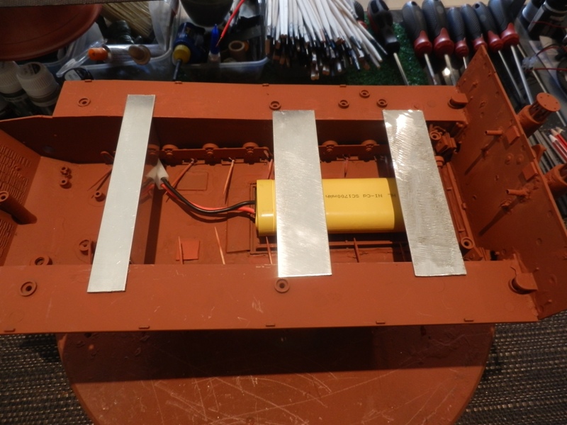

Got the hull bracing made today,used aluminium odd-leg angle that I got for my Jagdtiger conversion, its also going to help mount the speaker, but these wont be secured until the gearboxes have arrived & been fitted. The front brace will help out being a splash guard.
