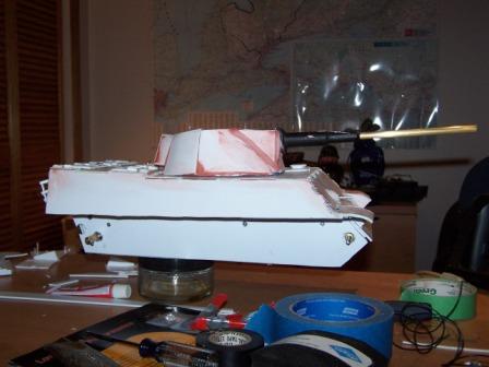

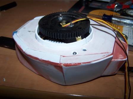

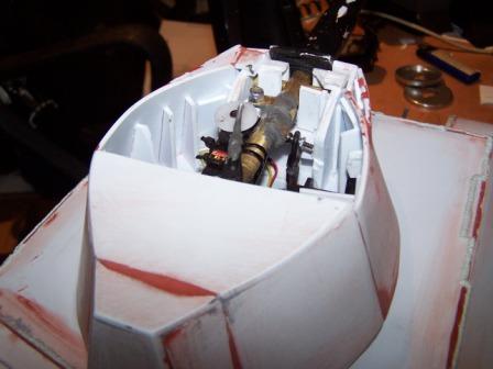

Latest update after a chance to work on this now that the holidays are over.
Pic 1 is the turret drive ring, I am working on getting the motor set in the hull. Hoping to have the turret turn at around 1 rpm, slowest my motor will go but I do have a slip clutch on it so that will help stop any damage if get stuck in the trees. Second is the recoil and elevation, just using micro servo's for that because I can program speed and distance on them.
The last is a side shot the top or front and back is not detailed enough and even the sides still need work butif you can see where I am going at least now.
2 weeks and the suspension will be done as I will have some Mato metal Panther wheels in shortly. I was going to build them but arrghh I been building this since October and I want to drive it all ready :lolno:
Update 7 002.jpg (23.43 KiB) Viewed 1811 times
Update 7 003.jpg (21.32 KiB) Viewed 1811 times
Update 7 001.jpg (22.92 KiB) Viewed 1811 times

I am using the Hi-tec HS81 servo, at 6v it will move 60 deg 0.09 secs at no load and the force it generates is 41.66 oz/in which is more than fast enough and strong enough. My only concern with the servo is the amount of movement. I want bthe barrel recoil to look realistic and total travel as I have it hooked up will be about 1-1/2". Might not be enough but I will need the SLU etc before I can judge that. I'll use a longer arm and do 180 deg of turn if I have to.
The little bit I can test though it looks nice with the quick pull back and a slow return.
To attach the servos to the barrell for the elevation I just made a flat ring out of some 1/16" x 3/8" flat brass plate, the ring had a tongue sticking out and I JB welded it to the outer barrell. Of course I drilled a hole through the tongue to insert my screw and bolt into, then attached the other end with a ball to the servo arm.
Same idea for the recoil but it was the servo I attached to the barrell, then I attached the servo arm at one end and a ball connection on the inner barrell at the other.
The barrell itself is 2 tubes of brass off the shelf from my LHS.one sits inside the other.

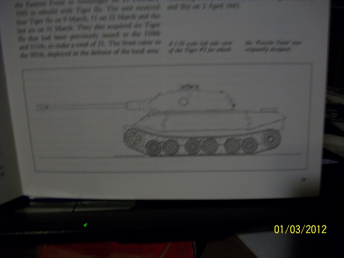

Picked up a new book today Fighting Armor of WWII SERIES. King Tiger Heavy Tank 1942-45.So far for a small book 47 pages it has some very detailed charts and specific data on gun types,evolution of the drive train,turret data,just alot of specific engineering information and little speculation.This is exactly the type of book I prefer.
One interesting sketch of the Porsche design the Turret was intended to be mounted on seems similar to your build,Boogies as a suspension system. Here is a picture of the sketch.
Caption reads-A1/76 scale left side view of Tiger P2

vk4502p.....the porsche bid for the kingtiger contract....
you can get one here....
http://www.ludwigs-hobby-seite.de/vk4502Turmvorne.html" onclick="window.open(this.href);return false;
