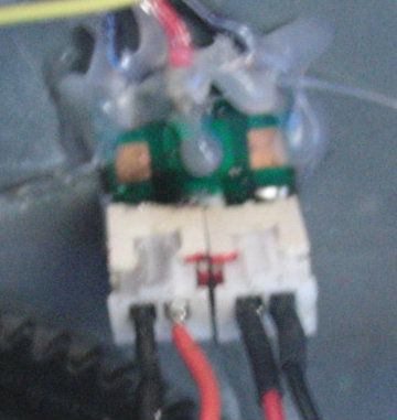

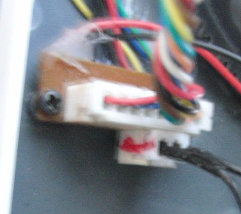

Been a bit of a ball ache to get this sorted but pretty well done. From the last post I sorted some electronics, decided to make the upper hull and turret easily separate-able. The two places I had solder joints was the elevation and recoil motors, and the co-ax mg. I simply soldered in excess plugs (from the Mato Sherman board), so now its just three screws and pulling plugs out to get the turret off;
Above is the small board for the turret wiring, I just moved it out the way and soldered these two plugs, the inner legs of each plug connects to the shared positive.
This plug piggy-backs off the ball mg wires.

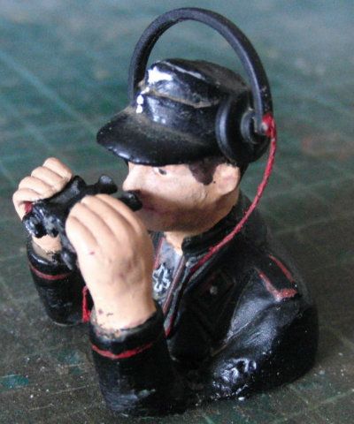

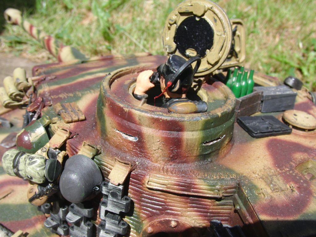

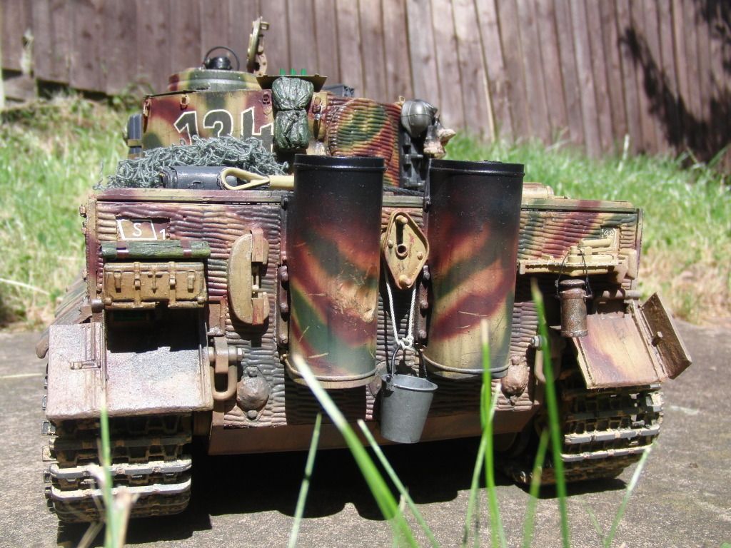

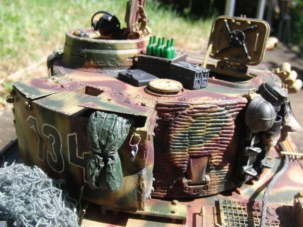

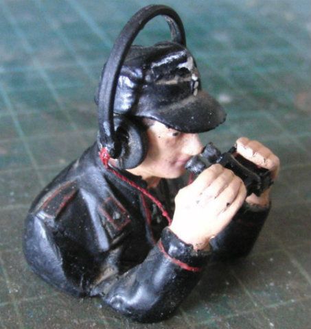

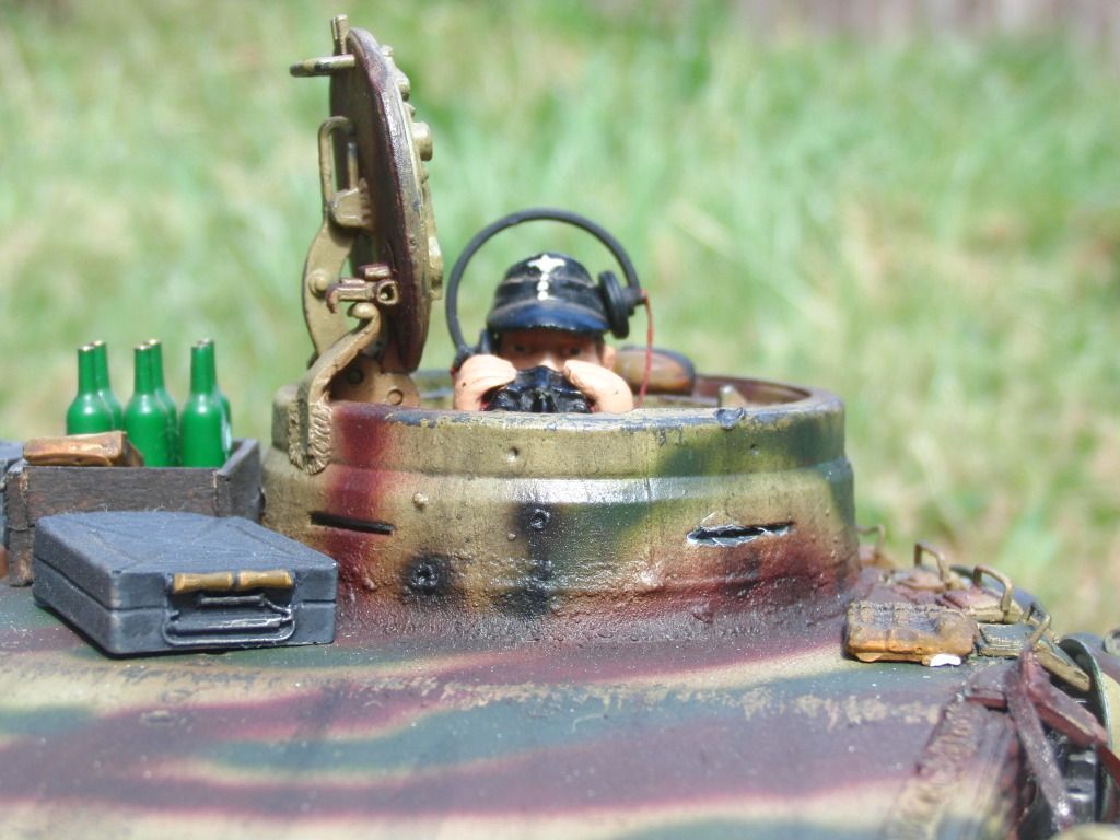

I spent a little time making a commander figure who can stay in in battles, with his head just poking over the cupola edge, quite liked this idea I saw on a 1/6th Tiger. I chopped a spare HL German commander figure down and repositioned arms to hold binoculars to his face;
I also removed his hat, made up the missing bit of head and repositioned the hat so it didn't look as stupid as it normally does;
The headphones were altered too to stay in place properly, revealing the ear I added
I followed this ridiculously awesome face painting tutorial: http://www.scale-models.co.uk/figure-tu ... g-ray.html
But it didn't work as well for me (poor quality model with little detail...honest)

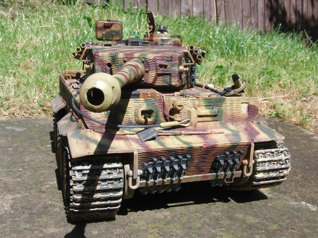

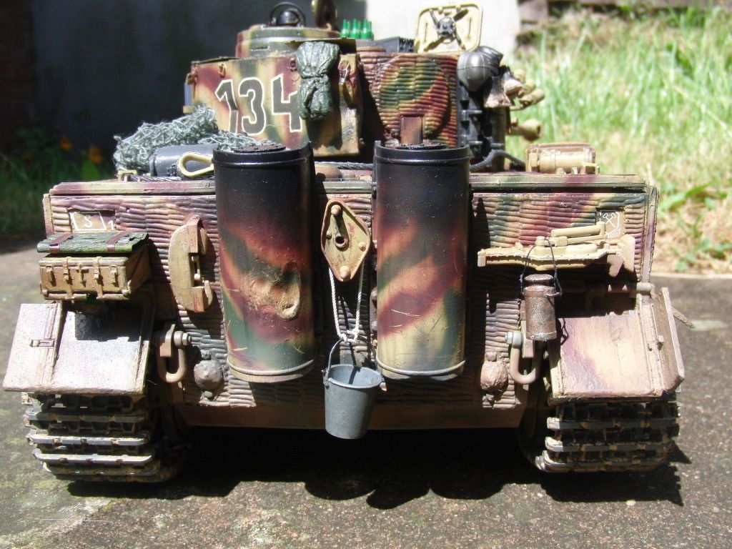

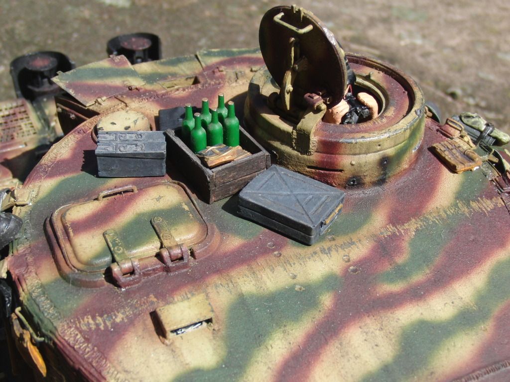

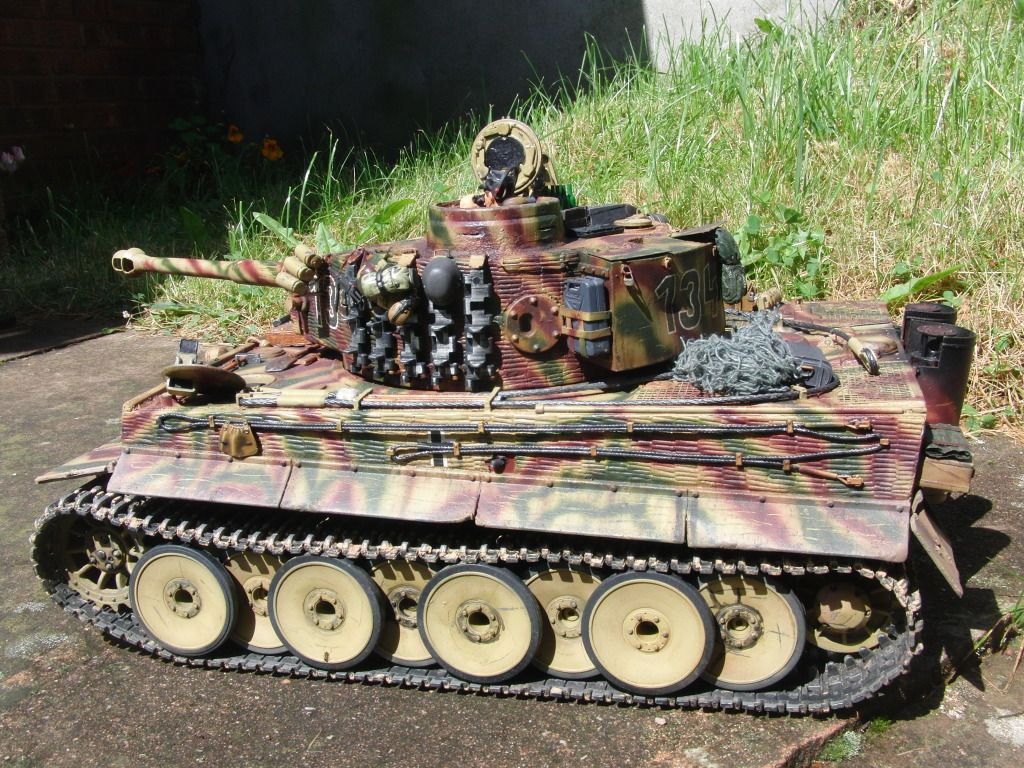

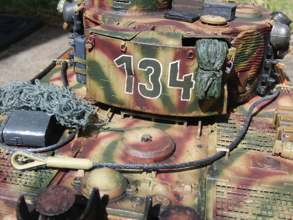

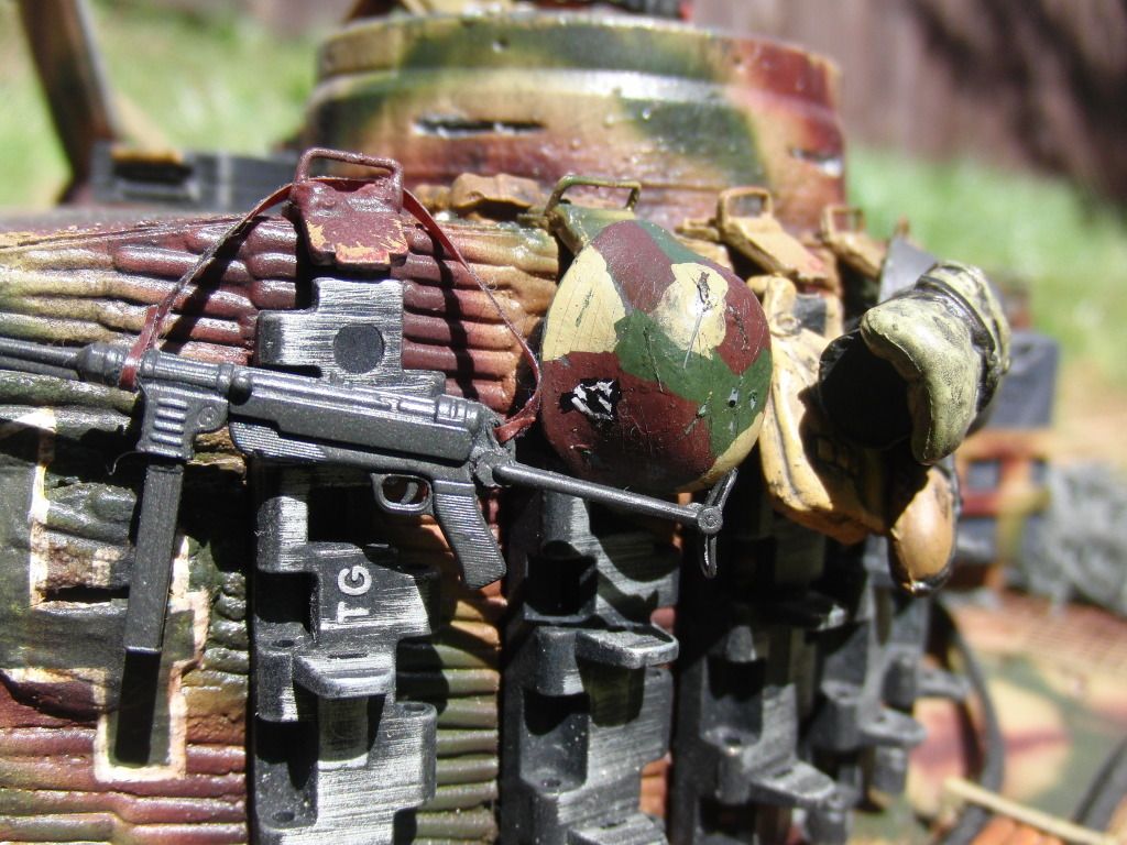

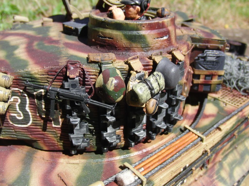

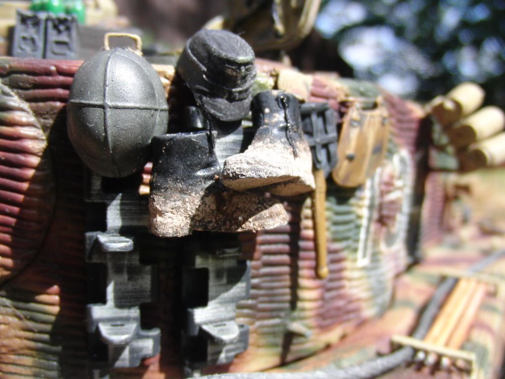

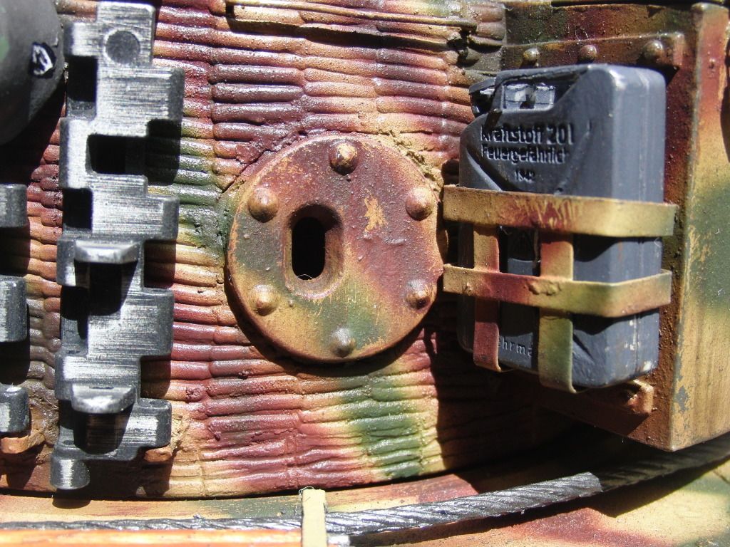

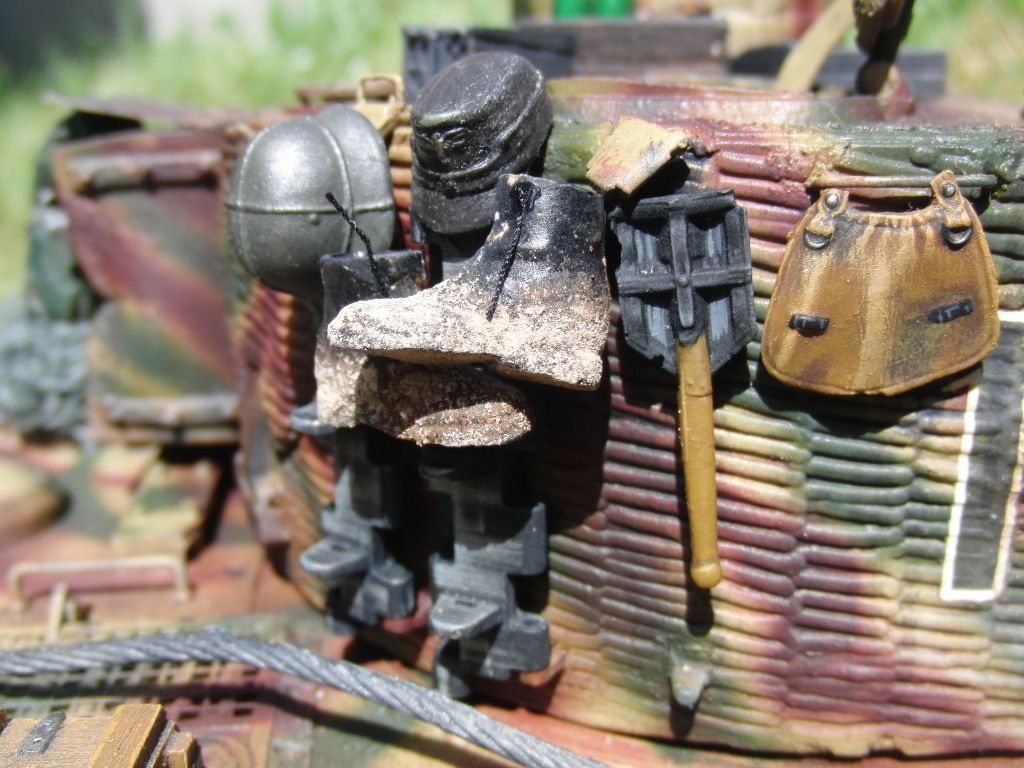

So weathering wise, it had slight pre-shading and sun lightened bits, all the while using the hairspray chipping technique (first go
) on all layers and colours separately. Then when happy with camo it was given a light dust coat (Buff), then shadowing followed by a dark brown oil paint wash and some other oil stains etc. Then came rain streaks with oil paints before a final dusting coat (Buff again) with some variation in Flat earth. Was sealed after with Pledge floorwax (Klear), then Plasti-kote Krystal matt varnish on (supposed to be) metal parts as it is more of a semi-gloss, and matt varnish on all other parts

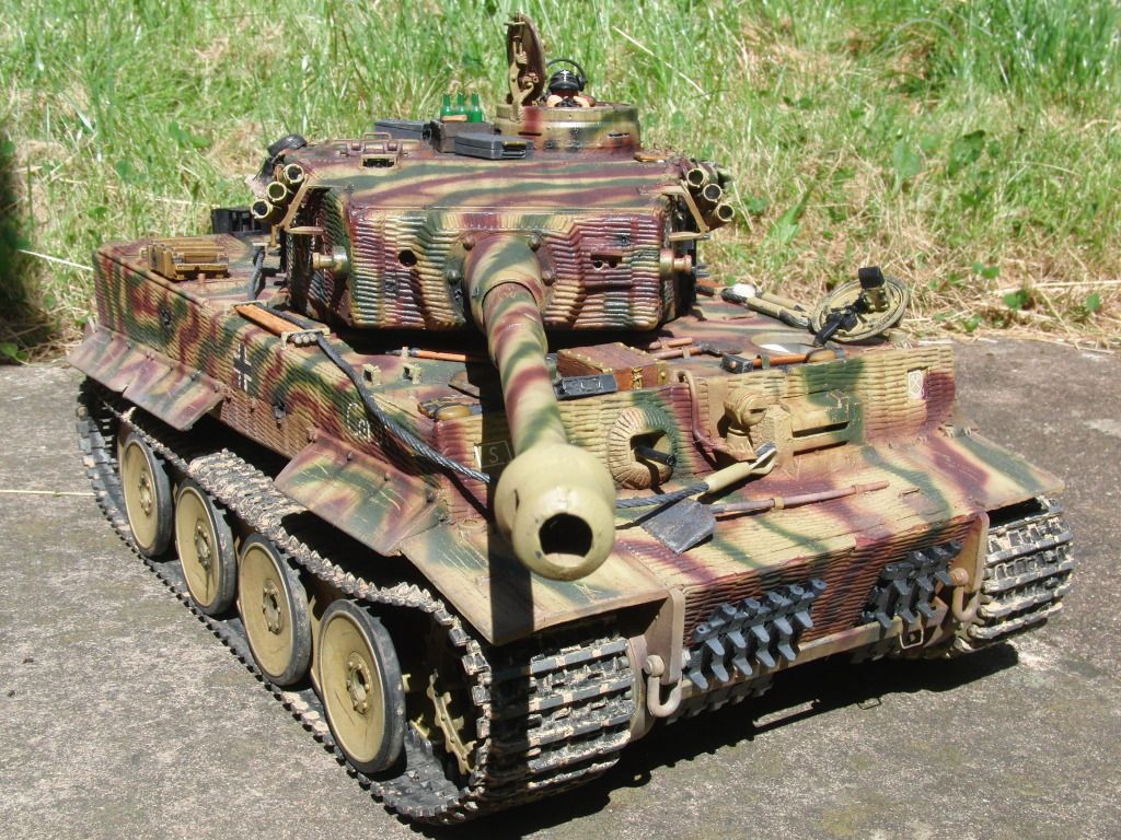

Now normally I don't post pics over 640x480 so anyone can view on any monitor, but I have put quite a bit of effort in this bugger so pics are a bit bigger
Hope you guys like;

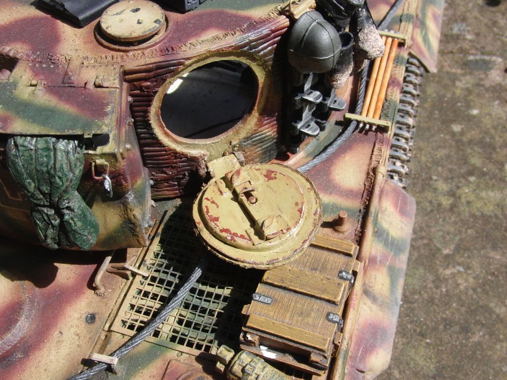

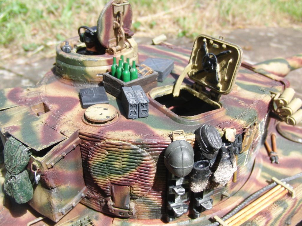

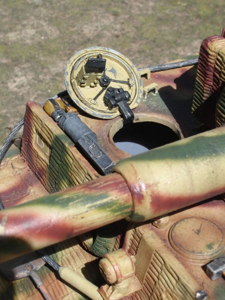

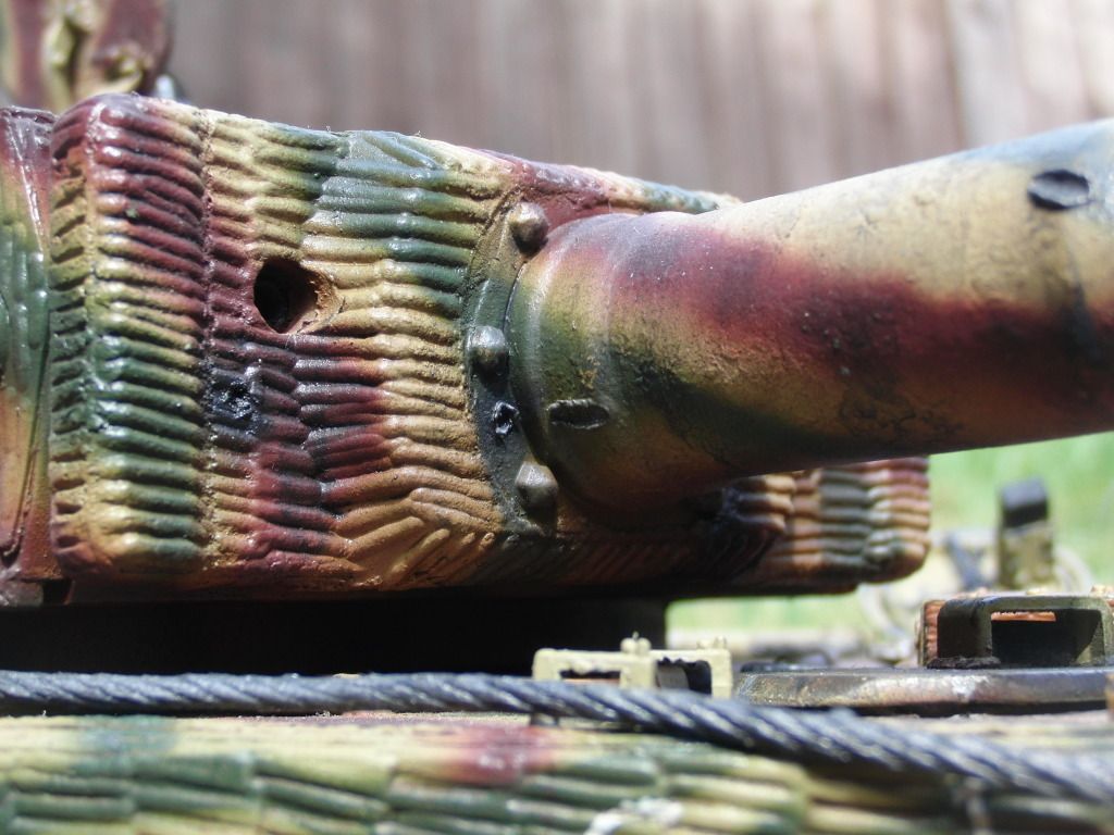

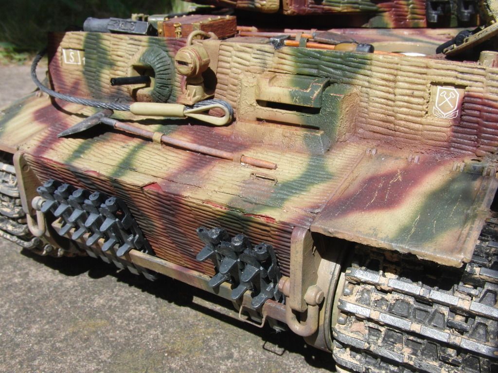

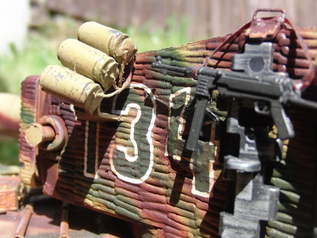

Wanted to try a wedged dud round, I like how it looks but it would have been removed asap I guess in reality;
Just noticed I messed up the SS symbol here, will correct;

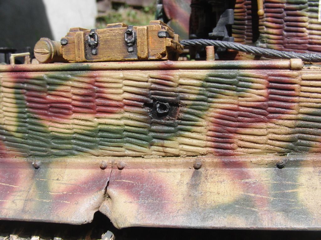

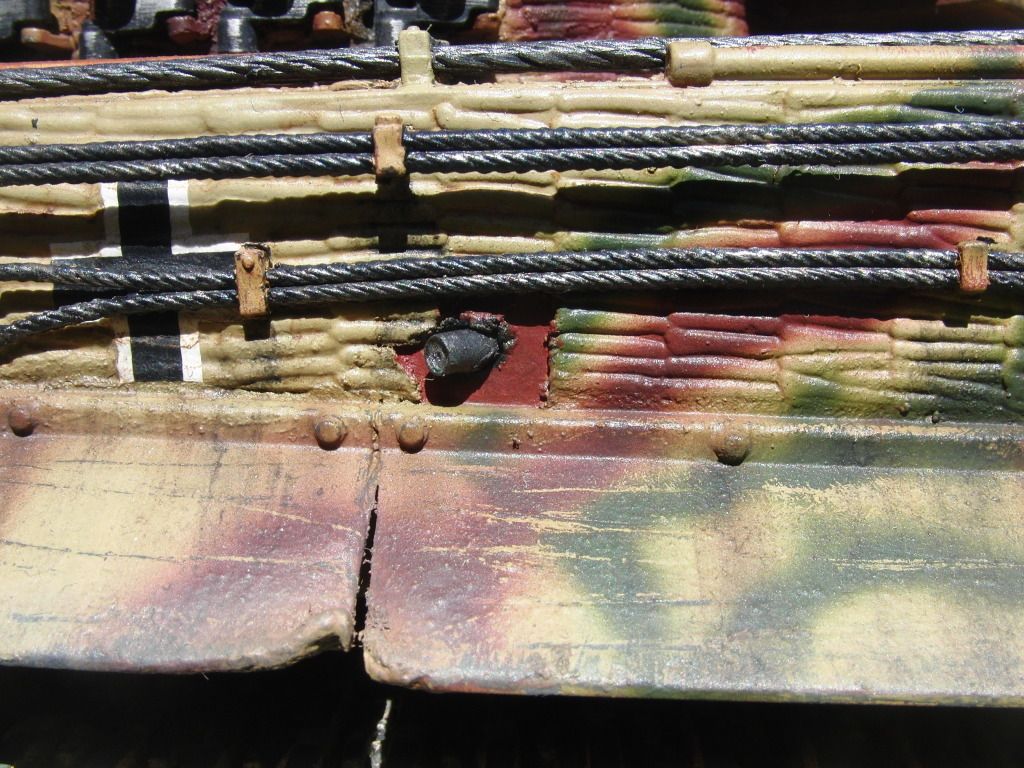

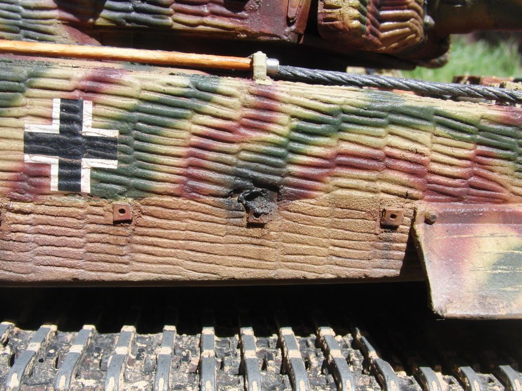

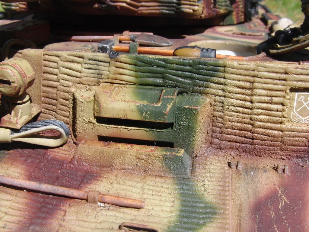

The reason this skirt section was removed, a damaging shot;
The flaking on the three was going to be corrected but I like how it looks
Cheers guys

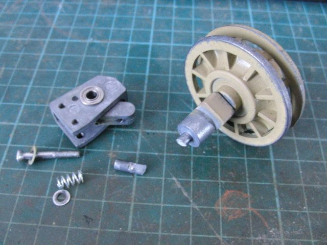

) probably due to slack tracks. Turned out something had been getting worse until it broke;
Stupid white metal parts!

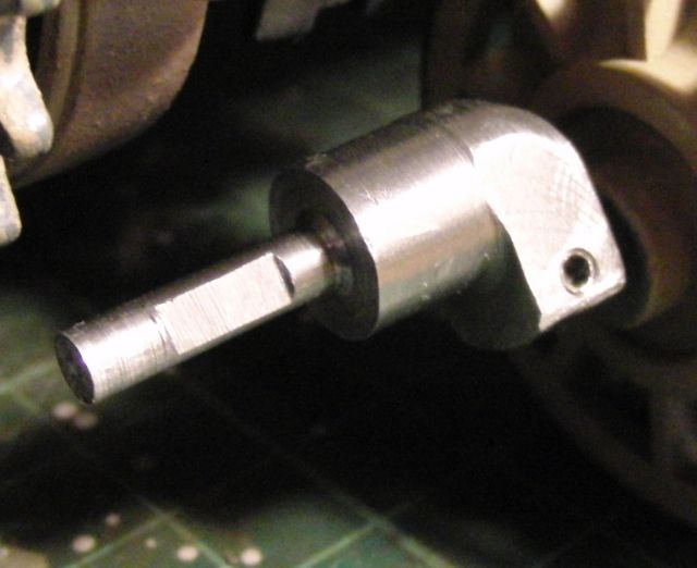

So was thinking about buying replacements but a few people suggested fabricating an alternative. I talked to a chap at work about threading a bit of 4 mm rod and drilling and tapping a hole for it, and he came back to me with this
A perfect replica including a tapped hole for the grub screw, I wasn't expecting that so Jerry, cheers mate

Looks great. I know of several broken Asiatam idler arms. Thats not a bad idea to fix it! I did fint it a bit hard to adjust so I simply replaced the whole unit with Henntec track tensioners.

I really like that - love the camo scheme and the detail. Those muddy boots are great.
