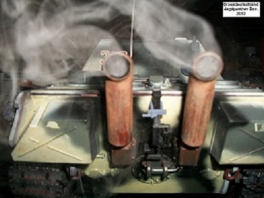

Saxondog
Posts: 4293
Location: Tennessee-U.S.A.
Re: New to this and is this any good?
Post by Saxondog »
The smoker are notoriously bad units,if they ever do work it is generally for a very short period before the damn thing burns out the very weak wire heating resistor.
Their are several topics on these units,how to upgrade them, modifications and opinions. I was involved with another member in this search for a better unit,and I can say he made one that works,and keeps on working.
The units were sold by Phil @ RCTANKWARS,they are much smaller not than the original units and seem to work very well.
Super Smoker By Walkabout
Jagdpanther Smoker Test 002.JPG (93.92 KiB) Viewed 1405 times
http://rctankwars.com/Products.asp" onclick="window.open(this.href);return false;
