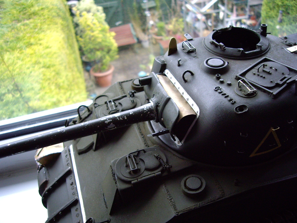

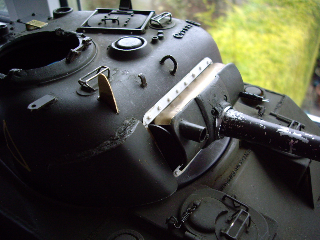

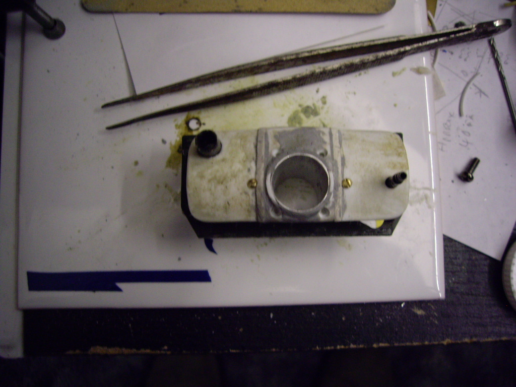

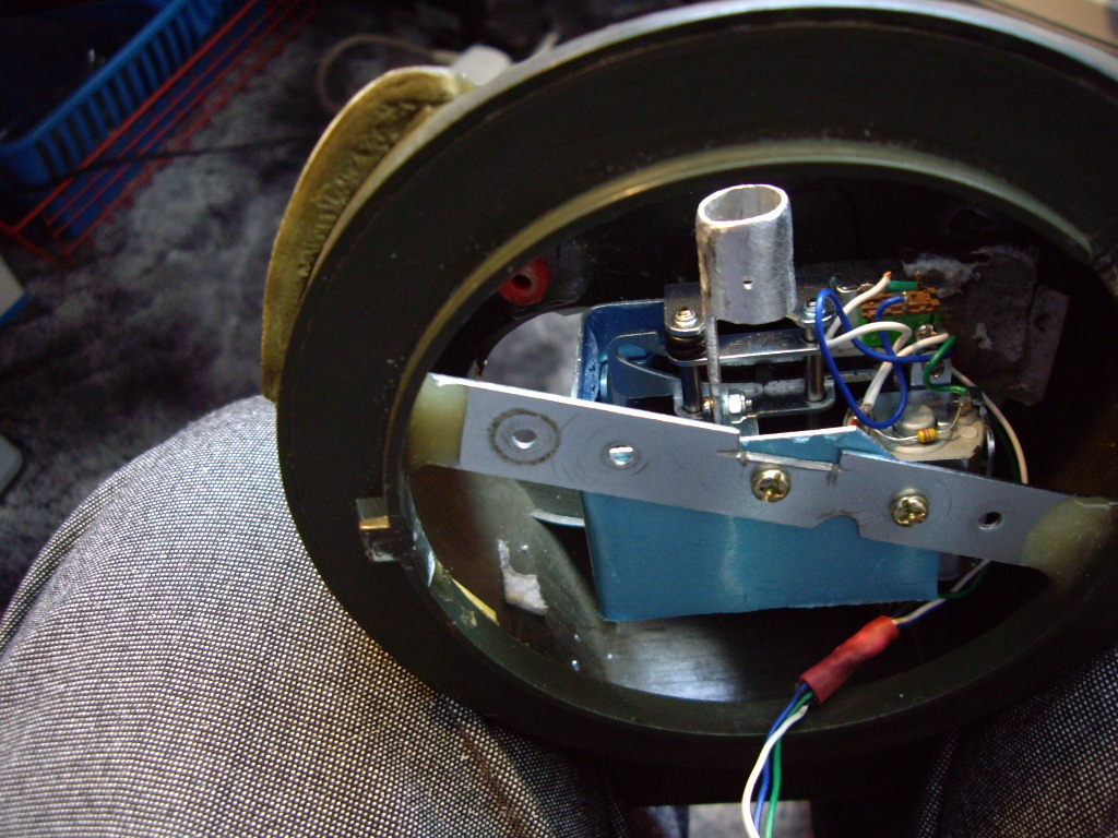

so we move forward ......the mantlet the hole opened up by another 4mm this to bring it back where it should be,,,the recoil is a tiger 1 type as yet un modified, you must bear in mind that this is the old type turret and is slightly smaller at the bottom, the new turret is 2mm wider .
extra work on the mantlet had to be done as i made it removable, this with brass strip soldered nuts and great deal of thought and hair pulling and i do not have much of that too start with :haha: :haha:
at last the pair wait to be put together.......
slot for blade sight..plus cast numbers
more brass this time the blade sight and a thingy that sits on the turret roof sorry no idea what it is?

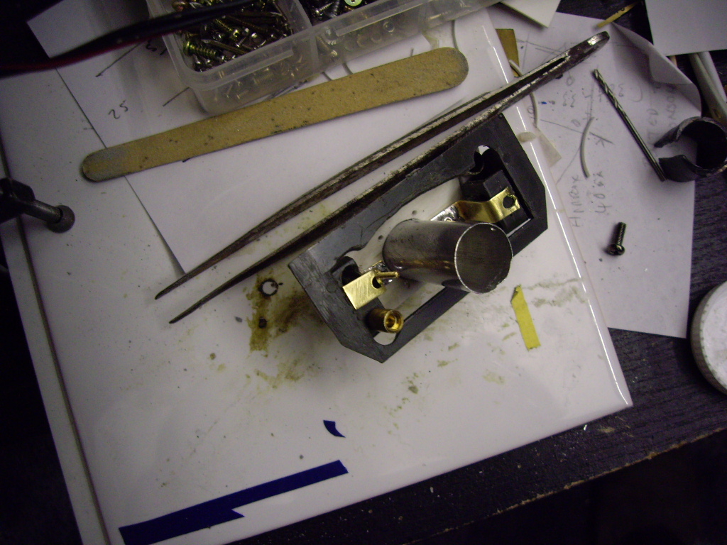

the back of the mantlet with the brass fitted.....
the mantlet with more work done on it.......
from underneath
from underneath
recoiled fitted
recoiled fitted

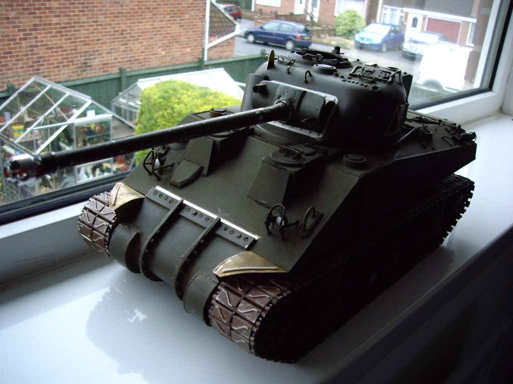

well was it worth it    ... i think so........<br />Thats all folks..........<br />fleshy.............................

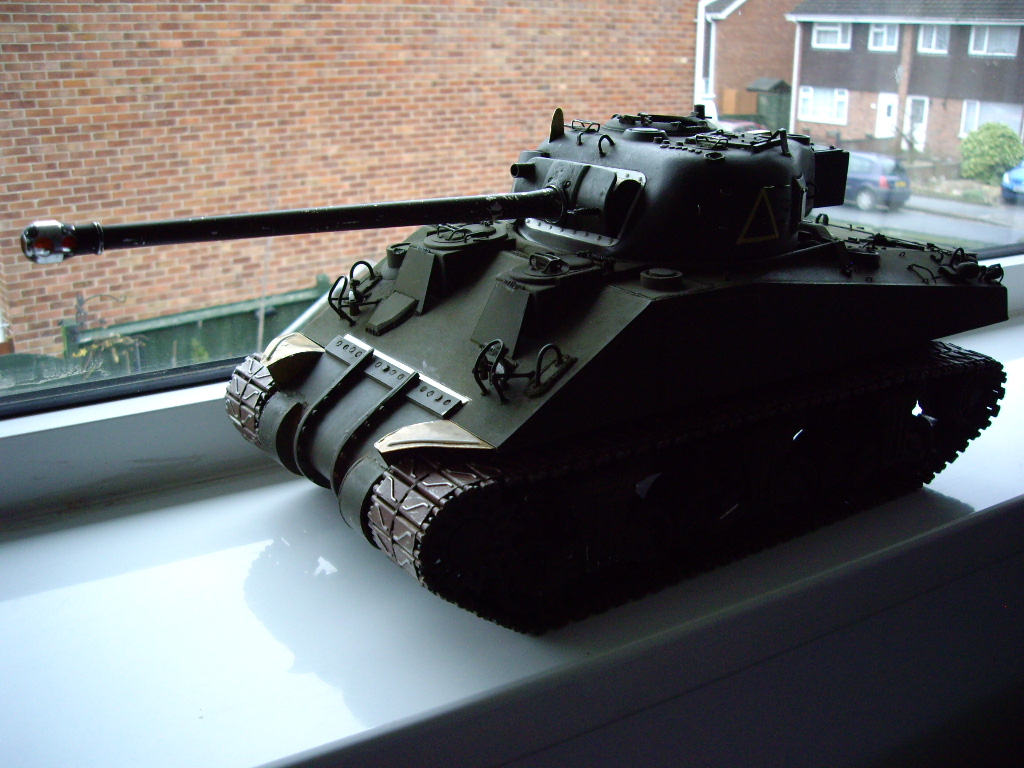

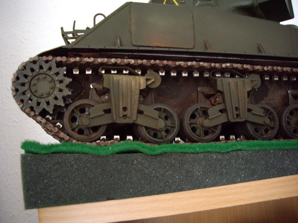

this shows her profile well i think just before painting..

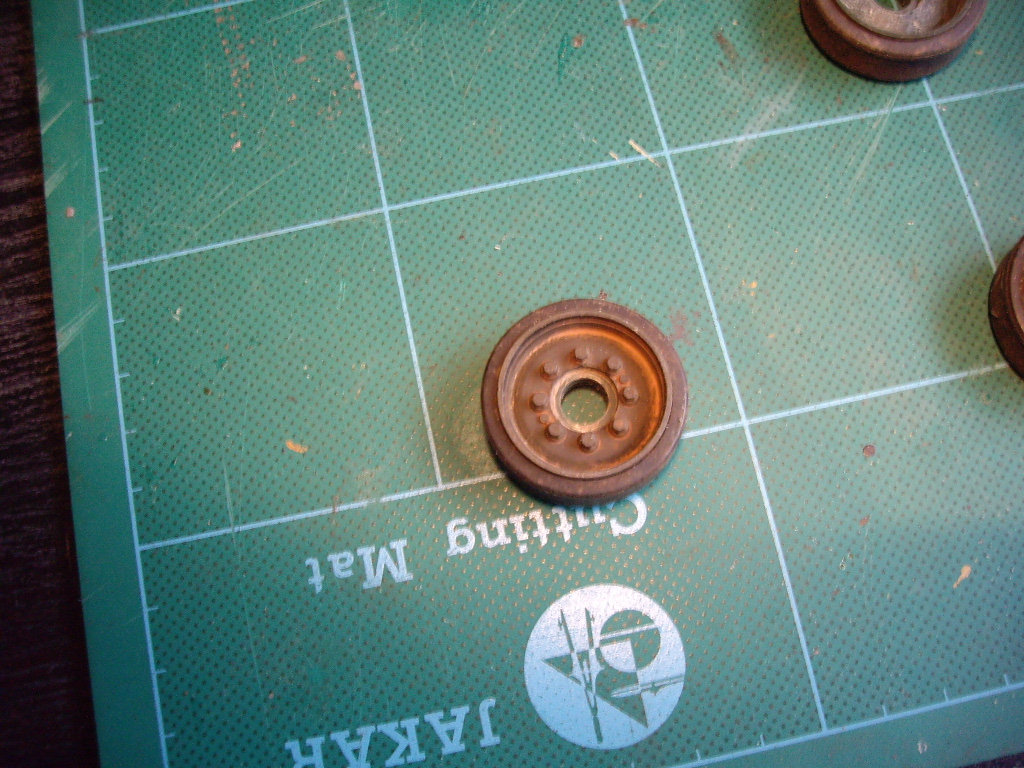

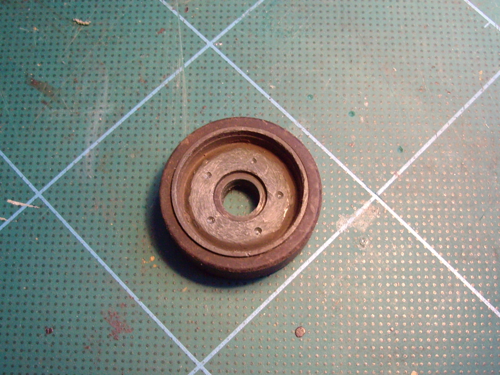

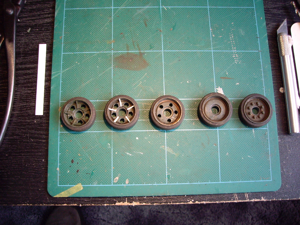

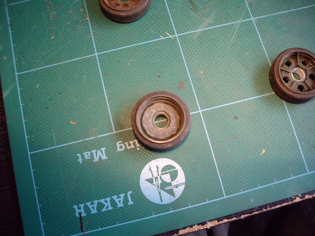

this shows the five steps that go to make each wheel the round holes are squared and then the fins are added,, do this twelve times ,,i found that making about one a day was enough..
mark your wheel at 72 degs five times or 36 degs ten times as one mark will be for the holes and the other for the fins........
grind  down the nuts like so.......
take one wheel thus..........
this shows the finished vvss covers and finished wheels note also the fact that i have brought  out he centre part to be almost level with the sprockets as they should be this was done by adding some 15mm copper pipe to the nut plate and a push fit was sufficient to hold it in place.........

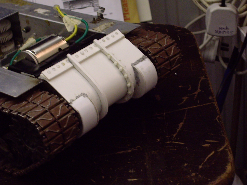

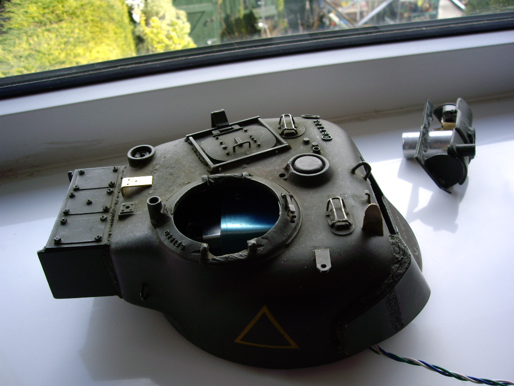

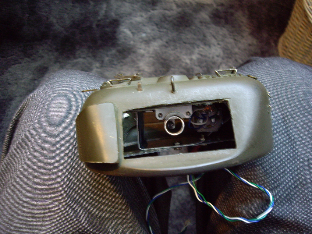

the new mantlet surround from plastic card and rod and square strip again for the nuts also the cover from more brass note the ally barrel surround has been thrown forward this will require more work soon but the piant will hide this for the time being

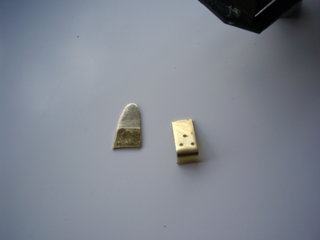

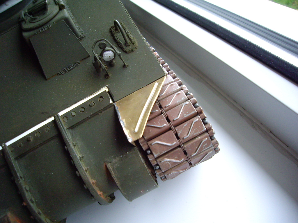

the new brass fenders which are bolted to the metal bottom hull and not to the hull it,s self..........
