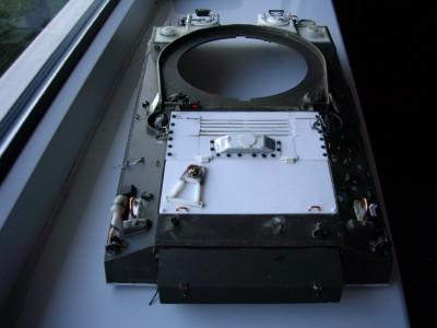

Take one 1974 tank and convert to the Firefly M4A4 hulled model........
first the old hull.....

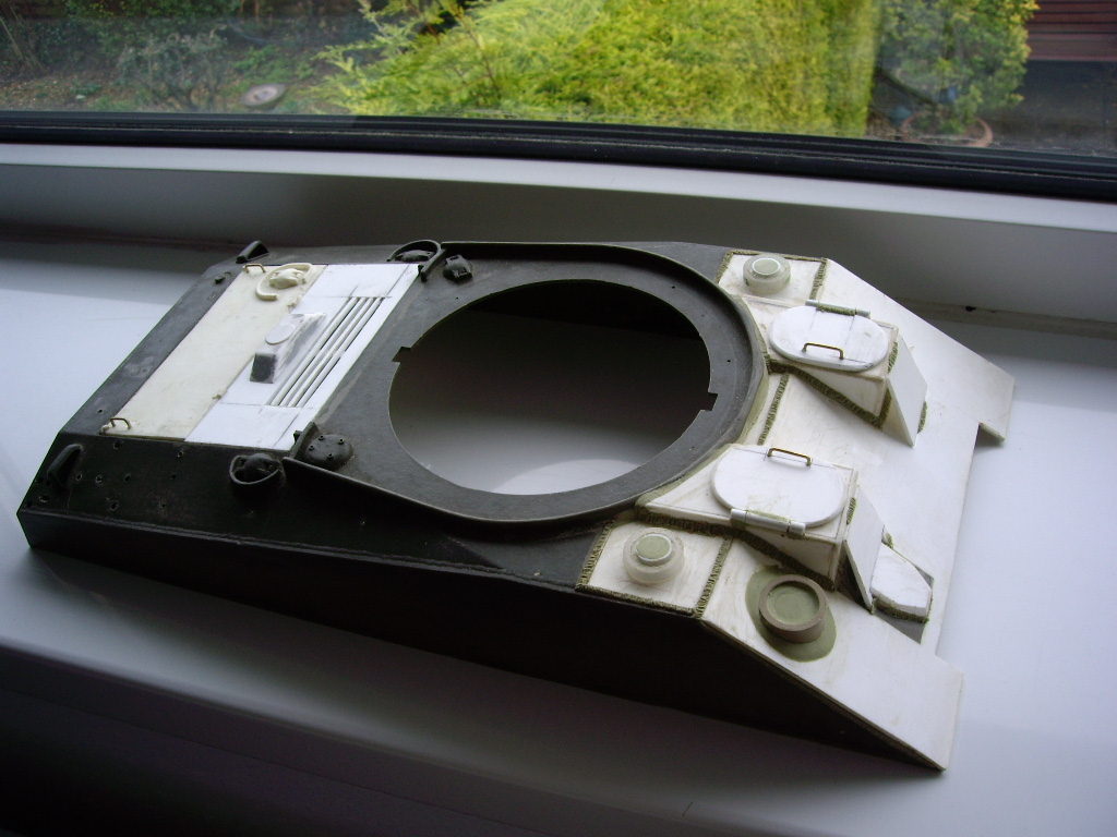

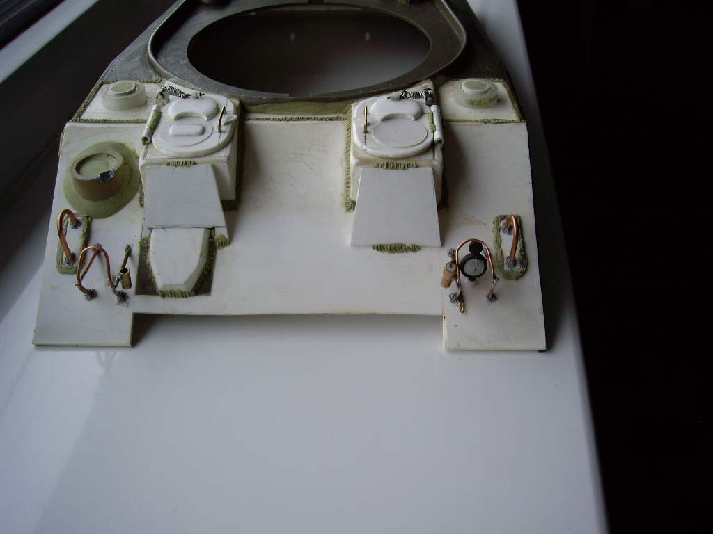

hatches with raised tops and perscopes circles added also the latch ..this as with the whole of the build is totally scratch built.....

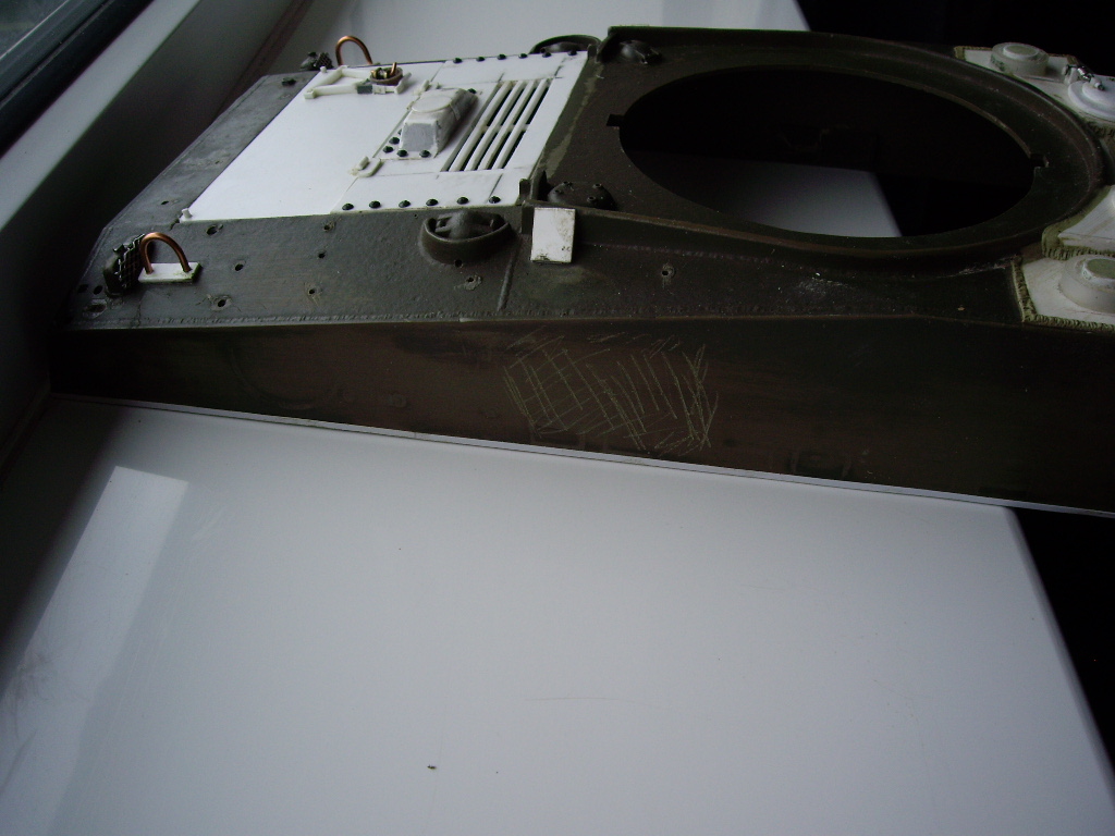

rear deck removed and a small hinge added to the water tank top.this from plastic rod with two saw cuts in it....

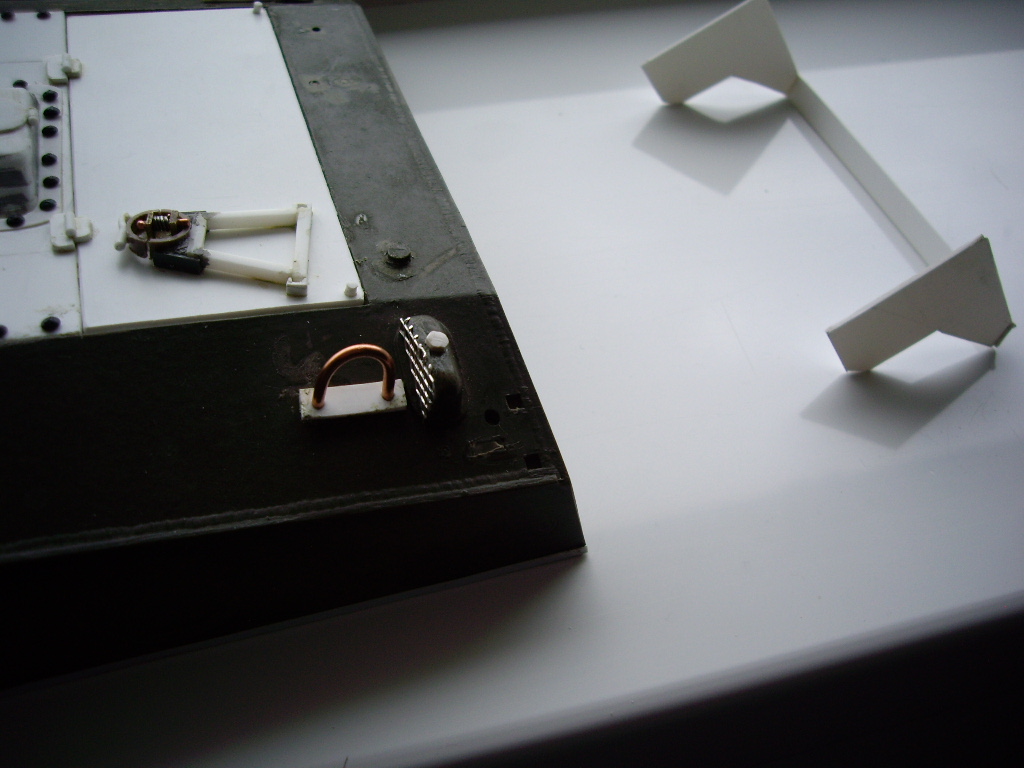

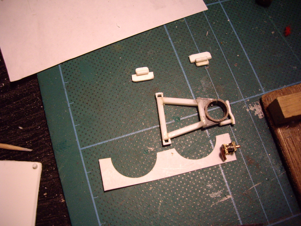

the gun crutch no less than sixteen pieces in this item and the new rear deck hinges

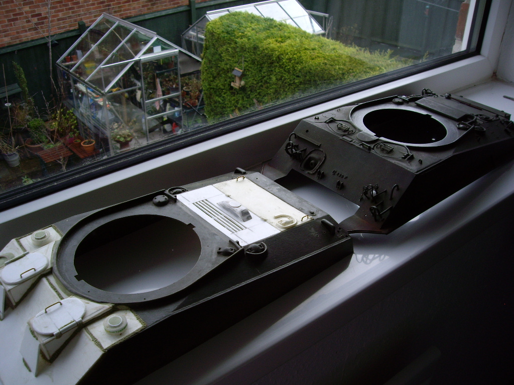

both hulls ...the rear deck of the new will be replaced as they did not have a refill gas cap on the rear deck.......
new hull modded by Septon,,i am aware that the hatch hinges are incorrect but needed to be strong for the use that they will get........

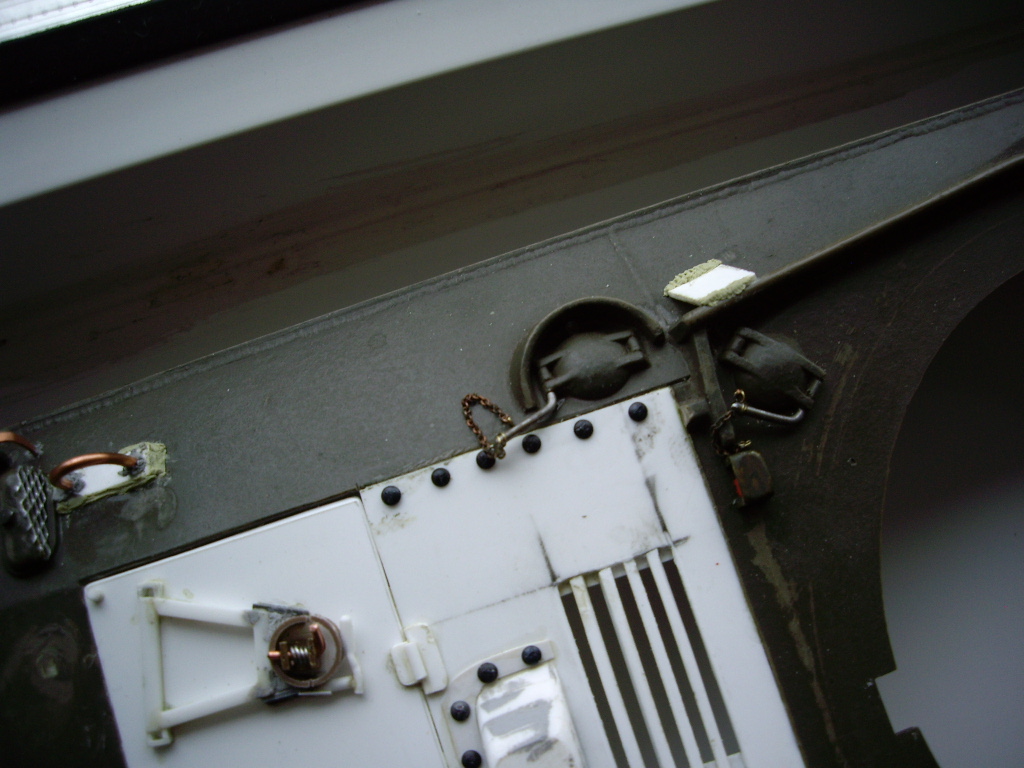

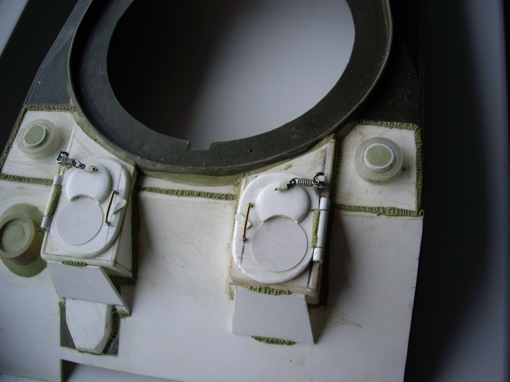

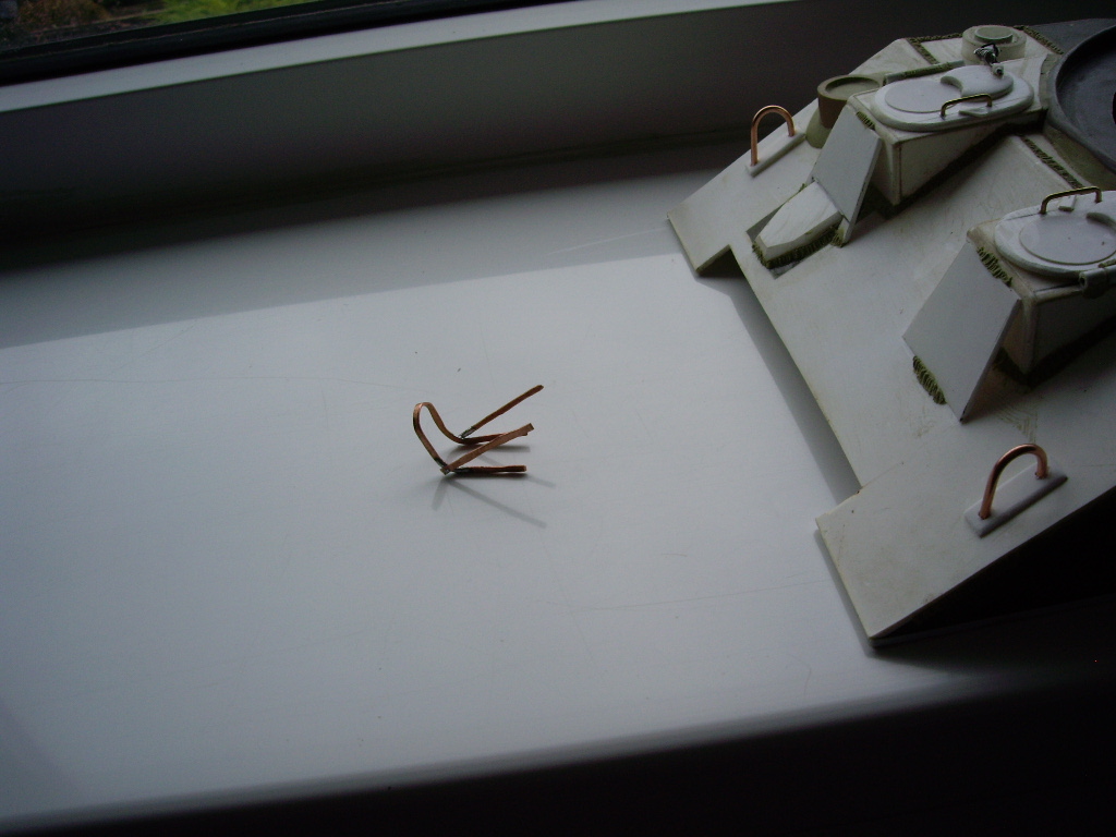

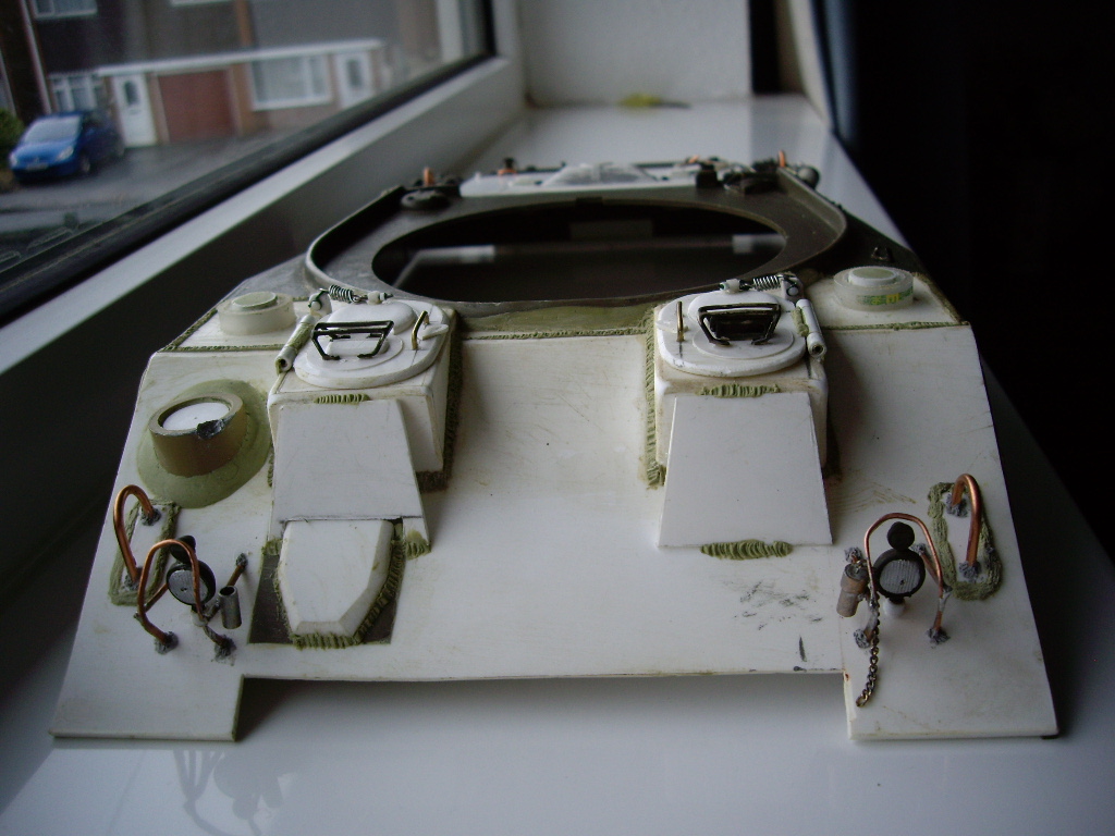

springs have now been fitted to the top of the hatches this from plastic and fuse wire not spring steel as in need to open these hatches a lot..
the bolts have been added and also a raised lip around the water tank

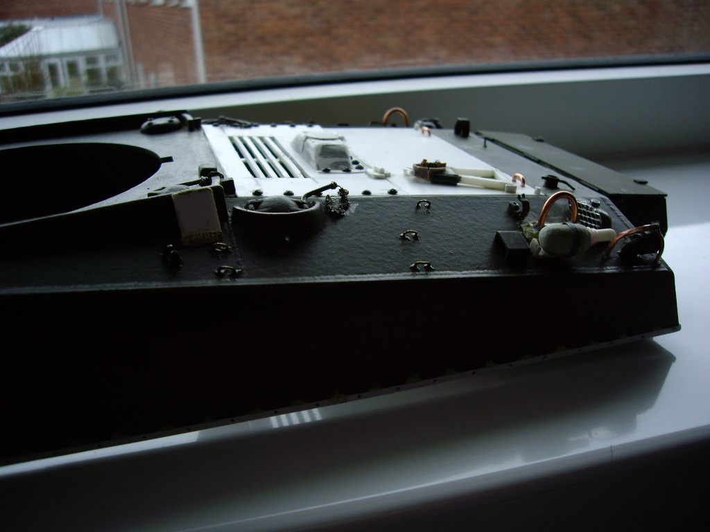

this shows the mesh fitted to th rear air intakes also the bolt on top, but i replaced this later with 12 ba bolt

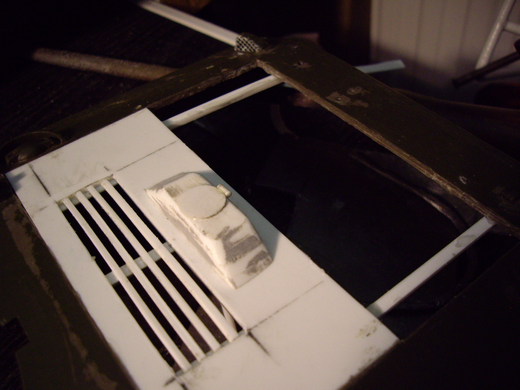

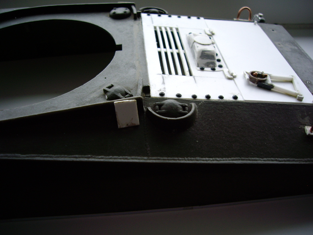

rear deck fitted with the gun crutch and a flap fitted to the front of the water tank refill

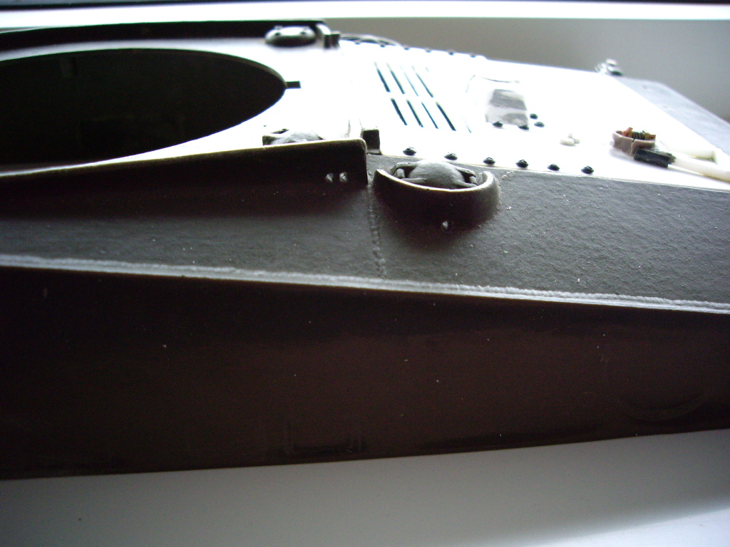

this shows the start of adding additional armour to the hull sides also note that the strip of plastic at base of hull this for the dust guards to be screwed to in the later pics you will see that millput has been added to look like it,s been welded and the holes will have been drilled........

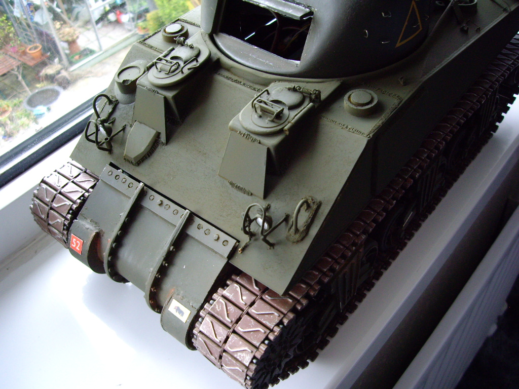

front light brush guards made from copper  wire beaten flat and then shaped and soldered

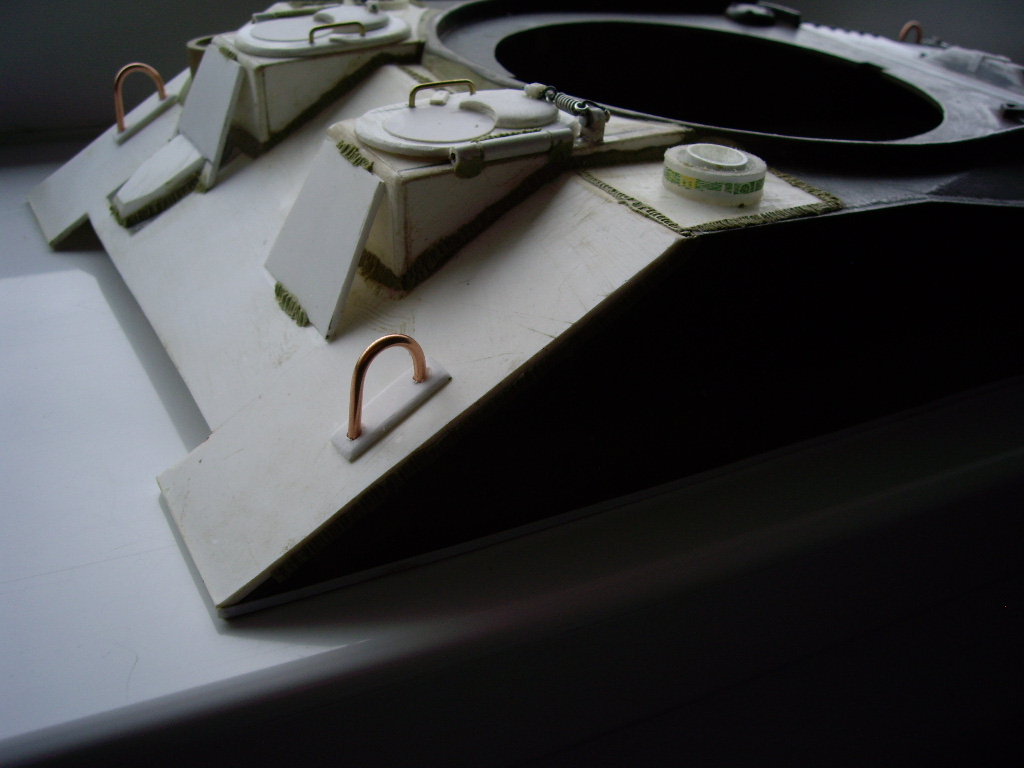

front lifting rings now fitted

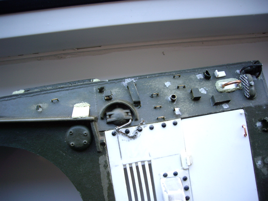

note red fire engine extinguisher handle built from plastic rod and flat evergreen plastic sheet.........also rear toolbox added

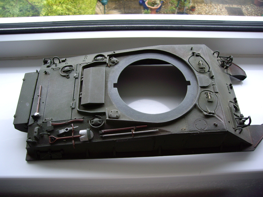

the other side of the rear deck with holders etc.........
now we start to fit the tool holders and tie downs also note the rear fire extinguisher made from plastic rod and millput seated on plastic frame

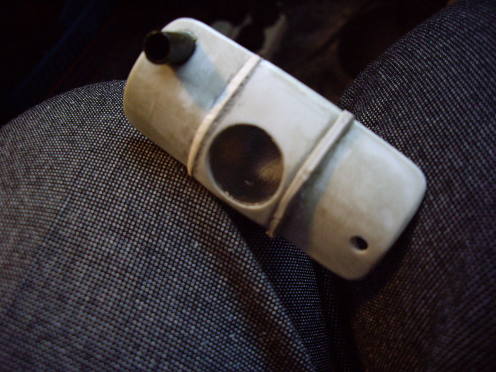

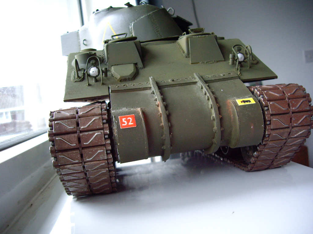

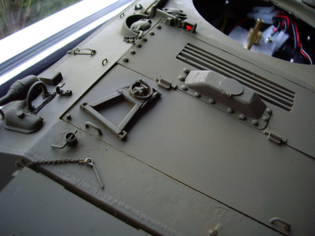

so now we try a first coat of paint ..also the new tranny cover built from plastic card and pill boxes this is only a prototype but wiil stay for the time being, as i had to use lead sheet to get the shape of the front also used it to get the shape of the flanges of the three cast hull ,, the nuts and bolts cut from plastic rod some heated also a square one for the nuts and thin one for the thread wow it ,s not easy ...........
the new mantlet  added the tube for the ir emitter also drilled hole for the 30 cal machine gun had to widen the middle section withe strips of plastic square rod and then grind it down at about 45 %

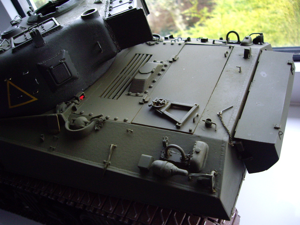

close up of the rear deck..........

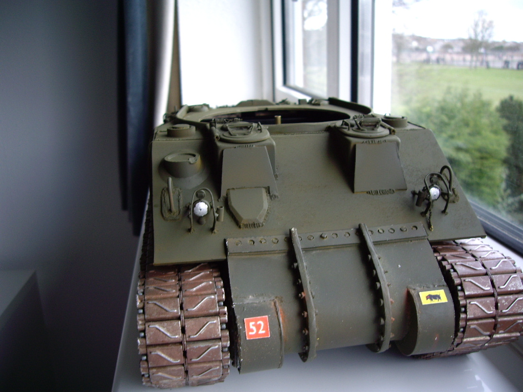

first coat front
first coat front
first coat rear
first coat rear
