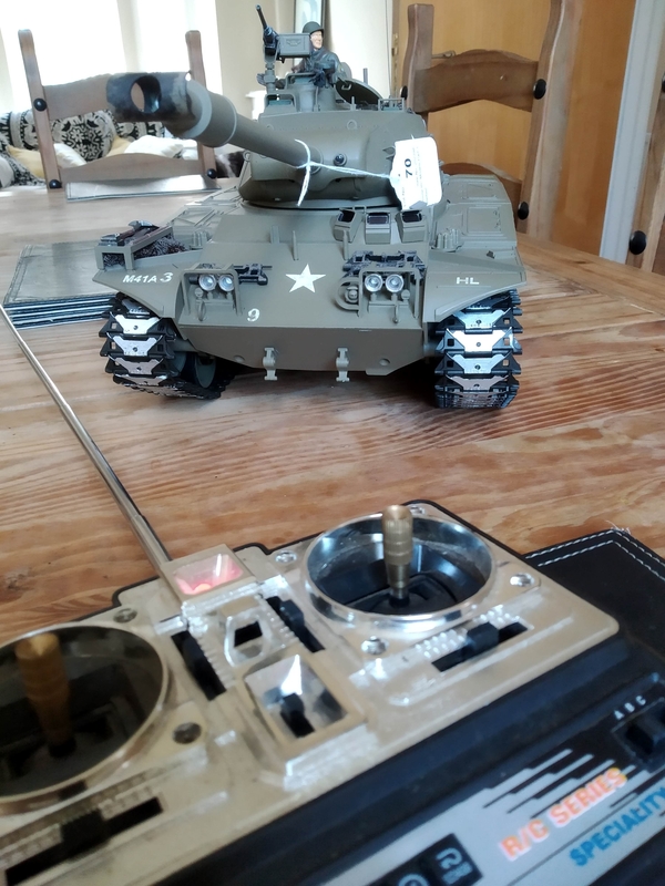

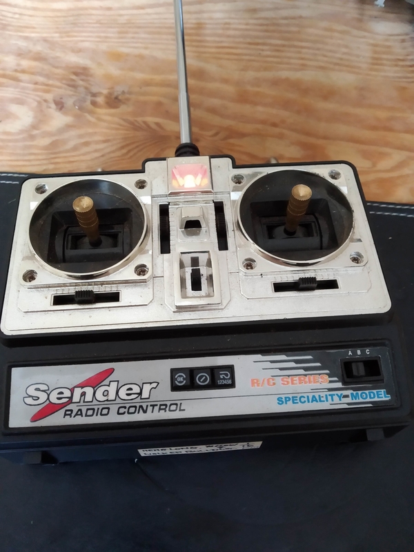

Re: Hi - I need some help my old tanks moving
1. Thats the image of controller
2. the controler with the bulldog walker
I switch on the tank with the on button underneath and switch on controller position A on both switch ok and that should start the tank.
But that does not work.
Question is battery too weak it was checked. Is it something else. Thats why I come here for guys with rc experience
Hi sorry if ive missed this already....
do the lights turn on and flash on the tank? If not try a fresh battery.
Regardless of the radio if the tank is OK to run, the headlights should turn on and flash. Once this is accomplished, the engine button on the radio will start the engine and lights will stay on solid.
You put the controller switch in the A position.
And you put the similar switch under the tank to the A position. Maybe try the centre B position on both, just in case a switch is the wrong way around or a wire has come loose.
It may be an idea to try all three positions, and the A on one, and the C on the other.
