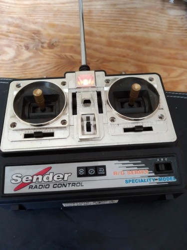

1. Thats the image of controller

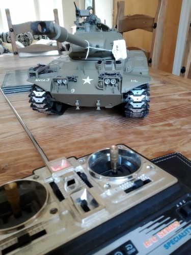

2. the controler with the bulldog walker
I switch on the tank with the on button underneath and switch on controller position A on both switch ok and that should start the tank.
But that does not work.
Question is battery too weak it was checked. Is it something else. Thats why I come here for guys with rc experience :thumbup: .

After charging the battery second tank has started working surprisingly. Its pershing with 1 number controller.
I have switched the battery between the tanks bit only Lights are flashing in walker - no movement.
Now Im charging last tank pantzer3.
At least one is moving.
I hope to get walker to move because he was the most expensive one.

Yes lights are on and are flashing. Im not sure if the remote is from that tank because it was another walker on auction.
It looks like Im missing connection between tank and controller.

You put the controller switch in the A position.
And you put the similar switch under the tank to the A position. Maybe try the centre B position on both, just in case a switch is the wrong way around or a wire has come loose.
It may be an idea to try all three positions, and the A on one, and the C on the other.
