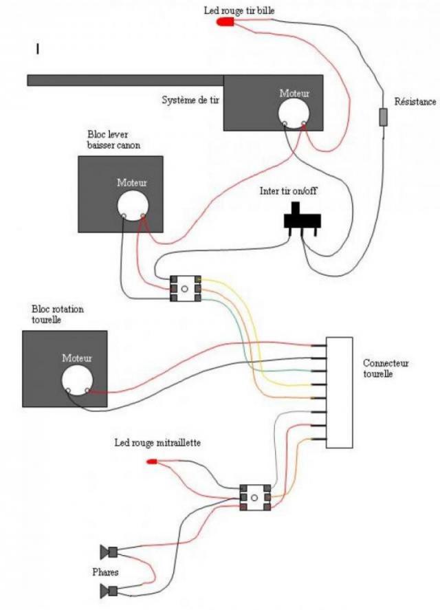

[attachment=0]D799D238-BE27-4A62-972B-AED98E50A21D-4335-00000603A01C5904.jpeg[/attachment
- D799D238-BE27-4A62-972B-AED98E50A21D-4335-00000603A01C5904.jpeg (59.26 KiB) Viewed 1913 times

An update:
Firstly thankyou for the, I assume, a 5.3 Version pinout diagram.
The elev up/down operates when I toggle left/right on transmitter.
The turret left/right operates when I toggle up/down on transmitter.
No Airsoft B.B. Shoot operation.
There seems to be a connector rewire in my future.

Re: Heng Long Panther G uncontrolled super spin
Hello
If can help? Wiring diagram type for Heng Long,and color on 8-pin plug ?? Is this concerne due ?to a change of platinum,or others? Or appened senddenly
