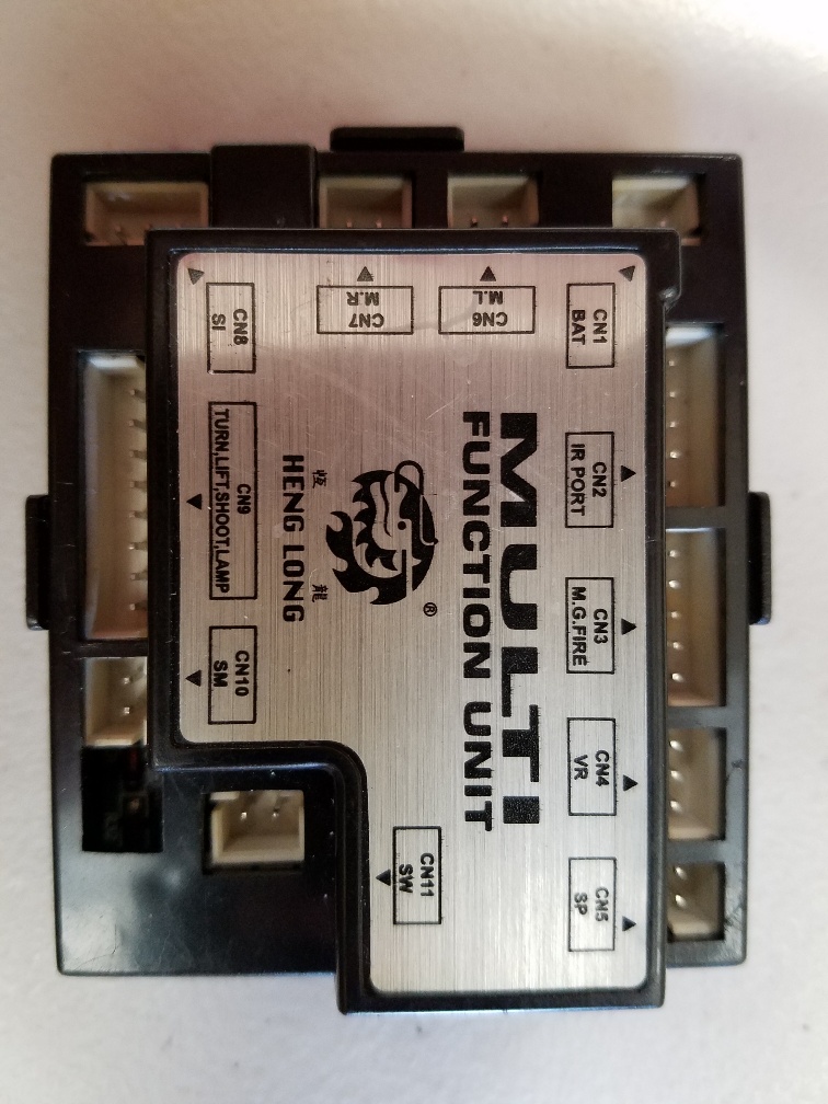

The original Panther G receiver is a Version 4.
The original Panther G transmitter is black label with silver lettering plus NO buttons on top left and right, only caps where the buttons would go.
So then to fix the Panther G uncontrolled spin I need to buy a Version 4 receiver, right?
I upgraded the Panther A from rx13 to rx18.
That means I installed a TK-YL101-3 with an 04 crystal as well as an 04 crystal in the old style silver labeled with 'Sender radio control' transmitter.
Upon Panther A power on (light on front of tank blinking) and transmitter power on (red light), ignition key on transmitter depressed. Motor sound came on and light on front of tank ceased blinking. Tracks worked: front/rear/turn. Turret traversed. Machine gun sound ok. NO cannon up/down and NO cannon shoot.
This means I have to rewire the 8 pin conn, right?

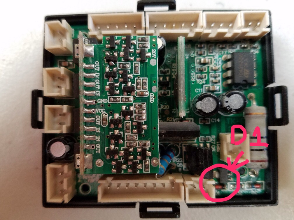

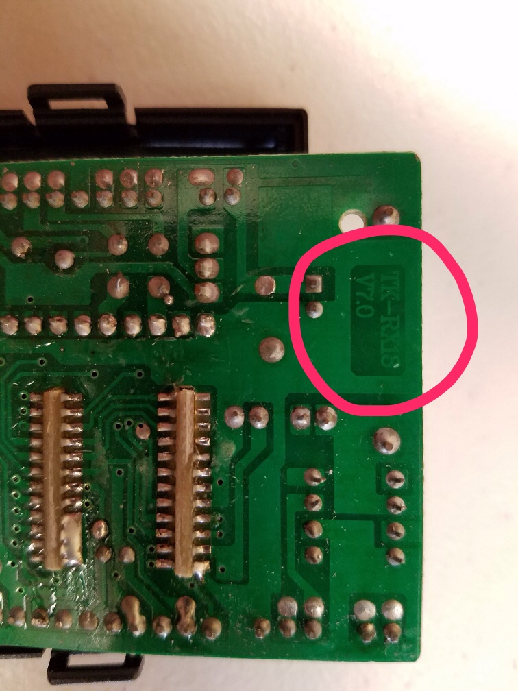

The rx18, ref picture, I received and installed in the Panther A had Version 7 inscribed on PCB, ref picture, and I noticed that I probably burned/shorted D1, ref picture.
This means I have to get a Version 7 rx18, right?
