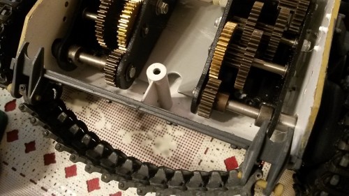

Here's some flash pictures of where it's at right now. I'll have to get some better ones outside and post them.
I've got a couple of rider figures coming to add on the rear. I'm still undecided if I want to do a dusty lower, or add some snow, like in the inspiration picture. I did some light snow on my other StuG III build and I liked the way it came out, so still trying to decide. I've got one warm weather rider and one winter rider coming, so I guess which one I like better will be the deciding factor.

Capt. Love the turtle , those gear boxes are such a scale speed and the driver is amazing , you gotta show me some fiber optic tricks sometime . I'm still seeing spots from that strobe lol
