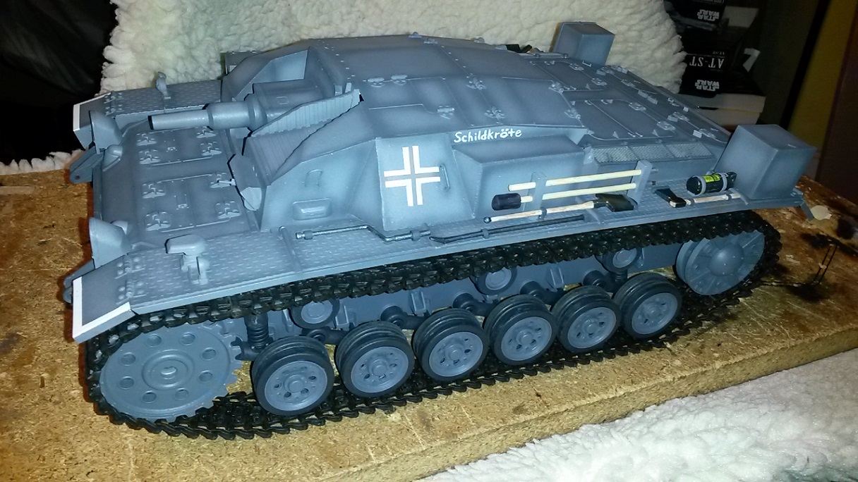

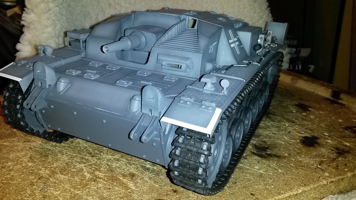

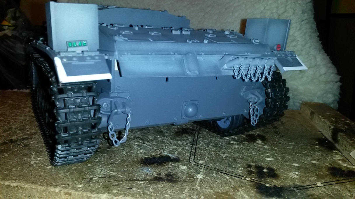

Here's some flash pictures of where it's at right now. I'll have to get some better ones outside and post them.
I've got a couple of rider figures coming to add on the rear. I'm still undecided if I want to do a dusty lower, or add some snow, like in the inspiration picture. I did some light snow on my other StuG III build and I liked the way it came out, so still trying to decide. I've got one warm weather rider and one winter rider coming, so I guess which one I like better will be the deciding factor.

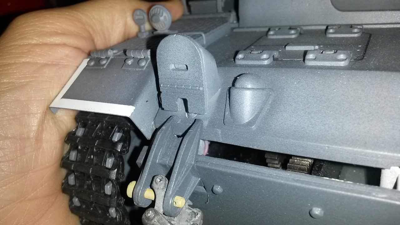

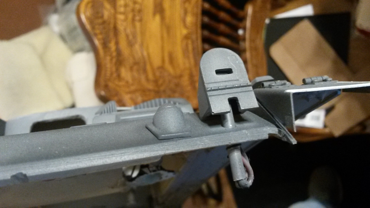

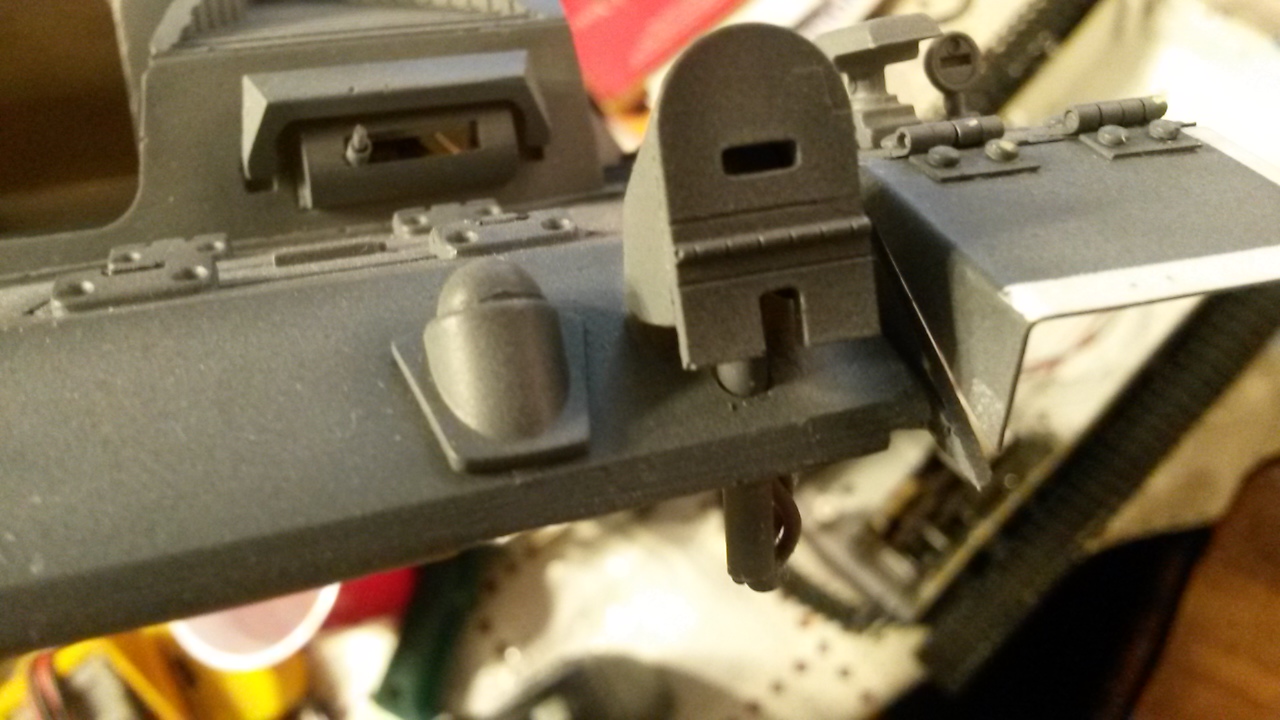

Here's some more detailed pictures on how I mounted the headlights.
I used the plastic tow shackles as I figured they would be stouter than the resin parts. They are mounted to the lower hull.
For the headlights themselves, I put heat shrink over the leads, bent them over to 90 degrees, and hot glued then into some aluminum tube. I painted the interior of the resin housing with several coats of black paint to act as a light block. I then put some hot glue inside the light housing, and pushed the led into it. A bit more over the LED, and it's not going anywhere.
I put the upper on the lower and marked where the tubes would go through the front plate, drilled a hole, and using the tow shackles to line everything up, hot glued them in place.
Another angle
I didn't put any alignment pins in the magnets, so the upper hull just slides forward into place.
I had thought about mounting the lights and shackles to the lower hull, but it meant I would have to run wiring back to the lower hull from the 8 pin connector board. As it is, they are pretty sturdy and seamed to line up well with the shackles.
