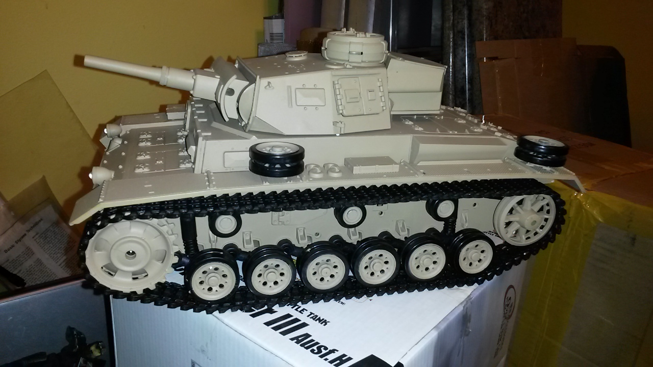

It started with a Heng Long Tauchpanzer III.
out of the box
out of the box
And a picture of one I really liked...
inspiration
inspiration
I used the tauchpanzer as it had the right rear deck, saving from having to replace the hatches. It also had the escape hatches on the sides of the lower hull, so that sets it as an Ausf A2, one of 20 or so made.

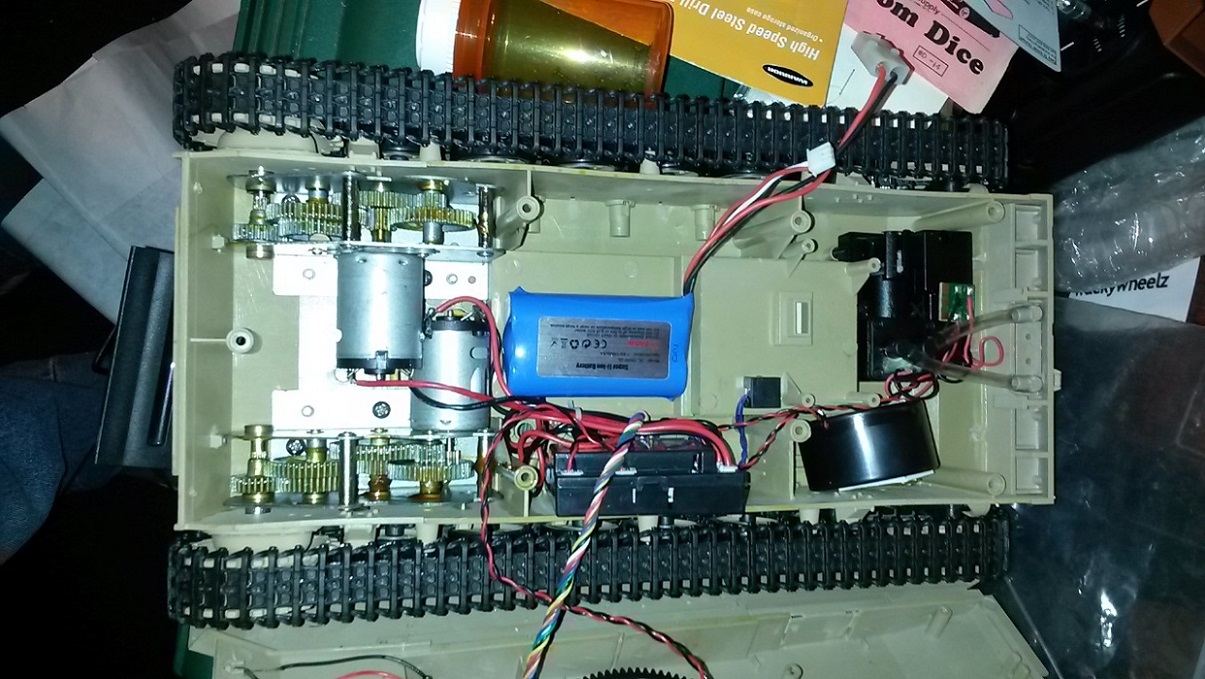

Here's the interior layout straight out of the box.
interior layout
interior layout
It had the small battery and the funky battery box. This wasn't really a problem as I planned on removing the battery box altogether. I decided to try something different with this one and seal up the interior. I used spray Plasti Dip after I removed the battery box and sealed up the other holes for the suspension. I placed plastic sheet over these as the stop pegs on the suspension arms do not really reach into the interior.

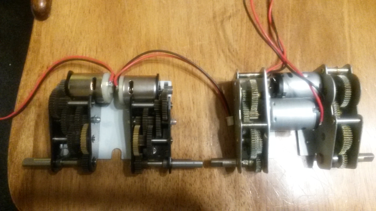

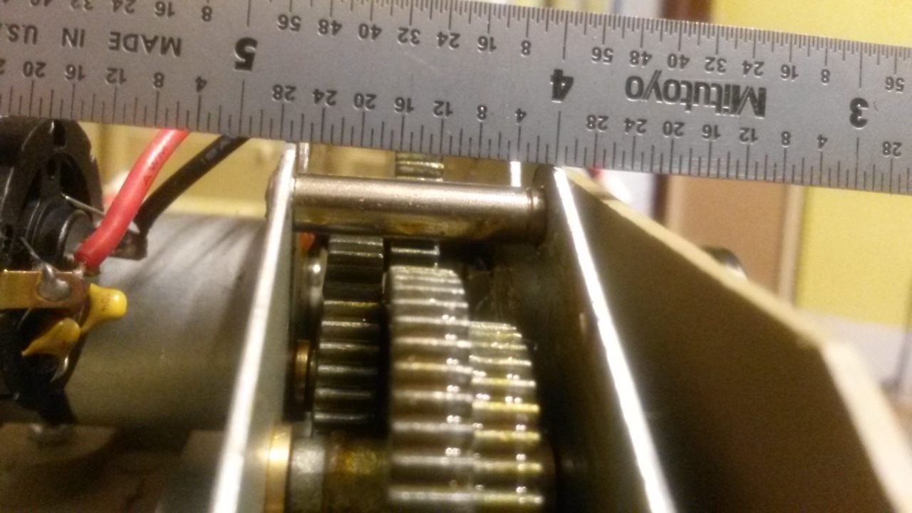

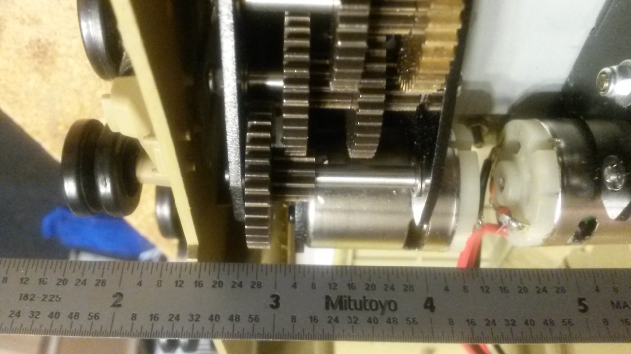

I knew from Painless's build that the gearboxes were going to be a problem, so I ordered a set of low profile ones I found on ebay. Here's a side by side of each.
side by side
side by side

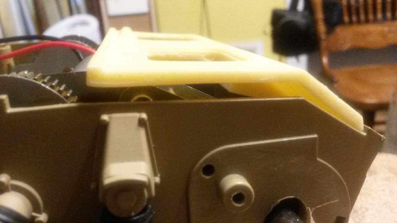

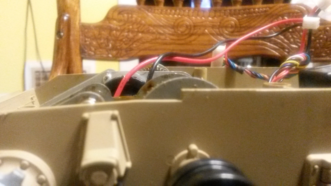

Here's the problem with the stock gearboxes.
too tall
too tall
front
front

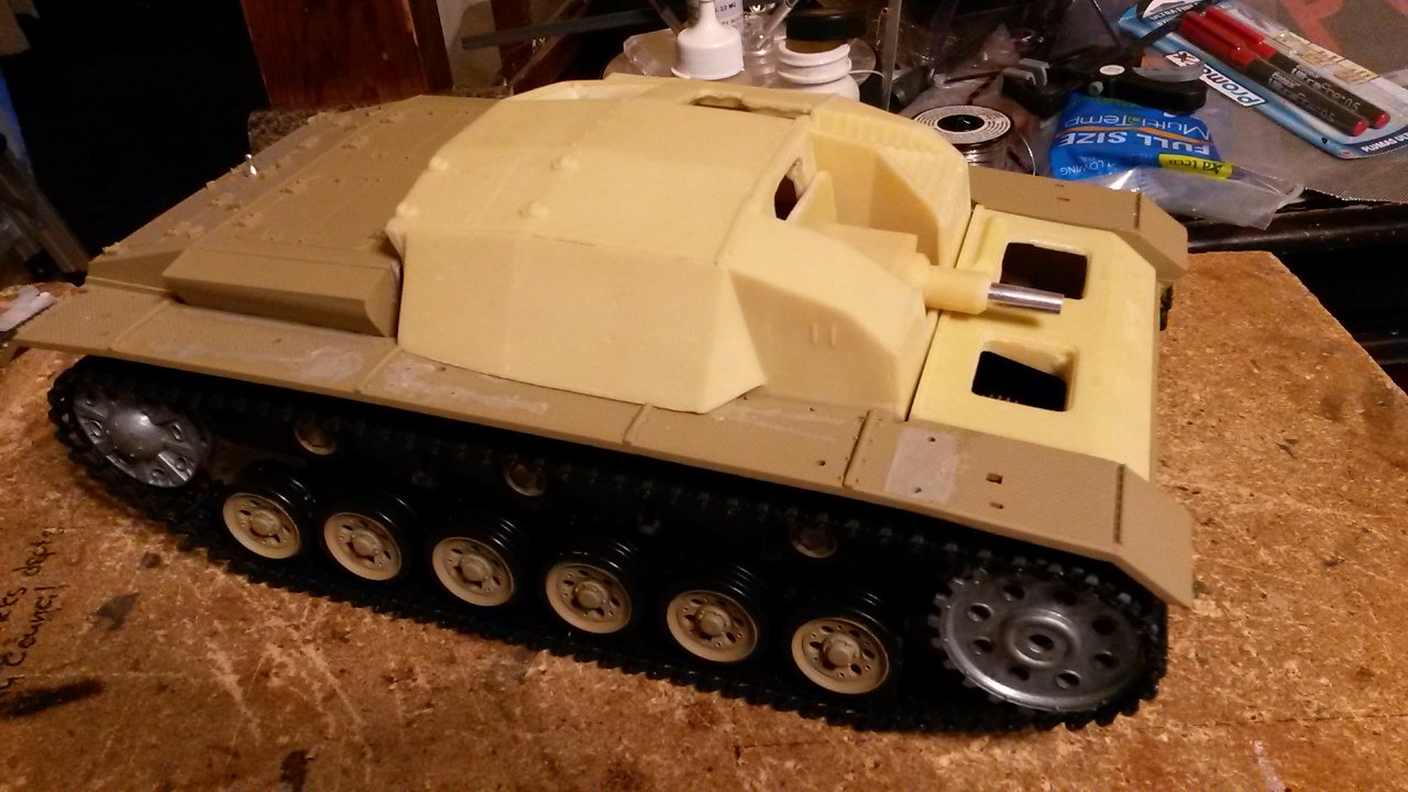

Here's the new low profile gearboxes installed.
There is plenty of clearance between the gears and the upper hull, even with the lowered position of the new resin deck. Just have a bit of trimming to do to get the plate to sit correctly.

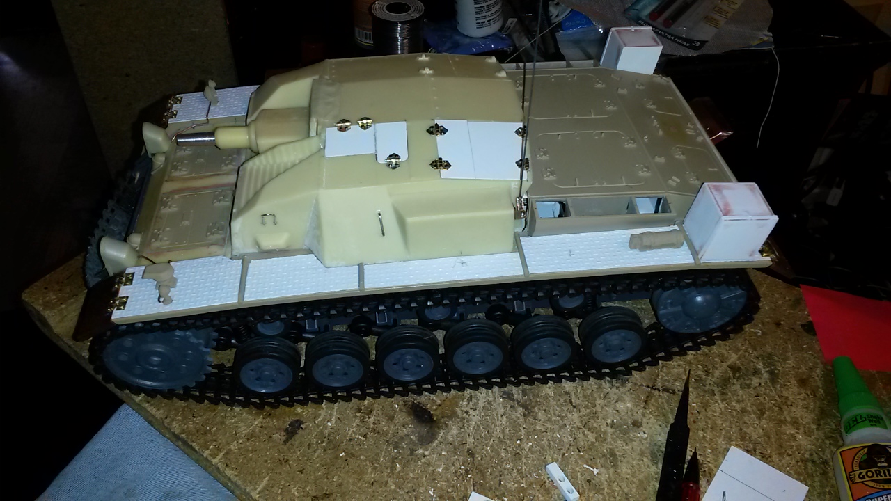

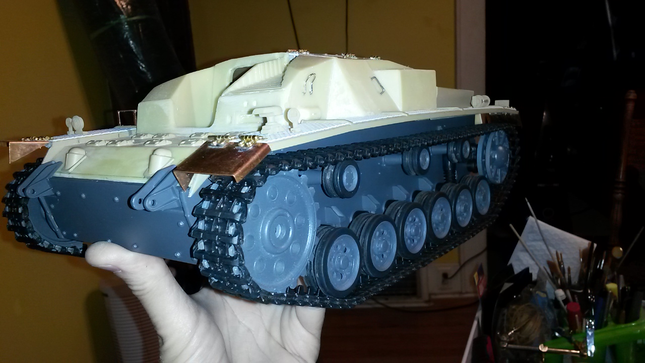

Here's the upper hull already cut and with the conversion parts installed.
I cut off the tools and such so that I could replace the tread plate. I only left the sponson mounting bars, trimming them to allow the resin casement to set into position.

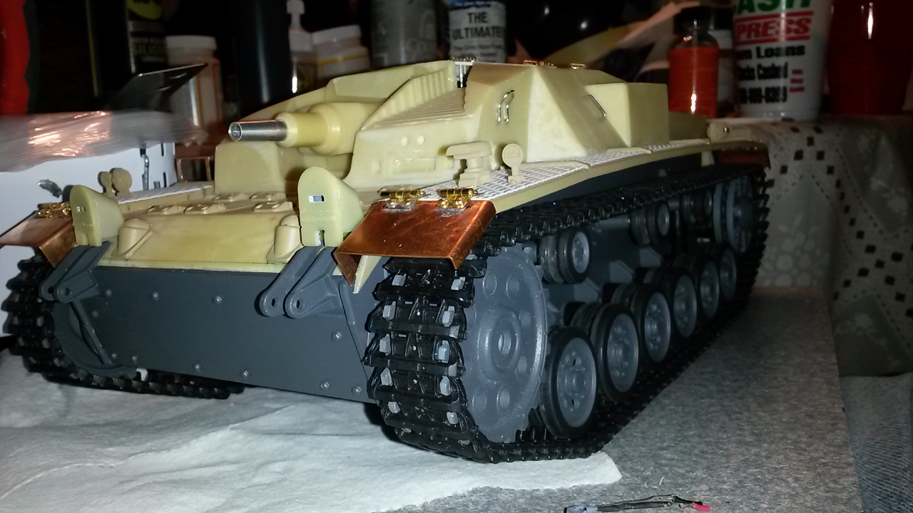

On most of my vehicles, I replace the fenders with sheet copper to get a more scale look. Also, when you hit something (or something hits you :haha: ) they bend in a realistic fashion. Here's the fenders and the smoke candle housing.
fenders
fenders
After I made up that nifty candle holder, I realized that I had made the newer style, not the older like the A's had. :{ Well, I'll deal with that later. Here's the rear fenders installed, as well as the replacement rear resin plate.
rear
rear
And the front fenders.
front
front
Also, you can see the new tread plate installed, as well as the front hatches. The resin hatches that came with it were the wrong type, but the ones on the tauchpanzer were correct. I just cut them out and mounted them in the resin deck.

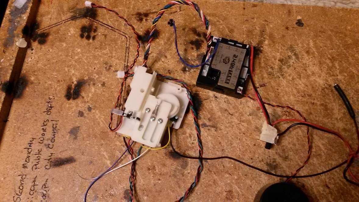

I installed LED's and mounted the headlight housings on aluminum tubing and attached them to the front plate. The tow shackles are mounted to the lower hull and the lights sit on top of them. The upper hull is held on with magnets, so all you have to do to remove the upper is slide it to the rear.

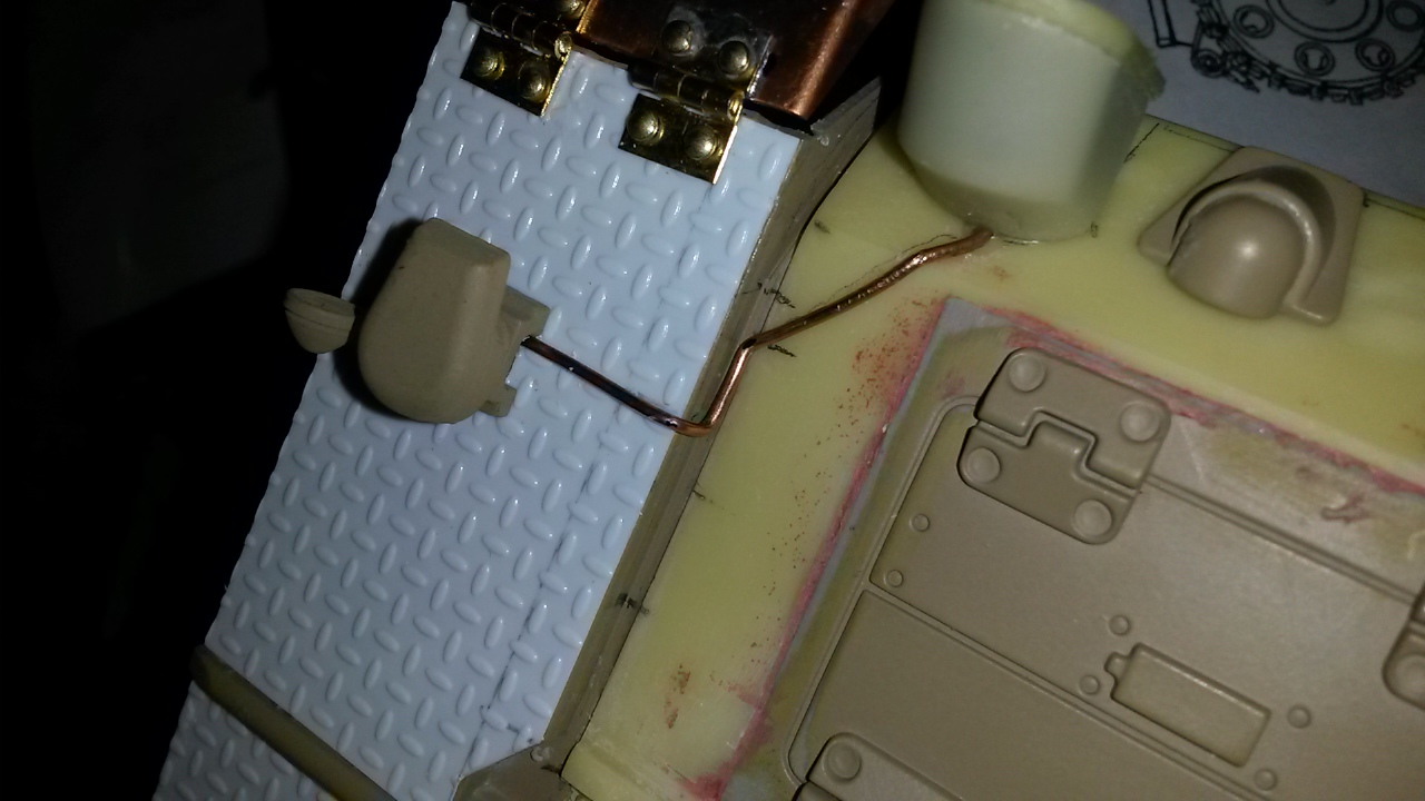

I scrounged up some copper wire and had a try at making the conduits running to the deck equipment.
Here's the smoke candles I cobbled together. Used acrylic rod, sheet plastic, and some small chains and straight pins.

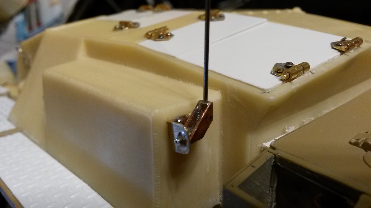

The resin antenna mounts were really fragile and I knew they wouldn't stand up to any abuse. I had a small piece of square brass tubing that a piece of music wire fit into so I made a mount up with the tube and some copper.
And , to my surprise, it actually stows!
Here it is, ready to paint.

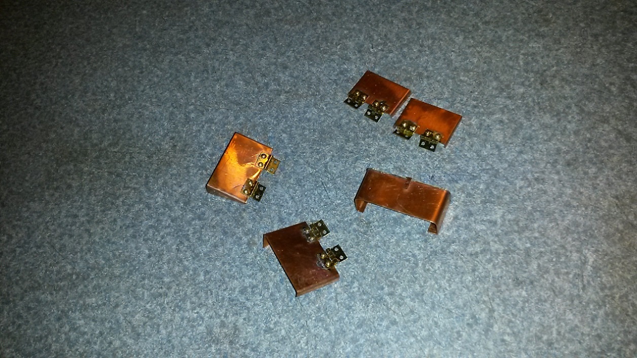

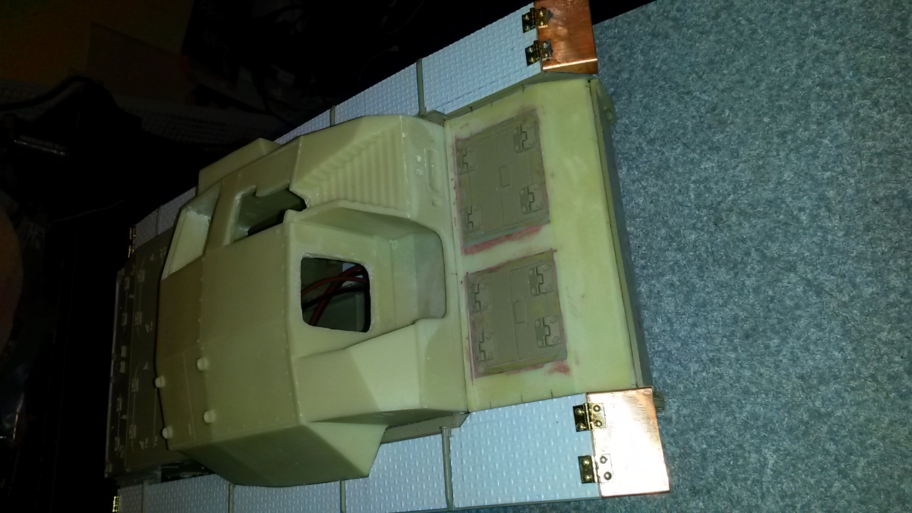

I didn't care for the resin hatches, so I made some new ones out of sheet plastic. I cut some doll house hinges to resemble the real hinges.

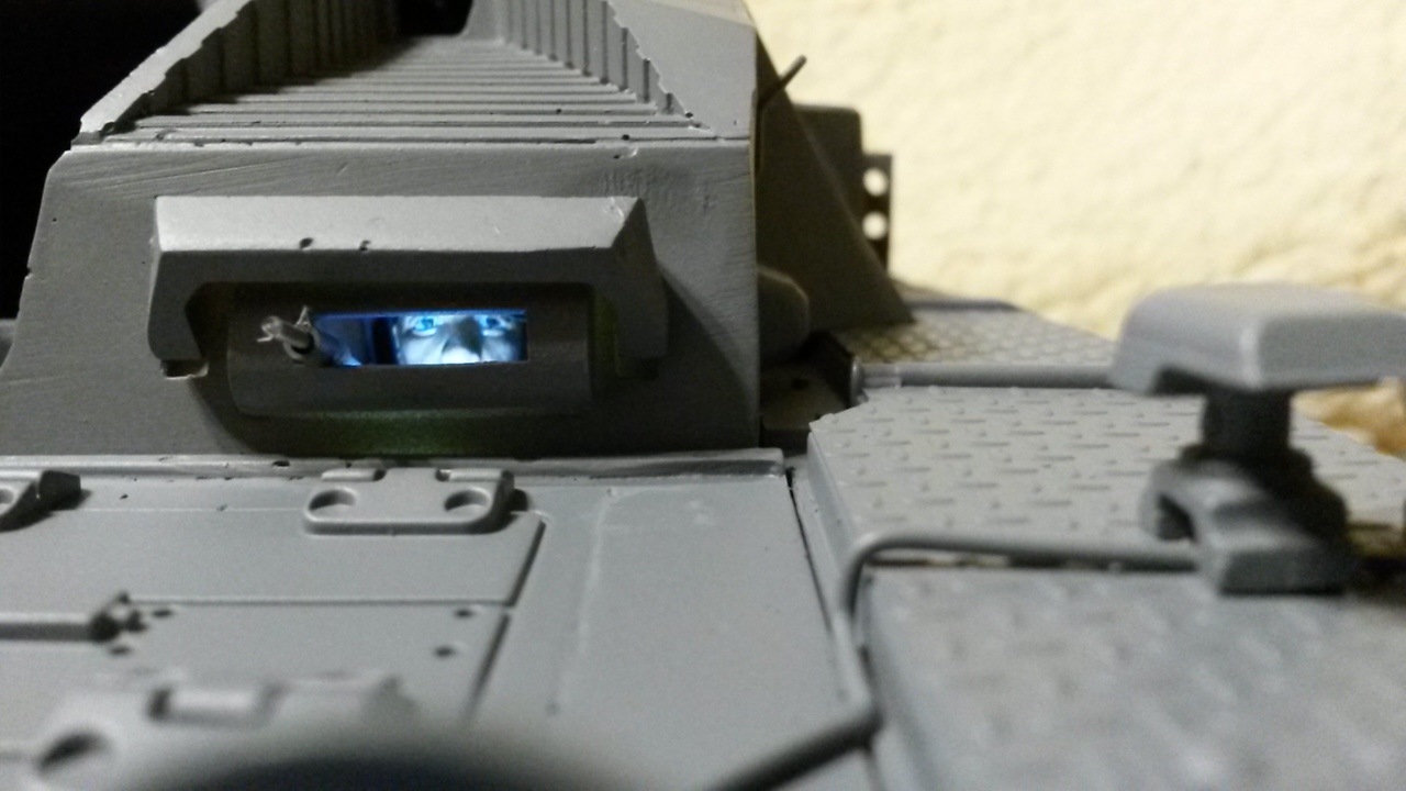

I used a short piece of brass tube with a front site soldered on as an MG barrel. Remounted the LED and ran a piece of fiber optic. Now Fritz can shoot back!

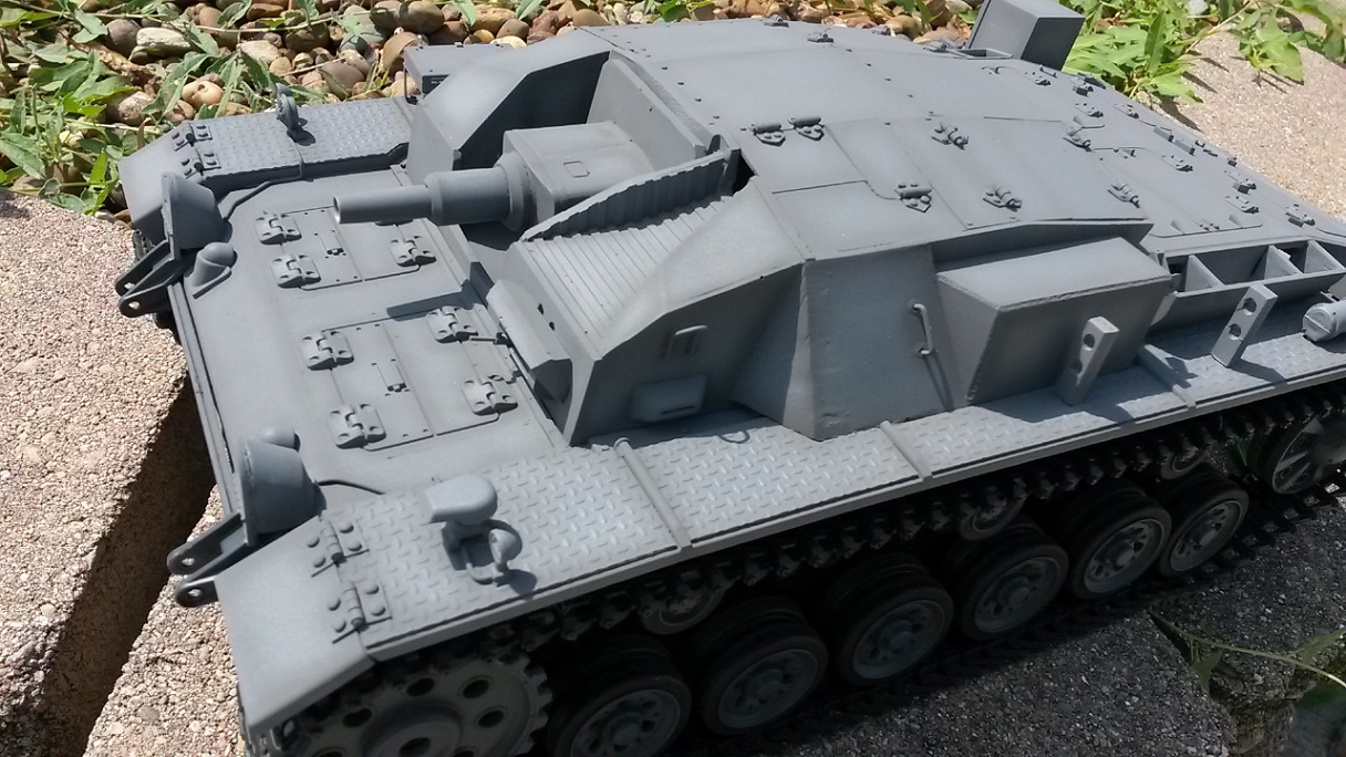

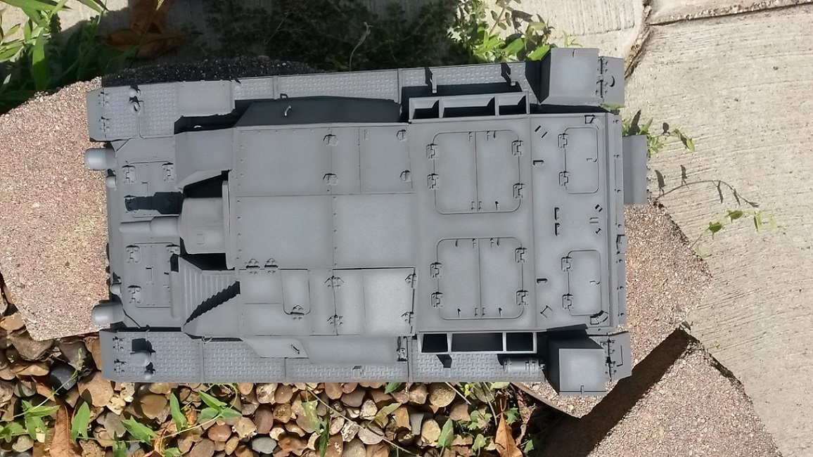

Got the upper hull painted and shaded and got some pictures outside.
overall outside
overall outside

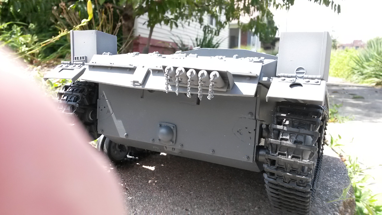

The rear showing the painted smoke candles and cover. Pardon the finger. :{
rear
rear
top outside
top outside

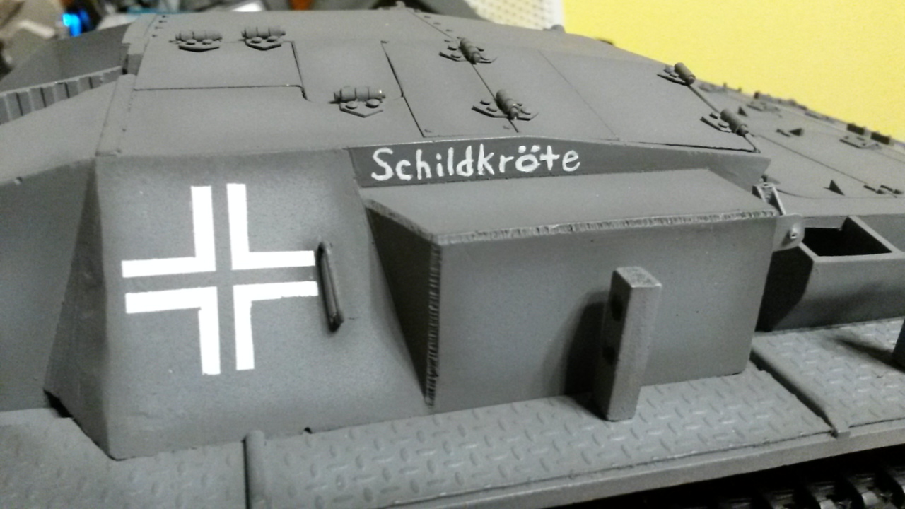

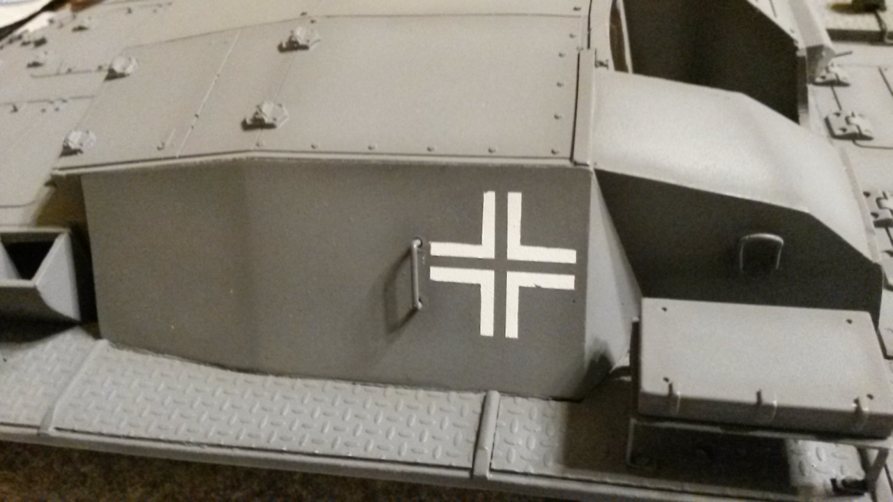

I cut some stencils to paint the crosses on with. I couldn't find that these early models had very many markings, So i just painted them on rather than ordering a decal sheet.
It had to have a name and I thought the upper hull kind of looked like a turtle, so Schildkrote! German for turtle.
