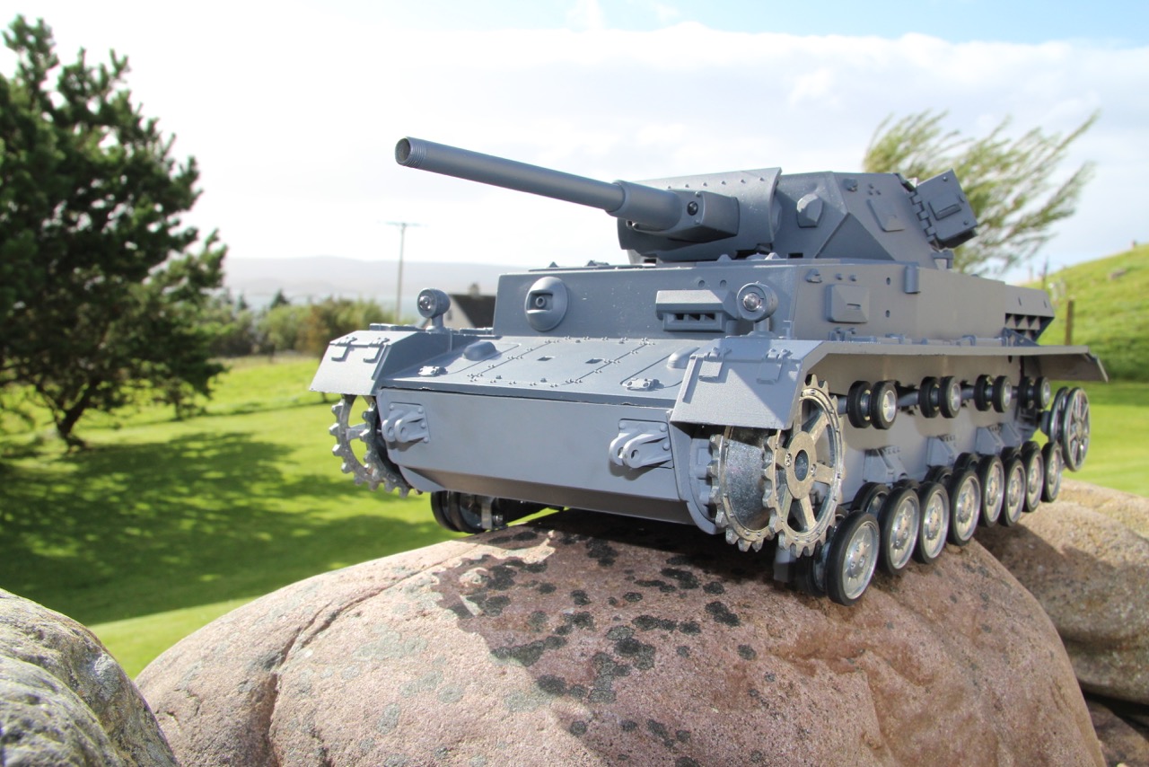

Yes, I've cleared all the obstructions out of the way (hooks etc..). Here are some pics for comparative purposes. From them I conclude that the Taigen/ HL upper deck is inaccurate at the front; but it does fit the plastic hull properly at the back, whereas the Asiatam metal hull is probably too long by almost a centimetre (5-6 inches on full size tank :think: ). Here we go:
Taigen has incorrect lip/ledge on front panel

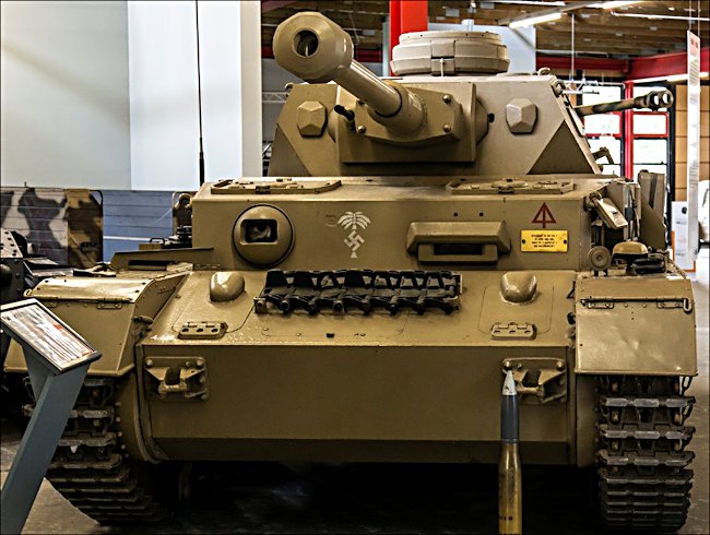

I'm too degenerate to be a rivet counter, but this is what the PZ iv leading edge should look like..n.b. no overhang or lip, but a clean edge:
Nice clean leading edge on bow

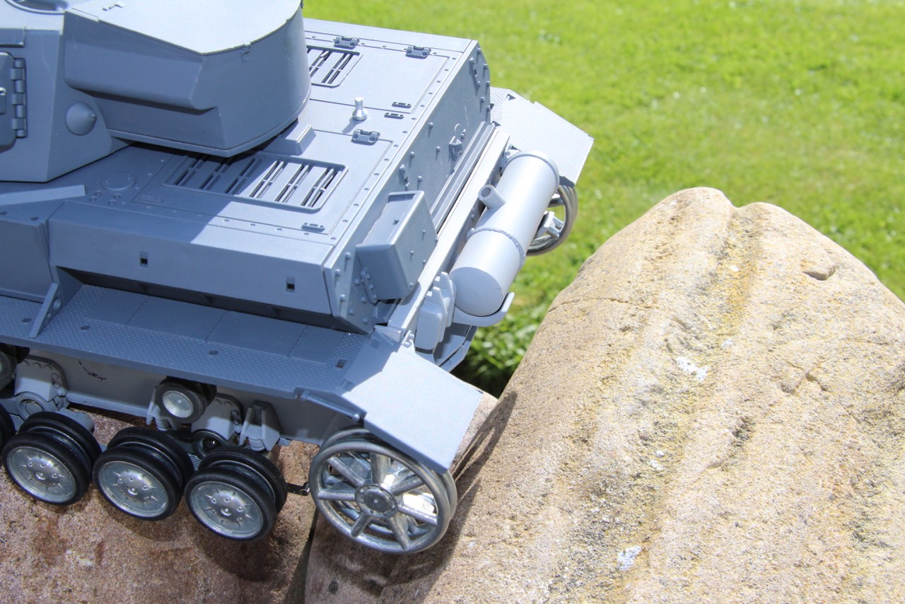

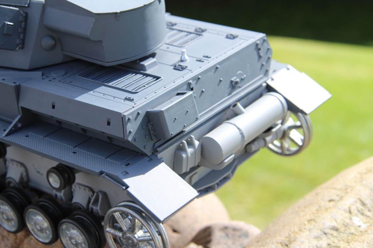

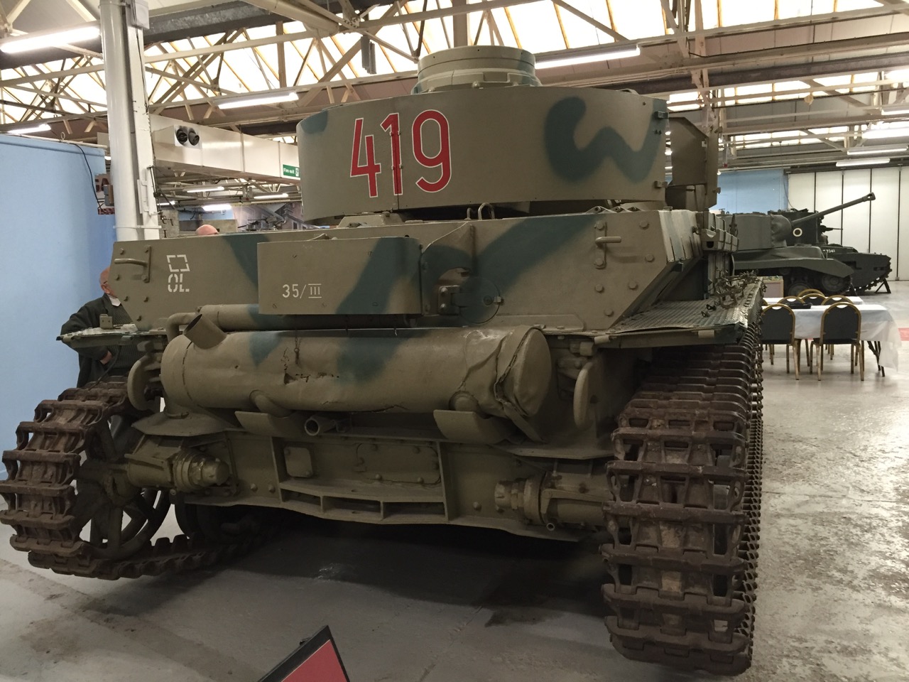

Taigen Pz IV rear is correct where upper deck flange is flush with that on the lower hull, and rear the panel almost overhangs the exhaust..not set back from it:
Compare with Pz IV no 419 I snapped recently at Bovington.. Note position and slenderness of rear flange joining upper and lower decks, as well as upper deck almost overhanging the (battered) exhaust..:
Upper and lower panels are more or less flush
Now, when the HL upper is in the correct position at the leading edge on my Asiatam hull, thus:
Correct alignment at leading edge
The rear looks like this 8O :-
Rear panel should be partially obscuring the exhaust

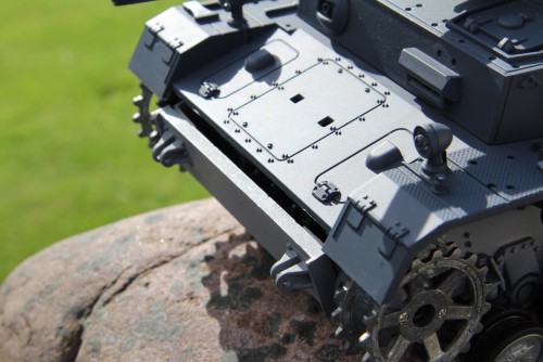

But, if I line the back up correctly, as per Taigen models and the real thing, this is what happens to the tank's leading edge 8O :
Oh dear..good ventilation though

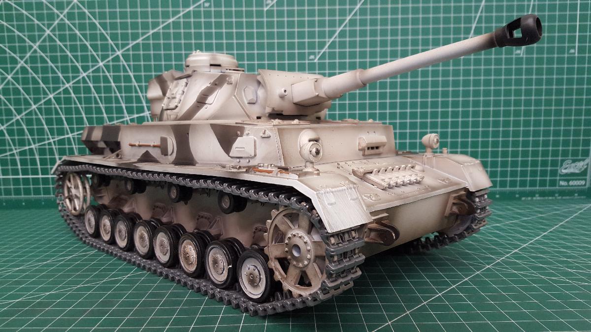

Well, here are some very old photos of my Asiatam + Heng long hull. It fits good. All the Upper hulls are exactly the same size.
