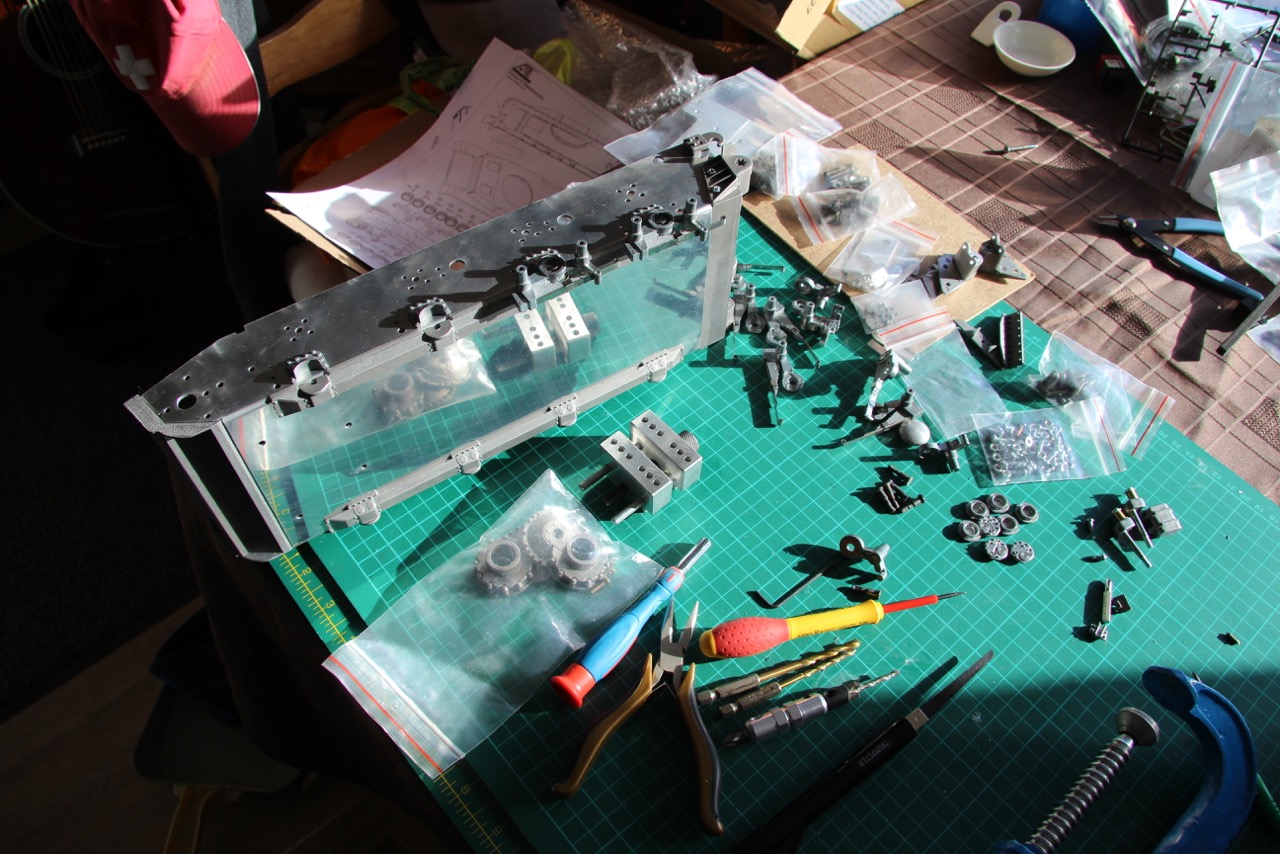

The instructions arrived on a CD, and I duly printed them out. This was probably a waste of premium inkjet paper and ink, since the illustrations created more questions than they answered. @) Thus, following advice from one of Shaun's posts, I downloaded the Tamiya Pz4 instructions, and suddenly it was as if a veil had been lifted! (no, I'm not religious..) Fiat Lux, boys!. Anyway, they helped give a clearer idea of where things should go, and how they should get there.
The Asiatam kit comes with a lot of wee plastic baggies full of disparate metal parts. Even when I found out where bits should go, it was often a b**ger of a job persuading then to go there, without recourse to drills, files,
emery cloth, hysterical threats.. and my new trusty pin vice...oh, and with super glue here and there. In particular, the supplied suspension system (marked 'Taigen' in faded ink) proved spectacularly obstinate. Annoyingly, some suspension arms are too slack, and will need shims or washers, otherwise the wheels will wander wonkily, as the tracks pass over them. That could be very noisy @) . In addition, two of the retaining clips on the leaf suspension fell apart for no discernible reason, and the others slide around disconcertingly. I can only guess what will happen the first time they're put under real stress :O Boing.. Boing... BANG !!! :-< Ohh well..we'll need to improve these bits before letting them loose on the unsuspecting world! The other fittings need cosmetic, and time consuming detailed attention. It's easy to see why these are sold as kits, and not pre-assembled in some depressing low-paid sweatshop...
Here's what the initial package looked like when dumped on my table:
Pandora's Panzer Box..opened up

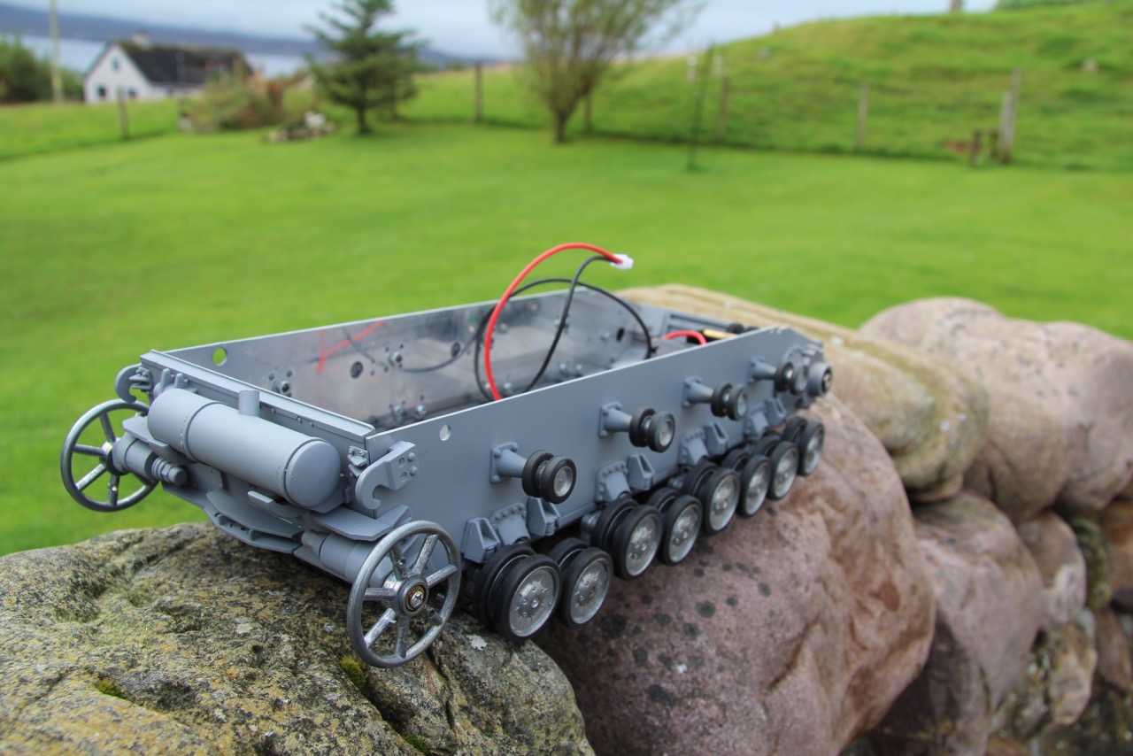

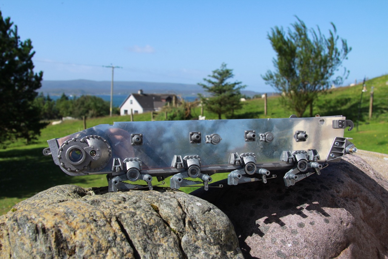

Then, after many hours and satanic invocations, stage one Panzer on the wall in my garden...with calming sea loch in the background! :haha:
Highland pesky Panzer 4
It'll be a while before I add any updates to the build, as I've yet to decide what model it will be...but I favour an F2 or later. But at least it will be paid for by the money accumulating in my swearbox :lolno: :lolno:

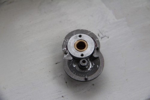

This Pz IV project would test the patience of a saint- and nobody's accused me of being one of those! Heaven forfend :O The first new chore was to get the axle support bearings to fit the drive covers, and then fit them both to the hull. This required the services of my (now) indispensable Dremel...and a lot of unprintable language:
Bearings don't fit the Asiatam housing..drat
Now fitting:

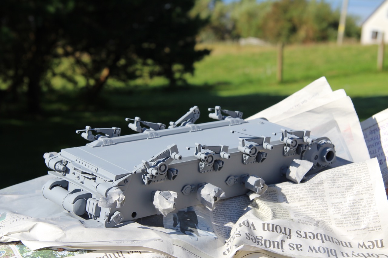

Next, a spot of primer and some fresh sea air:
Note the annoying suspension has already sprung..some clips

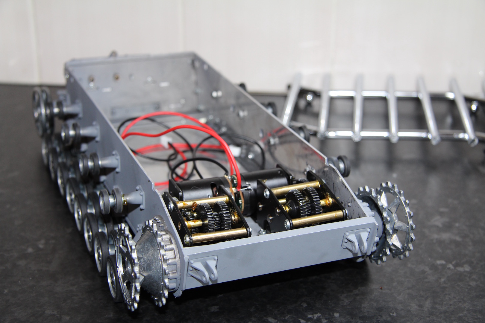

After more cursing, drilling, and modding I began attaching the poorly fitting wheels and one motor/gearbox:
Had to use spot glue to bind outer road wheels to inner ones..
Had to re-orient one drive motor by 90 deg in order to prevent contacts meeting and causing meltdown mayhem
These Taigen Premium 3 motors are a very tight fit..but, they do fit- just. :thumb:
Almost inseparable..but motors just fit
and, in profile:
Looks simple..but it was anything but

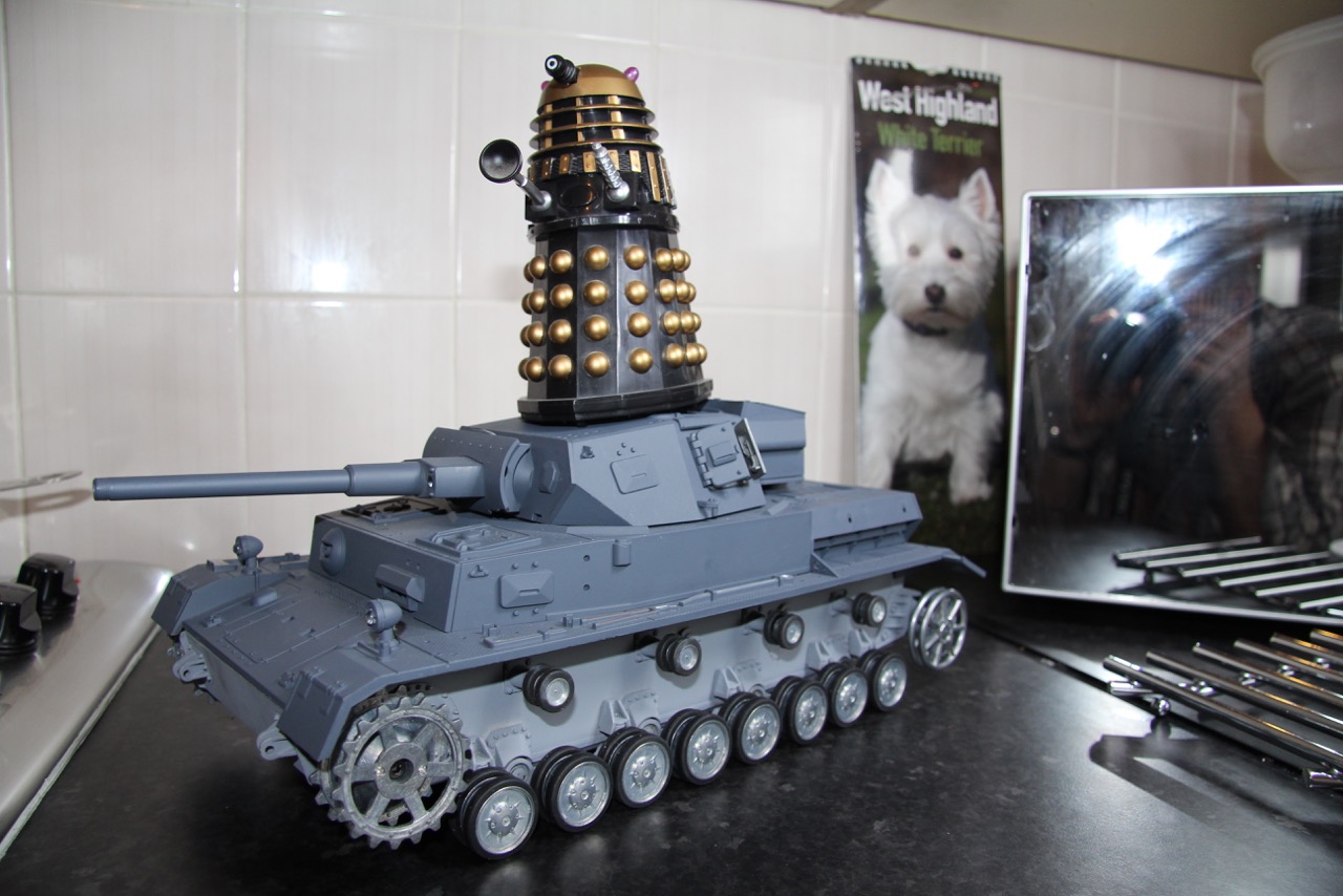

Just getting an idea of what the F2 will look like with the HL upper deck in place. heng-long-panzer supplied the budget upper deck without a commander's cupola..and so Hauptmann Von Dalek stepped in as an ersatz cupola for the present
:haha:
Revolutionary new cupola with commanding presence..

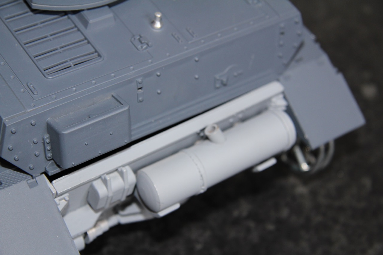

A long road yet for this project, but my next problem will be finding a way to marry the Heng Long upper up with the Asiatam downer. The Asiatam metal hull is almost 1/4 in longer than the HL deck..or, the HL deck is shorter than it should be. Either way, it's another pain. Have a look:-<
HL upper deck..short in the arse department
Es tut mir sehr Weh!!
