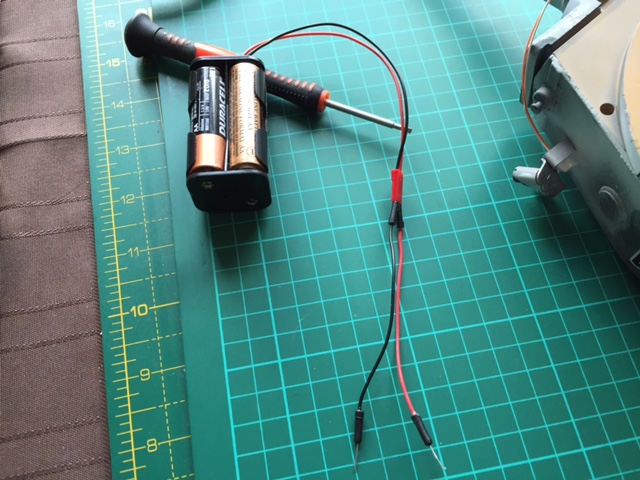

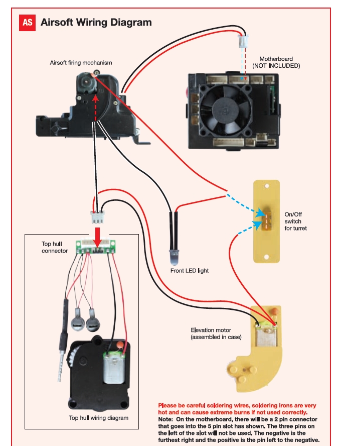

Below: one basic wiring diagram, and one rudimentary DC volt tester (4xAA batteries/ holder/ two probes..all available cheaply from Ebay/ Amazon etc..). There is only one 3-pin connector in the wiring diagram. Disconnect it in at the turret, and put the red probe into
the red connector insert point, and the black into the outside black insertion point (not the middle..that's for airsoft). Movement/ whirring noise means elevate unit is OK...and time to celebrate. If not..you need a new one. It is possible to lose the 'pairing' on your Taigen transmitter, and that might scramble some functions., e.g., everything works but..'rotate' or 'fire'..or well, you get the picture. 'Imex-Erik' explains on Youtube how to rebind your transmitter to the tank...assuming, that is, that you're still using the Taigen stuff:- Note, while 'Imex-Erik" may sound like some sort of Dark Age Viking raider (like 'Sigurd Snake-Eye', and 'Ivar the Boneless'...real raiders), he's actually quite mild and helpful..
