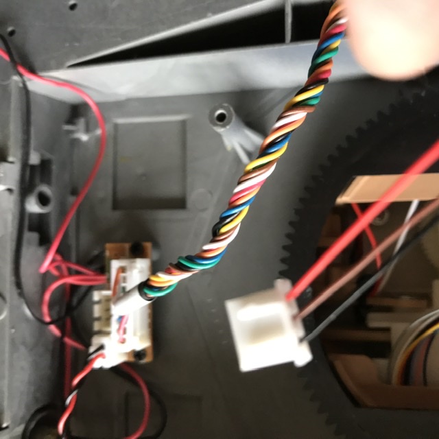

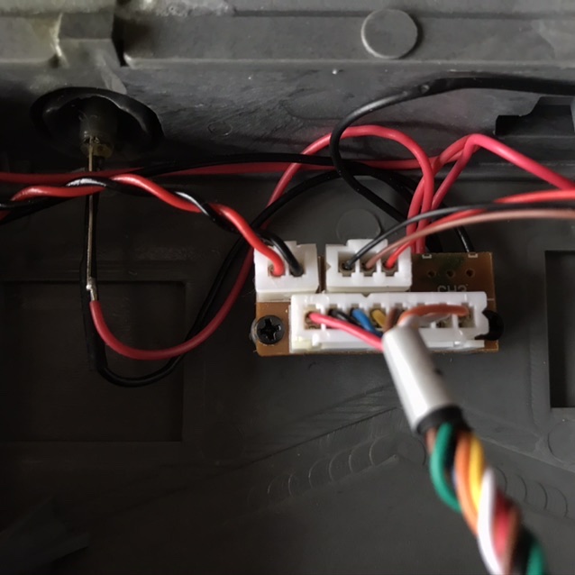

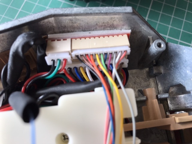

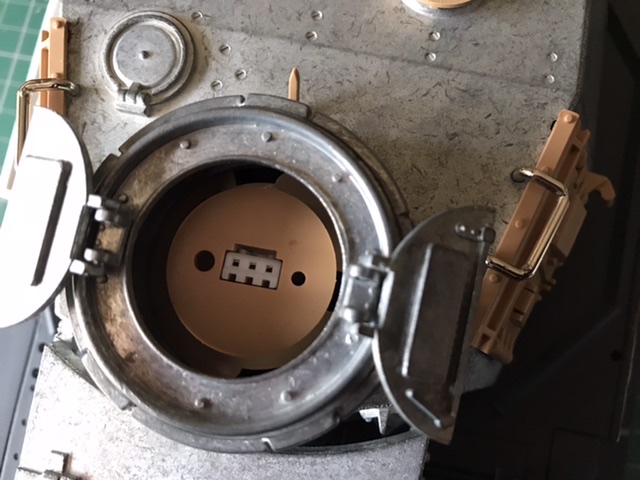

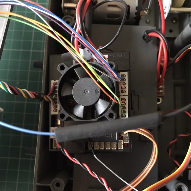

Sorry for bothering the community in general on a topic that appears to be well thumbed over. But I have all the issues you discussed in this thread, ie. elevation continuous operating and no recoil or flash on left stick. This is accompanied by periodic random/uncontrolled firing sound and flash.
My setup is a new Taigen Panzer IV IR turret, complete with recoil and flash coupled with a Taigen 2.4 GHz V3, with the track recoil suppression option. The basic tank is a Heng Long Panzer IV standard BB model I’ve had brand new bit stashed for 4 years.
I’ve reversed the black and red on the hull three pin, red from pin 1 to pin three and black from pin 3 to pin 1. This sorted the elevation and random fire sound and flash, but still no recoil or controlled flash. I don’t know whether I have followed the discussed reversing of wiring correctly and where to attack next, but it has to be in the hull connector.
Any help would be much appreciated.

Re: Taigen turret on 2015 heng long wiring help
Your wiring looks ok the reason your having to swap the 1 and 3 pin is because heng long put a socket on their 8 pin board so the plug can only connect in 1 way and the taigen 8 pin board has 3 pins sticking out so the plug can be connected either way round.
Check your recoil unit where the red wire connects to the elevation motor there should be another blue wire connecting it to the positive on the recoil motor and the flash wont work until the recoil triggers the micro switch once the recoil works the flash will work.
Thanks for your help. I checked all connections last night and following advice from Forgebear, plugged the blue recoil ground into the ground on the Taigen MFU, instead of off the ground on the power switch.
The good news is I have recoil & flash......... the bad news is it continuously cycles without left stick input and with the just power on, without switching on start.
There are two microswitches on the recoil side of the unit; one of the simple open type at the end of the recoil stroke & the 2nd small enclosed type that is tripped by a spigot on the face of the large recoil gear. I will try to check their basic function today.
It will be the 2nd 1 with a yellow and black wire connected to it. it will need resetting as its not switching off the earth connection making the unit recoil continuously
