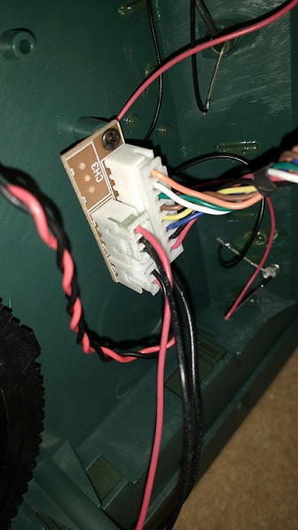

RobW
Posts: 1244
Location: Sheffield
Re: Taigen turret on 2015 heng long wiring help
Post by RobW »
Not sure it'll be much help, but at least should assist in placing the red wire.....
