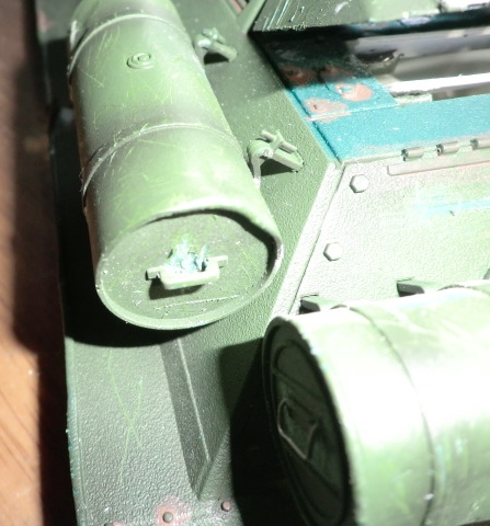

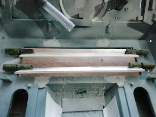

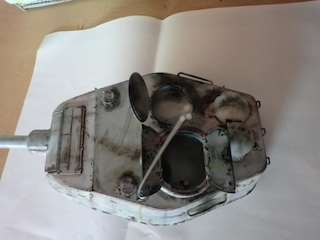

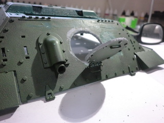

- had to bend the hatch opening tool down a bit as it catches on the turret
- CIMG2100.JPG (31.55 KiB) Viewed 3739 times
- CIMG2099.JPG (36.29 KiB) Viewed 3739 times

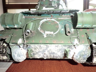

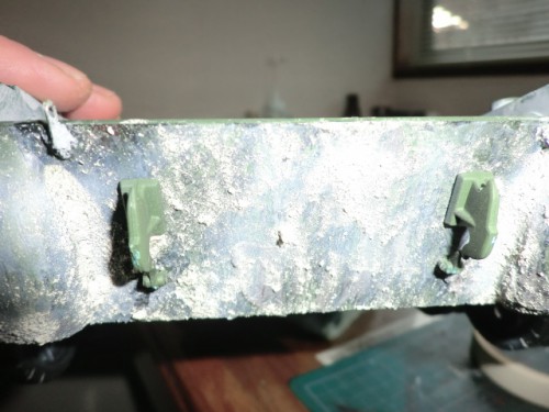

- haha all went well but somehow I ended up ripping the hinges off, too bad

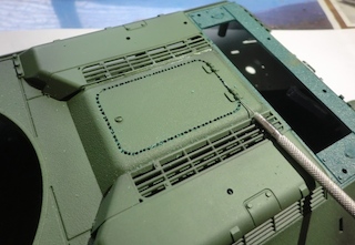

I did the Dr Phil suspension spring swap (you can see it all on Dr Phil's web page, the other T-34 Heng Long build thread), but I found it's better not to mod the springs on the rear wheel set under the motors as the weight of the motors makes the suspension sag too much, so the rear wheel set has full spring tension the others are swapped for low spring tension)
I cut the very hard plastic tubes off the smoker and replaced with softer tube ( I saw some people used McDon*** wibbly wobbly straws to great effect here, the smoker is a pain to sit between the motors)

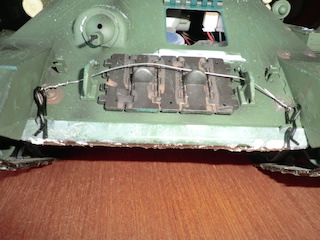

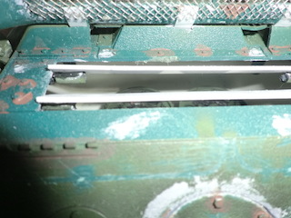

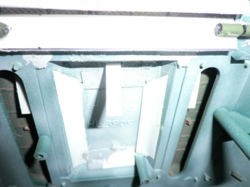

I hinged the rear section and it now pivots up like the Flakpanzer model. Working on putting a plasti card strip in front to hold the speaker (ditched the speaker box tub thingy...) and the switch under the front hatch.
Mainly working on texturing the turret and adding small details here and there before I begin painting the lighter green base colour.

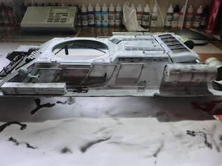

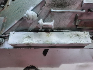

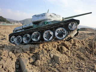

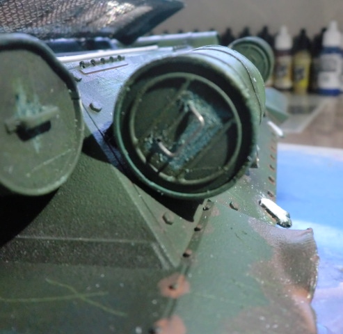

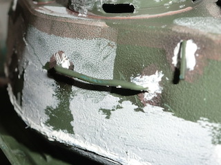

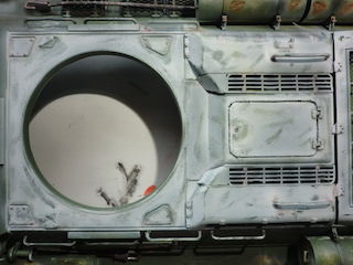

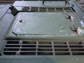

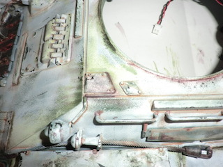

Did a little detail painting and started adding winter wash, I'm not so good at doing realistic dents or the weathering patches but it's steps in the right direction

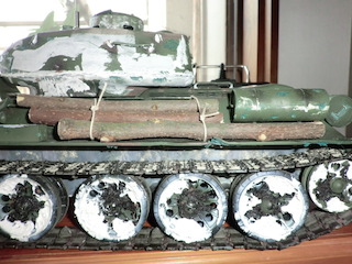

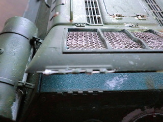

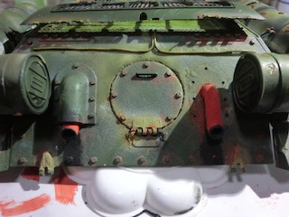

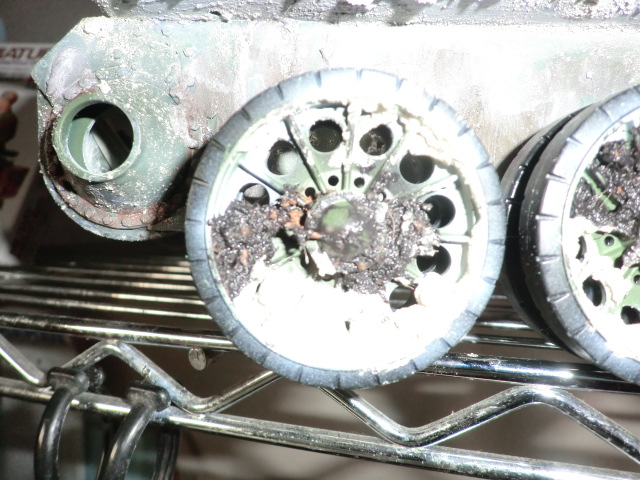

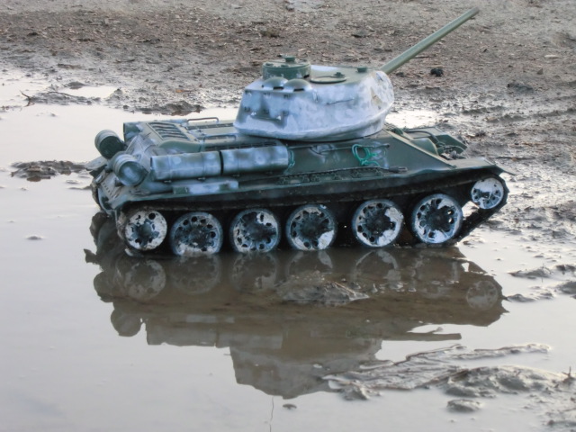

Re: Decided on a Heng Long ... T-34/85

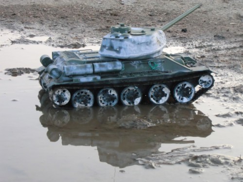

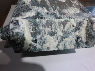

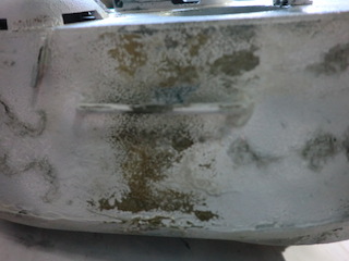

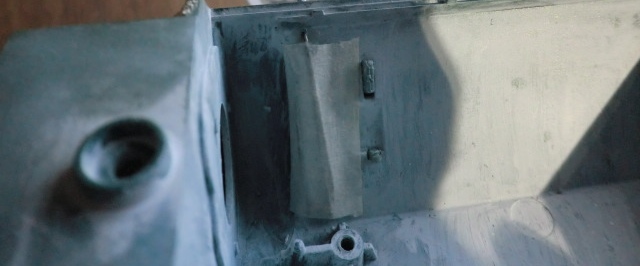

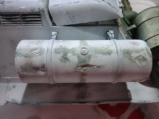

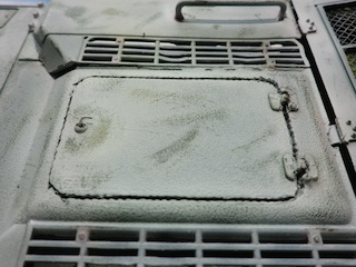

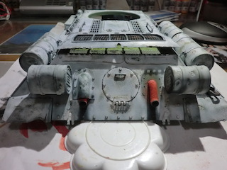

I didn't repaint the original HL so using that as a base I added hairspray then white then rubbed some off with water and brush
then started adding shades and highlights and weathering with thinned oils
(I did the pipe with powdered chalk and varnish)

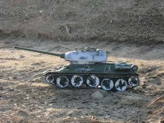

You guys are too generous in praise
looks like it was painted by a four your old
and here is a bloke who hasn't got a clue about how to use imovie...
(it still needs rain streaking, a lot of tidying up and the logs, bags and tarps haven't been added yet, like
everyone else it's a work in progress)
How not to make a video, camera strap, wibbly wobbly, dark light etc. just rushed it off as the weather was good...
this video is dedicated to my furry friends, antenna eaters, garden guerillas, foulers, T-34 destroyers

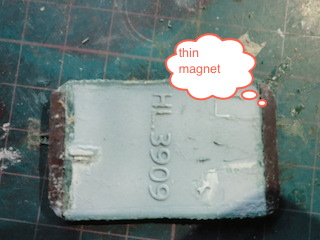

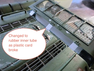

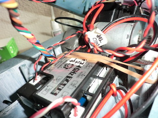

(I bust up my rear hinges so rubber bands saved the day, I'm going to do the neodymium magnet mod when they arrive, lol how do you pronounce neodymium properly
https://www.youtube.com/watch?v=Y2XE5bnbjlc
