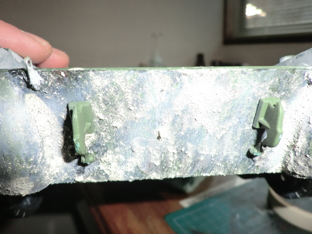

- haha all went well but somehow I ended up ripping the hinges off, too bad

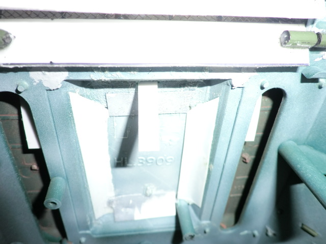

I did the Dr Phil suspension spring swap (you can see it all on Dr Phil's web page, the other T-34 Heng Long build thread), but I found it's better not to mod the springs on the rear wheel set under the motors as the weight of the motors makes the suspension sag too much, so the rear wheel set has full spring tension the others are swapped for low spring tension)
I cut the very hard plastic tubes off the smoker and replaced with softer tube ( I saw some people used McDon*** wibbly wobbly straws to great effect here, the smoker is a pain to sit between the motors)
I hinged the rear section and it now pivots up like the Flakpanzer model. Working on putting a plasti card strip in front to hold the speaker (ditched the speaker box tub thingy...) and the switch under the front hatch.

(I bust up my rear hinges so rubber bands saved the day, I'm going to do the neodymium magnet mod when they arrive, lol how do you pronounce neodymium properly
