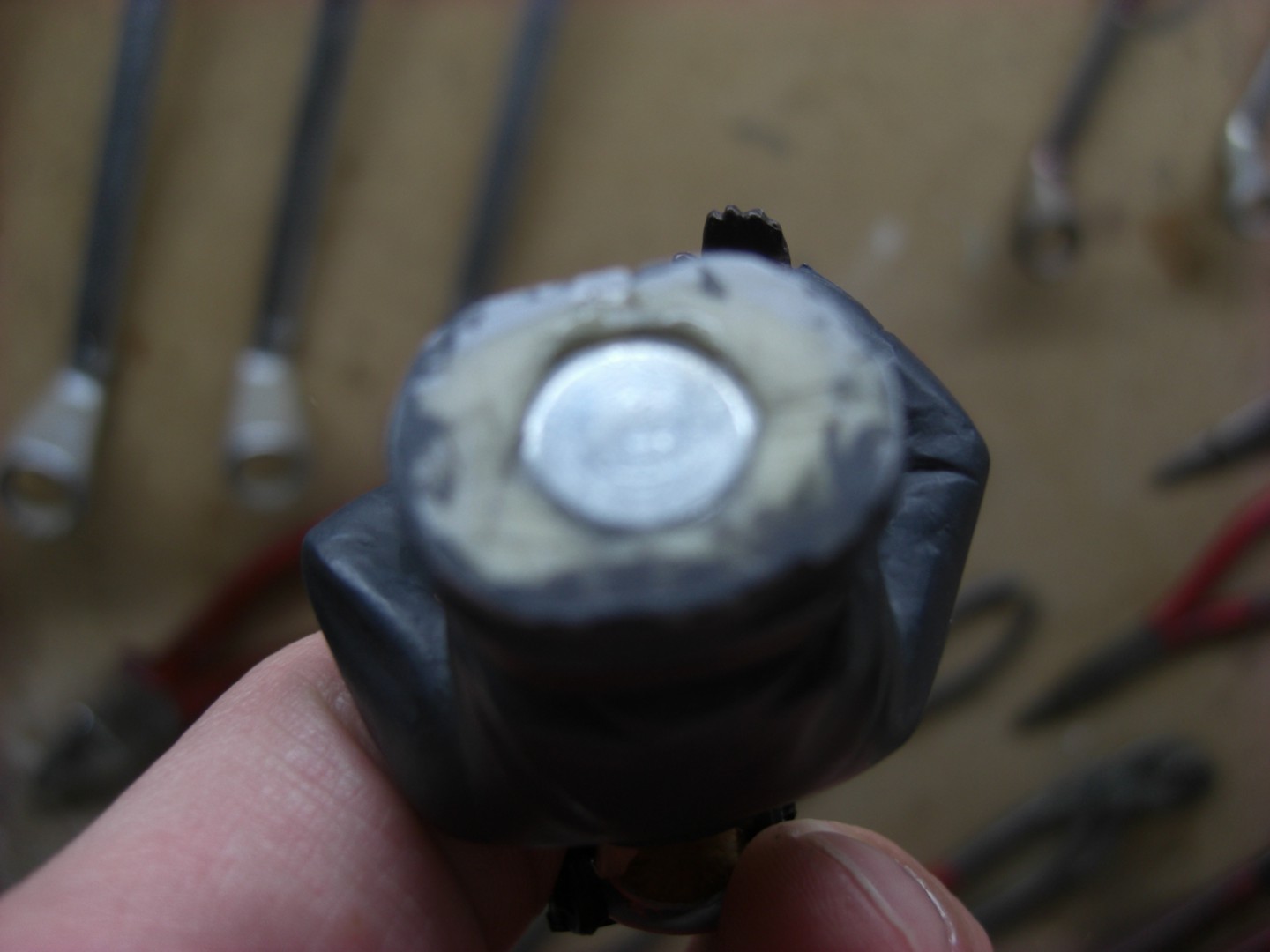

For a lower main emphasis he has received inside a hex bolt M5; furthermore is inside the turret a magnet that is holding my commander.

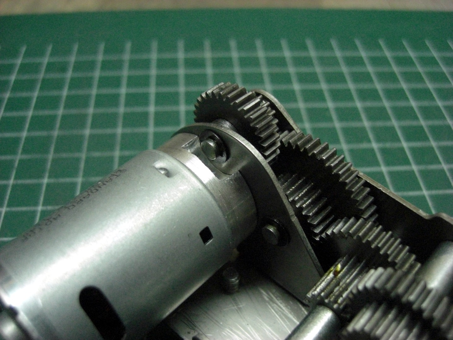

Before I concern me intensive with camouflage for my Panther, here are still the last two changes; I've installed another gear and added a last detail at the rear turret hatch.

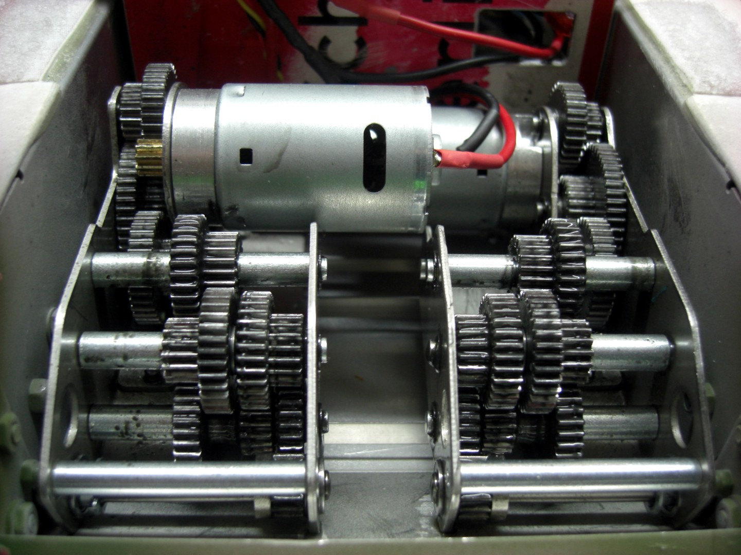

The transmission for my panther came from Singapore from Impact.
The transmission unit is basically a copy of the Tamiya gearbox, extended by an additional gear. These gearboxes from Impact reaches almost twice as high reduction ratio than the original, out comes a really great drive feeling, massive power and speed and acceleration are more realistic.
Along with the new firmware from ElMod it is now possible that the tank drive curves on each surface.
Here is now a view to the contents of this package. However, I changed the shafts from Impact against Tamiya's, for me they are processed better.
The new gearboxes are now installed in the tank and these without any problems.

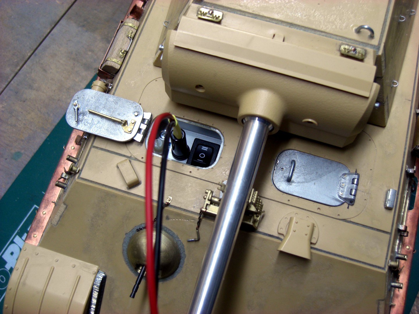

Now to my second change; for my crew probably not so important, but it belongs to a panther, and so I had installed a device for closing the rear turret hatch.
For the turret sided strike plate, I've cut a small slit, pushed the striking plate from the inside through and glued it at the inside.
From the hatch I've filed some material from the edge and glued there the strike plate. Here in the pictures not to see, but the parts were then also completed with welds.

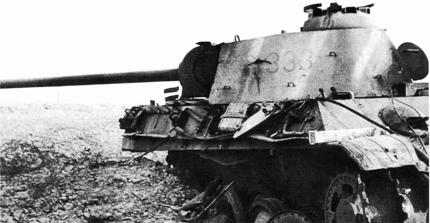

Here are still two photos to this theme:
The tank with turret number 333 has really existed…
That’s all what I know about this especially camouflage. Before I start with the primer, I will drive some rounds to see, if he is still need an update.

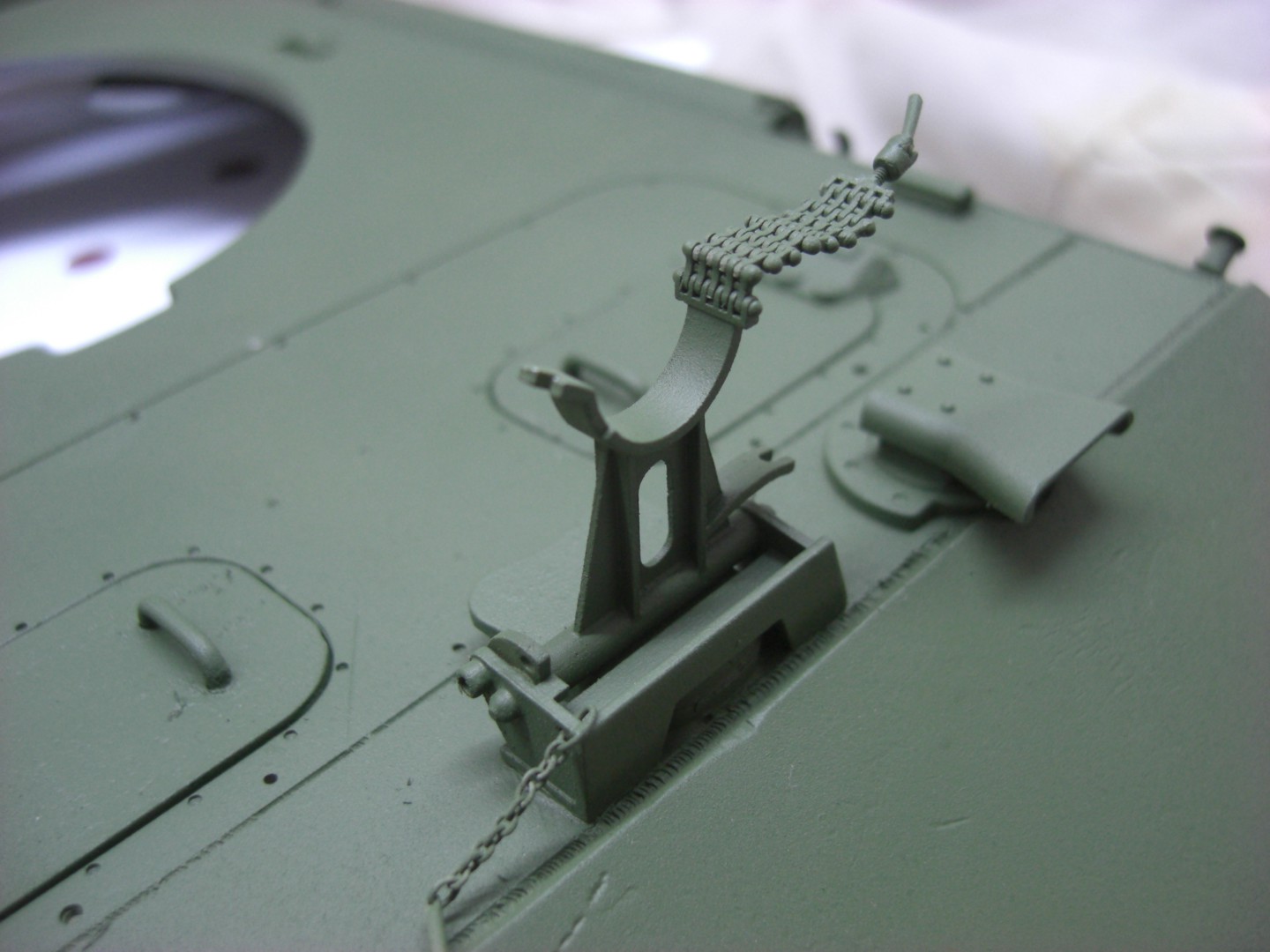

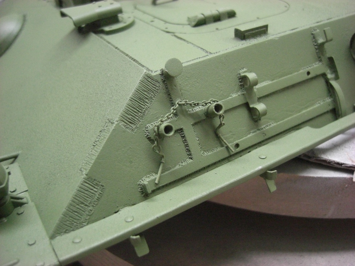

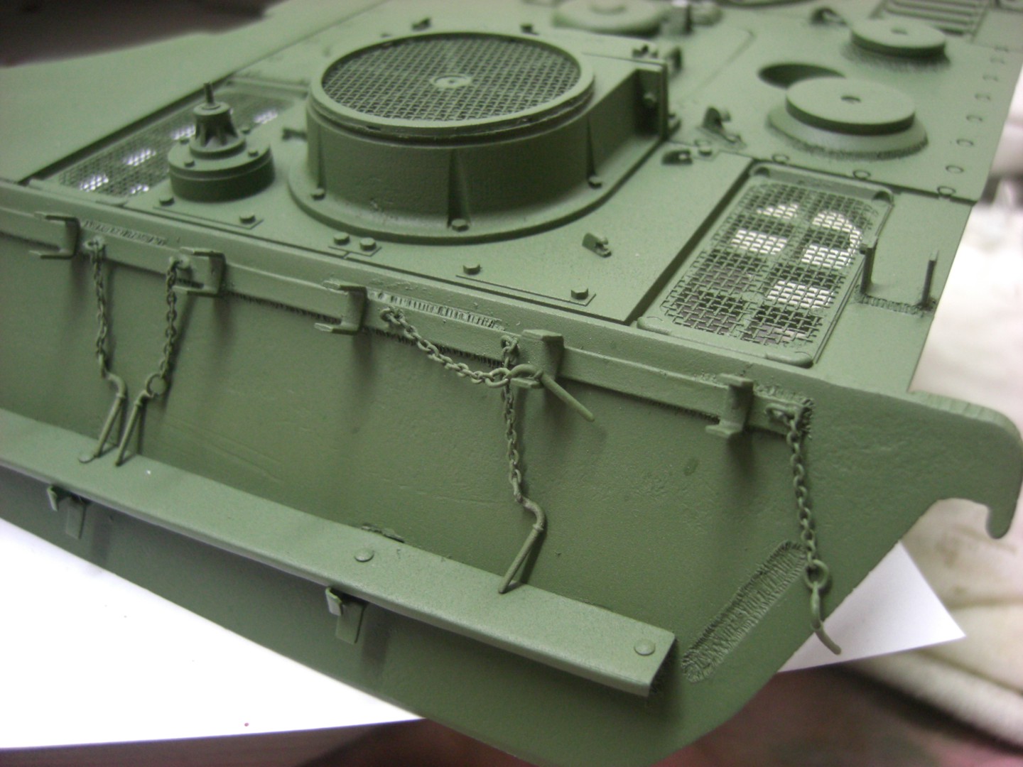

As I said, from the primer coat on my Panther I have no photos, only from the base color. The used base color was then and is now olive green (RAL 6003). This coat I've applied on my still disassembled tank. Here are some photos…
I have the color heavily thinned to receive a thin coat, especially on fine details like the chains or the weld lines.
A long time I thought about whether I should use „Worn Effects“ from AK; but then I decided me against this fluid. The tanks from this unit were at that time almost new and the used time was very short. So will a slightly aging and weathering seems more realistic. On big surfaces I've applied a second coat (little clouds) of olive green with 10 per cent white; I hope this is good to see on my turret.
Next time it will go on… :)
