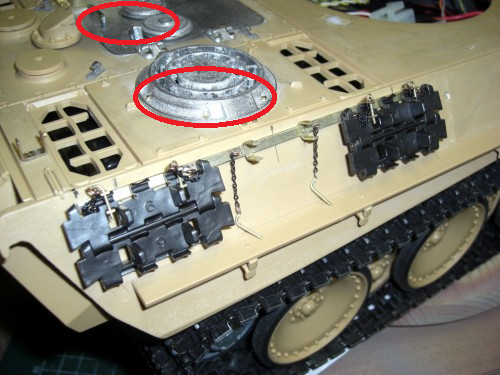

Starting today, I dedicate myself to the upper hull. I’ve used again many WeCoHe parts like gun travel lock, heater for crew compartment, some hatch covers, tool holders etc.
I begin with the heater for the crew compartment; the parts quality is fine, but not quite complete. But this is not a problem for a modeler, we adapt and detail at every time. First is here a photo from an original heating.
The ring for insertion of pieces of cake on top of the fan I've cut out from a PE panel, then I grind off bolt and washer and in its place I've drilled a hole and cut a thread M1.
So can I now, depending on the outside temperature, adjust the temperature of the crew compartment through the pie slices. :)
The holder of the remaining pieces of cake, I also have modified something, he has now received the two small plates welded. So can't the rest of pie pieces while driving make self-employed.
The holders for the spare track links are also from WeCoHe. First I removed all the parts and polished them. Then I've rebored the wholes in the locking bolts and each provided with a short chain.
Then I soldered the chains of locking bolts with a small loop at the spare track link holder. The holders themselves are screwed from the inside of the upper hull with M1 screws. Finished it looks like this.
And here the right side…
The spare track links are only to try; they came with the kit from Tamiya and made of plastic...

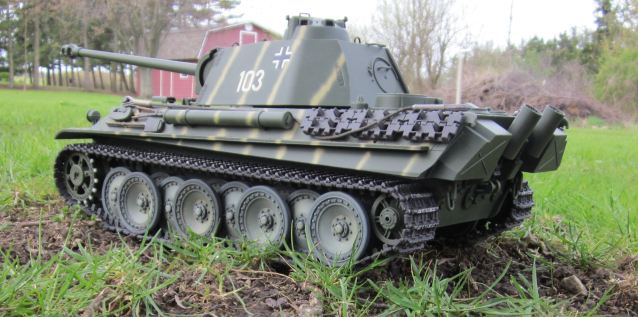

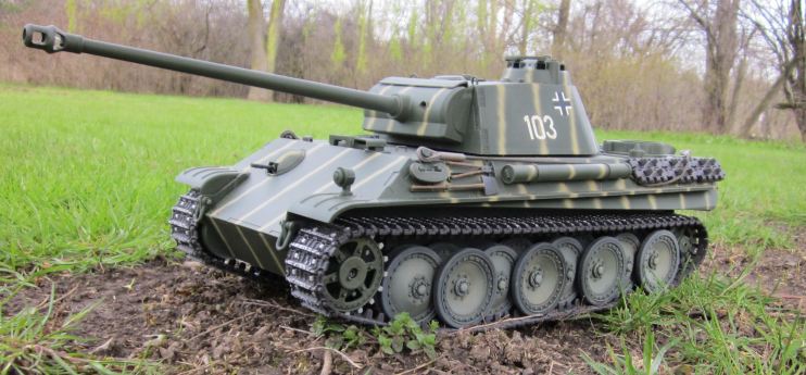

One of my IR battling Panthers with my interpretation of the MNH colours, in case it is of interest;
MNH Panther Left Front.JPG (67.61 KiB) Viewed 11980 times
MNH Panther Left Side.JPG (57.12 KiB) Viewed 11980 times
Just after taking out a KV-1 at one of our club's meets
