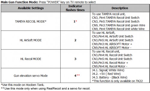

Craig, just noticed that that the Main Gun Function Mode Section contains the Gun Elevation Servo Mode (J4) but really it should be the RealRecoil (J2) Mode there. It is not wrong information but just misplaced I think. I must have flip thru this thing multiple times and never really noticed it. I don't use RealRecoil so that might be it but it is amazing how you think you know the whole thing inside out and then stuff keep popping up.

Re: Clark TK20/22 PDF Instruction Booklet & Remote Guide
Actually, this isn't misplaced information, it's just not explained anywhere in the documentation. RealRecoil mode doesn't need to be in the Main Gun Function Mode settings, because if you are using RealRecoil, this setting won't affect it at all, RealRecoil simply works just by attaching a servo to port J2, & the only setting for RealRecoil needed is one to change direction of the servo used for it, which is another function entirely.MichaelC wrote:Craig, just noticed that that the Main Gun Function Mode Section contains the Gun Elevation Servo Mode (J4) but really it should be the RealRecoil (J2) Mode there. It is not wrong information but just misplaced I think. I must have flip thru this thing multiple times and never really noticed it. I don't use RealRecoil so that might be it but it is amazing how you think you know the whole thing inside out and then stuff keep popping up.
However, the Gun Elevation Servo Mode is linked to this function, in a way, & which recoil mode you are using, but only if you are going to be using RealRecoil. Meaning, you can only select this option number 4 under Main Gun Function Mode if you are also using RealRecoil & a servo for recoil as well.
I'm assuming these other recoil units just won't work if option 4 is selected, though I have not tested any to verify. The function settings may have been done this way, again, because of limited resources in the micro controller used for programming, so anyone wanting to use Gun Elevation Servo Mode will also have to use a servo & RealRecoil for their main gun recoil.
I think I will either add this programing hitch to my "Special Board Programming Notes" section which I included in both PDF guides, or update the functions table with another note.

Thanks Craig, I guess I will be finding this out very quickly as I just picked up couple of HiTec HS-81 to try the recoil. So what you are saying is that you will only have to select this if you are using Gun Elevation Servo and that's why it is there.

Yes, the only way the Gun Elevation Servo function will work with a servo connected to J4, is if the Main Gun Function Mode is set to "4" on a TK22 board. But to use this option, you will also have to use a main gun recoil servo with RealRecoil too. In other words, you couldn't set this to option 4 & still use a stock Tamiya, Hooben, or Heng Long recoil unit. If you did, the gun elevation would work with the servo connected to J4, but those recoil units wouldn't. I have not tested this myself, though this was my understanding of how it all works after asking Clark to explain.MichaelC wrote:Thanks Craig, I guess I will be finding this out very quickly as I just picked up couple of HiTec HS-81 to try the recoil. So what you are saying is that you will only have to select this if you are using Gun Elevation Servo and that's why it is there.
