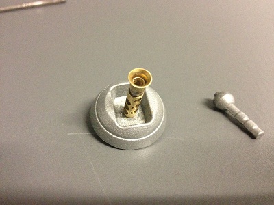

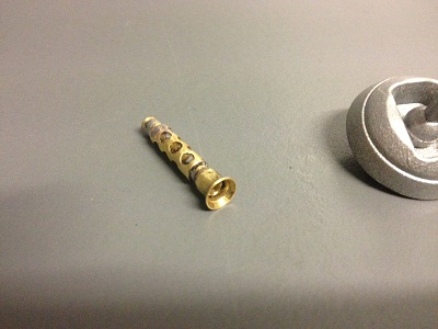

Gday Fellas, I didnt see the point of the original machinegun and ive got some of this brass tubing around,so I just knocked this up in front of the TV and it only took about 35mins.Ive used 3.15mm and 4mm tube (not to scale) I used a fine drill and pencil file,and flanged the muzzle by placing a small length onto a countersunk 3mm bolt and backing a nut upto it.

that looks fantastic. take it you drilled the bigger bore and then slid over the small bore. what sixe drill did you use? jeff

Hi Jeff, I used a 1.5mm drill bit and then used the pencil file to get the holes more accurate coz my drilling wasn't that good. Cheers
